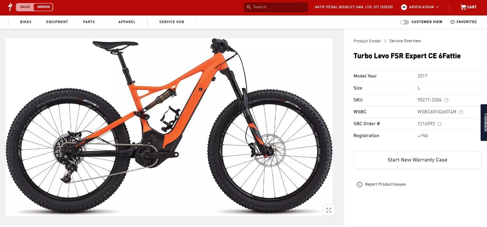

I´m looking for a second hand motor for my Specialized LEVO FSR EXPERT 6FATTIE (MY 2017)- Ele Motor, Specialized 1.2 motor, custom rx tune (85nm) - S206800001

I know what it states on the Specialized shop page but as a Specialized trusted service centre for their eBike motors, I can tell you this information is incorrect. The specialized part number is correct, but your motor is a Brose S 1.3 90Nm motor, part number C97272-100. There is also a Brose factory remanufactured version available (part No G74102-100) these are much cheaper and are approximately 90% new parts. We are the official UK Brose warranty service centre, and you can buy these motors, or our upgraded version here: Security measure - eBay By using eBay instead of our website, you can get the motor delivered by their international shipping program.
