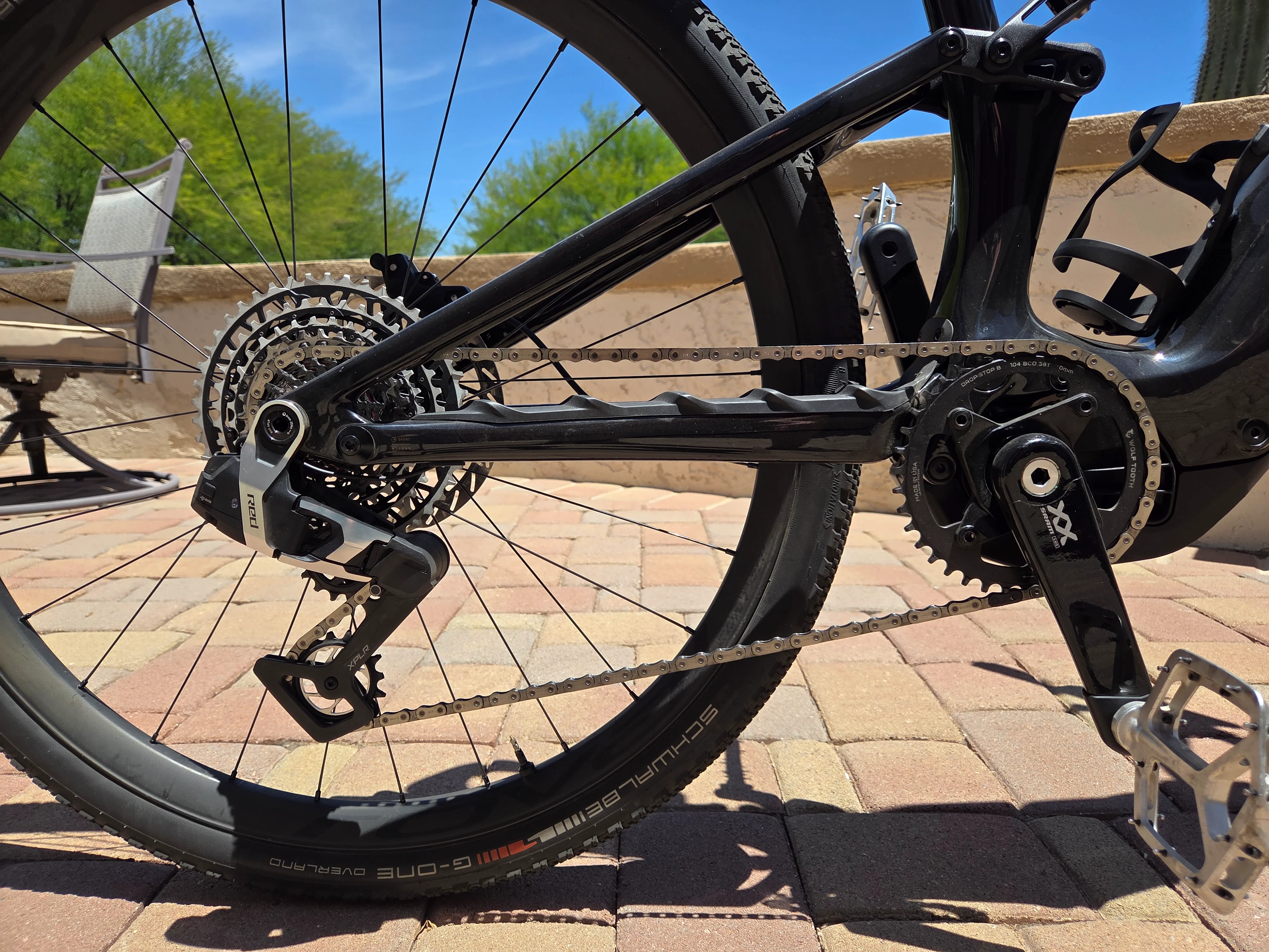

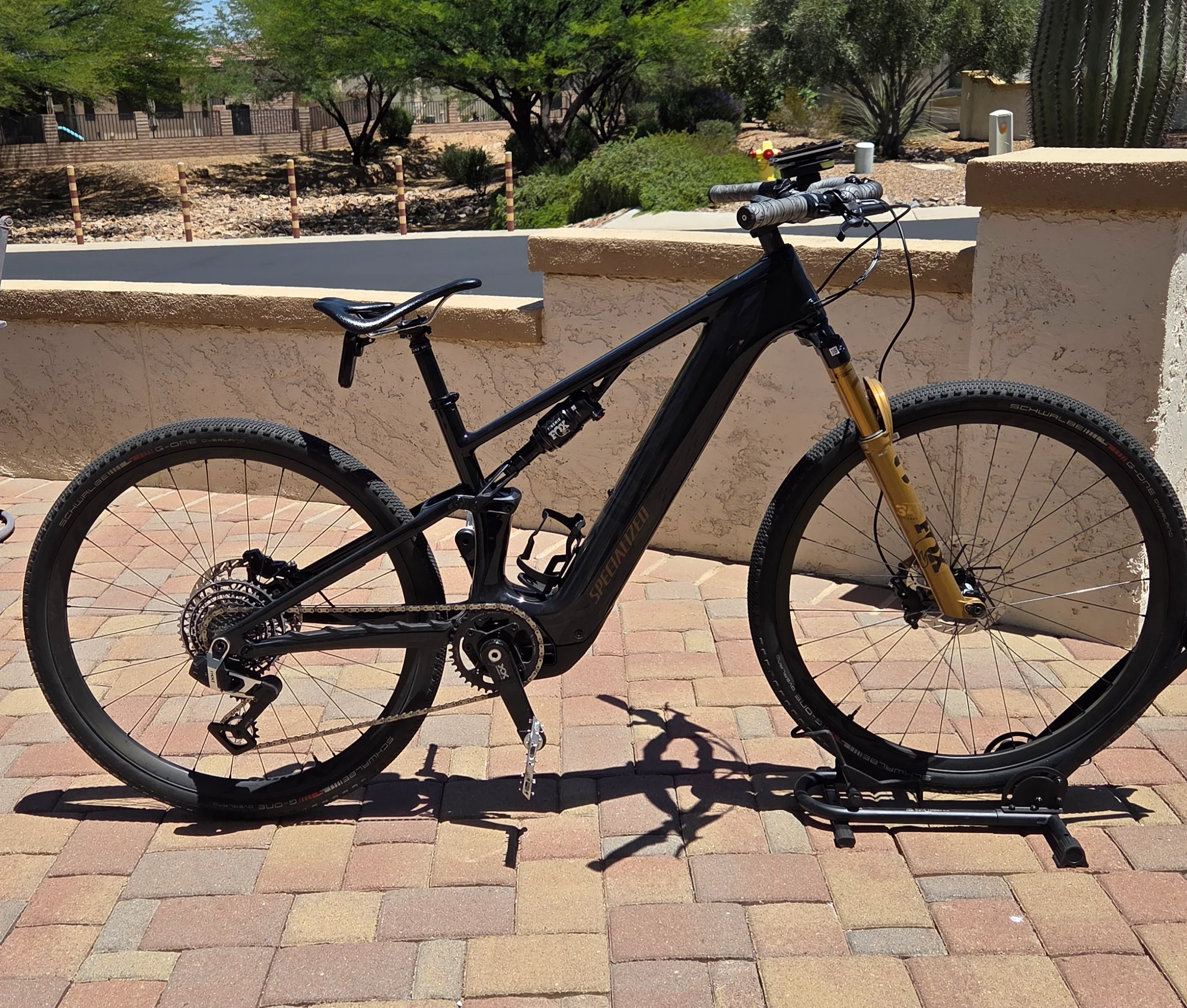

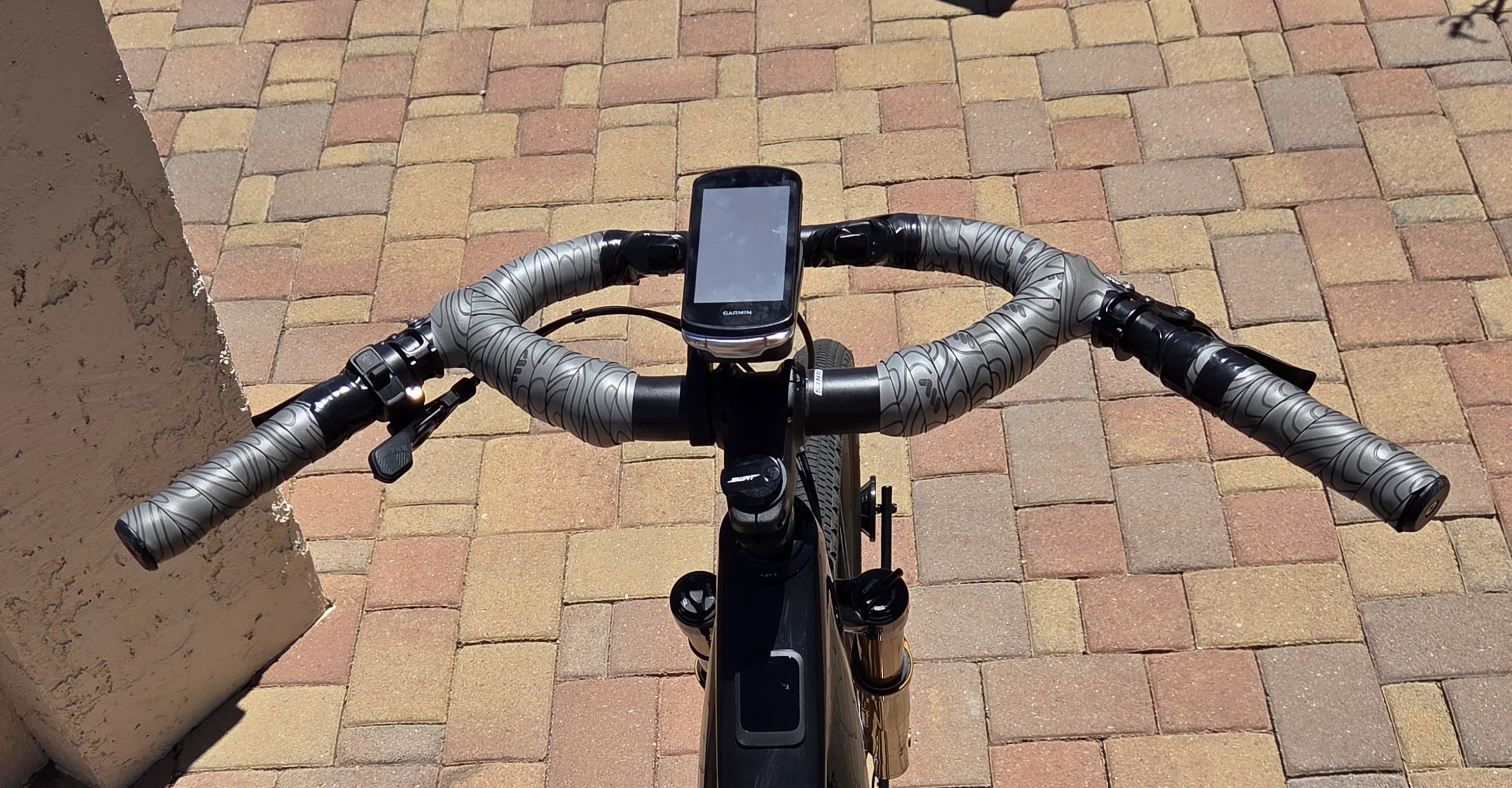

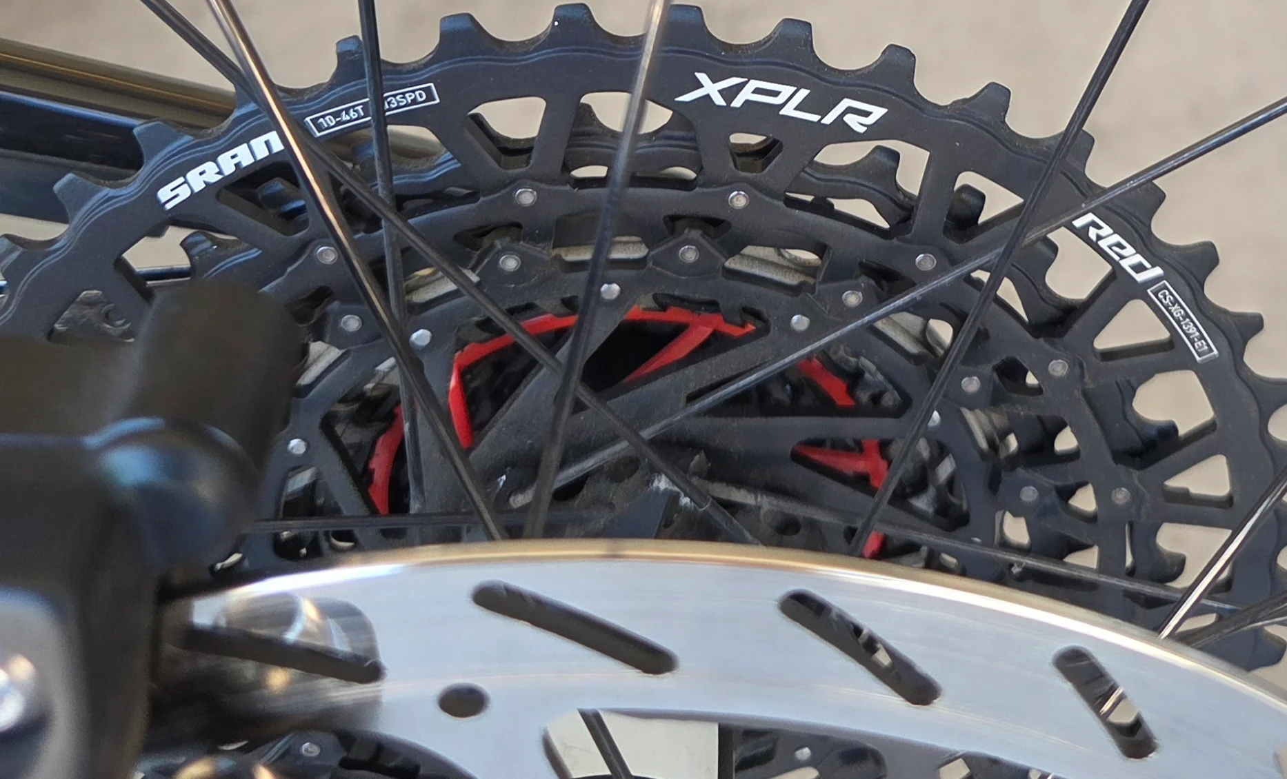

My bike is modified for gravel and rails to trails riding. I run Schwalbe G One Overland 50mm tires. I also have an XPLR transmission. Tighter gear ratios and 13 speed 9 tooth top gear. Along with a 38T chain ring. Also, all of these tests are on the same paved road loop for consistency. I want to know what's most range for the settings I am comfortable peddling. These results aren't going to be typical for other uses.
I am using the stock 840W battery for all these range tests. I am also taking the battery down to 0% to 10% for these numbers as the battery usage is not linear. The first 20 to 25 miles gets what would be a 140-150 mile range, but the miles with sub 25% remaining battery can go as low as what would be 110.
I am in the process of trying the 0/0 TMU tuning I learned of from garethky's post cited above. Weather and real life has limited my riding this week, but the one ride I did get in looks very promising. I can tell this setting is giving me less assistance than all the rest I tried. Somehow, it is able to bypass the minimum assist that all the others had. Riding my Levo R now is very similar to my Levo SL. This is what I've been trying to achieve, the same level of assist as an SL but now with a much greater range.
Did you buy the Levo or Levo R? Please post a picture or two of your unusual gravel bike build. I assume you have unlocked the 28 mph etc
Levo R. Mentioned in both posts above. 🙃

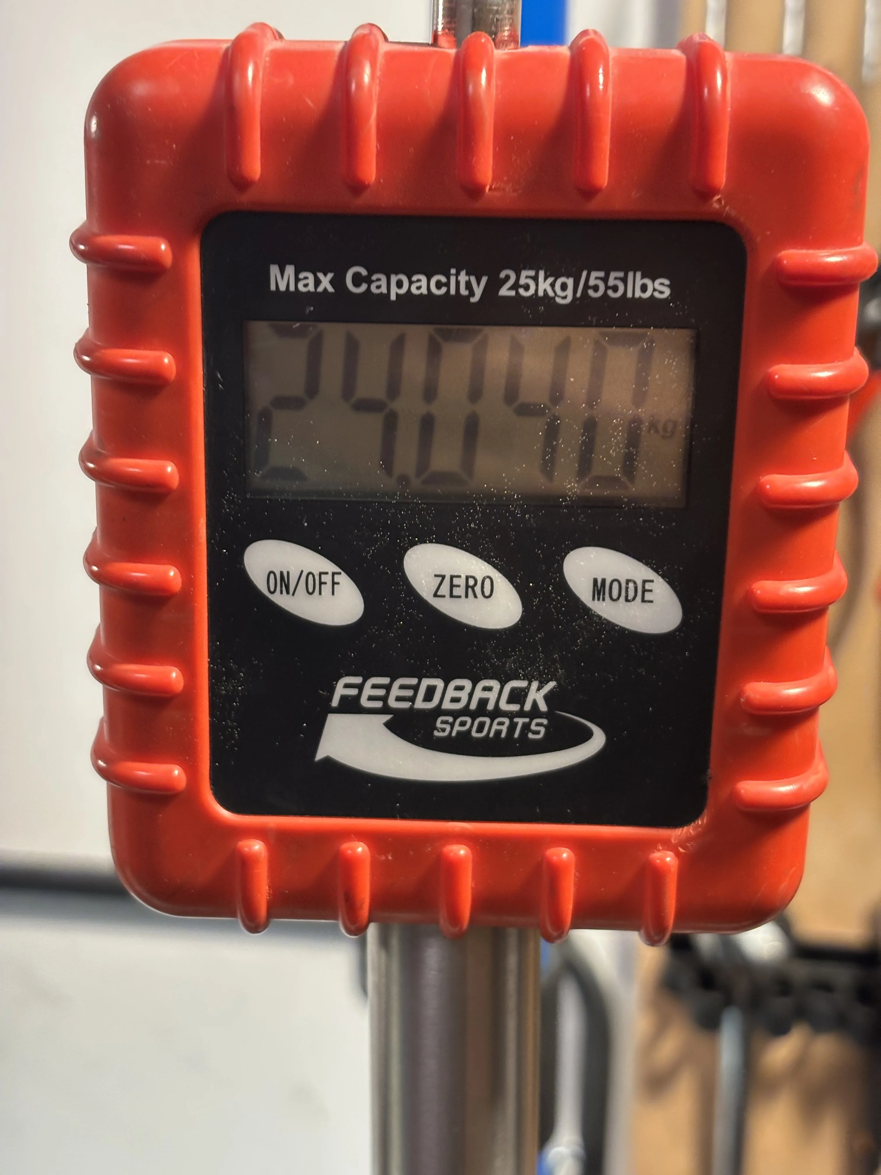

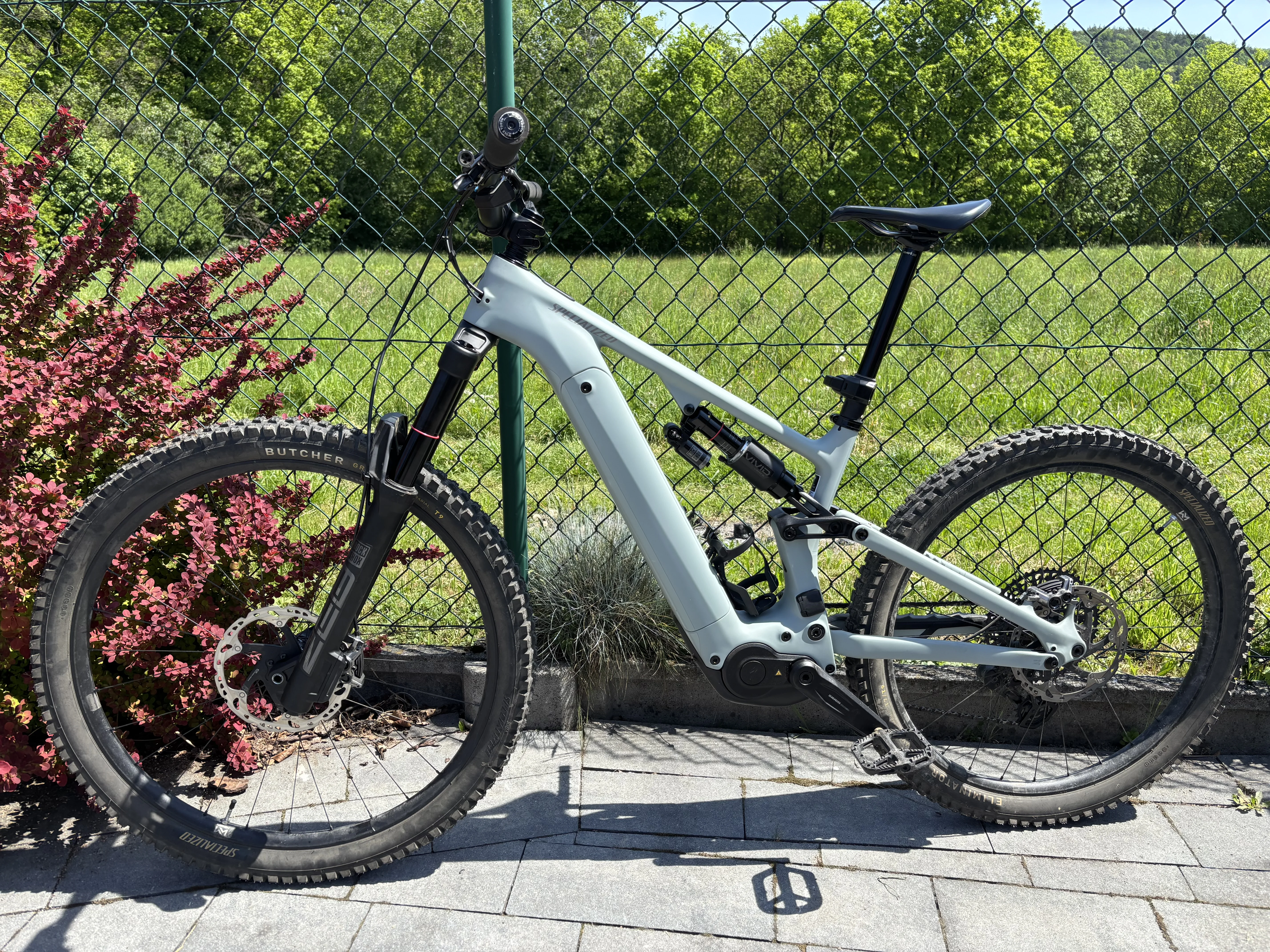

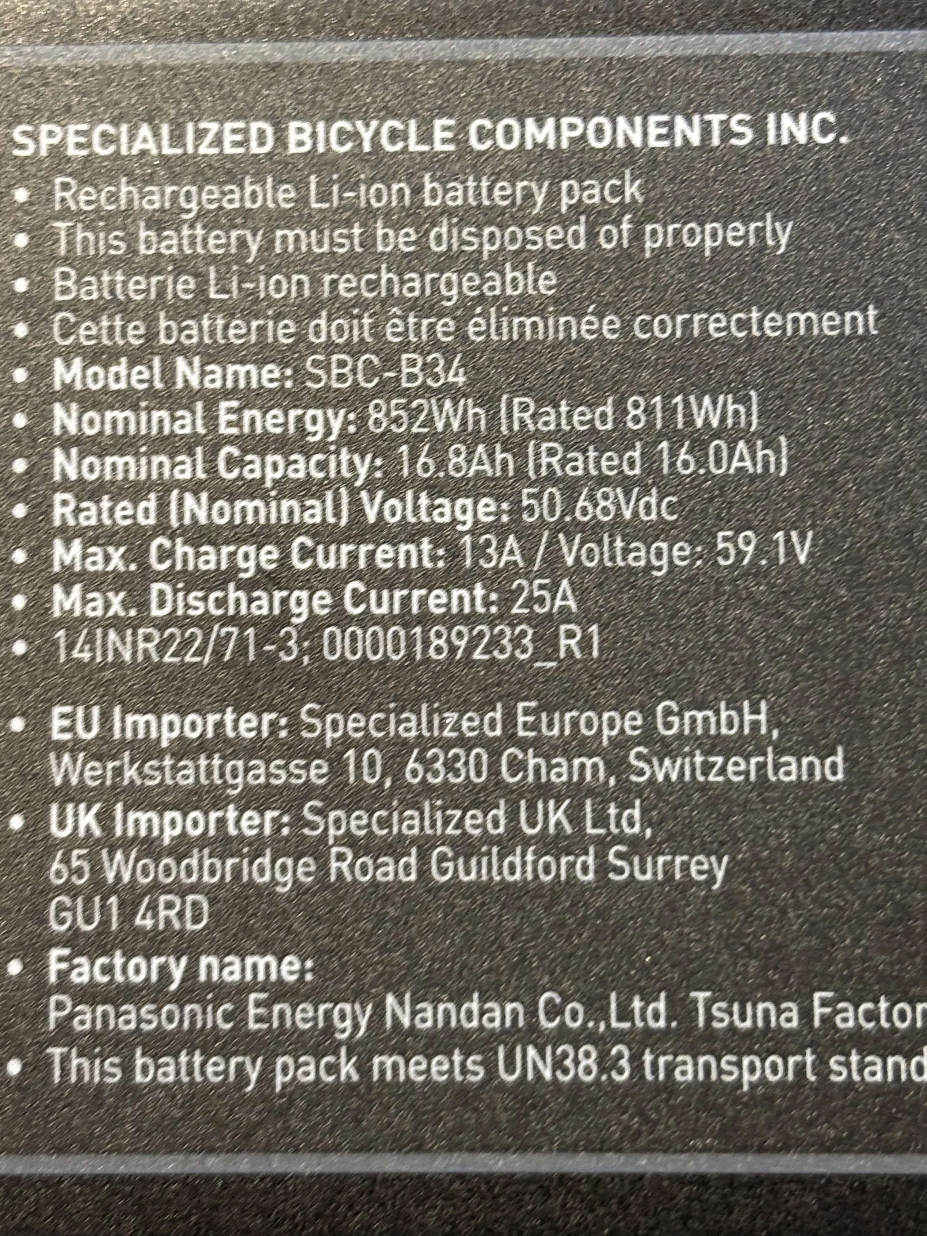

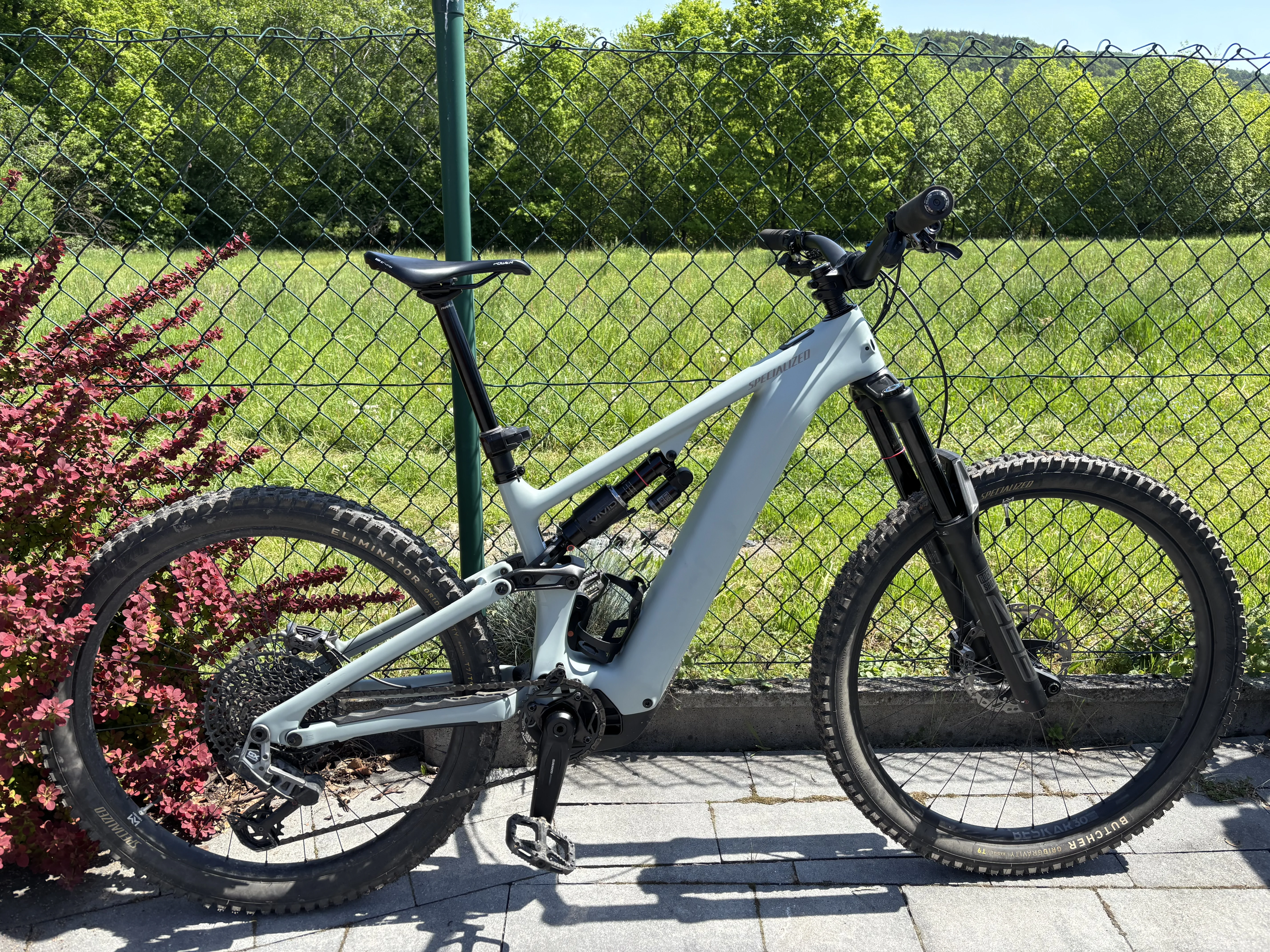

My Levo Evo comp, S3, agave grey. Ugly, fat, heavy, blah blah blah.
Came with 852Wh(!) battery made in Japan.
Moved all the stuff I had on my gen3: newman beskar wheels (aluminium), dropper post reverb AXS, XTR brakes, GX and OneUp stem/bar.
Weight is 24kg, with pedals and gravity tyres F/R.
Actually 0,5kg lighter than my gen 3 with 180F smashpot zeb/ 165R vivid coil.
Quiet, powerfull, definately more "jumpy" than coiled gen3.
