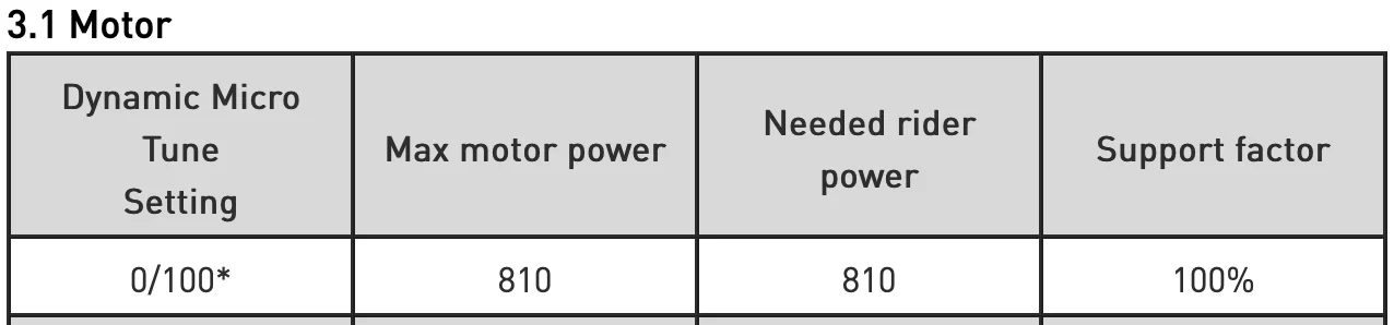

The Dynamic Micro Tune doc says 0/100 is 1:1 your watts to motor watts:

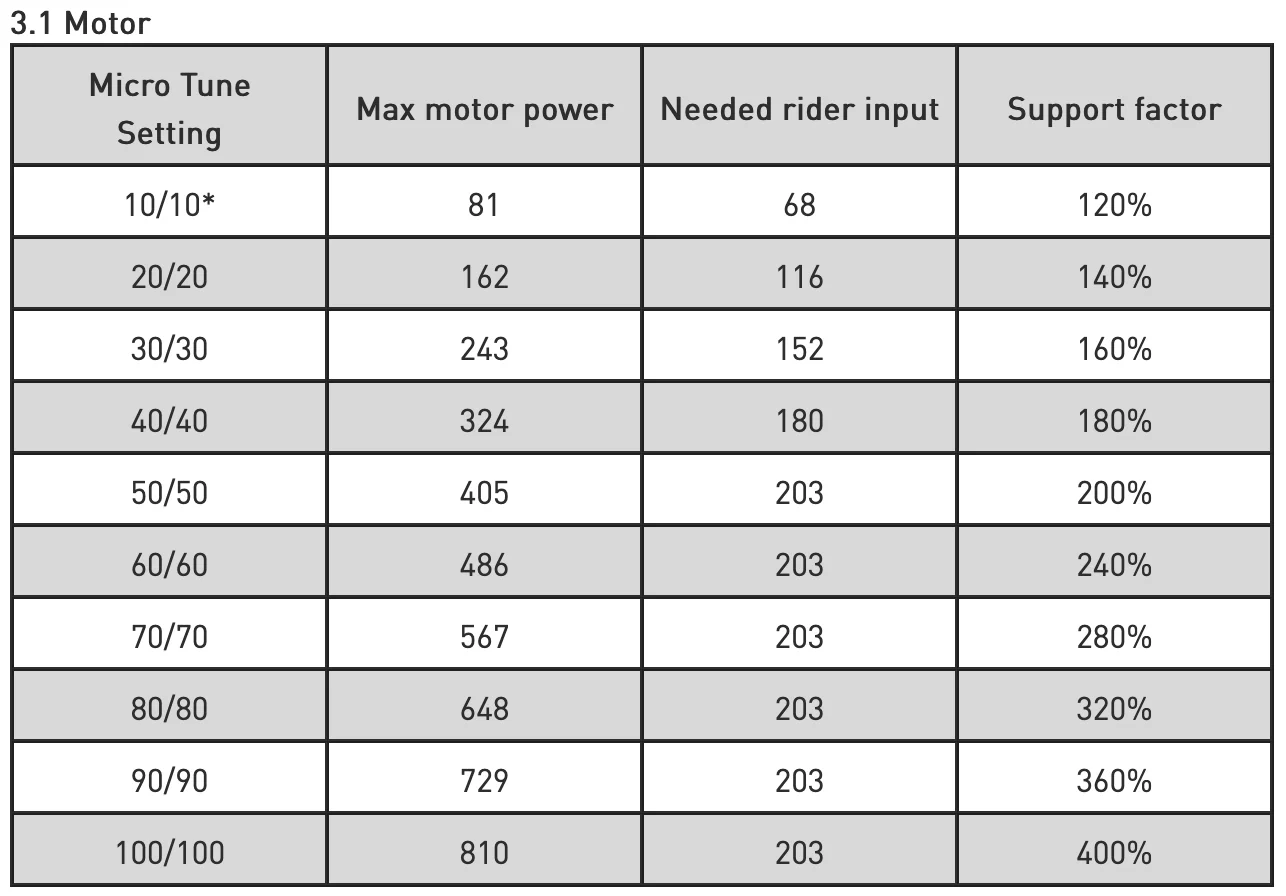

And the the Micro Tune table shows how many watts you get at each power level as "Max motor power":
But its missing the 0/0 entry. Which I *think* is about 60 watts of motor power at 60 watts of needed rider power. (my bike is an sworks, so its a bit higher)
The Bosch systems put out less than 100% of your watts in eco mode (I think its 60% in Eco in the Gen4). But the Levo cant do that with the current firmware. But 0/100 is as close as we can get to that.
