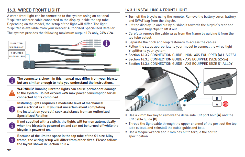

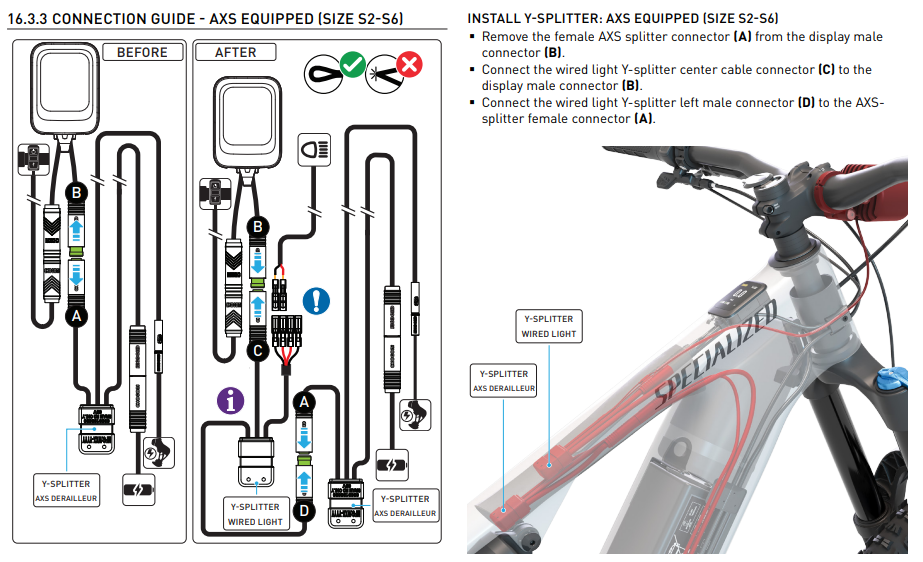

I saw an optional wiring loom for a front light so wouldn’t be at all surprised if someone made a light mount for the steerer tube that mounted to the front ports.
Yes, the Y piece is in the manual. But weirdly no optional mounts, guess they're working on standard bar mounts being used.

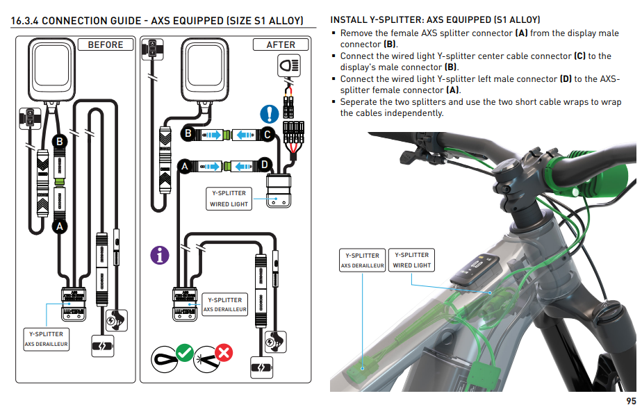

Interesting that due to space the install is different for S1 :

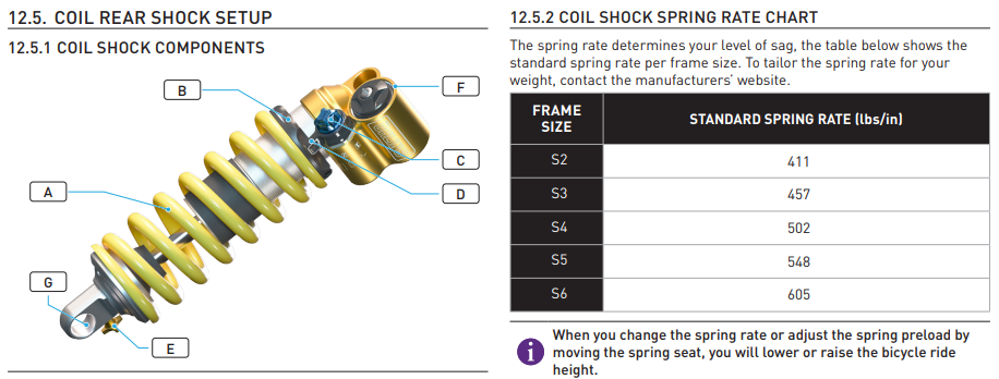

Not that m planning to get the G4 (but I really want to 😩) at least I know my vivid coil will fit 🤔
