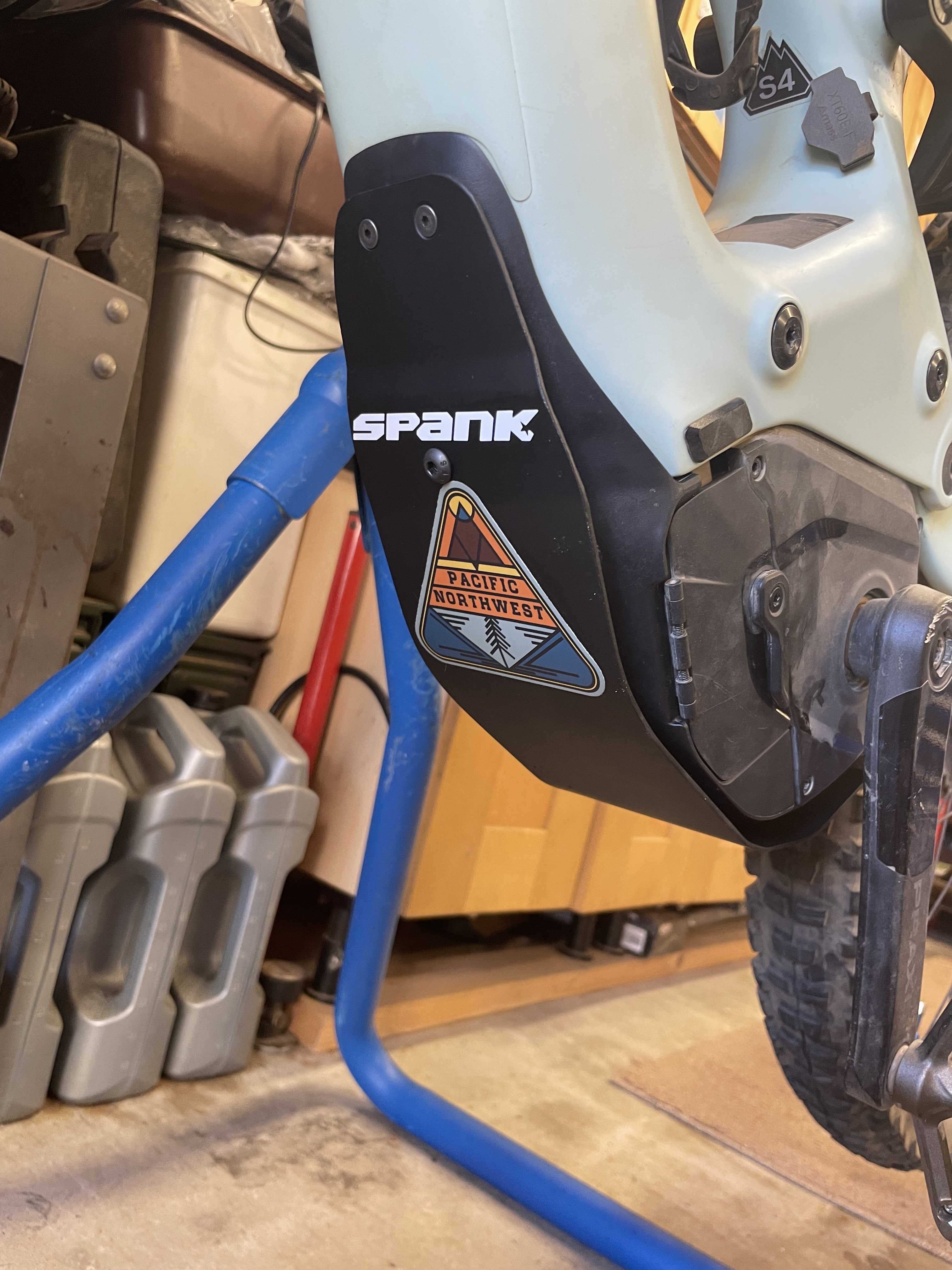

Has anyone who is riding their Gen 4 cased (motocross bike term) their motor over steep drops? I have a few times now, hopefully it's not going to damage anything. I hope a lightweight skid plate comes out for them.
The motor hangs out farther in front of the cranks then the Gen3. I have never cased my Gen 3 in the whole time I have been riding it.

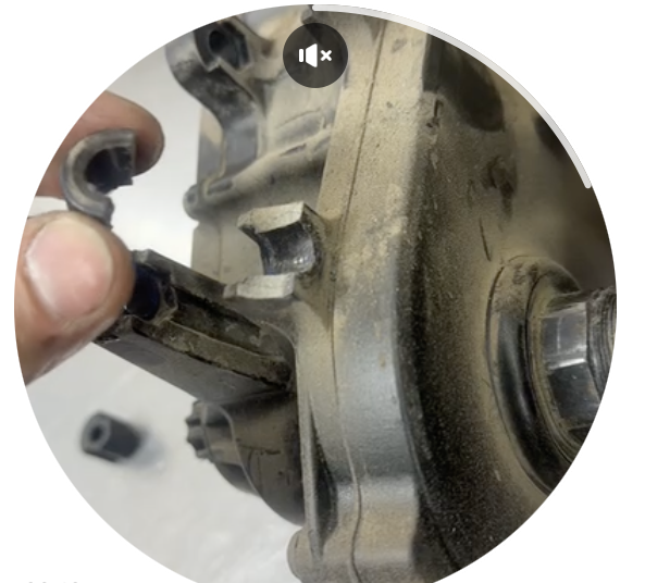

I cased mine gen3 few times and probably landed on flat to many times, the motor is fine, but one of bolt mounts failed. Might not be your case but probably should inspect for cracks on mounts if you casing too much.
When it finally cracks into two pieces there would be cricking noise when pressure is applied on cranks.

Yeah my Gen 3 battery can be removed by removing 1 bolt and about 2 minutes.
Actually that is a lie, as I fabbed up a metal skid plate that mounts to the plastic motor housing/battery cover so I have to remove that first (4) screws, and then the main battery mount bolt.
Still take two minutes to do.
