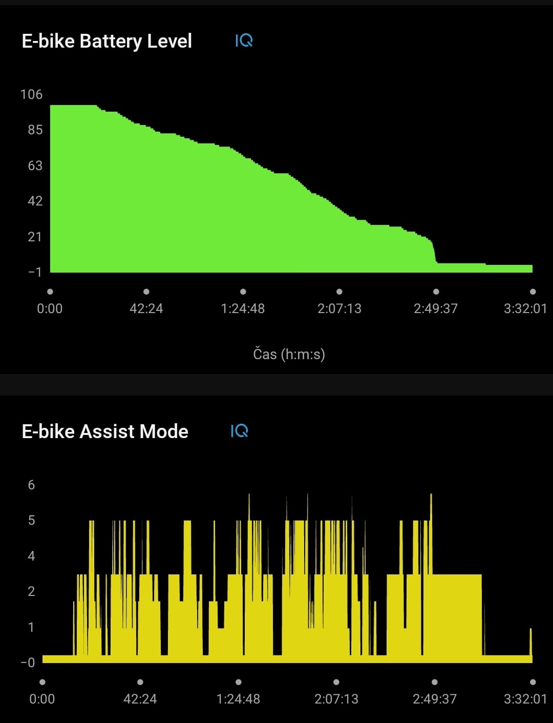

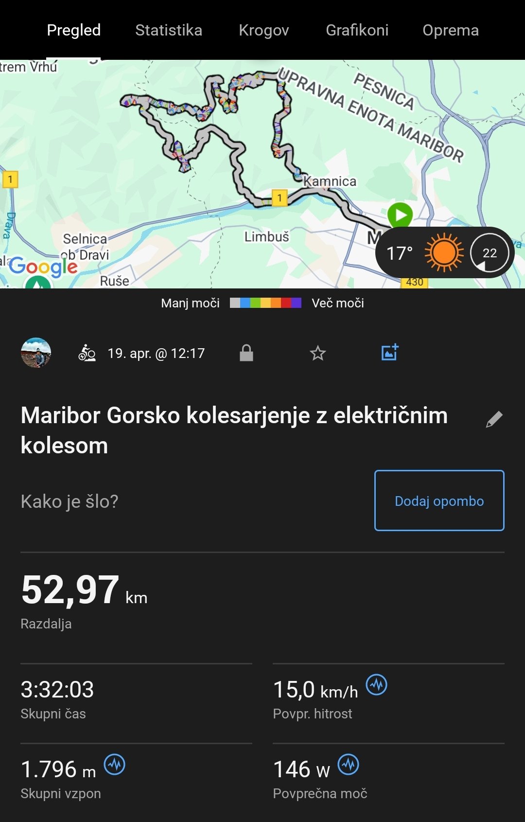

WOW Looks like Shuttle + Auto burn an insane amount of energy.
With your weight(175) this is one of the worst battery consumption result I have ever seen. It is cca 62Wh per 100m altitude gain, compared to others in Turbo, Bosch CX cca 42Wh, Giant cca 48Wh, Avinox in Boost 70+Wh.

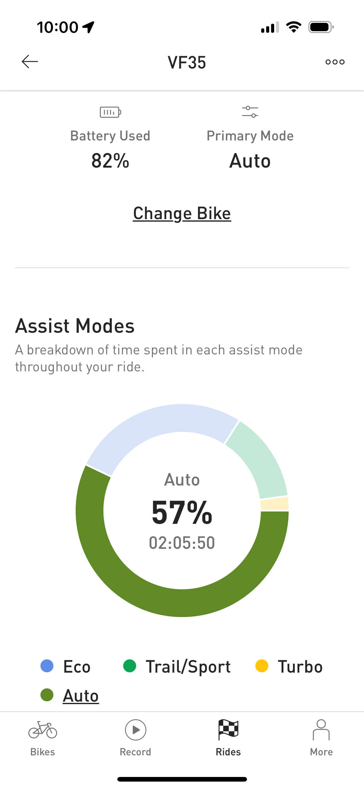

no shuttle and i think the range is fine. your calc is not taking into account distance.

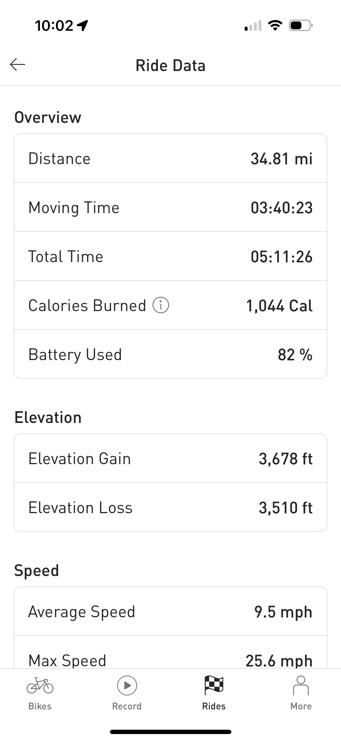

Really, I think you are kidding yourself about it, this is one of my last rides, pretty comparable by distance 53km(33mil) and average speed 15kph(9,3mph) and similar assist settings(fyi 4 is the level of Auto on my ebike), although the altitude gain 1796m(5892ft) is a huge difference.
Mine has an 800Wh battery, finished the ride with 4% remaining, 200lb+ ride ready, 26,5kg Reign E+, the average consumption was cca 44Wh per 100m climb.
If we take into account that you are 15lb lighter and the motor has cca 15Nm more that should even things out just a bit, but even then 63Wh/100m vs 44Wh/100m with only 15Nm more is massive.
Sorry but to this kind of consumption is not acceptable, I am really interested if all Levos will have such high consumption. My suspicion is on the Auto mode, as said would love to see Trail mode on the same ride.Screenshot_20250427_140611_Connect.jpgScreenshot_20250427_140717_Connect.jpg
