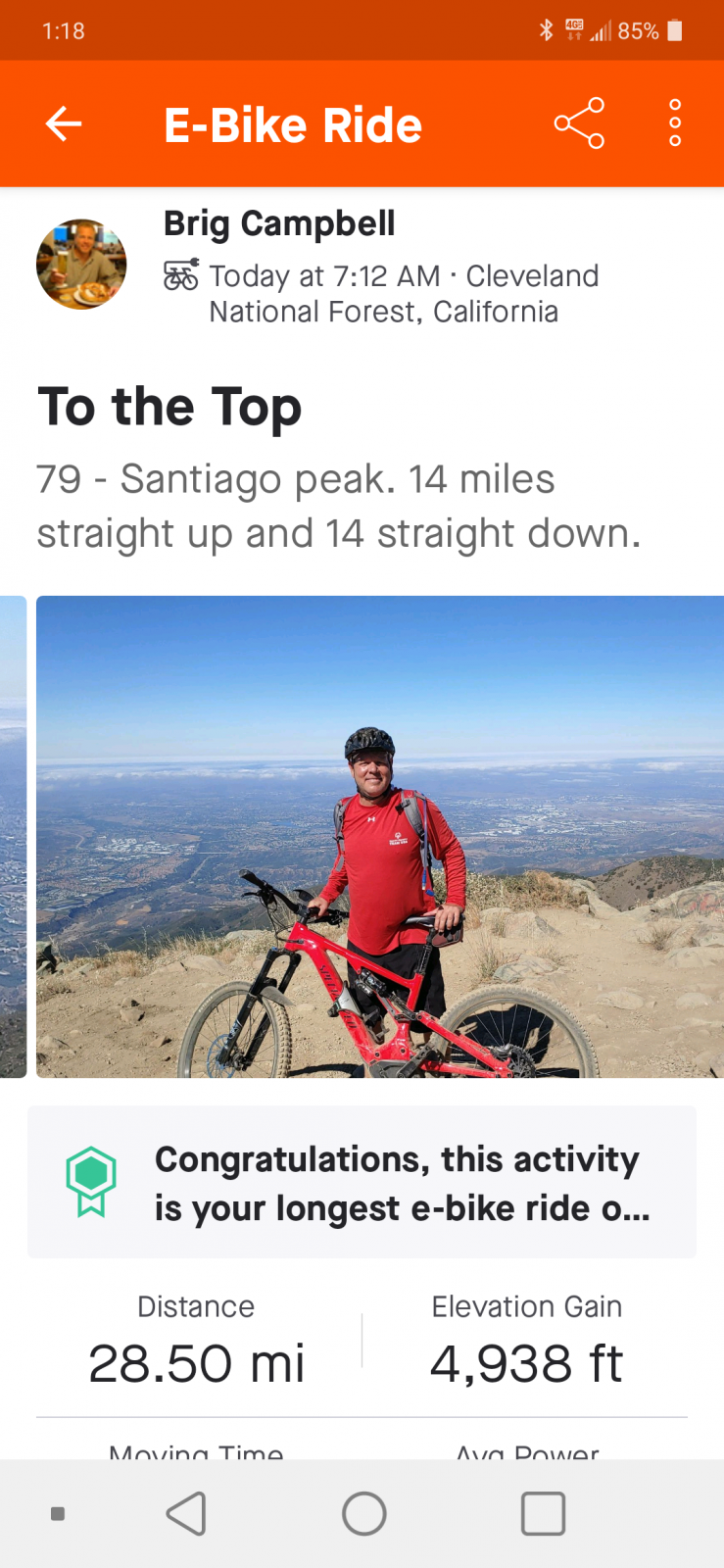

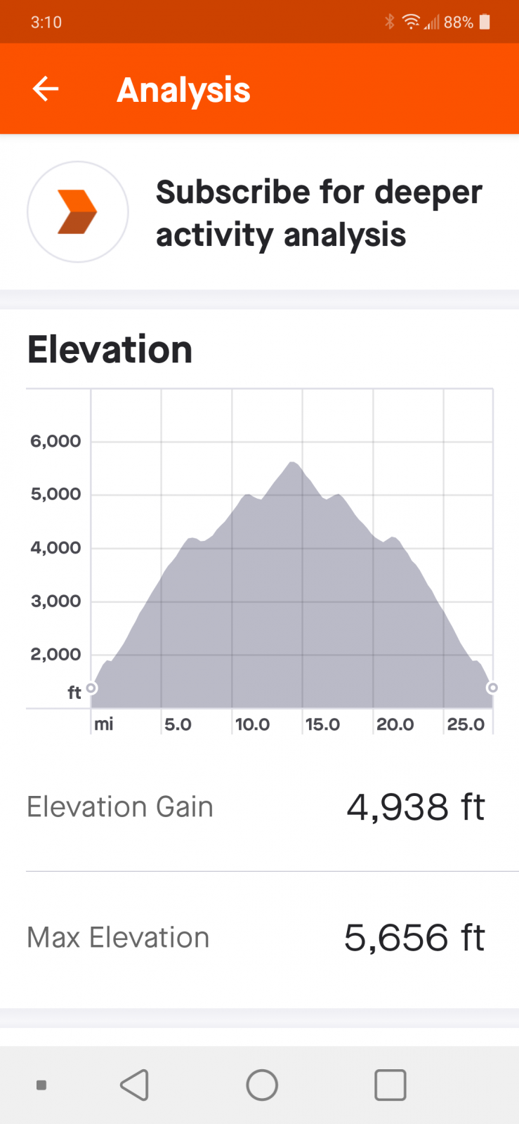

Battery range test for 2022 comp alloy with 700 battery. Used 79% running almost exclusively in ECO at 35
Check out my activity on Strava: https://strava.app.link/inzb43u7mrb
