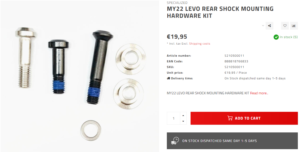

I had to order from Specialized for a coil shock I want to run.
looks like 2 aluminum top hats that according to manual need to be fixed with a green loctite, but are not bushings in the conventional sense.

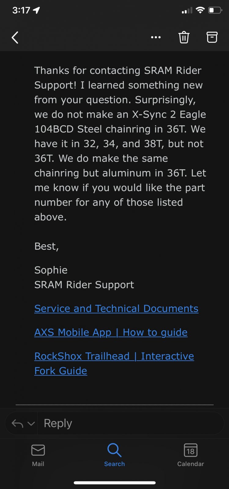

Anyone know the part number or replacement for the 32T front chain ring ? The spesh web site is saying its steel but every site is only selling alu
Alloy comp gen 3
I was after a steel 36 tooth SRAM XSYNC2 104BCD chainring and had emailed SRAM. They confirmed the steel ring is available in 32t 34t and 38t (not 36t). I can’t find the part number for the 32t online, but email SRAM from their website and they respond in a day.
If you are replacing the ring, you may consider going up to a 34t for better gearing on the Levo. You can use your same existing chain. On my Levo Expert, I went from the stock 34t steel ring to a 36t aluminum ring. Much better gearing.
