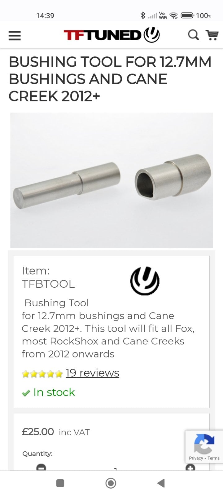

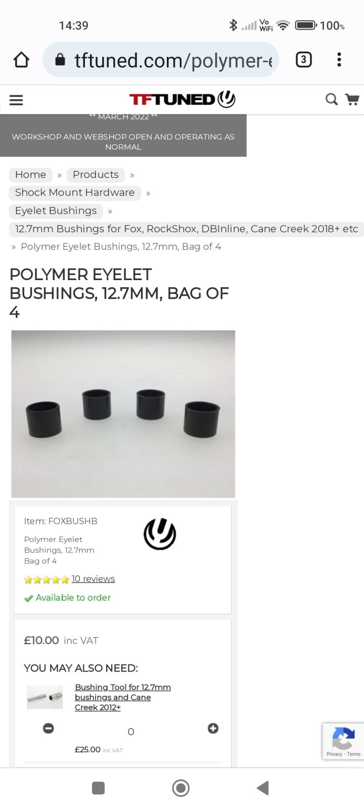

I've just fitted a Ohlins to my 22 Pro , all I had to buy was bushings and the tool for the lower eyelet the top mount I used the fittings from my X2 ,
I ordered 12.7mm polymer bushings and the tool to go with it , makes life easier and a clean installation 👍
Hope this helps
Regards Stuart
Thanks for your help.
Yep, the lower mount that goes into the yoke is easy to swap out.
Would you mind posting a link to the bushing & tool?
Hi , can't seem to copy the links so here's a couple of screenshots, both items from TF T uned
