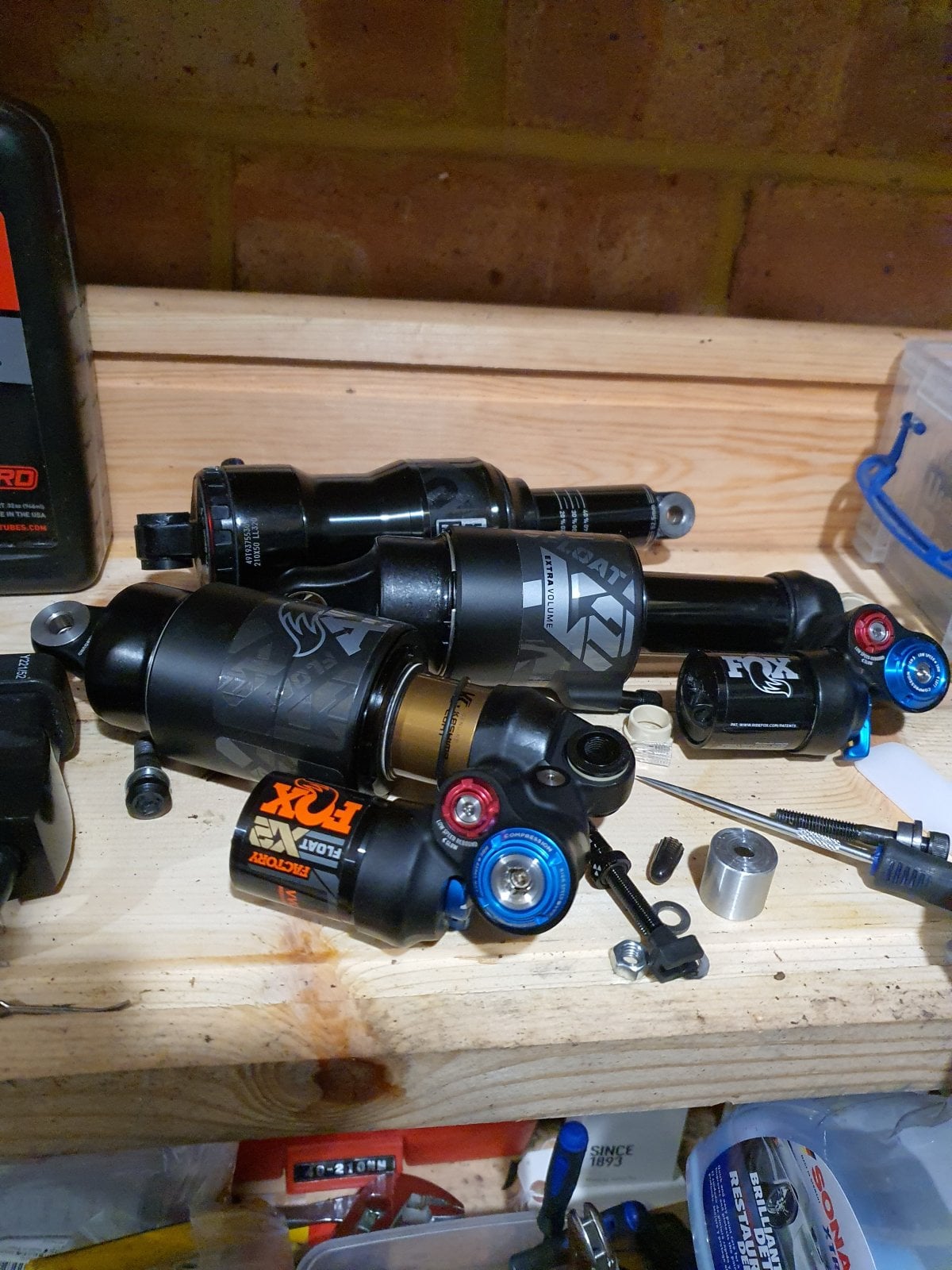

Still making the knock thing through the frame. I'm convinced that's what's been knocking for 3x months
Like Rob said maybe capitulated (fecked)
The super deluxe was great this weekend no knocks or anything. I even lost air in it and the bike still felt great other than the bottom outs (the tokens hit the air valve and I forgot the air cap haha). Most composed I've felt on the bike so far

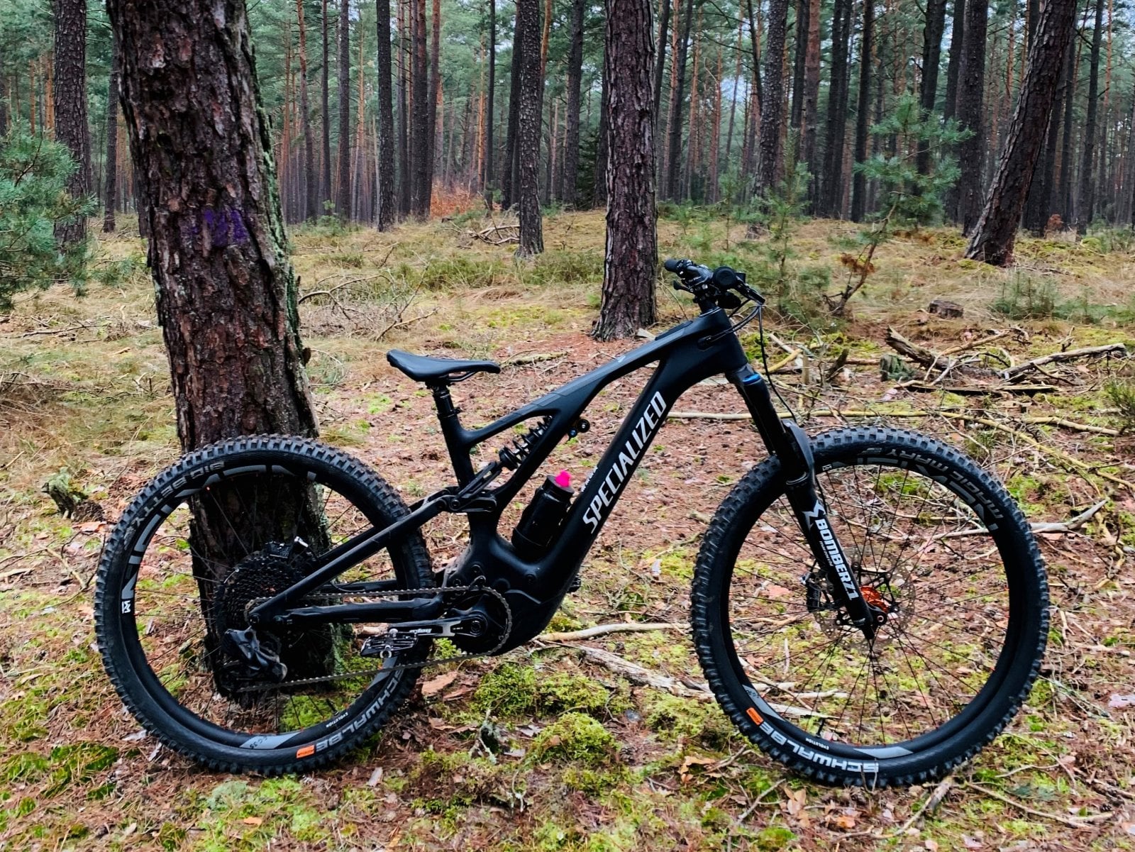

Hello everybody,
after destroying the Frame of my TurboLevo Gen2 in the Summer of 2021 i finally got my new Toy!
I proudly present my new Custom Bike Park Turbo Levo Gen3...
Specials:
FORK: CUSTOM Marzocchi Z1 Coil 170mm with a 2022 Grip2 Damper -> FOXZOCCHI Z1 GRIP 2 COIL
SHOCK: 210x55mm Öhlins TTX 22M with EIBACH SPRING 450lbs (Rider Weight 82kg)
WHEELSET: CUSTOM Industry Nine Hydra Hubs on NEWMEN EG 30 & 35 RIMS with Schwalbe 2.6 TIRES
DRIVETRAIN: AXS GX EAGLE
BRAKES: Hope V4 200m Rotor on the rear and Hope E4 with 230mm Rotor on the front
plus this and that, all from Hope...
This Bikes should suit my Riding Style which is pretty aggressive with a lot of Park Riding and rough Trails all across the Alps from Bavaria Germany to Finale Ligure Italy!
But i need some help with my Suspension Setup from you Guys, because i don´t feel 100% comfortable right now on the Bike!
FORK: First Time Coil Fork (feels super plush and runs to fast threw the Travel, but Spring Rate FIRM should actually fit)
-> so which Setup on the Grip 2 do you run on your Levos for aggressive Riding?
-> does anybody have some Experience on this Z1 Coil Fork with Grip 2 Damper?
SHOCK: Because of the Bikes Progression i changed the Coil Spring from a 550lbs to a 450lbs Spring and it feels awesome and super comfortable, but i´m afraid that it will punch trough on hard landings, so i nearly closed all my settings on the Shock to
0 Rebound, 0 LSC and 1HSC
-> does anybody have some advice for me or my settings on this Bike vs. the Levo Gen 2?
THX for having me here and THX for your Help.
Greets Dominik

Hello everybody,
Specials:
Greets Dominik
Dude that is a sweet looking bike! How you aren’t blowing through the rear travel on such a light spring at 82kg is beyond me though. The Levo had a high leverage ratio to start with and isn’t massively progressive. I’d expect to be running a much higher spring rate, more like 650lbs! Then you’d be able to open up the damping. Riding with all the adjusters closed isn’t good for the shock or the ride. It shows that the base tube is miles off for the rider. You’d be much better running the right weight spring and adjusting the damping to suit. Even better would be getting the shock custom tuned for you and a recommendation of the correct spring weight by a specialist suspension company. Here in the UK I have used J-Tech Suspension and TF Tuned extensively and only had have positive things to say about them. Either company would be able to tune the shock to your requirements and it would transform the ride. It must feel harsh and under sprung at the moment.
Same goes for the fork. Get it tuned by a reputable suspension specialist. You’ve paid a lot of money for the bike so why not get it to ride the best it could possibly be? It doesn’t cost much to get a fork and shock tuned and is one biggest and best changes you can make to a bike. For your weight and riding style (Bike Park) I’d expect to use a firm spring in the fork.
Edit: I wouldn’t buy the current Cascade Link for your bike, it’ll blow through the travel even faster. The new one, when it’s released, combined with a longer stroke shock would be an upgrade though. Of course your suspension will be beautifully tuned by then and won’t need it.. ;)
X2 factory back on tonight
You mean cavitated? :LOL:
Strange that you still have the knock with the Factory X2. Didn’t you have the same with the Performance Elite X2 as well? Maybe it is a characteristic of the shock. I’m not sure if mine (Performance Elite X2) does it or not now!:unsure: I’m away at the moment so can’t check . When I’m back home again I’ll confirm, or deny.
As suggested to @BikeParkLevo get your shock send off and tuned and it will make a massive difference. It might even fix the knocking if there is something wrong internally with the shock. You have plenty of shocks to use in the meantime while your shock is away!
sorry yes
Both of them do it, the Factory more so.
Got some rockshox mounting hardware on the way to try first. then ill send it off for warranty (or just a service...)
Its a rotten shock to ride on currently just want to test the mounting gear out first to make sure it is royally screwed.
Seems transition owners also have problems with the X2. Same problem.

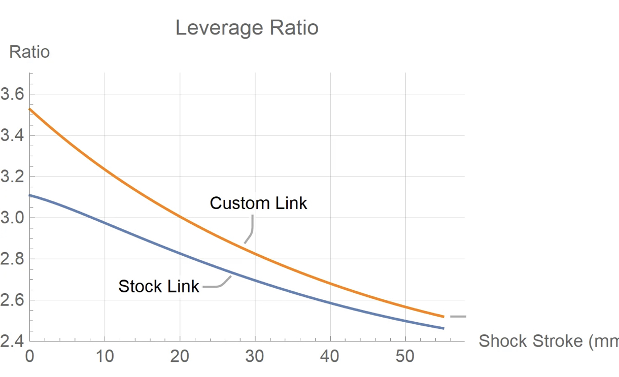

Why do you say, with Cascade link will blow through the travel even faster? Its more progressive, then will be more difficult to blow through travel is it not? I think i can tune very well the suspension of my Levo, but 150mm going always be a bit little short in some trails. I cant wait to see this new combo from Cascade(Yoke+link+230x65 shock)! :D
It is more progressive but starts at a higher leverage ratio and ends at higher leverage ratio than the standard link which is already high given the short shock stroke. That’s why Cascade have a 90kg weight limit and don’t recommend coil shocks as you’d need a very high spring rate to prevent it blowing through the travel if you are anywhere near that weight limit.
The new link will hopefully drop the overall leverage ratio and that combined with the longer shock stroke will allow the use of coils with sensible spring rates and air shocks that don’t have to have a million psi in them if you are a larger gent.
Thanks for explanation! :D Lets see the final number for this new combo from Cascade...
