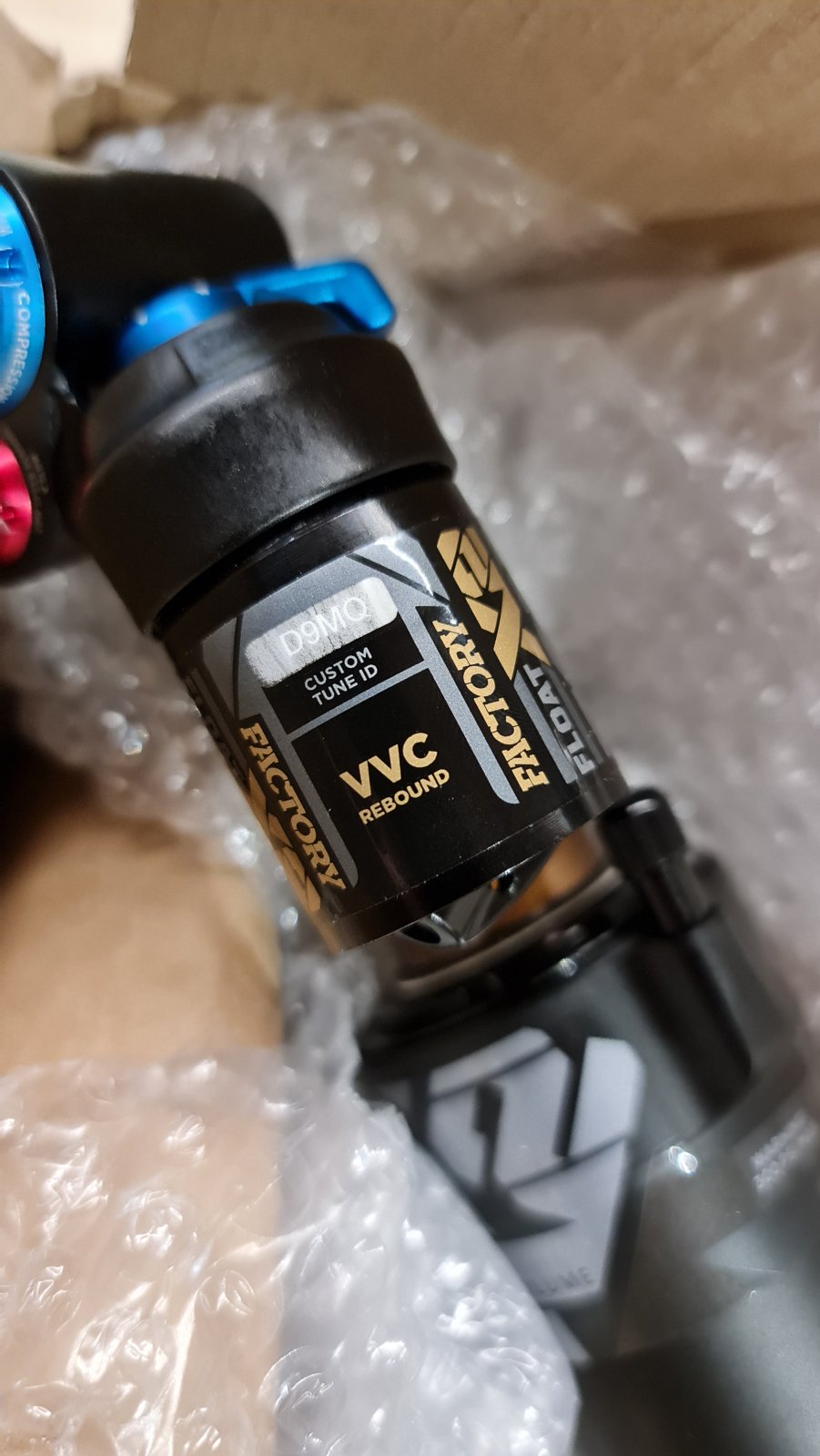

Just got my fox x2 from service. They have changed to vvc?
A question to the owners. Does Specialized mount any spacers in the Fox X2 out of factory. And if yes how many?

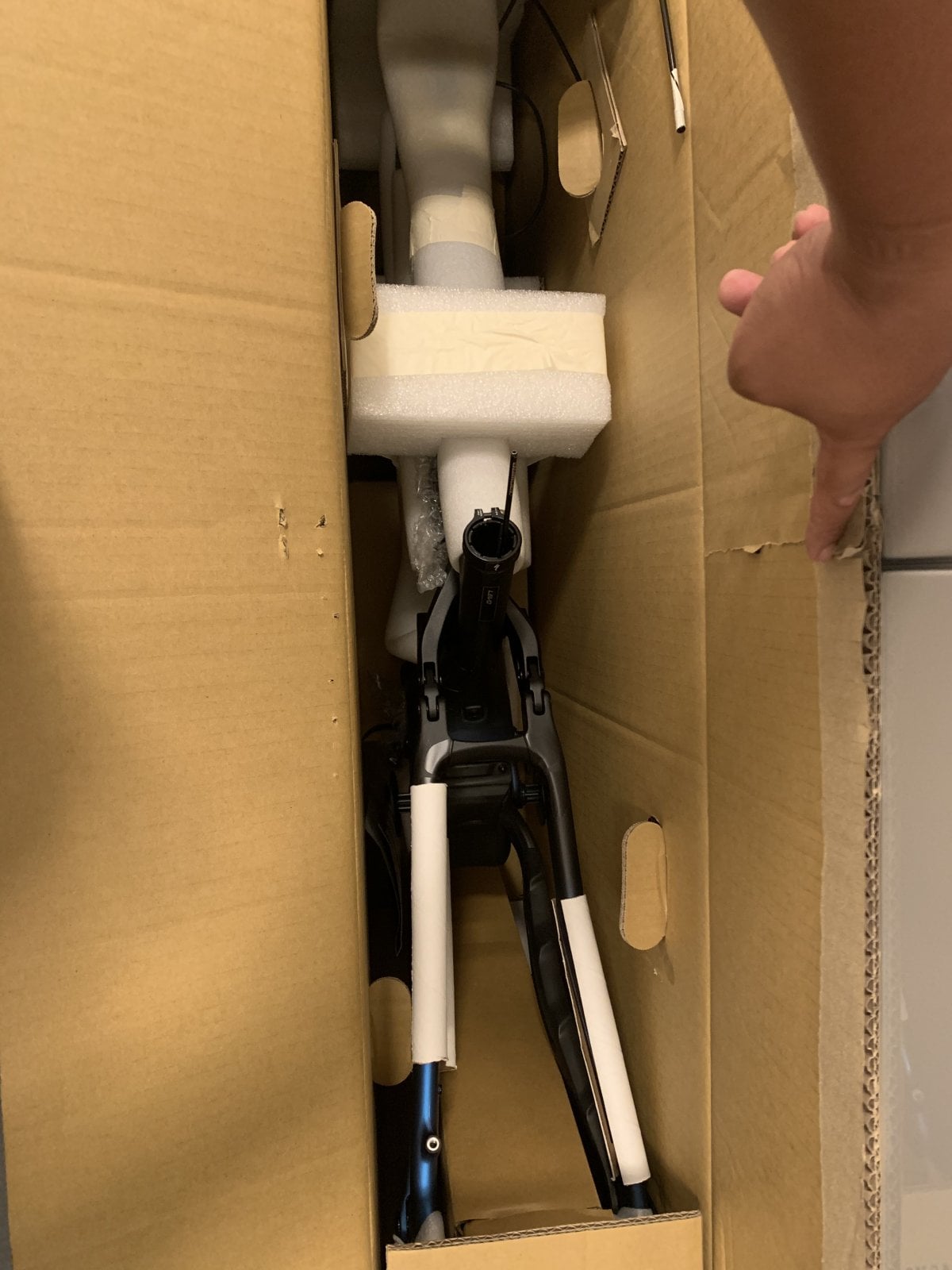

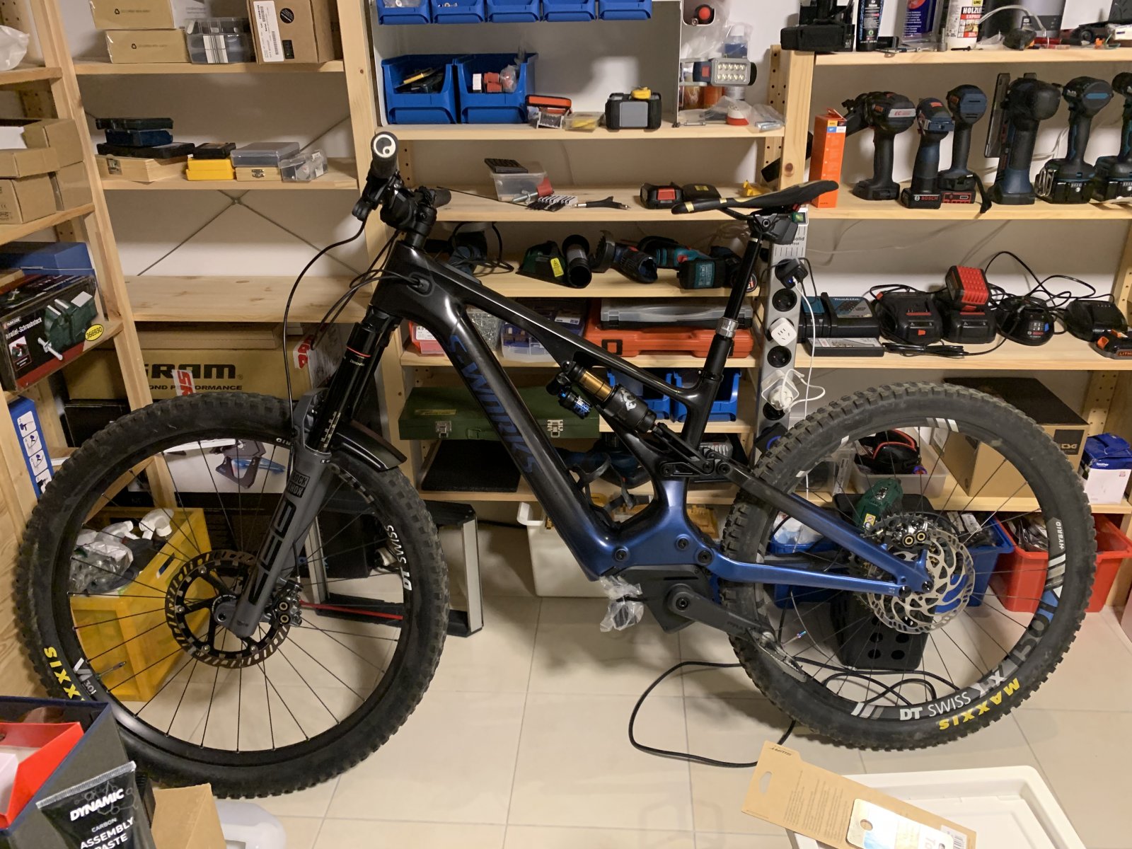

Picked up my SW frameset tonight, surprisingly there is no battery inside! On the package label it shows 9.2kg net weight and 12.5kg gross weight, the battery should be in this package.
another guy who picked up 2 days ago just confirmed with he didn't get the battery as well.
local dealer has completely no idea why this happens since we are the first 2 who ordered the gen3 frameset. All other gen3 completely bike they do all contains the battery in the frame.
Still took it home and wait for the dealer sort it out. Anyone else has same experience?
thanks!View attachment 69833View attachment 69835View attachment 69836
It is a bit odd but I have seen a few of the online German retailers selling SW frames without batteries at attractive prices, hopefully it is just a glitch in the Matrix! Now if they sold the white frame I would be all over it like..............

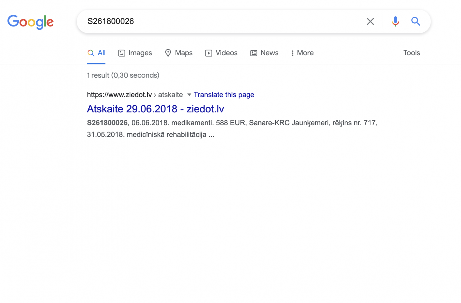

If anyone wants the PN for the door, I think it is:
S216800026
