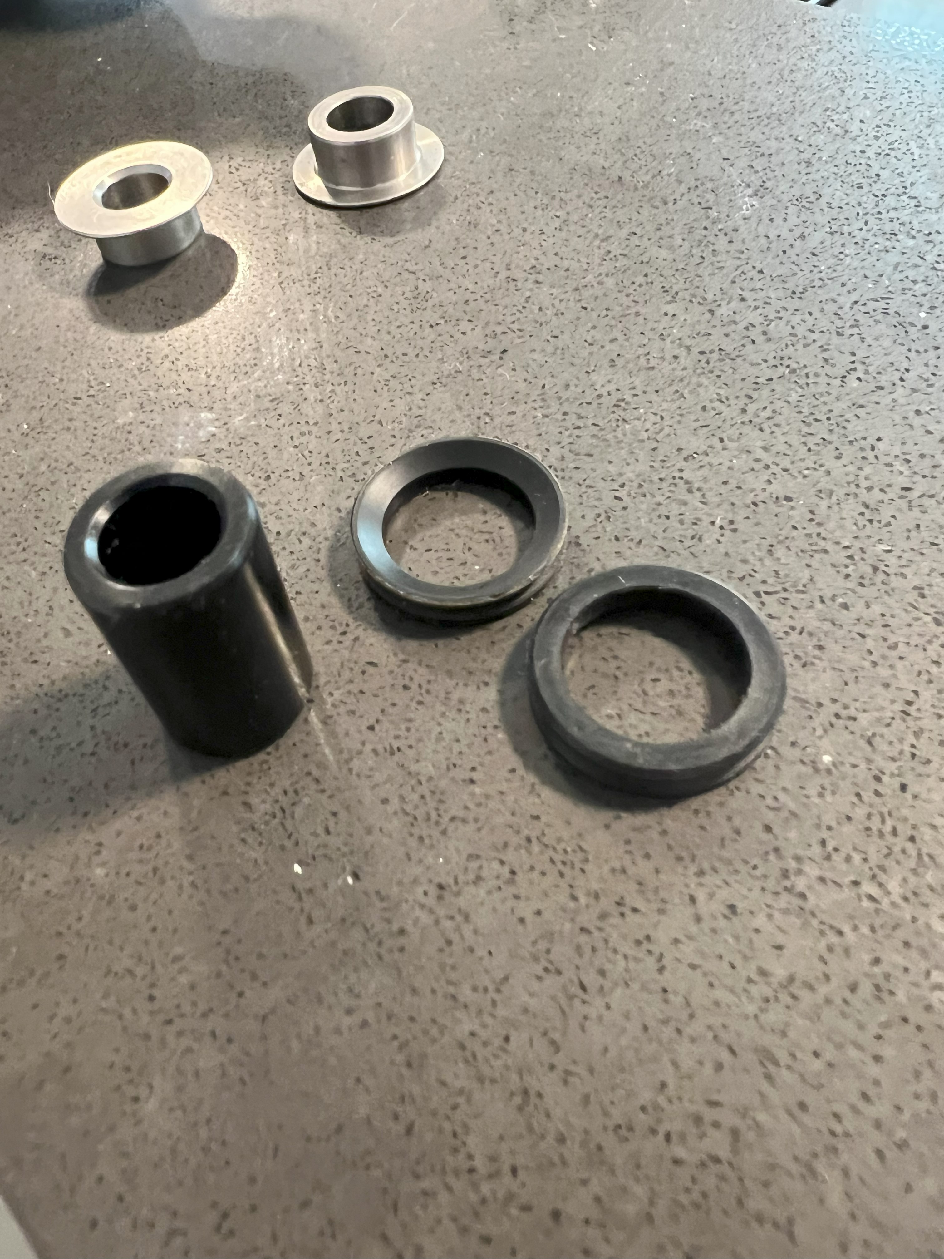

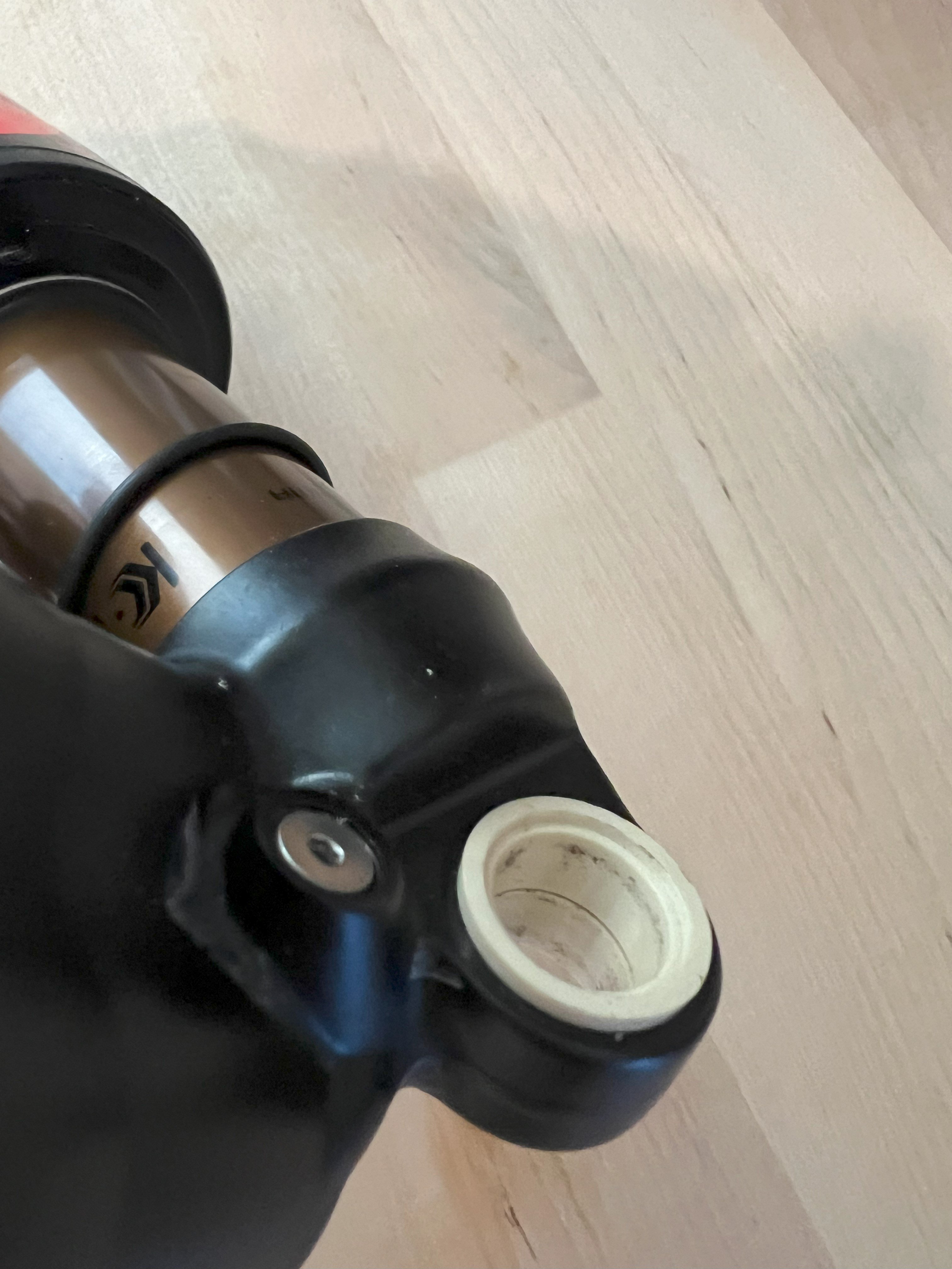

The RS bushings are not the same as what I will need for the Fox shock, maybe other people had different bushings (see second photo). The lower eye (one connected to the wishbone) of the stock RS shock has two silver metal bushings that protrude from eye like thin flat washers (probably 1mm thickness). My Fox shock (see first picture) has white plastic bushings in it that protrude out way futher than this 1mm, and if I pull those plastic bushings, the two metal bushings from the RS shock wouldn't seat correctly in the Fox eye (the Fox eye would be too large). On the top eye for the RS shock, there is a black metal sleeve with two black rubber bushings. Again, the white plastic bushings that protrude out but not far enough alone and too far if I put the black rubber bushings on. I'll just order the proper fox parts as I am not a fan of grinding and cutting parts or stacking bushings.

After you removed those 4 pieces (2nd pic) from the Rockshox shock you still have a thin silver bushing in each eye. Those have to be removed as well and moved to the Fox shock then the other 4 pieces will fit fine. Probably the same cost to bring to local shop and have them move the mounting parts over in a few minutes vs ordering new parts.
Ah, yes, I forgot about those. I have the tool to pull those so easy enough to do. Thanks

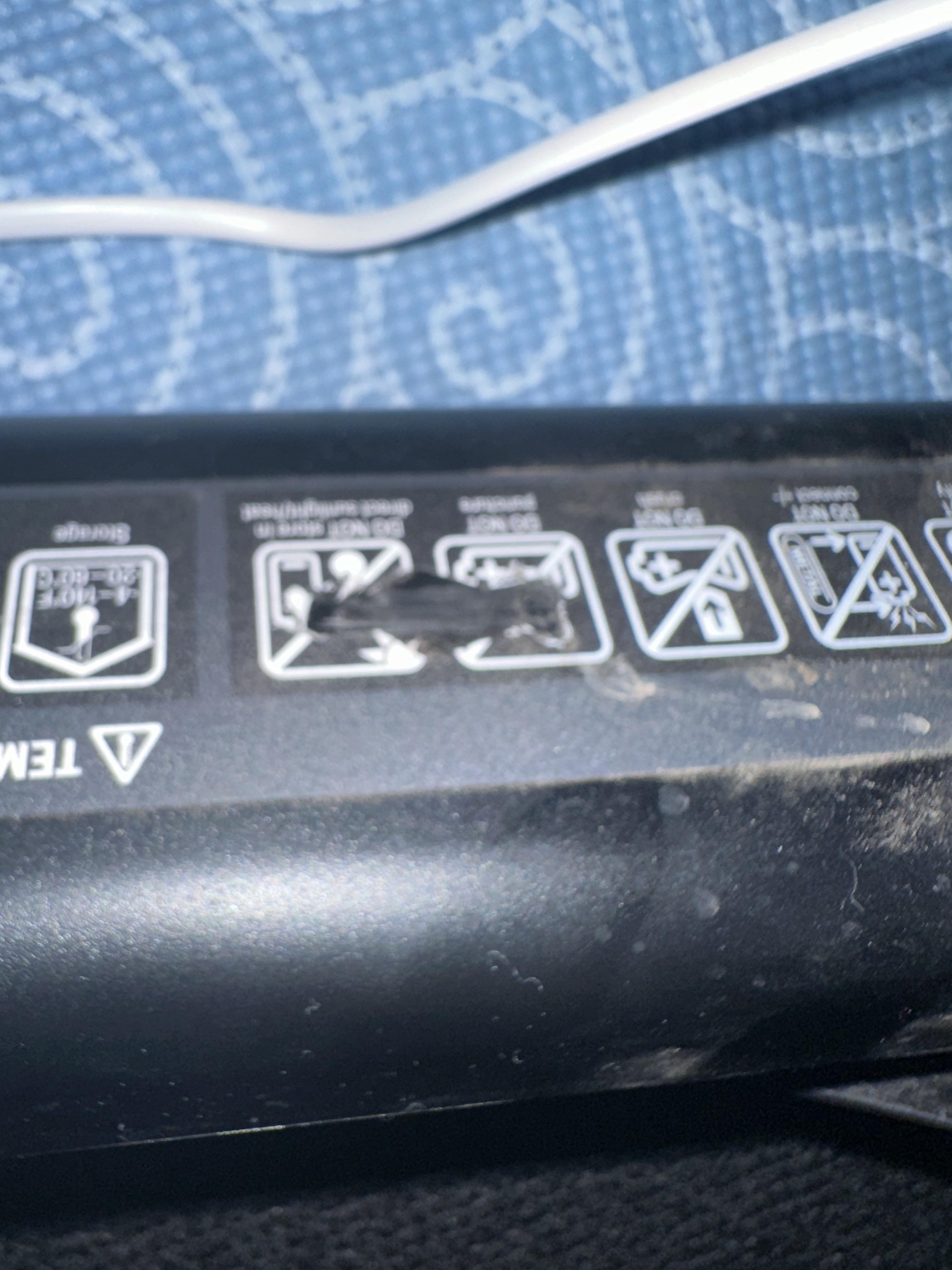

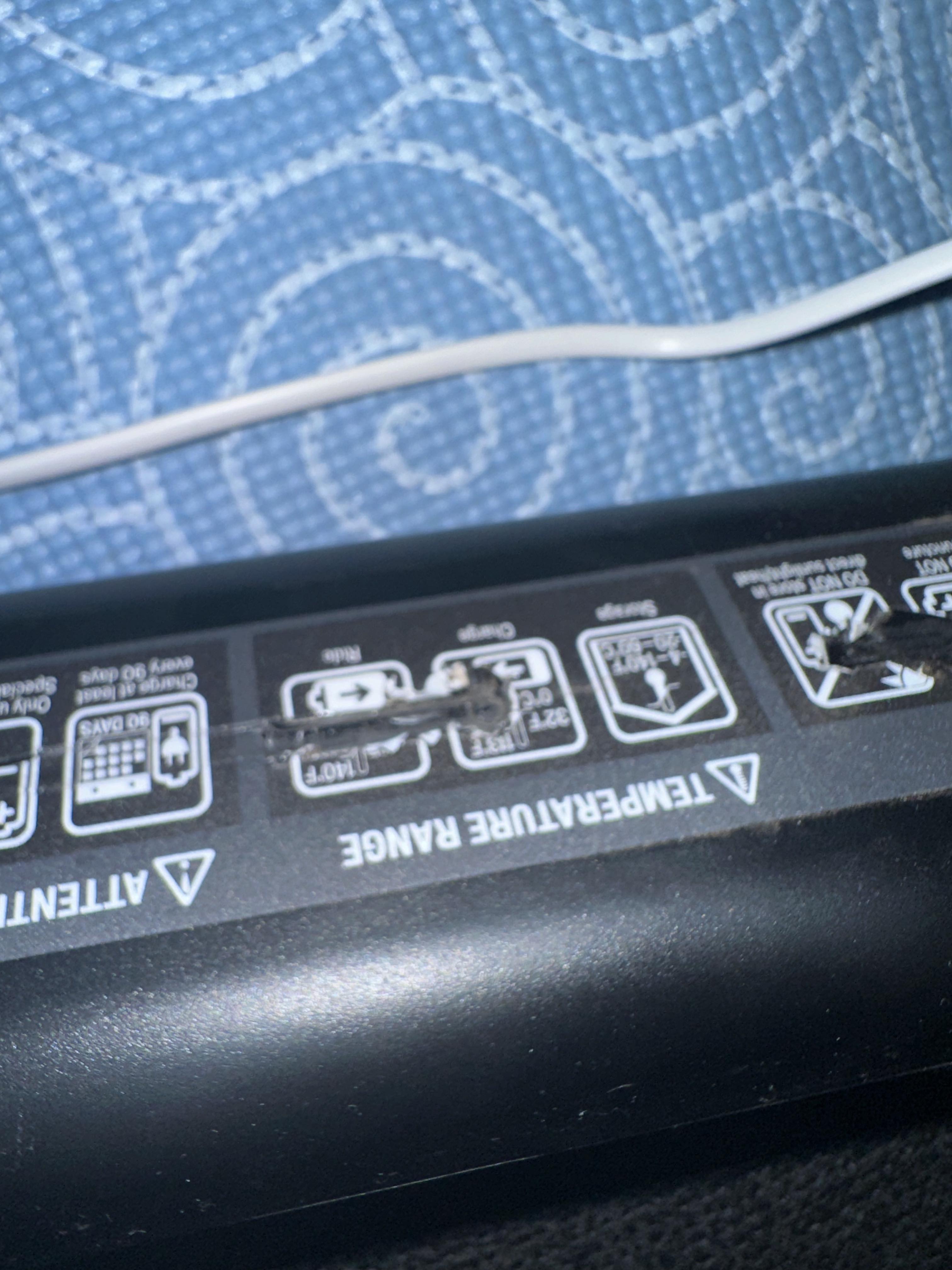

Removed the battery of my Levo for the first time since I had to take it indoors for charging (pretty cold outside lately) and noticed some scratches on it. Could this be from rubbing against the bottle cage bolts or something? Not the best pictures but it took the label and began etching the plastic casing (probably a mm or 2).
Should I be worried?405293329_731859082171844_4902595118510960077_n.jpg393177805_1372960240072019_4965680647240850191_n.jpg
I have the same scratches. If they are not too deep, then it is OK.
Did you replace your water bottle mount? Because I replaced it with a Fidlock mount which has a lower profile, and the screws go deeper into the frame. I used the shortest screws I found at home, but they could be even 1mm shorter. The ones that came with the mount were way too long.

I’ve done this on mine with too long water bottle bolts (fidlock) battery’s fine, been like it for months. Obviously got the shorter bolts now 😂
Worried NO.
BUT, I would make sure that whatever is causing the damage is fixed before it gets worse.
