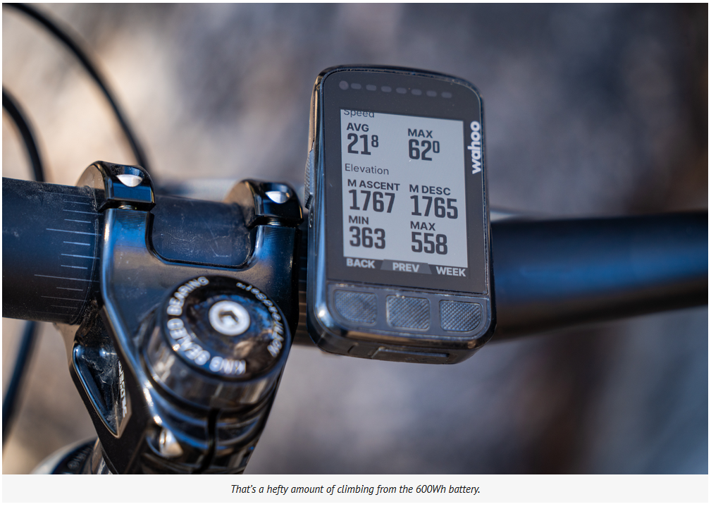

And, to publicly argue with myself, 2025 Santa Cruz Vala Review | Conventional Looks, Class-Leading Performance
The Vala, with it's new 600Wh Bosch, doesn't get close:
Again, that's in Turbo. But, even the old e160 killed it with same Wh.
These numbers are whack. 🤯
I can’t even get remotely close to these Bosch numbers, and I’m a pretty fit 80kg human, in fact one of my 60kg whippet riding friends (who is a 5w/kg beast) can’t even get close to that sort of elevation in Turbo.
Ive been riding an 800w Gen5 Bosch (100nm update) and struggle to get 1700m of vert in Turbo, and for the last few weeks I’ve been riding an Unno Mith with the 800w Avinox battery & that’s getting within a few % of the Bosch.
In fact a TQ HPR50 with a 360 battery doing nearly 1600m vert In Turbo? I’m not sure that motor / battery can do that in any mode 😆
I'm pretty sure the goal is a general comparison of the same-rider same-trail between the different bikes; and with stock tires. I don't think It's meant to apply to your specific trails/tires/use case.
Also looks like they use the same Wahoo. Could report very different to whatever you're using. But again, I think the goal is to compare bikes they review rather than to tell you how much elevation you'll get.
