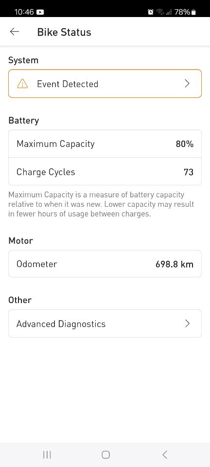

I thought my battery (according to Mission Control 1st app) was holding up fine, showing 100% health.
However, in February '24 , they introduced the new MC app. After installation, suddenly my bike system is still showing healthy but charging is limited to 80% charge because of relative capacity to when new... After 64 charge cycles!

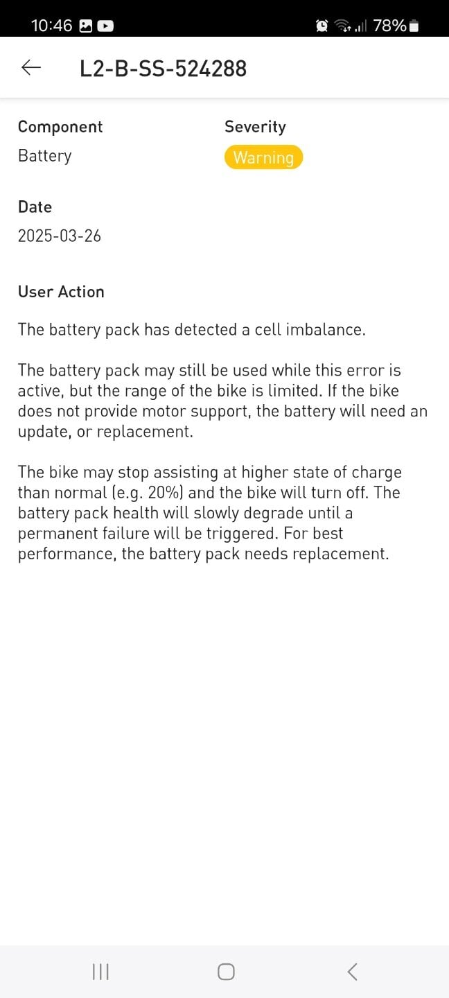

There was a Warning notice stating that a cell imbalance had been detected.

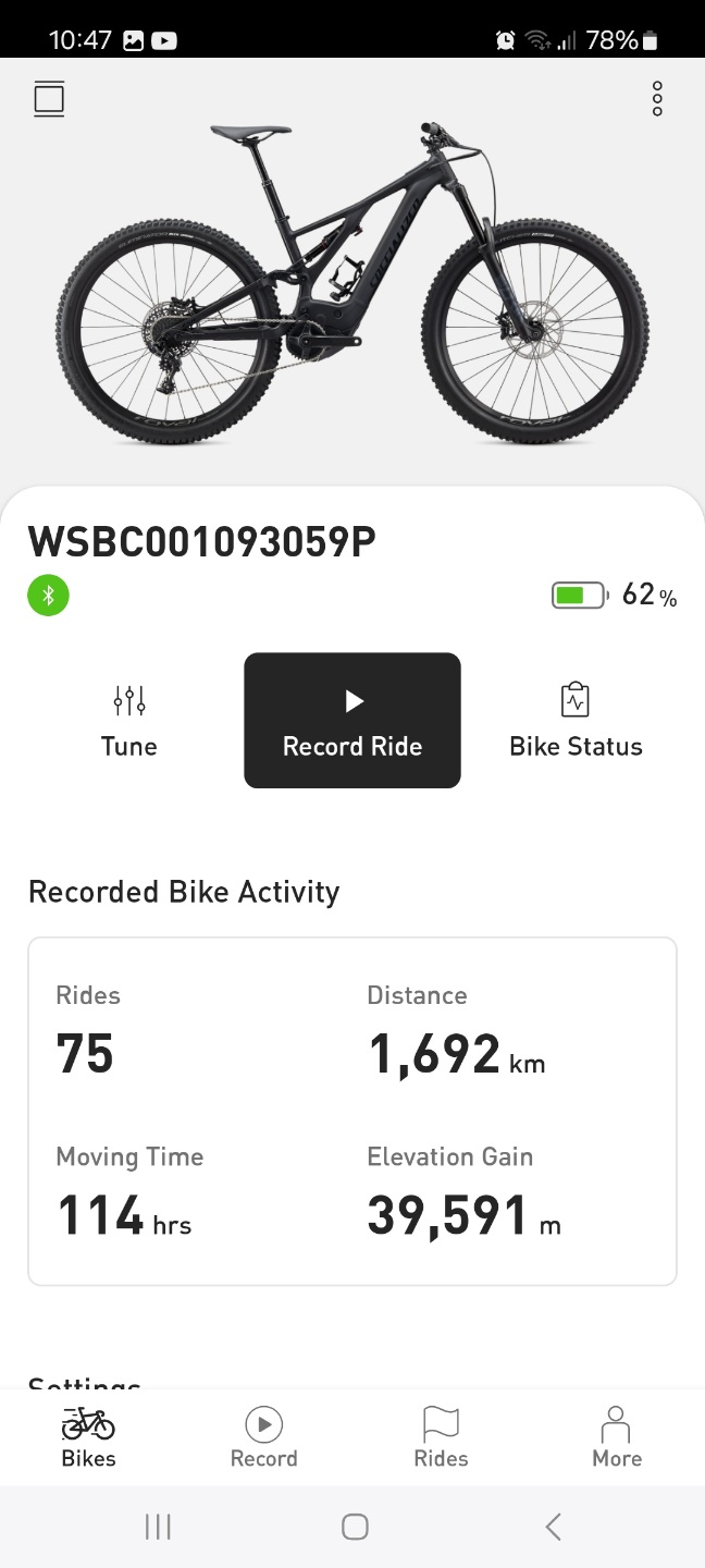

I attach screenshots of the issue for reference.

Screenshot_20250326_104648_Specialized.jpg Screenshot_20250326_104700_Specialized.jpg Screenshot_20250326_104720_Specialized.jpg Screenshot_20250326_104836_Specialized.jpg
