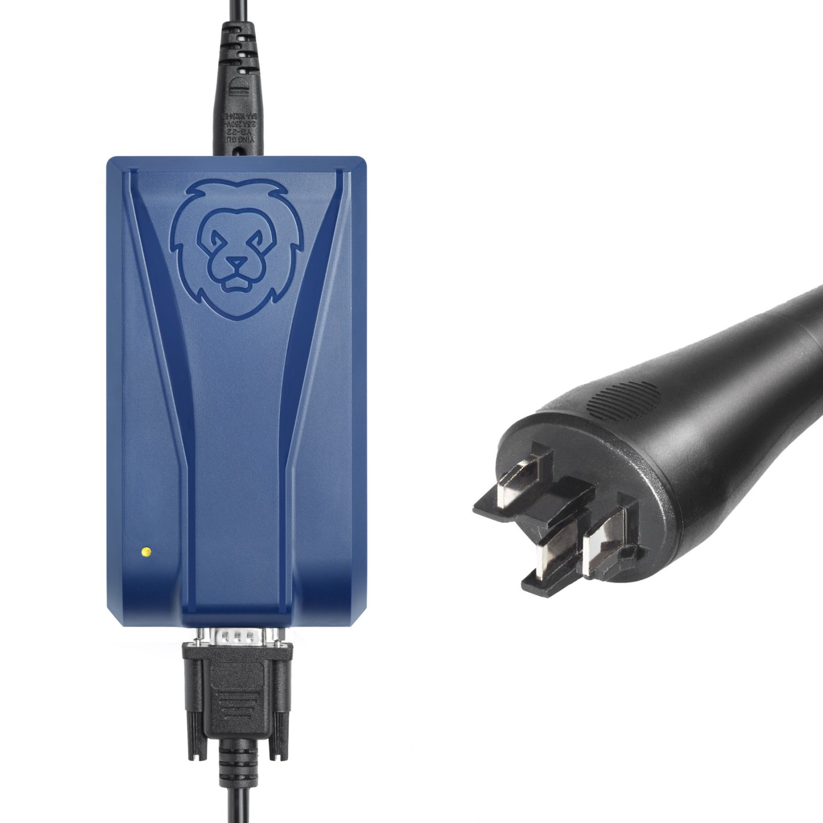

Just saw this in Bike24. I wonder what's the reason to use totally useless, crap, non-automotive computer style DE-9 connector on the other end. That's a total show stopper for me even if the charger would work without electricity. That's some real low quality.
It's a well proven locking connector with multiple pins for multiple launch leads into different manufacturers interfaces, and it can take the current. You can find other connectors yes, but they get very expensive very quickly.

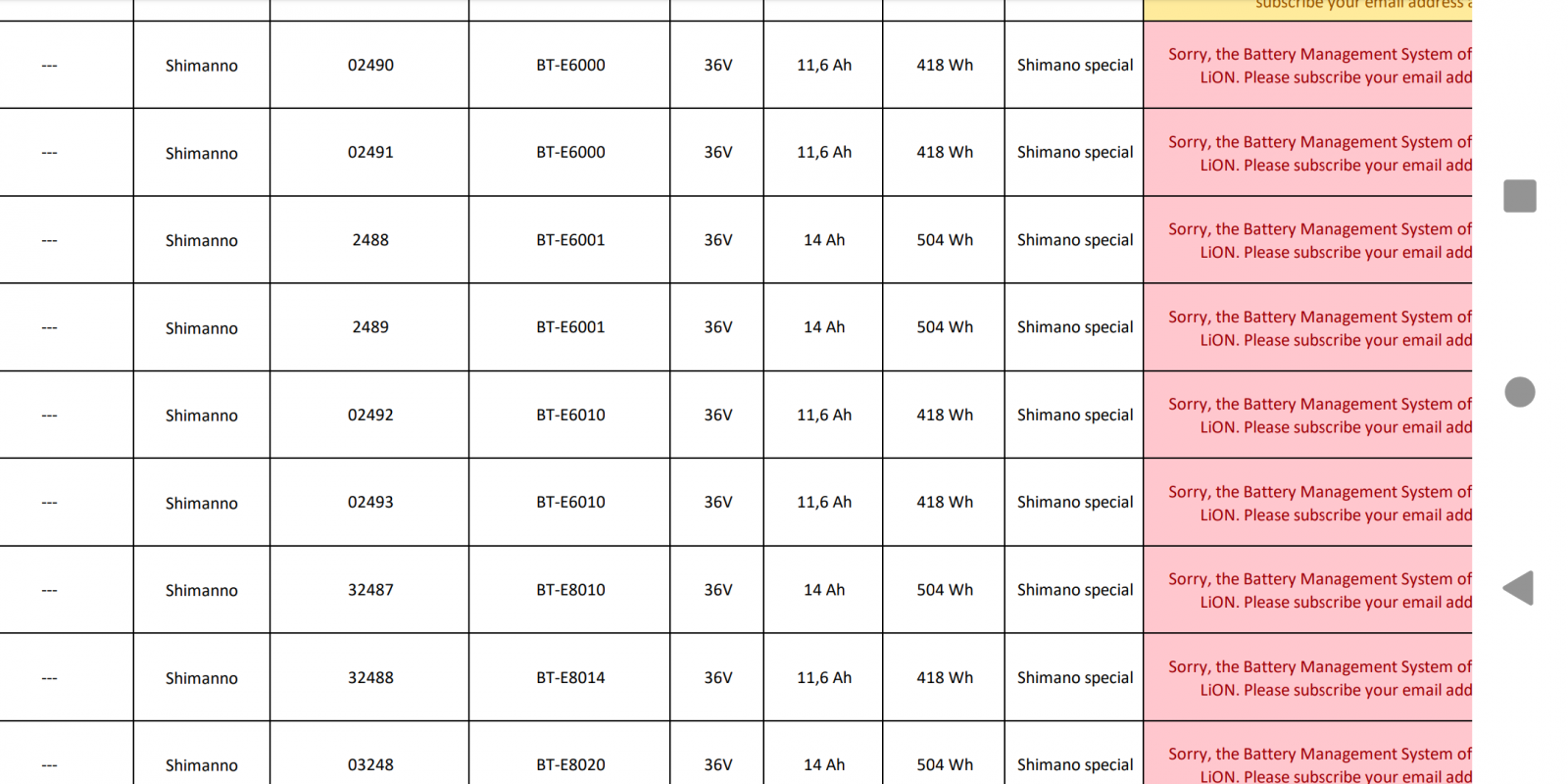

Shimano and Yamaha are not yet supported by the Lion; however, they are working on it.
Why is that a show stopper? It's a well used connector rated up to 5A per connector so is more than capable of taking a 4A charge.
It also allows the manufacturer to use 9 pins for different comms and then offer the adaptor cables
I mean maybe it would be nice to use some weatherproof sealed tyco connector, but how many people are going to be charging their ebike from a power source in the rain?
I don't see much point in hiking the manufacturing cost when a proven connector exists.

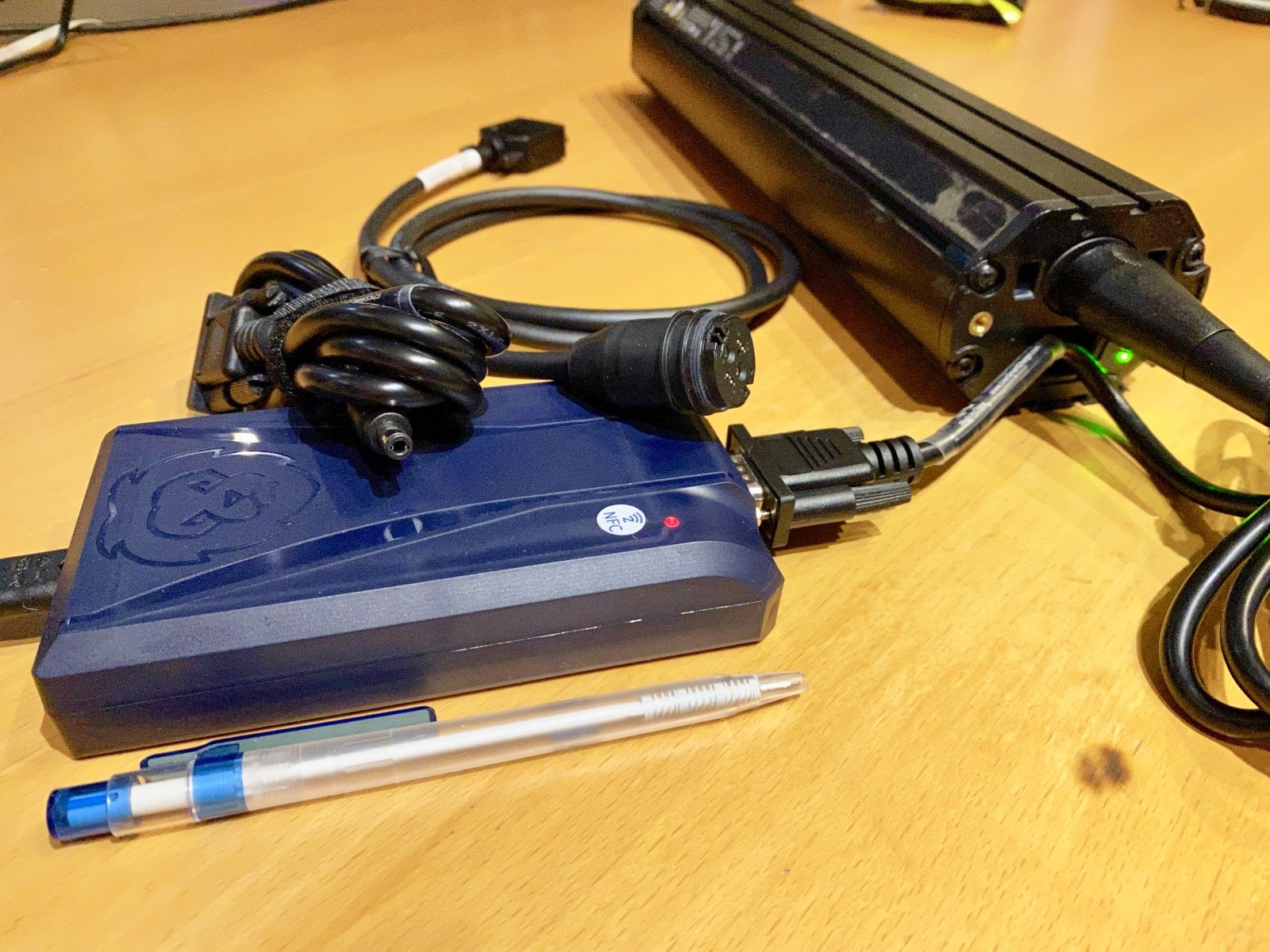

I bought the Lion charger and have been using it on our latest holiday (camping). I bought it with cables to charge my wife's Cube (Bosch), my own Specialized Levo, and the extension battery that I sometimes use.
I had several reasons to invest in this:
  • Having to pack only 1 compact and light charger instead of 3 bulky/heavy ones when going on holidays (weekend or longer trips). We mostly go camping, so we already have way too much other stuff to take with us.
  • Some campsites only provide low amp electricity connections, so with this charger I can choose to charge at a lower rate and not having the risk that turning on the lights or using the water-cooker while charging blows a fuse or blackout the complete campsite. I don't mind the longer charging time (and having to sequentially charge the batteries) as we mostly don't ride every day, so there is plenty time to charge sequentially and at a lower rate.
  • Having the possibility to use the storage mode for when the batteries are not in use for longer periods
  • Having the possibility to get a notification on your phone when charging is finished (according to the chosen charging option). This is really useful when multiple batteries need to be charged (sequentially).
I will still use the original chargers at home, but the Lion is ready and packed for any trips we will make. It is even small enough to carry in a backpack for longer daily rides to charge during lunchbreak.
I do have some critical remarks about it:
  • Like mentioned by others I don't like the RS232 (?) connector. It has not failed on me yet, but It just does not feel right on a device like this. You will need to use the 2 screws to keep the connector from disconnecting, but this is always very fiddly and brings back memories from there past where you could not get the screws out anymore or the threads inside the device would come loose. Using it with gloves is just not possible.
  • Also I did have to use the charger outside (bikes are outside at the campsite) and had to keep an eye on the weather to cover it up or disconnect it when it would start too rain. But I guess you would have to do the same for any charger.

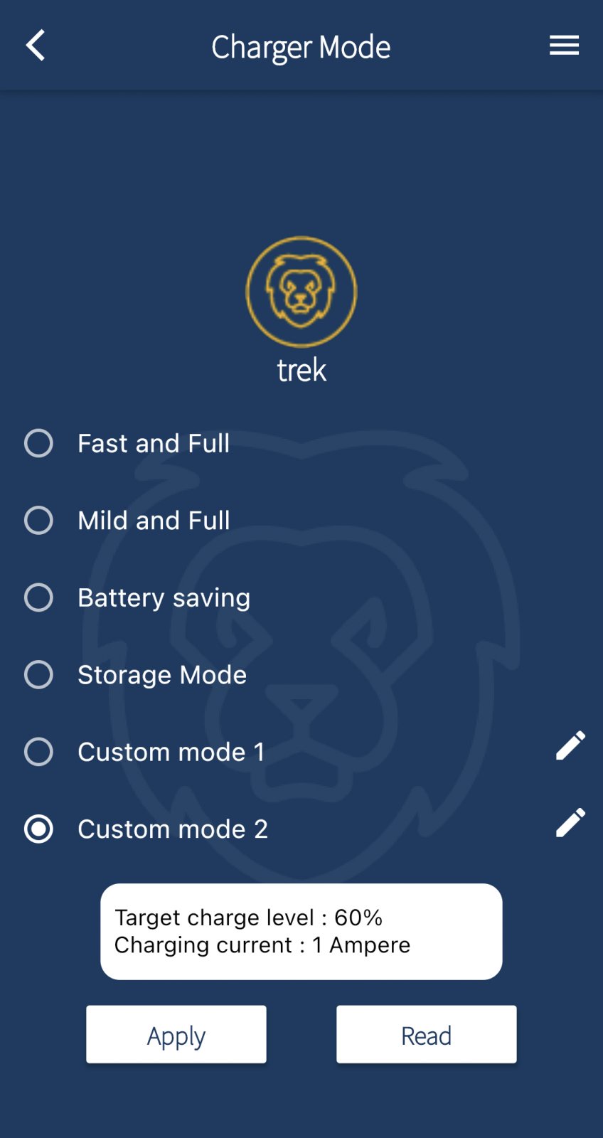

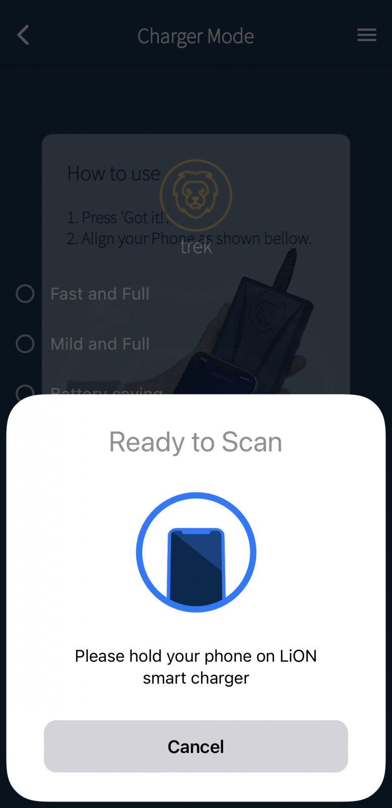

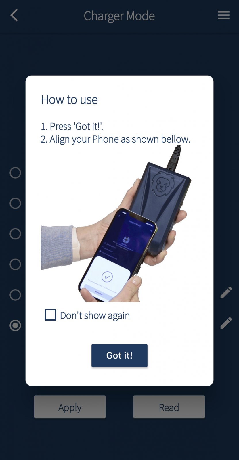

  • The NFC communication needs some practice and does not always work on the first attempt. This can sometimes be a bit annoying.
  • The notification functionality is not (yet) very accurate: I had situations where I would get the notification on my phone that the battery is charged to 100%, but when checking it was actually lower (like 90 or 95%). Not really a big problem, but could be better.
  • I think I would have preferred a bluetooth connection from charger to phone as that would overcome some of the above issues. Not sure why they chose for this NFC (offline) solution.
All in all I still think it was a good investment and I hope the manufacturer will continue to improve the software to overcome some of the issues.

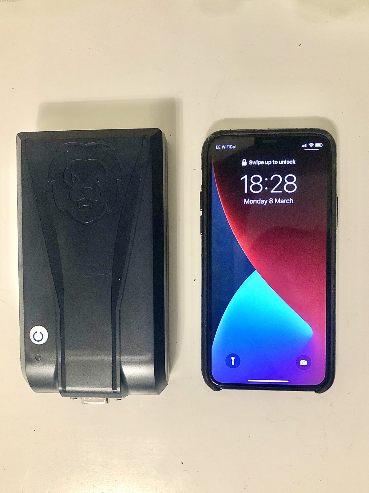

Thanks for the update, if nothing else it's very compact.
