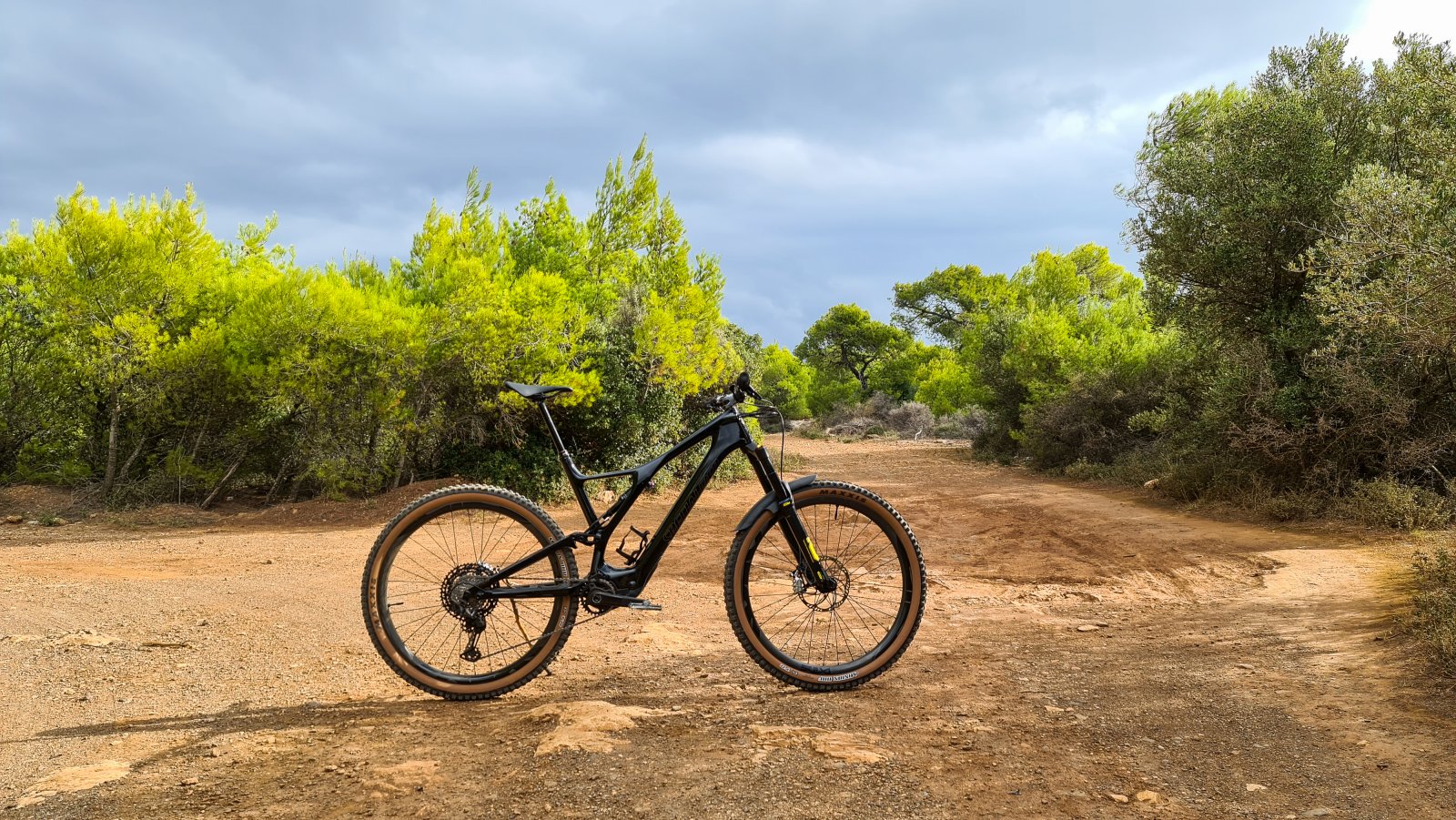

Hi, my SL comp is finally (almost*) ready.
Except the cranks I changed everything.
- Ohlins m.2 coil fork (@ 160mm)
- 77 designz stem & carbon bars
- DMR DeathGrips
- Magura 1983 brakes
- Shimano XTR 12sp cassete & trigger
- Shimano XT Derailleur & chain
- BikeYoke revive 185mm dropper
- Garbaruk Chain ring
- Specialized s-works power ark saddle
- one up pedals
- Maxxis DHF 2.4WT & DHR II 2.4WT
- Carbon rims with sapim CX rays with i9 Hydra hubs
(* I Have already the cascade link, and I am waiting to receive an ohlins coil shock for rear)

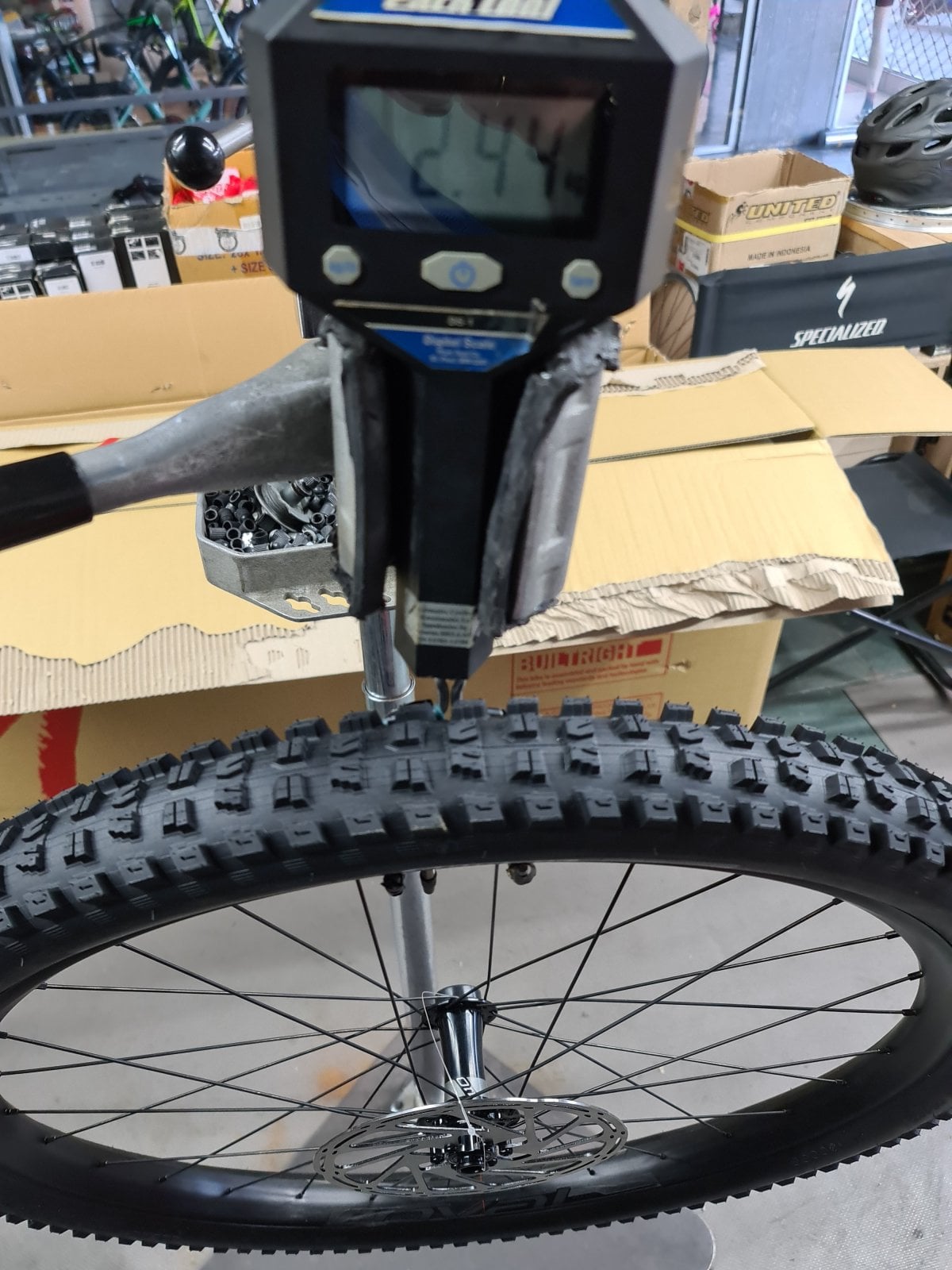

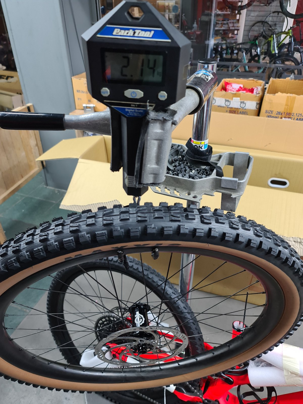

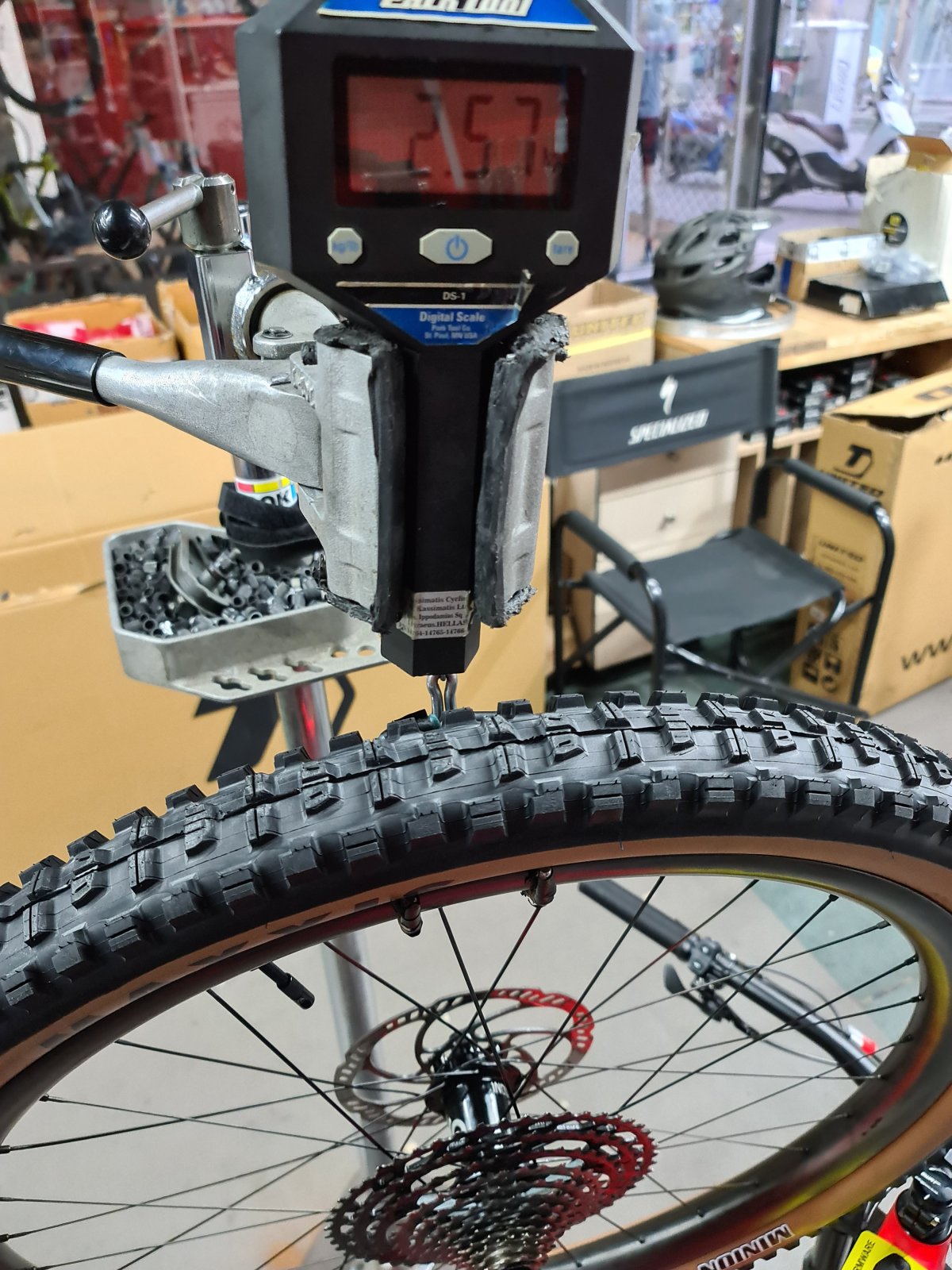

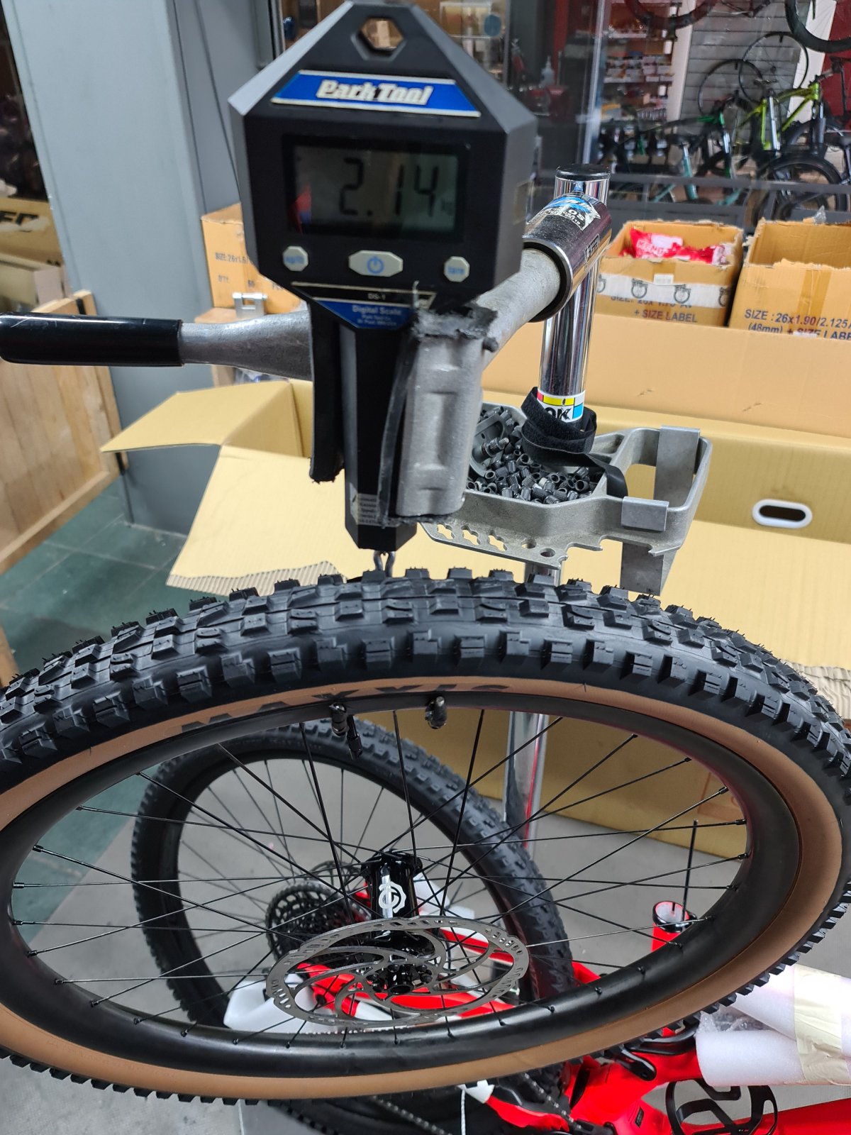

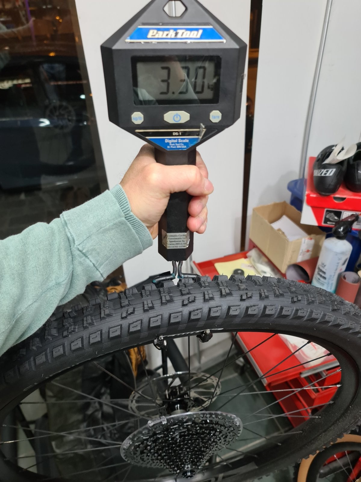

FWIW, stock wheels (with tubes) are 5.74 KG !! (Front 2.44kg / 3.30 rear), while the set I made is 4.710.
(Maxxis pair is ~ 350gr heavier than the stock Specialized...)
^^ my first ride was 25km in 1:50 hrs, with 775m elevation, only in eco mode, and spend ~30% battery (7 bars left)
(Maxxis pair is ~ 350gr heavier than the stock Specialized...)View attachment 45280View attachment 45281View attachment 45282View attachment 45283View attachment 45284
