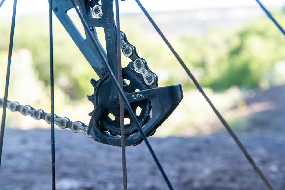

Just remember there are two 12 speed Sram cassette sizes- 11-50 and 11-52 which my 160s has so presuming we all have it, your derailleur has “520%” stamped on it, I only say as the 11-50 is more common

And what driver body you have, my 2020 150RS came with a PG1230 requiring a splined driver, the 520% cassettes are XD drive.
For Shimano freehub there are only 11-50t (SX and NX) and for XD driver 10-52t (from GX to XX1 range), there is no 11-52 cassette.
