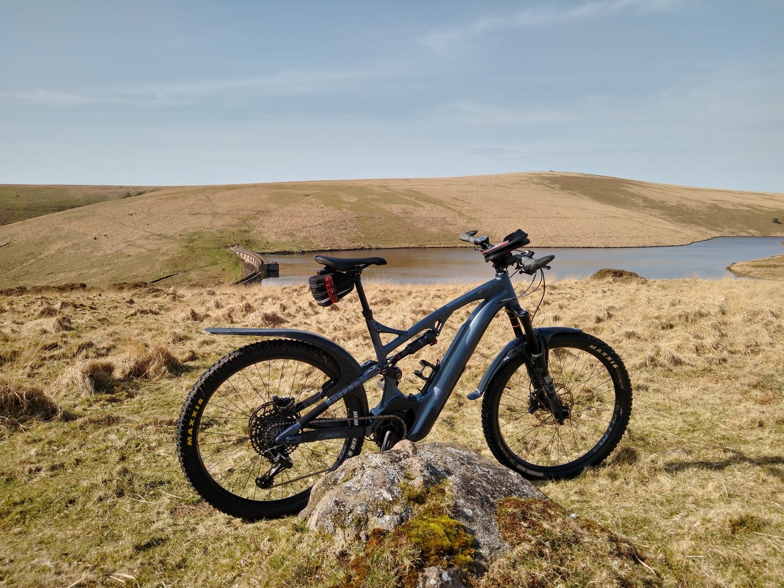

The trails are drying out nicely now, so it was nice to get home and not spend an hour cleaning my bike, my kit and me!

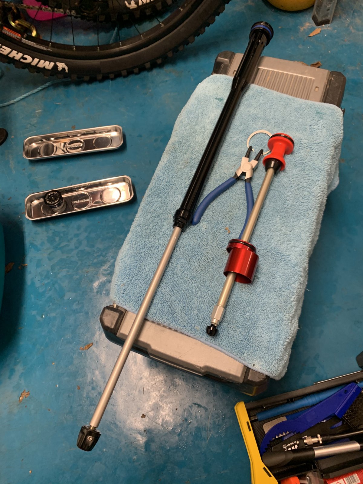

I bought the Charger 2.1 damper from Germany and the 170mm air shaft from TF Tuned. Total cost was just under £300 and then I done the work myself.
Changing the damper and air shaft are really easy. If you can do a lower leg service (which you should be doing every 50 hours anyway) then you shouldn’t have any problems.
How is the charger 2.1 compared to the charger R?

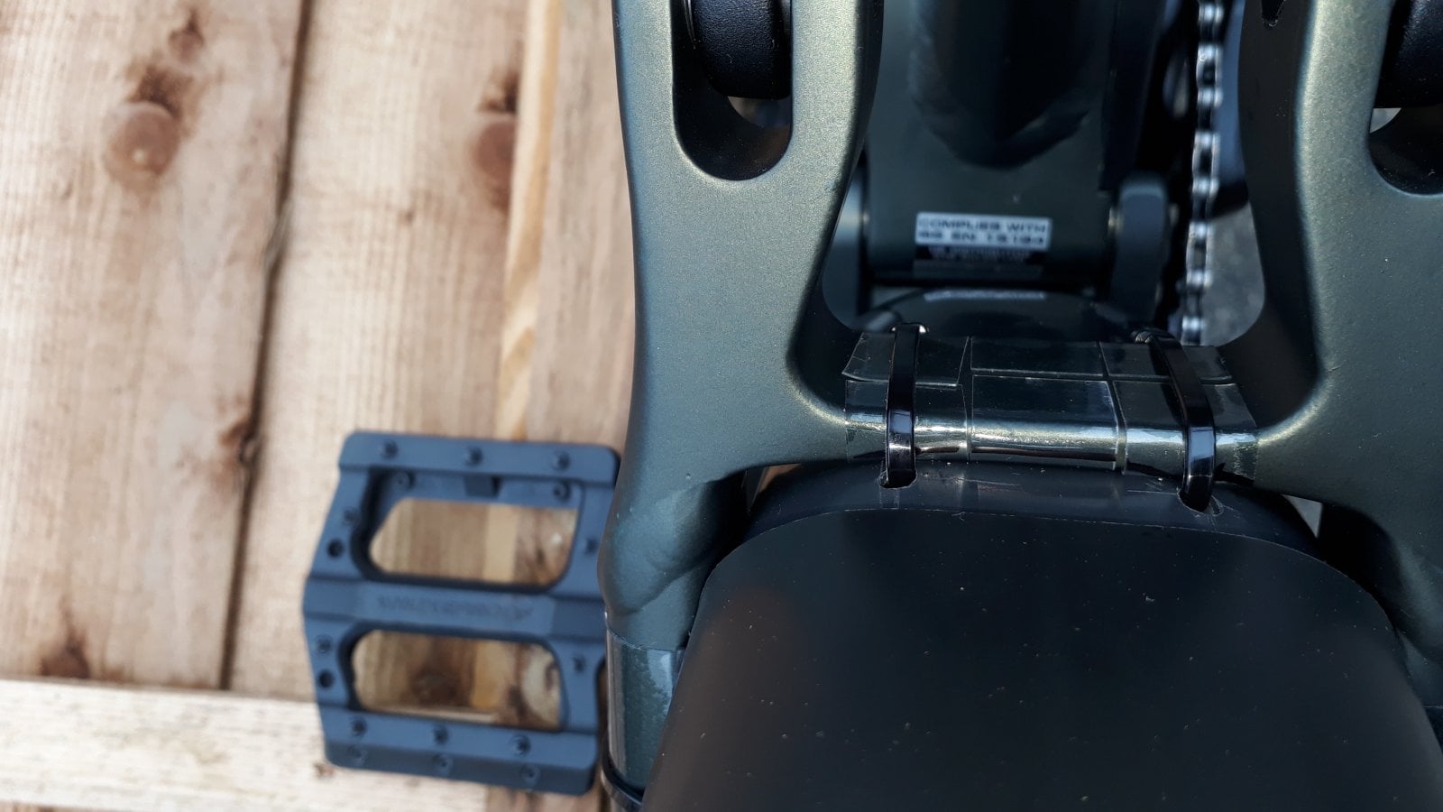

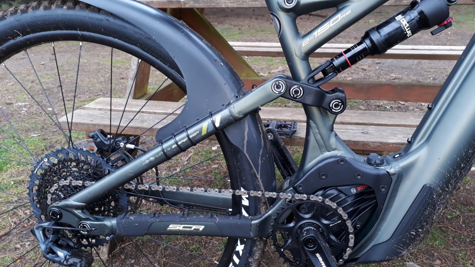

Thanks to all who have posted various mudguard combos, here is mine, and I am quite please with how it performed on my first ride.View attachment 55877View attachment 55879
That's probably the best there is, for keeping the mud off, but it looks awful!
When I fitted mine to my Cube, I did it in a hurry, and stupidly forgot to put the helitape on the frame underneath, resulting in all the paint rubbing off. I'm glad you're smarter than me and fitted the protection!
Mine sits a bit higher, to allow for the sticky Devon mud on the tyre that won't then scrape on the underside of the guard.
Looks ugly, but more importantly, is very effective.

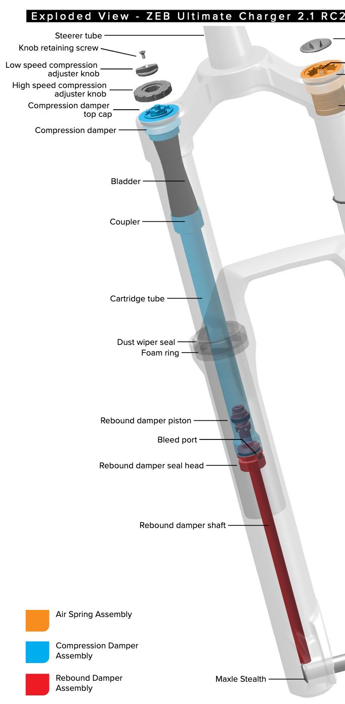

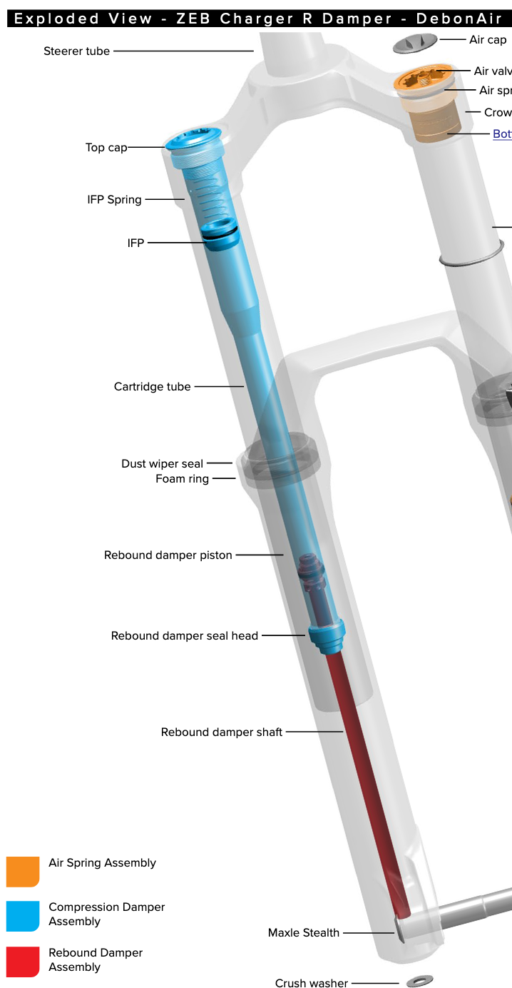

It’s a little more refined and slightly more plush. There is a noticeable positive difference but it’s not extreme. Also nice to have a little more adjustment available.

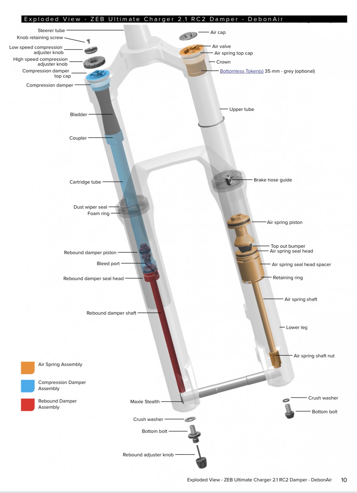

I'd be interested to know if the Charger R is the same as any 2.1 damper inside, minus the compression adjusters obviously. Mine's performed pretty well but failed after six months, so been sent off for service/repair ??
They’re definitely not the same. The Charger R is a semi open bath design whereas the Charger 2.1 is a sealed bladder design.
Yeah, I've looked at the service manuals - not sure how this shows they're that much different TBH.
Edit - found the right diag ?
