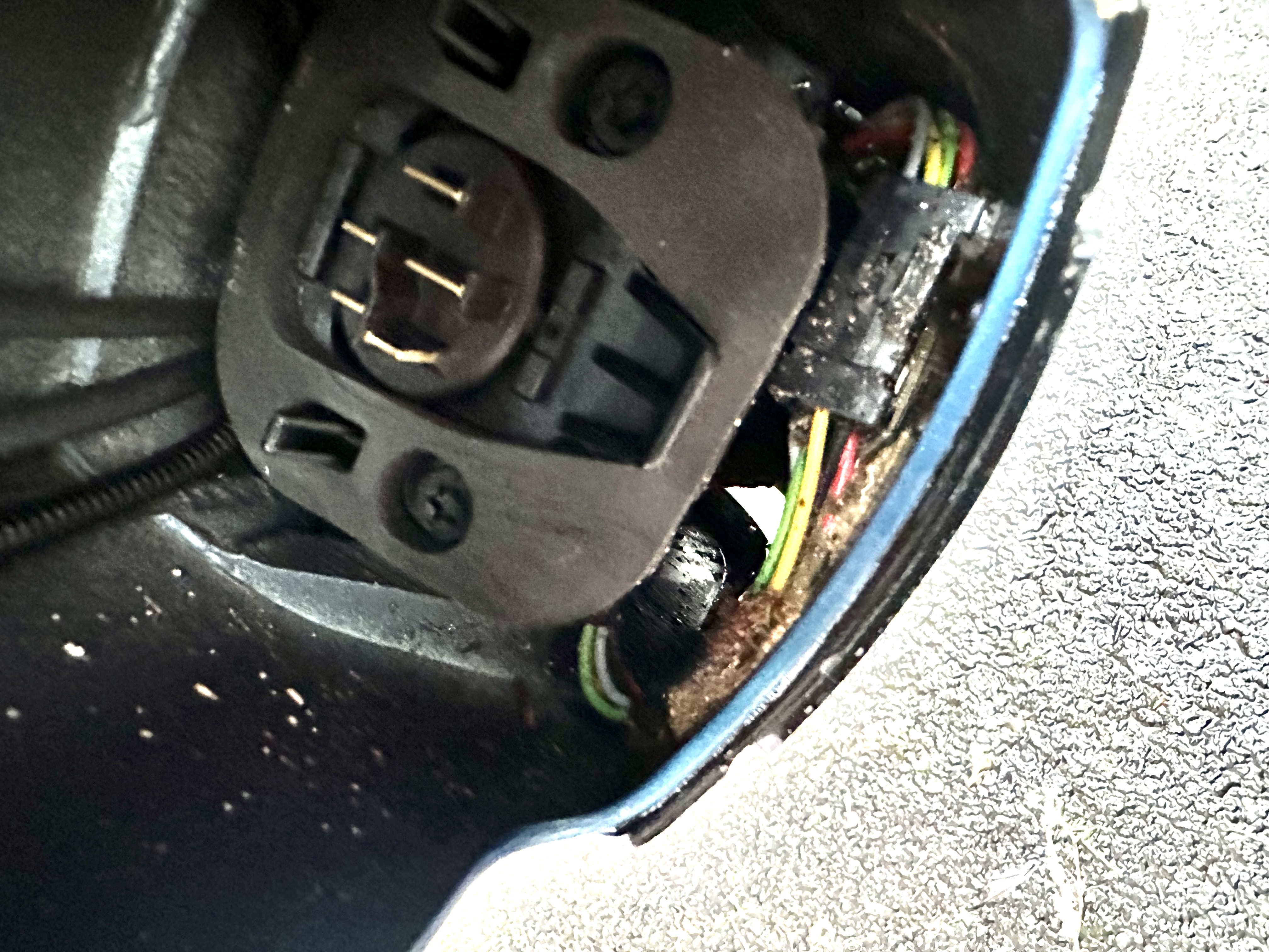

Should I be getting this amount of crud at the bottom of the battery compartment?
macinthekitchen
Jun 28, 2020
16
7
Ringwood
Just picked up a Scott Genius eride , Been for a few rides to break it / my arse in. I’ve noticed that after cleaning (hose only, no pressure washer) there’s a bunch of mud/crap at the bottom of the battery compartment, right where there’s connector. Is that normal or something I need to sort? are the connectors well rated for waterproofeness?

usual story of open fronted downtubes! The battery cover is often more cosmetic than functional. A decent front mudguard will help to stop it getting plastered by water and mud off the front wheel and some additional sealing a round its edges will mostly prevent trail debris getting onto the connector area. You are also better off using a soft brush and damp cloth with a bucket of water, than using a hose (imho).

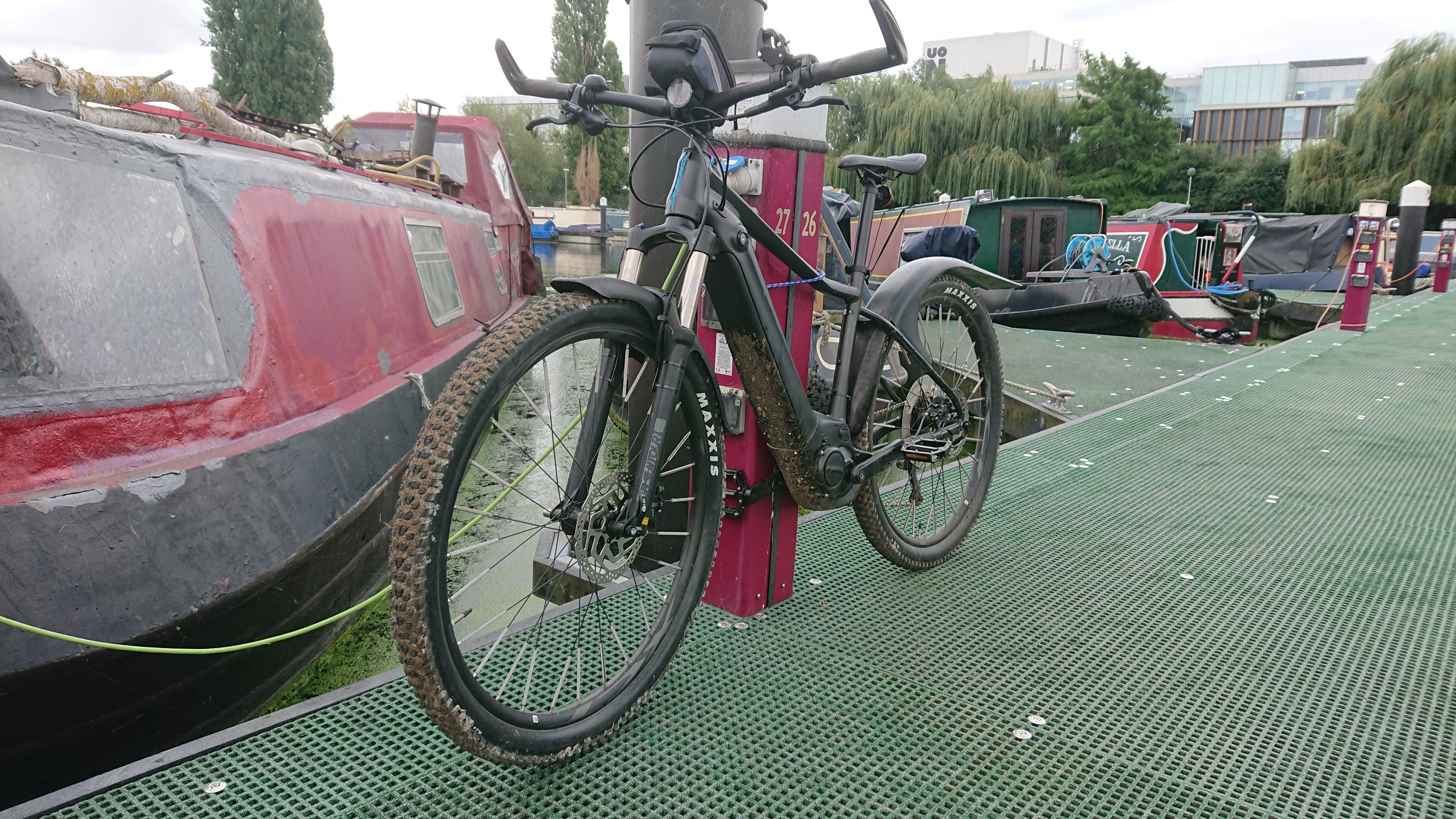

1 of those covers stops it, I use the Fahrer Akku cover tube in Medium on my Fathom (amazon linky).
As you can see from this pic, a mudguard's not gonna help
Thats exactly what i use , The Fahrer cover and have been for years ironically i bought it for my 2018 scott e genius and still use it on my Trek rail today .
As you say a front mudguard does nothing to help .

Thanks for all the tips here, I've just ordered a battery cover from Amazon :) FWIW - I asked Scott UK what they thought and they replied (very impressed with their service so far on this and other questions) ' The Bosch system is designed so that water can drain away. If water was to make contact with the connectors or terminals it will drain away and not cause issues. Due to the style of riding that is done with a Genius eRIDE the conditions might be muddier. If there is a build up of dirt it is recommended to clean as much away as you can to ensure water can drain away sufficiently. Once dry the mud should be able to brush off. Alternative a gentle wash can be carried out but not under pressure.'
Mikerb
May 16, 2019
6,141
4,672
Weymouth
the main battery plus is unlikely to be badly affected but the electrical connector in front of it is more vulnerable. Short answer...........no mud/water should be able to get in there!!
