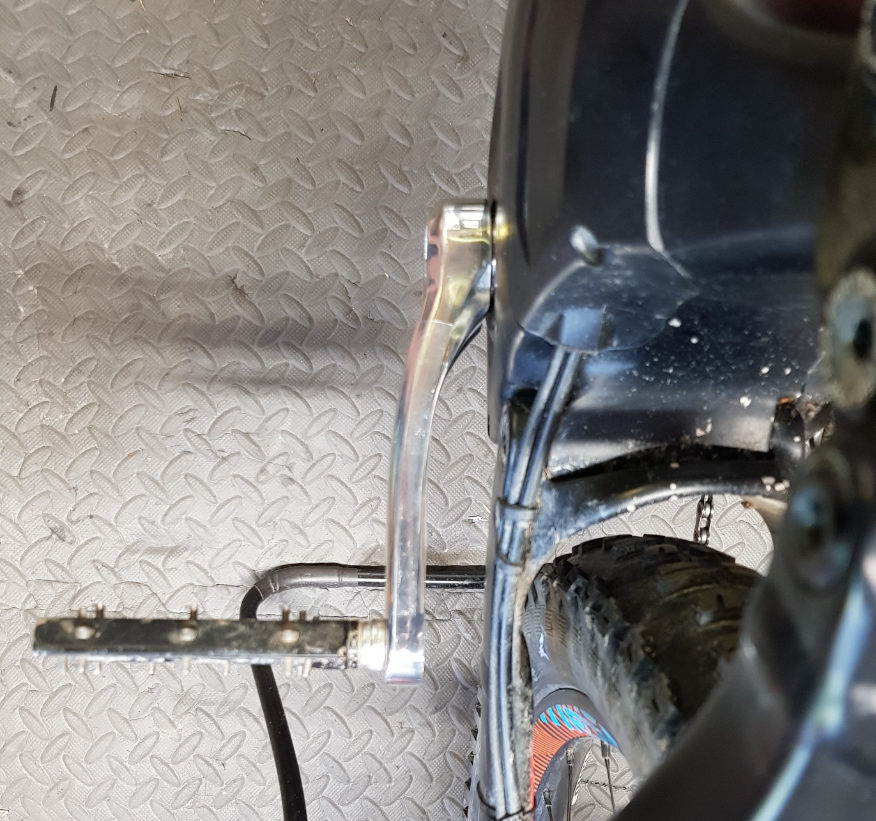

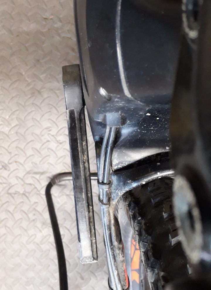

As I was removing the Venture 2 cranks I noticed that the black paint has worn off where the bolt fixes the crank to the ISIS connection much more than the original Praxis cranks. As my ankles stick out more than other peoples this may not be a problem in regards to clipping your ankles on the cranks whilst pedaling. I wear FiveTen Freerider EPS Highs so this is probably why I have not noticed this issue before but like I said this may not be a problem for most as I have very sticky out ankles :rolleyes:
If you are worried about clipping your ankles or wearing the paint off your cranks using the Venture 2's then this may be a valid concern. The QF on the Kris Holm cranks are HUGE compared to the Venture 2's so they will definitely resolve this issue.
I have just fitted the Kris Holm Spirit 137mm cranks, see the photos below, it really is a night and day difference regarding Q Factor so hope this helps.

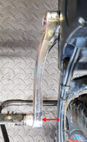

Chris can you do me a favour can you give me a measurement from centreline of the crank to outside of the chainstay please on each of the cranks if poss
cheers
cheers
Hi Dave,
Just to confirm, do you mean this measurement on both sides?
If yes, It is 22mm on the left and 26mm on the right

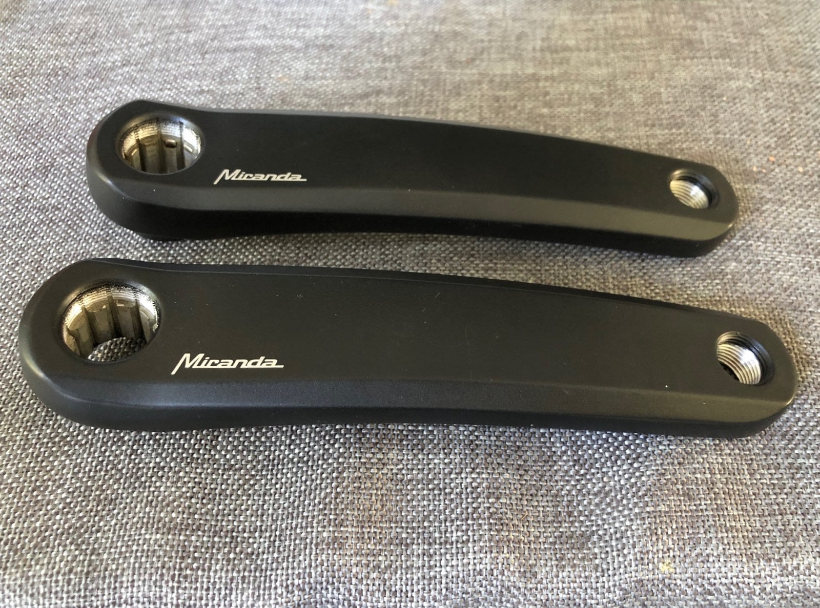

I just spoke with Bryan at Dillglove who import the Miranda cranks, he's going to send me the Miranda 150mm, hopefully they'll fit. Ill keep you updated.

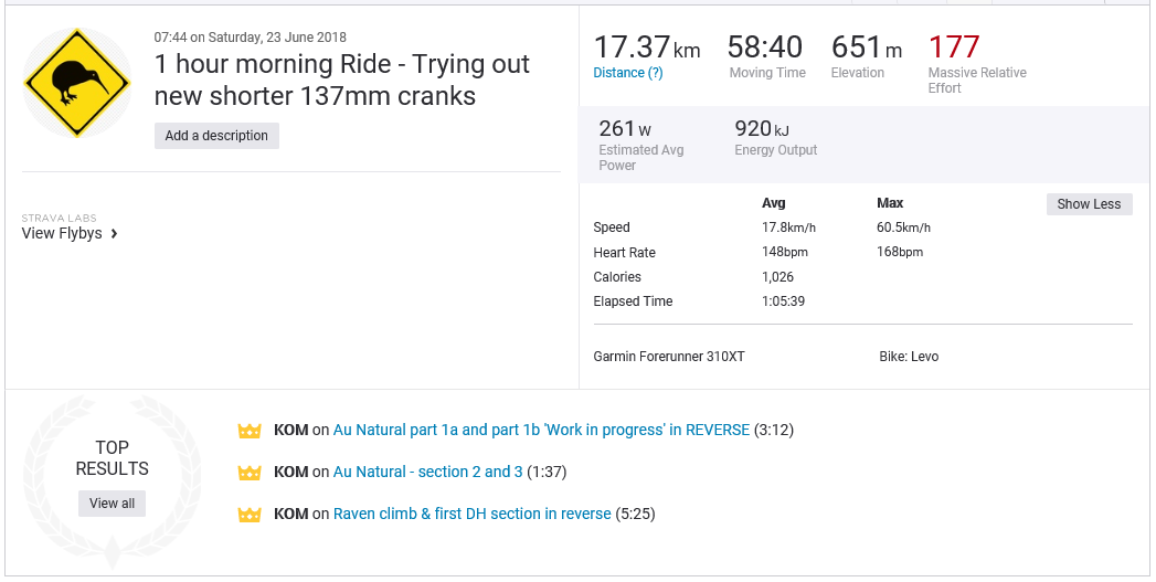

I was out again this morning and by myself so no one around to restrict me putting in a fairly intense effort.
Now before you read the following.....

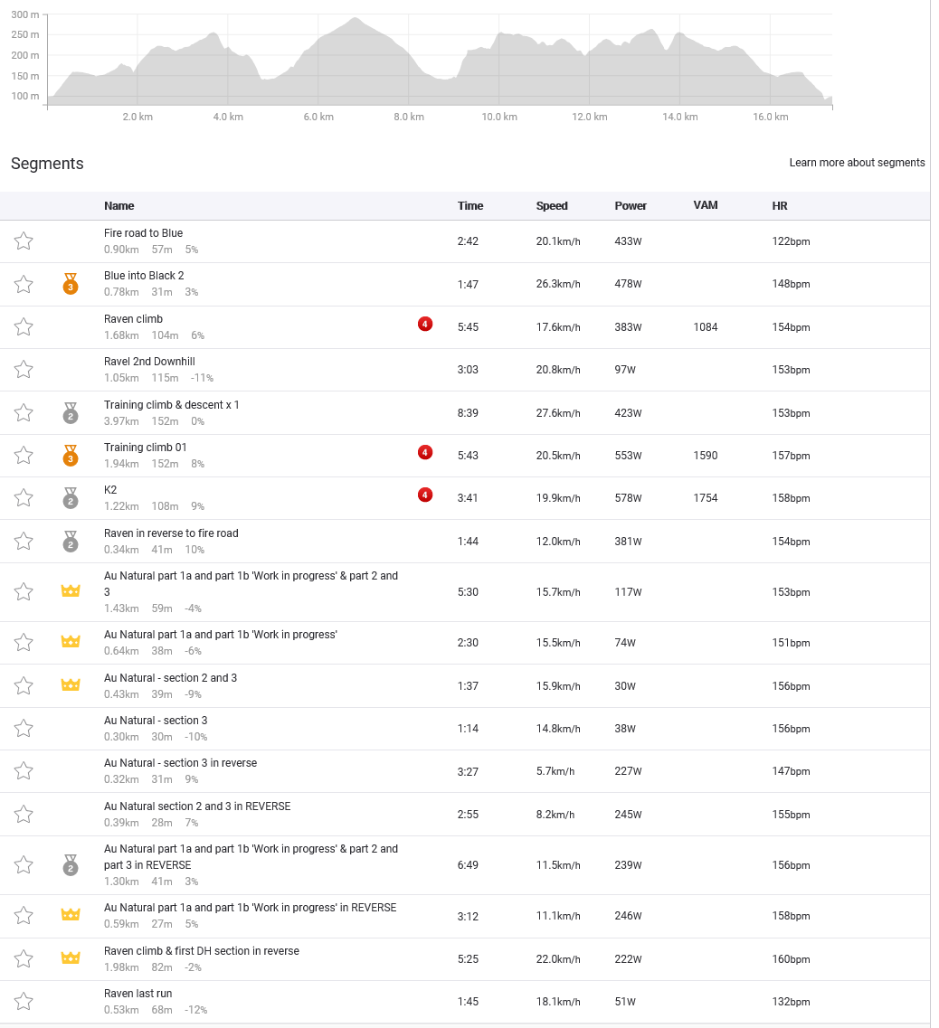

This is my personal opinion of Strava. It is NOT accurate and should be used as a rough training GUIDE only. Yes it is great to get a KOM, but when you get a KOM (and I received 2 of these a few weeks back) just riding down a fire road where Strava has accidentally picked you up on a trail next to the fire road then you really have to question Strava's accuracy. To get a more accurate picture I think you would have to take 10 or 20 snapshots of exactly the same runs and divide them by 10 or 20. Anyway, like I said, this is purely my opinion.
Here is my feedback of my second ride with 137mm cranks. Some of the trails were the same and some of them different from yesterday. According to Strava I did a few personal bests and a number of 2nd fastest and 3rd fastest times so 'as a guide' the cranks do not appear to be taking too much Wattage off me :)
The BIG eye opener for me today was how well the bike pedaled on the very technical climbs especially on my 'ebike Trials' trail run. I was able to pedal almost continuously over a lot of terrain where I would normally be reading the trail and holding back or just putting in half a quick crank turn due to being cautious of pedal strikes.
Still early days yet but I am definitely getting more confident with these shorter cranks and what they can do. ;)

I believe so, however, I called Dillglove and told them I had a Levo and they sent the correct arms (I hope, not yet fitted!!). I think they make a single ISIS type though, so likely the same.
Just been in touch with Dillglove, boy they're quick to reply!
They said wait to see how you get on with them Rob ? Then happy to supply same.
