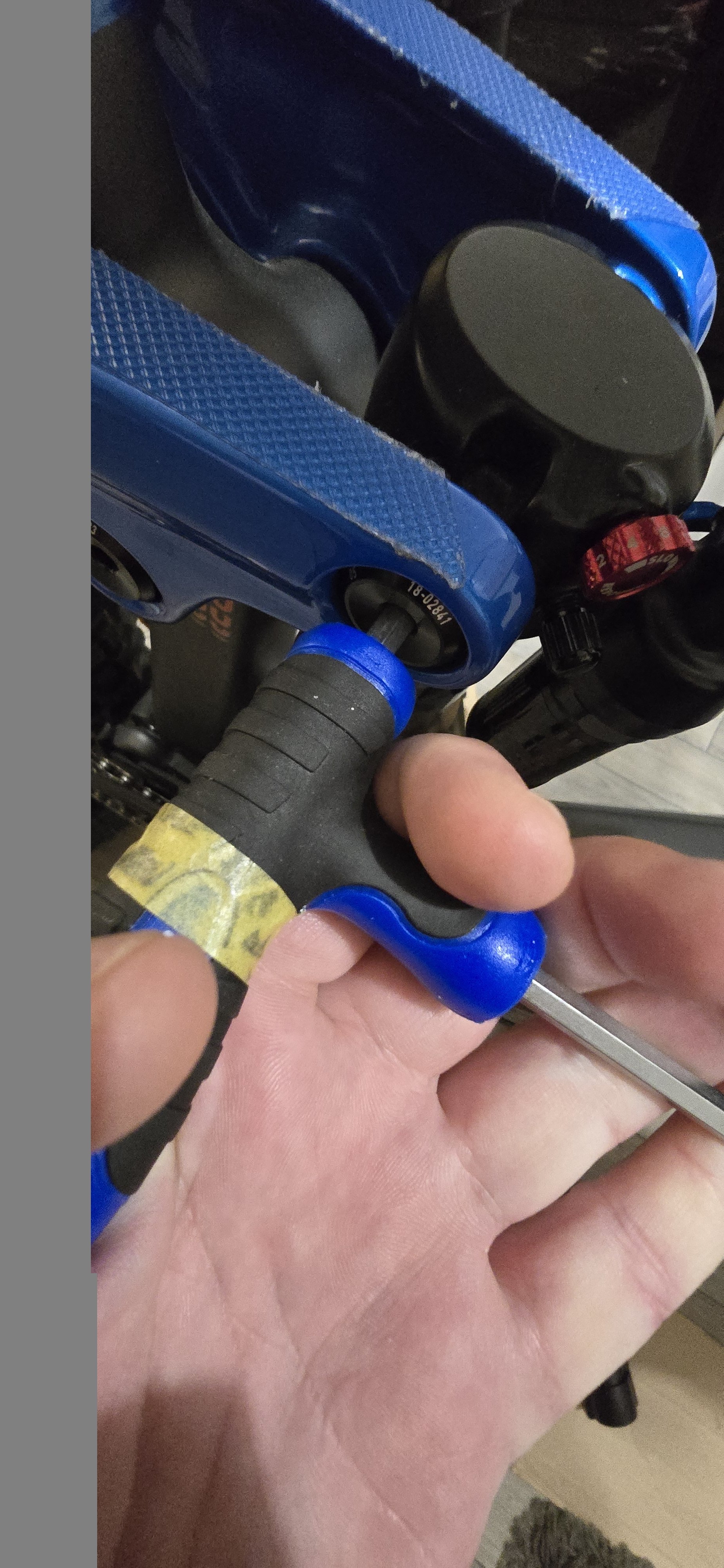

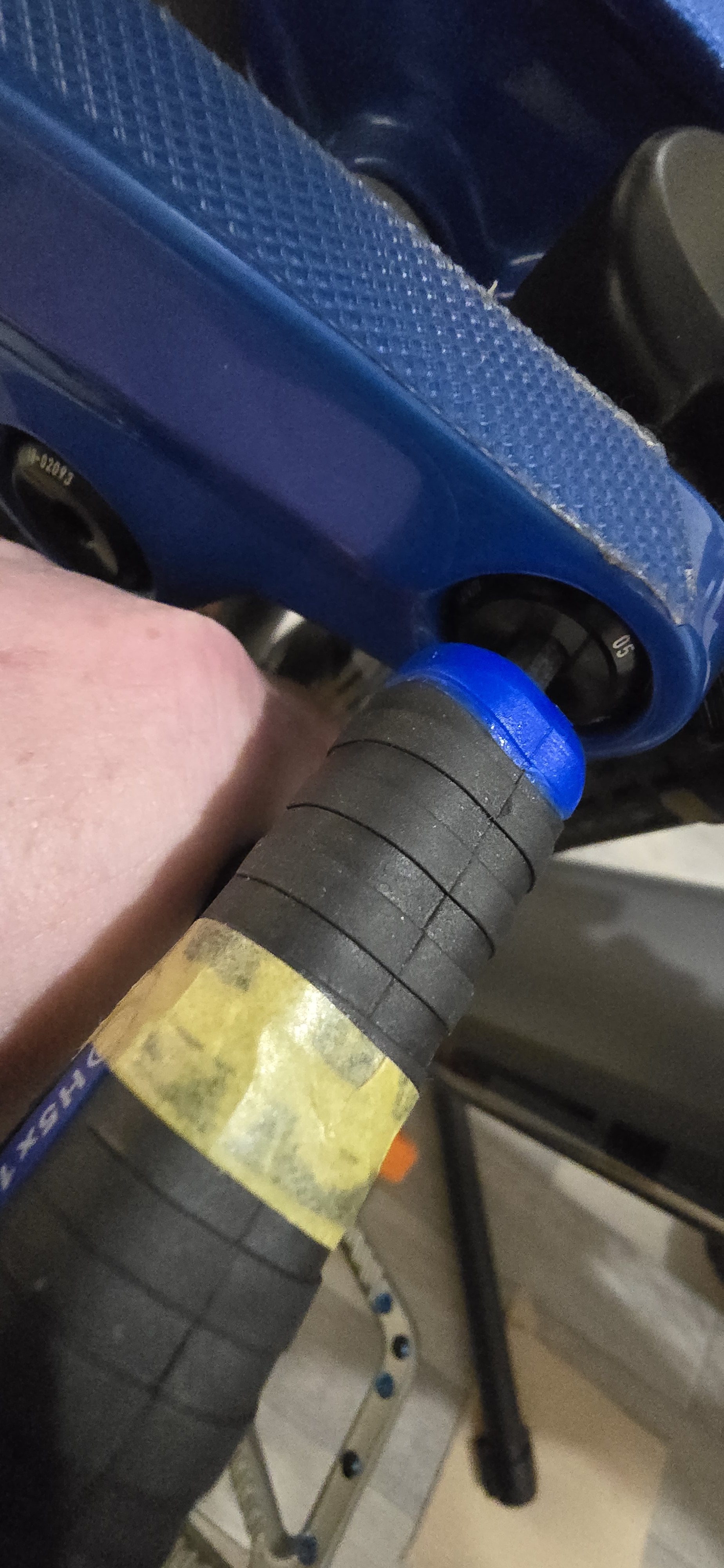

Hi id like to weigh in on this as doing it right now fitting a new 2024 X2 i used a T Allen wrench the small bit make sure you only use this side, slide it right in it'll take up near all the bit and Very gentle apply pressure with both hands one directly iver the head part! You will hear a loud as heck crack when they breaks the torque specs but its worked first time both sides just popped and came out no bother! Hope this helps someone else

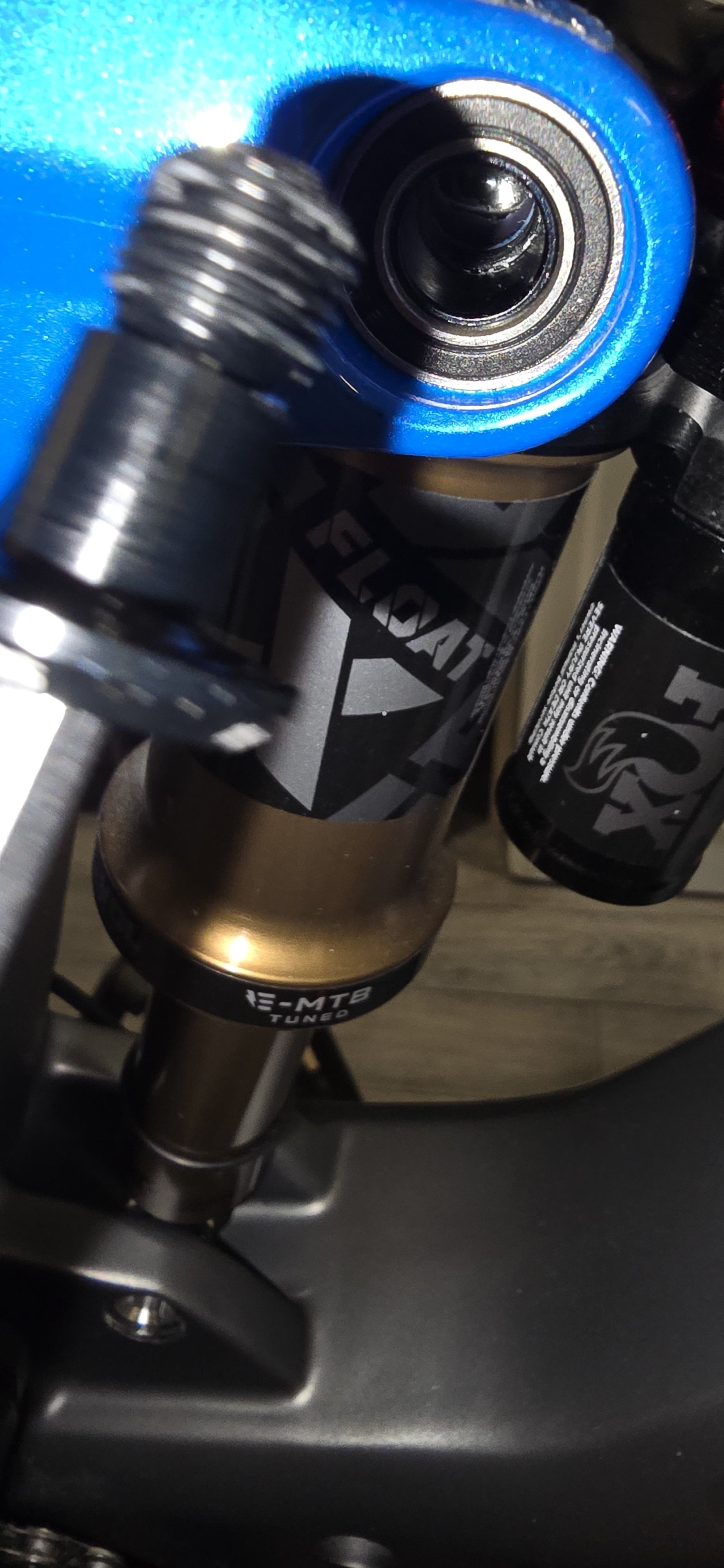

A quick fix until the new bolt arrives.
I drilled two blind holes in the bolt and knocked up a rough pin spanner.
Hopefully I can tighten it with the pin spanner and there is just enough bite left in the hex to torque it up.
I wont be using any thread lock but it should only be for a ride or two, at least I can get out on the bike.
This is also another good method for removing a stuck bolt before trying a screw extractor (y)
