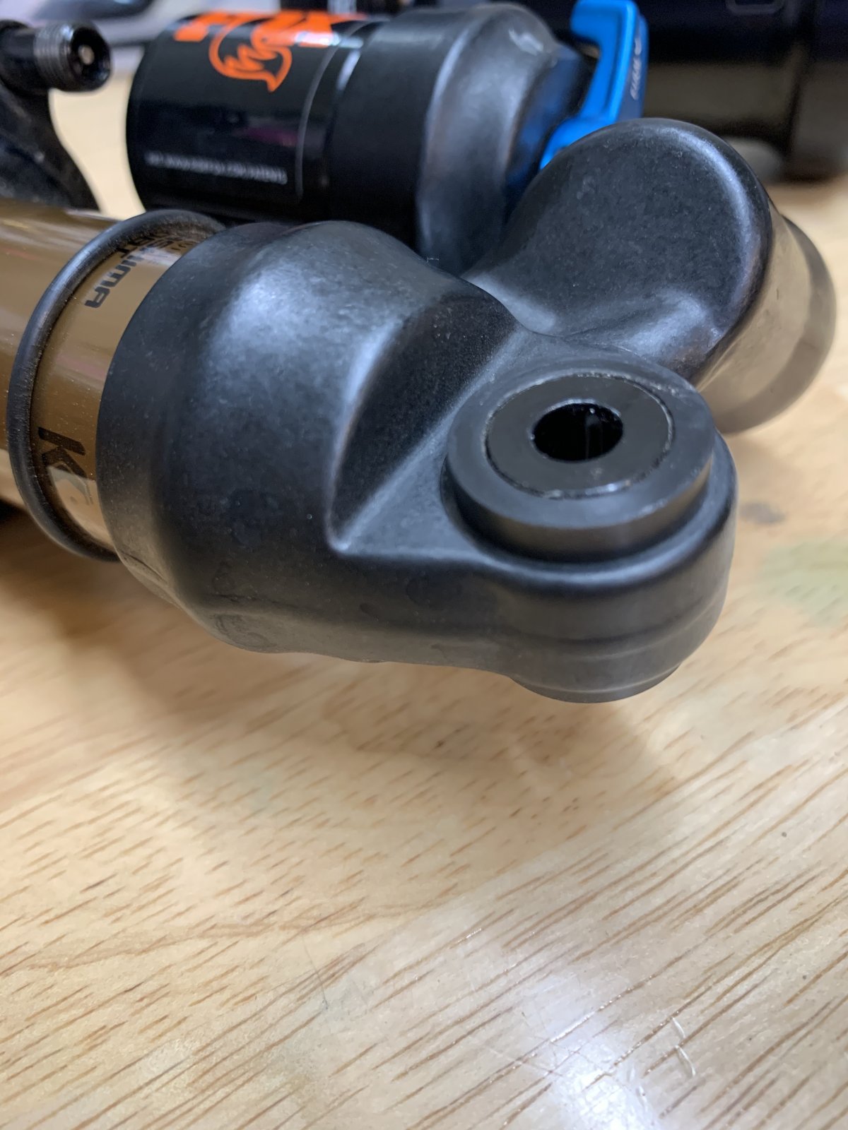

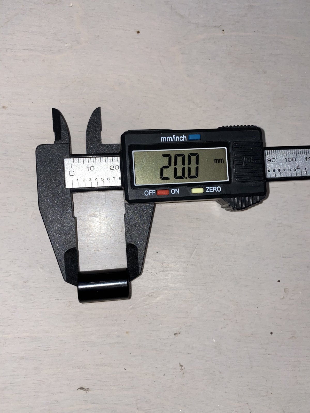

Top shock eye is 20mm wide, lower is without bushing/hardware.
In the lower eye you can use the flipchip to mount it in the frame.
Thank you for your help!
So is the top 6x20mm or 8x20mm just trying to figure out the exact one to order.
Also I only need one set for the top? I can use the current flip chip for the bottom? Hope this makes sense.

It is 6X20, the bolt is a 6mm bolt
As far as I know there is only one flip chip. In most cases aftermarket shocks come with abushing inside the shock eye, this need to be removed for the flipchip

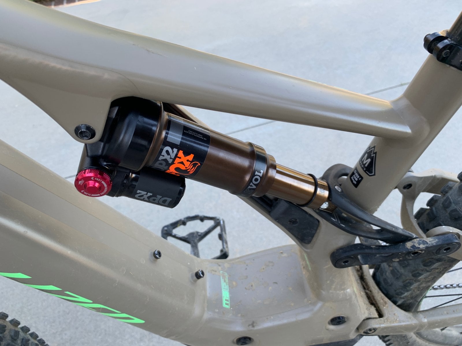

I just installed the DPX2 Part #973-61-017 It comes from the factory as a 210x52.5mm
I used the RockShox hardware on it as it was a perfect fit. The forward eyelit needed to be pressed out of the RockSox, but the hardware was an exact swap. For the rear, I had to remove the Fox grommet for the flip chip to have a perfect fit. In the forward eye, the fox grommet was used.
Hope this helps!

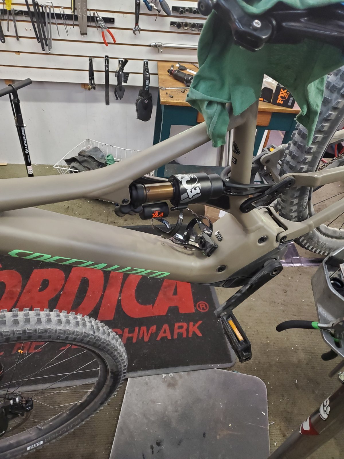

Hi @muzzman1 and @snowbro , I'm installing an X2 on my '19 Levo, did you get a mounting hardware? Just to confirm, can I use Rockshok's front spacers to install the Float X2?
Also, can I turn the valves to be outside the frame so that I can still put a large water bottle in the cage?

....so I did get the Rockshox 6x20 hardware and it was exactly the same as what I had with the original. (I thought it might be different but it was not.
I used the FOX white inserts on the rockshox shaft. I have a DPX2, so I cannot answer for the X2. I cannot get a full bottle, in fact I removed my cage all together and wear a backpack

Thanks so much for your fast response. I'll post the picture of my shock installed. :)

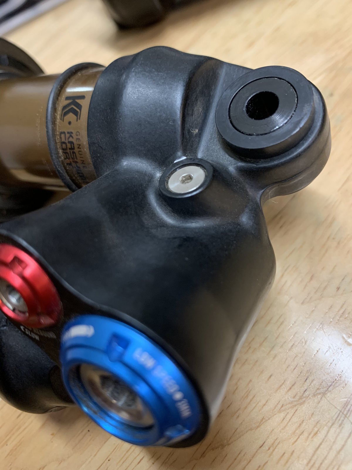

I have a 2020 Turbo Levo Carbon and just received a 2021 dpx2 but can’t find a 20mm bushing kit? Anyone know if it exists and where to get one?

Without the fox bushing i think the 6mm sleeve would be lose. I think in have to leave the bushing in. I suppose I could not bother with the black spacers, is that what you did? s yours a 2021 shock? Is the DU bushing the longer plastic sleeve that the bolt goes through? I’m lost....

DU bushing replaces the fox bushing. Then you can use stock hardware that was on the rockshox
i did it for a 2021 x2 on a levo sl and a 2020 x2 on a levo
your rockshox has a DU bushing. So you’ll want to do the same for the fox and everything will fit
