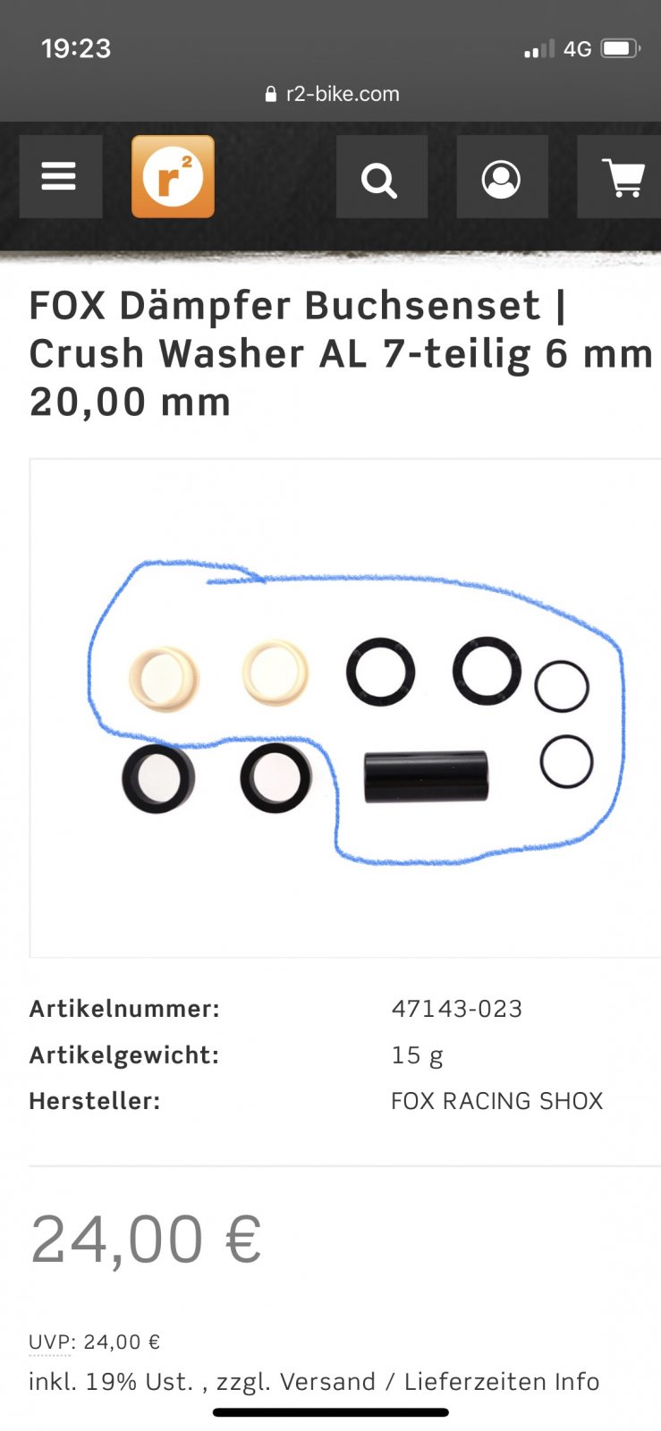

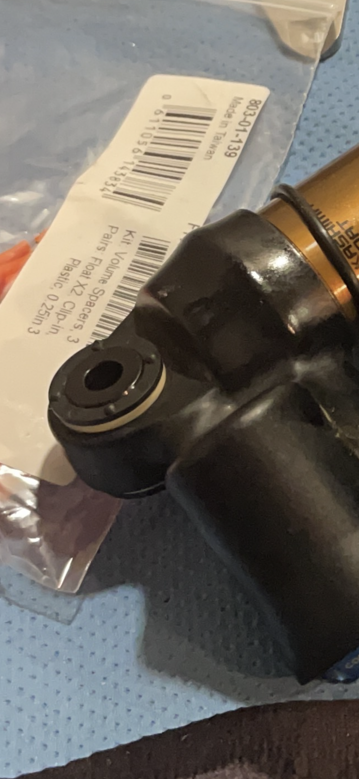

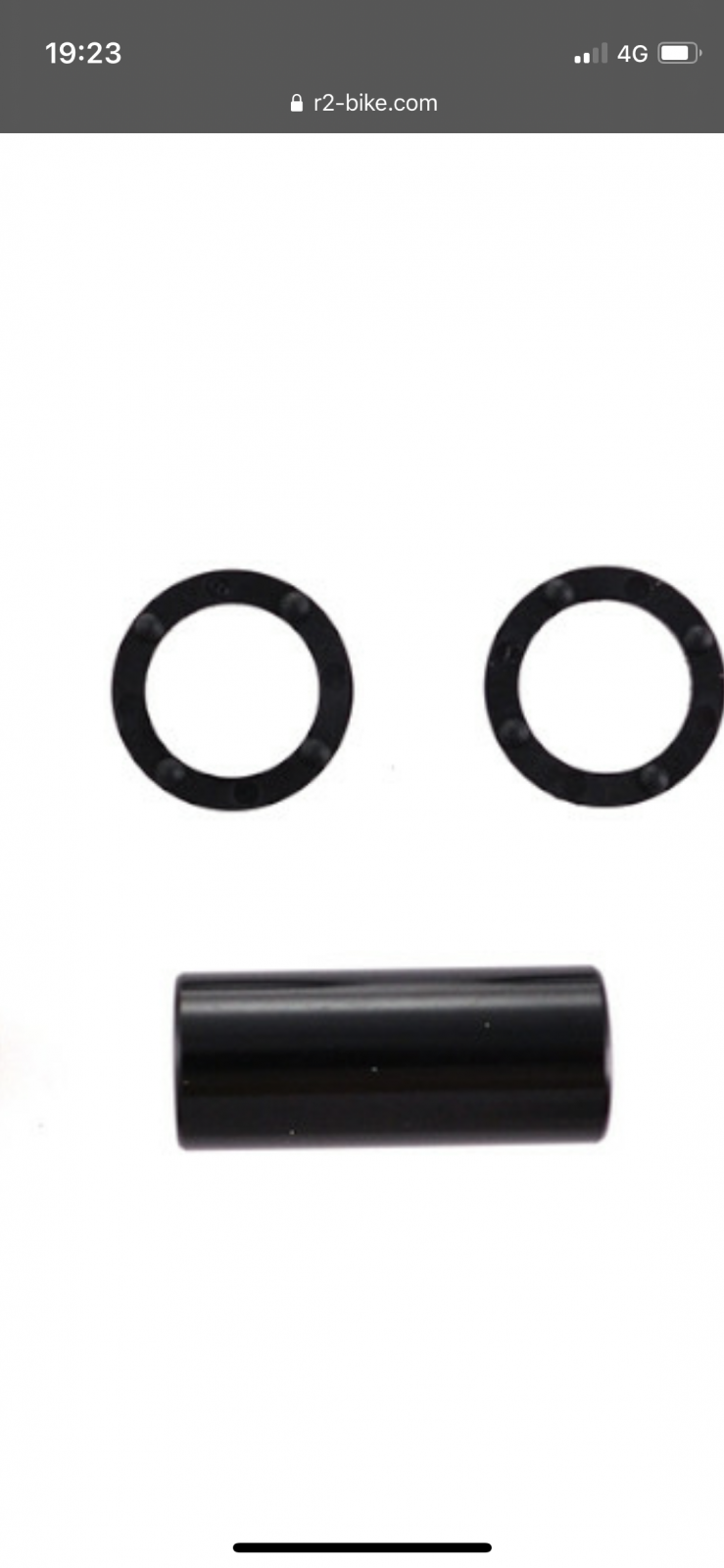

Hi everyone I inatalled it that way. I had previously the same frustrating issue to find the correct bushing kit. I bought the 20mm 6mm 7pcs kit and used only the 20mm black axle, the yellow bushing caps with flanche and for fitting i just put the two small black end caps with four round plugs on it on to the bushings. Befor I used it also with the older DU bushings. But for better maintenance I switched to the bushing kit without the DU bushing. Which is better I do not know

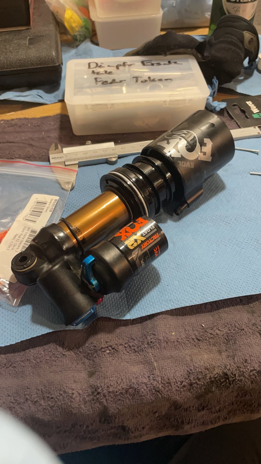

I bought new shock Fox Float X for my Levo, now I have to buy a mounting kit, I found out that Fox has 2 mounting kits with 6x20mm size:
- 5-piece with part number 803-03-244
- 7-piece with part number 803-03-327
So which one is the right one for my shock + Levo?
Edit: I believe I found out that both should be fine, the 7-piece mounting kit should be just a newer/better design ...
