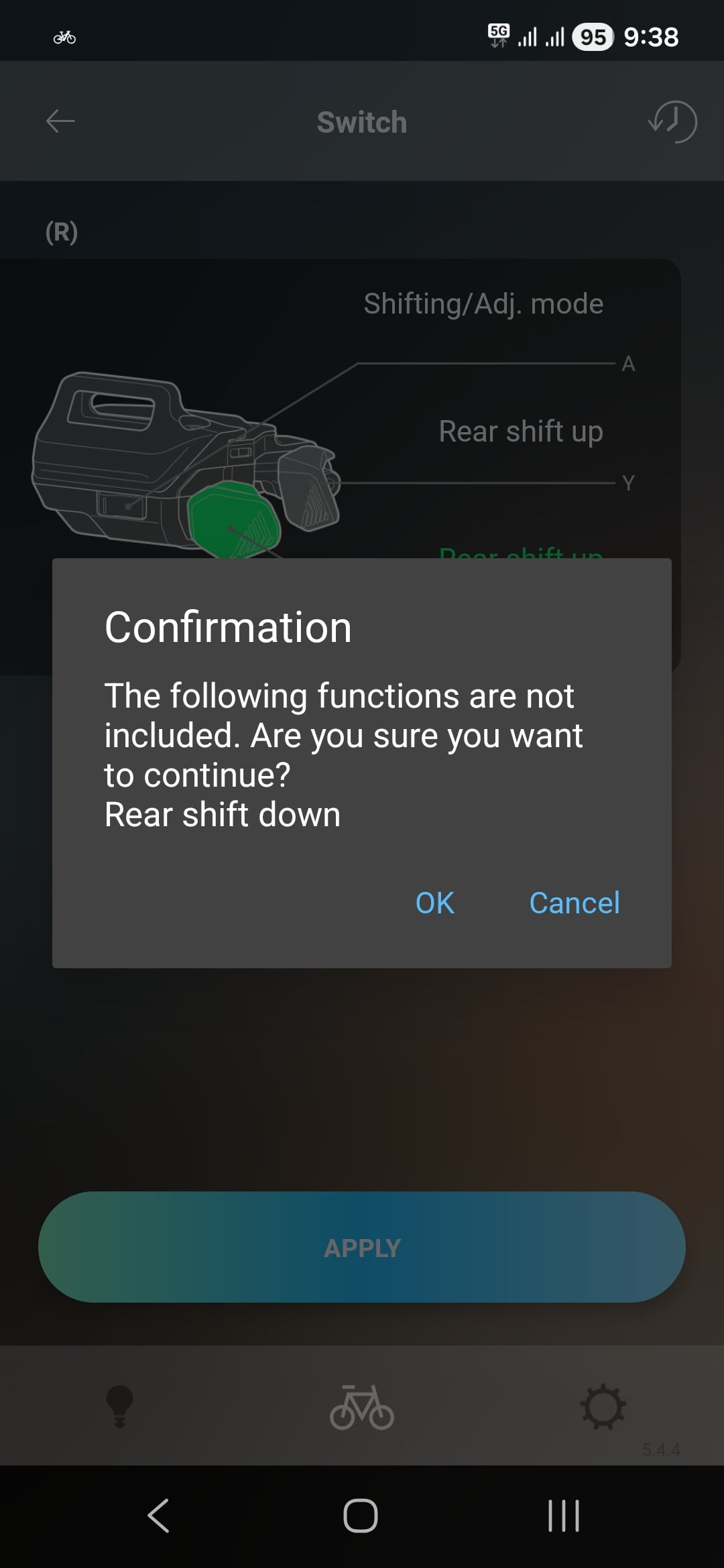

Has anyone encountered a problem where the button settings of the SW-M8250 (Di2, Deore XT) derailleur could not be reconfigured, no matter how much I changed them in the E-Tube app?

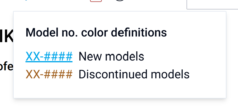

Not quite sure what this Shimano Compatibility Chart is really saying about your set up but your RD-U8050-SGS is listed in black print while the SW-M8250-IR shifter is in blue which kind of suggests they may not play together. Also I too liked the look of the XT shifter but the E-Bike24 online shop told me only the SW-EN605-R shifter is compatible with the Cues Di2 derailleur.:eek:
Maybe that is the cause of your problem.:unsure:
Blue is the new equipment. Black is old equipment. Brown is discontinued. As long as there is a downward path. They will work together.

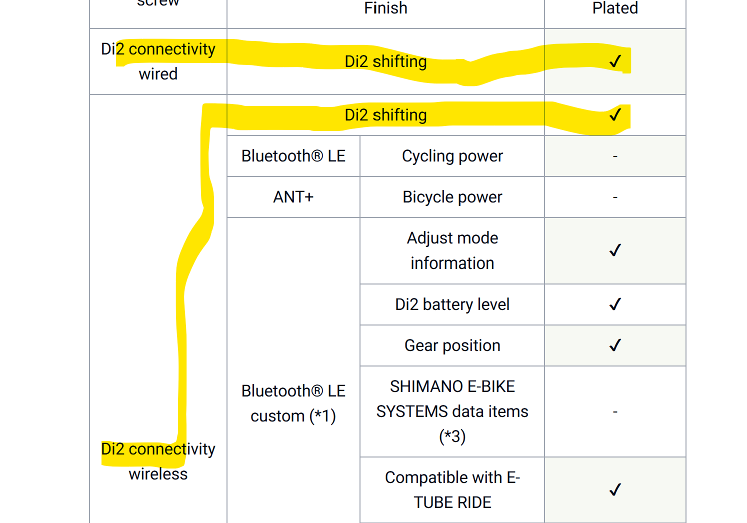

If you click on the product info for the Cues RD-U8050-GS. It says it has both wireless and wired Di2 shifting. So it should pair with the new wireless shifters. This is backed up by the compatibility chart.
The other thing is, I don't think he's having trouble pairing them. I think he's saying he's having trouble reconfiguring the switches. For example making the front button gear up, instead of down.

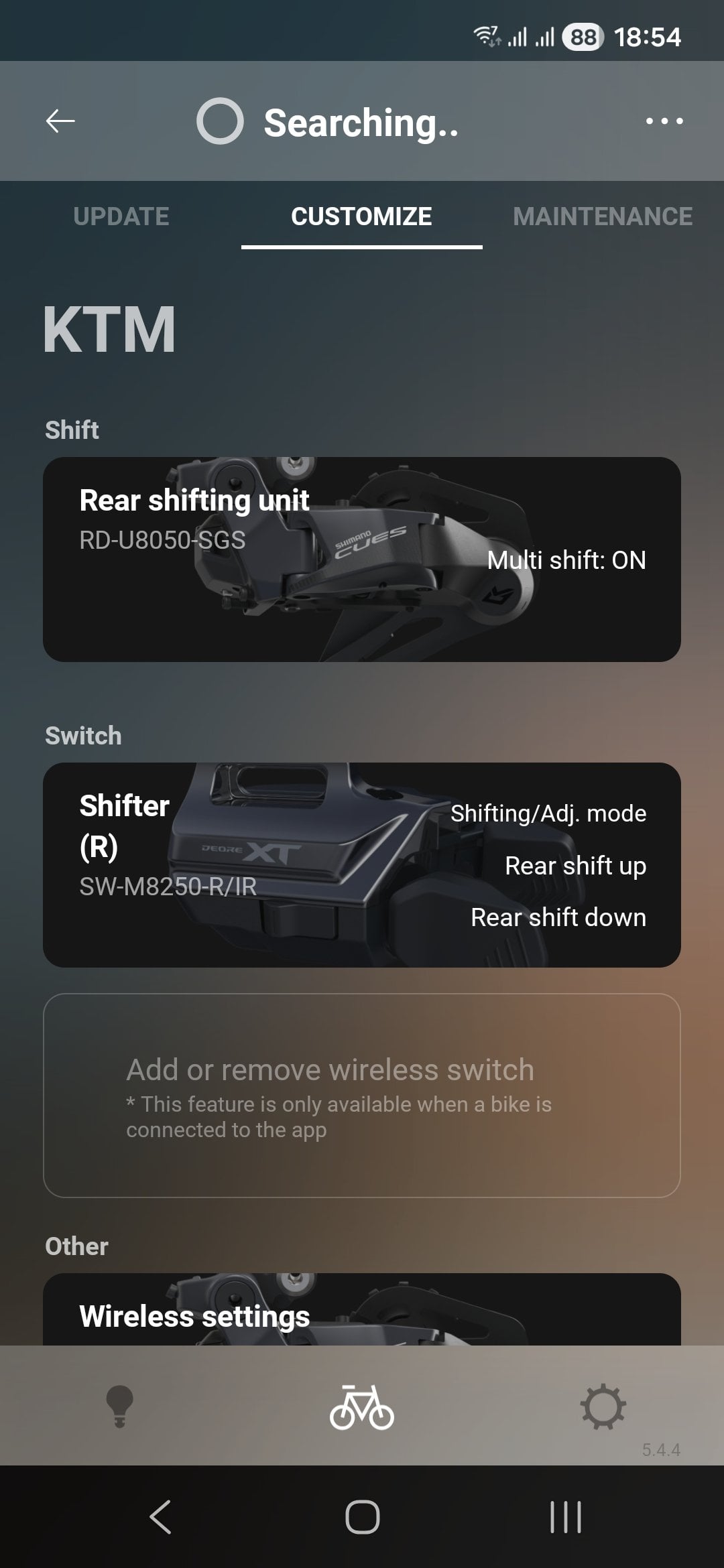

Sorry guys for the late reply. In the meantime my problem has been solved, actually I only had to physically press the pairing button on the derailleur for the software modifications to be applied. 😅
And as you can see abowe in the picture, of course the Cues derailleur (RD-U8050-SGS) works perfectly with the Deore XT switch (SW-M8250). 👌

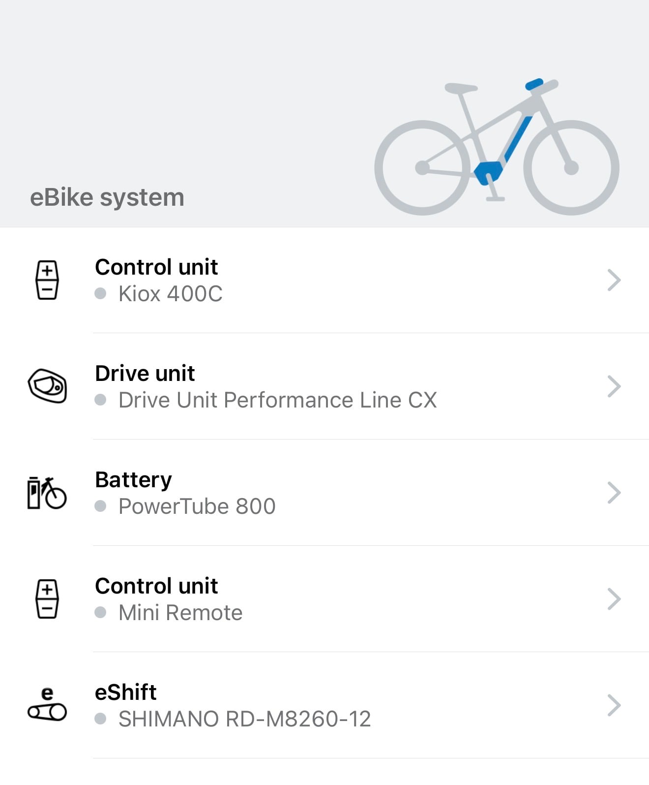

Got the M8260 XT di2 installed on my Bosch Crestline. Pretty much plug and play, the Bosch Flow App found the new hardware straight away.
I’ll try it out tomorrow, hopefully coast shift works.

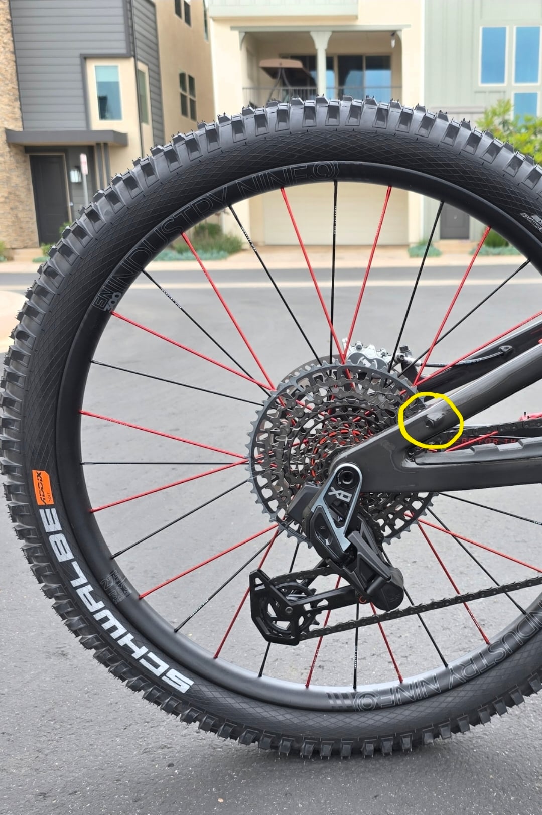

I was able to procure a SRAM AXS Eagle EP Battery Cable Extension Cord Bosch for my SRAM XO rear derailleur so I won't have to recharge my rd battery. Do you know if the Crestline has internal cable routing? Did you feed yoyr Shimano XT Di2 cable into this port? Any information would be much appreciated!
