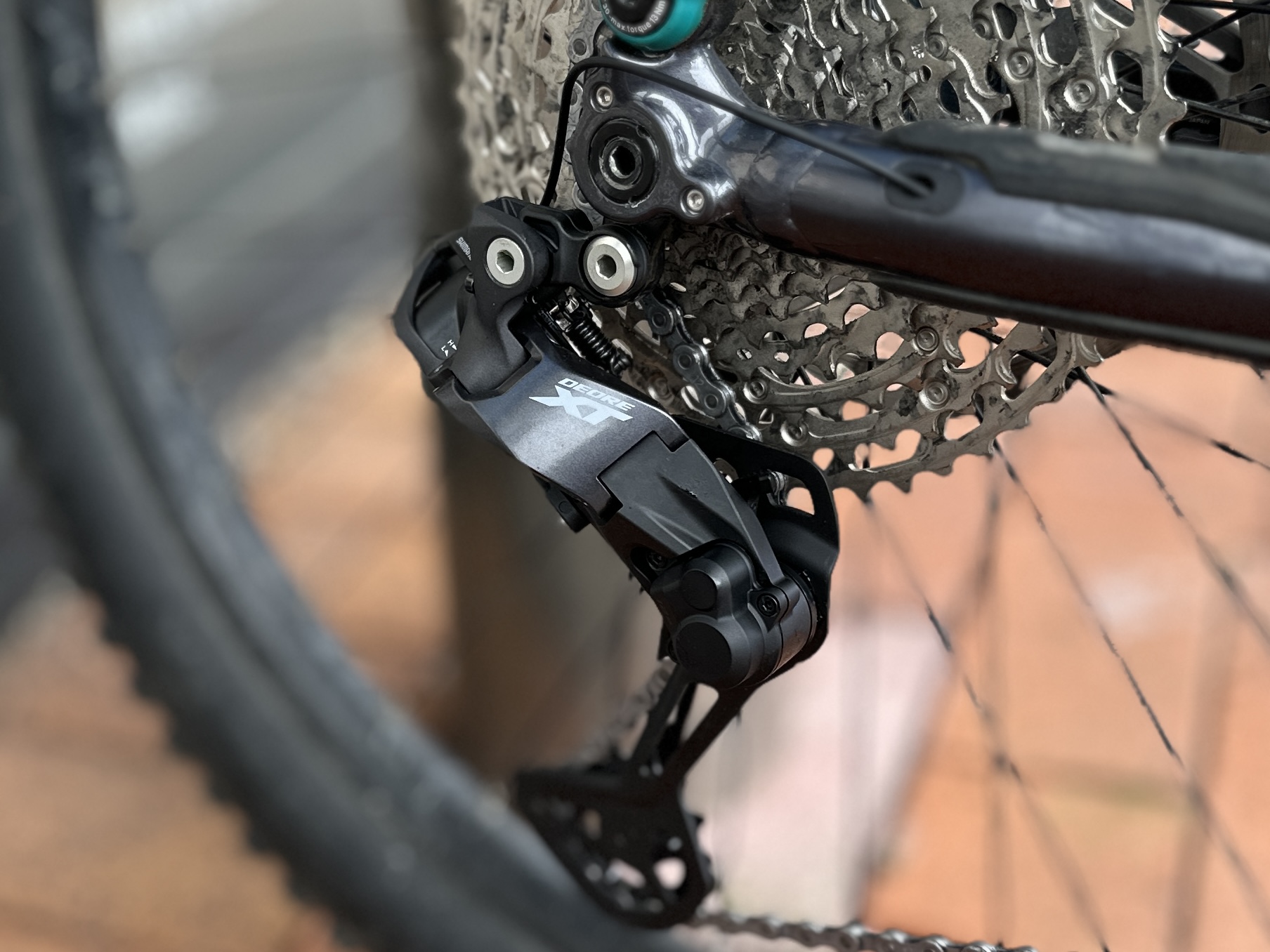

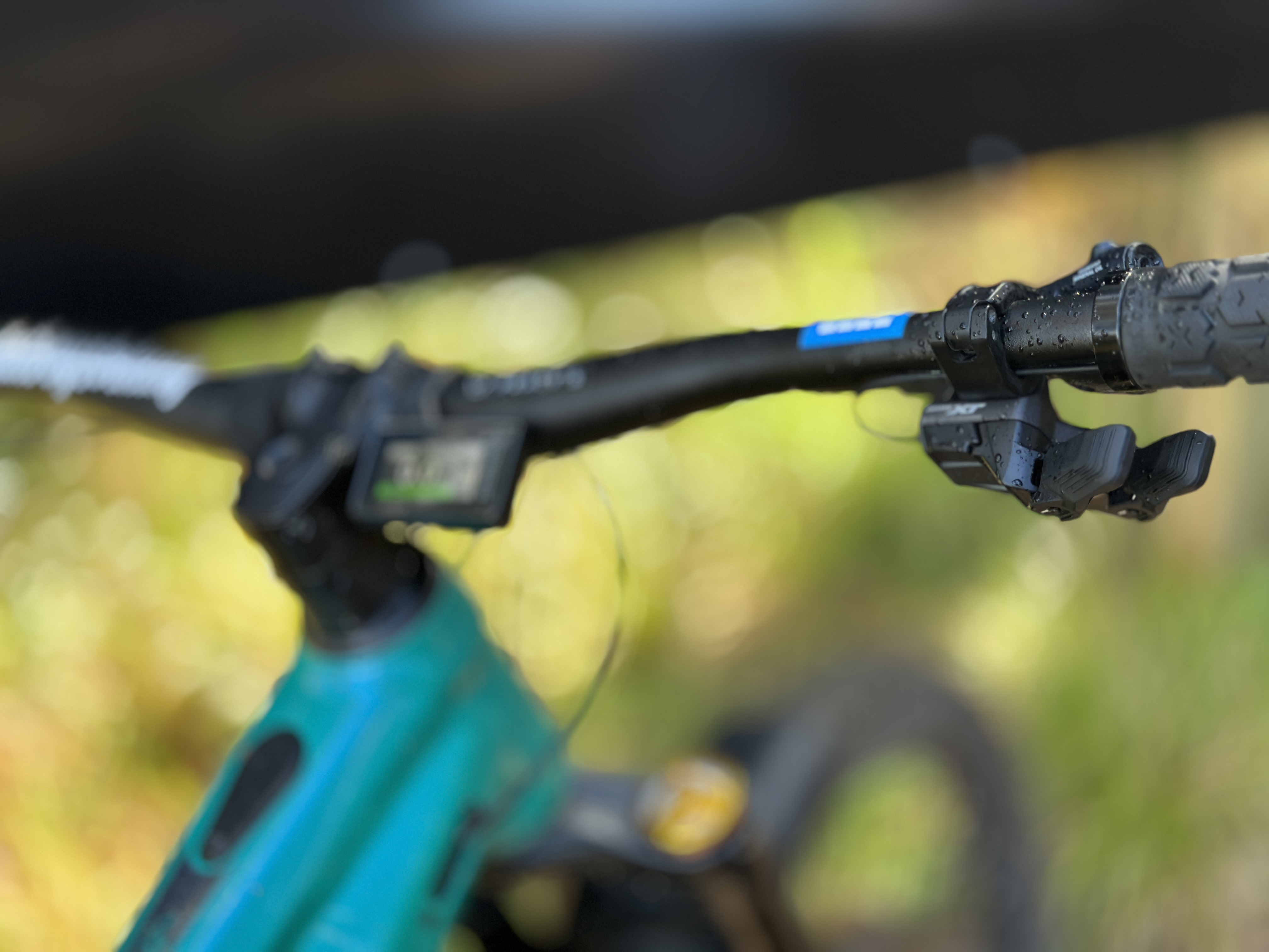

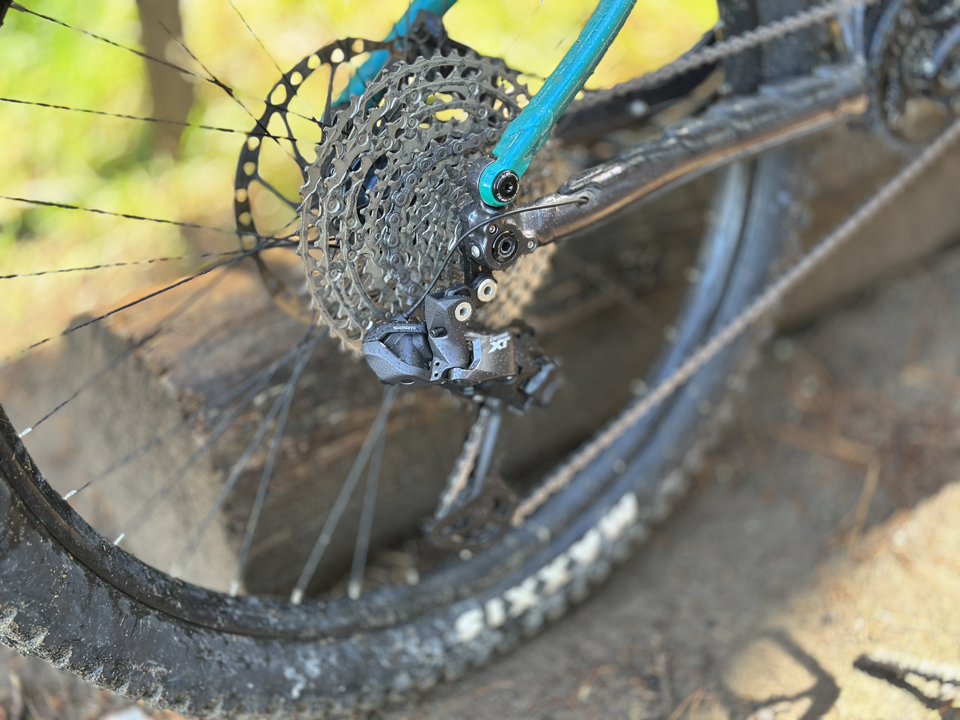

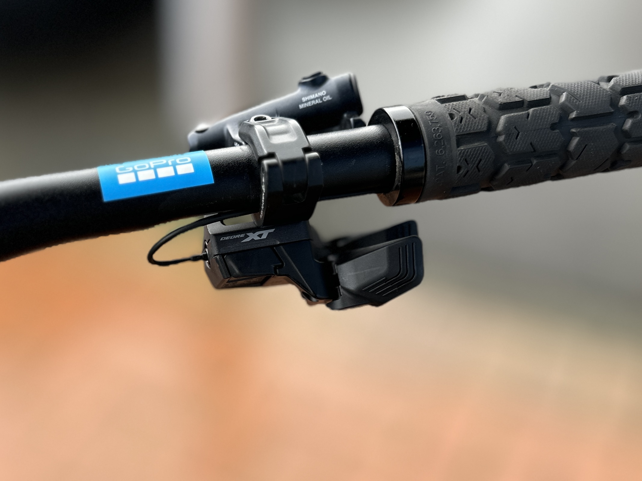

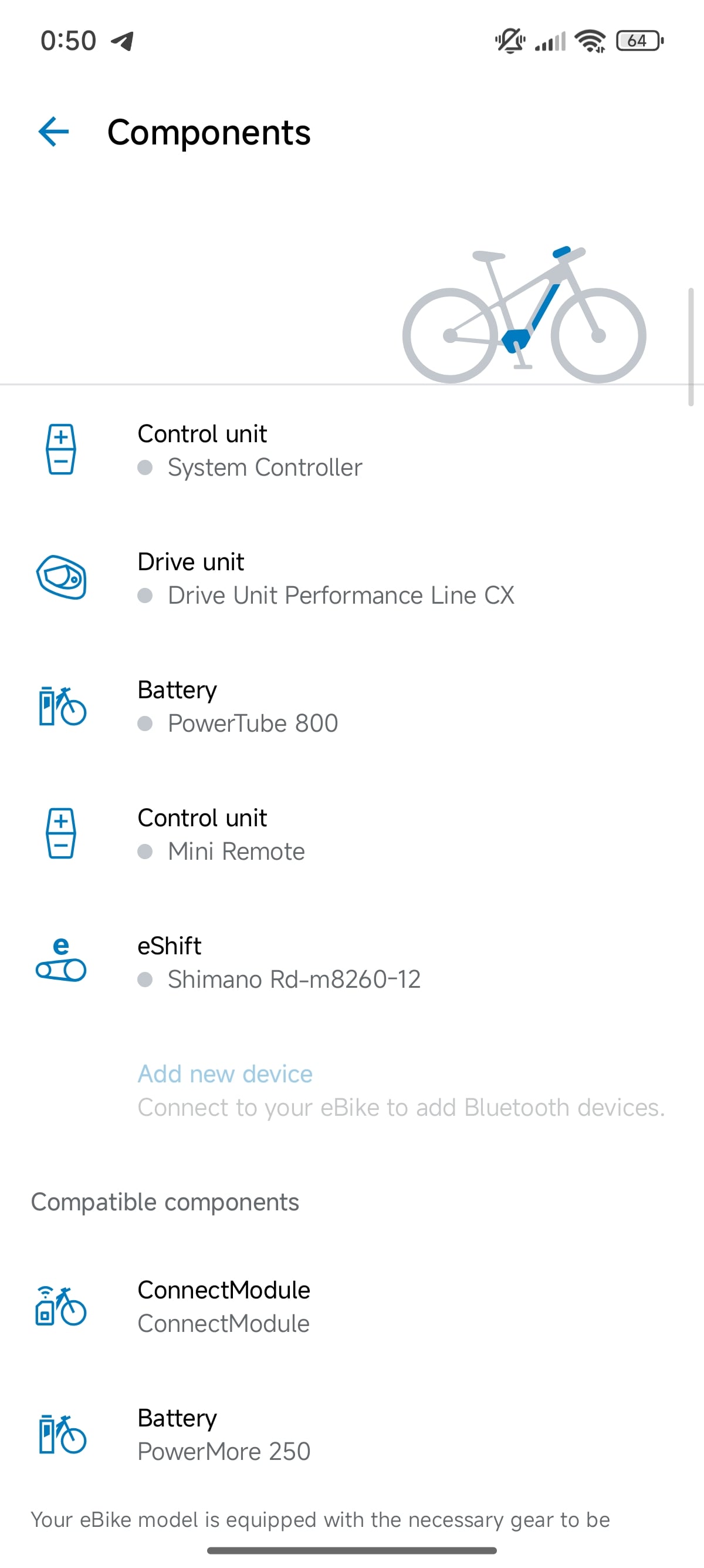

In case anyone's interested, I installed a Shimano XT Di2 M8260 drivetrain. It also requires EW-PS300 Bosch power cables. The derailleur costs about €320, the power cable €70, and the shifter €120. Now the Bosch display shows the current gear, but since Bosch hasn't updated yet, the eshift and autoshift functions are still missing. Compared to the SRAM drivetrain, the Shimano shifter is simply excellent, shifting gears very quickly. And most importantly, the Shimano cassette and chain are several times cheaper. If anyone needs more details, just ask. I'll be happy to help. Thanks to the forum members for their help, by the way.

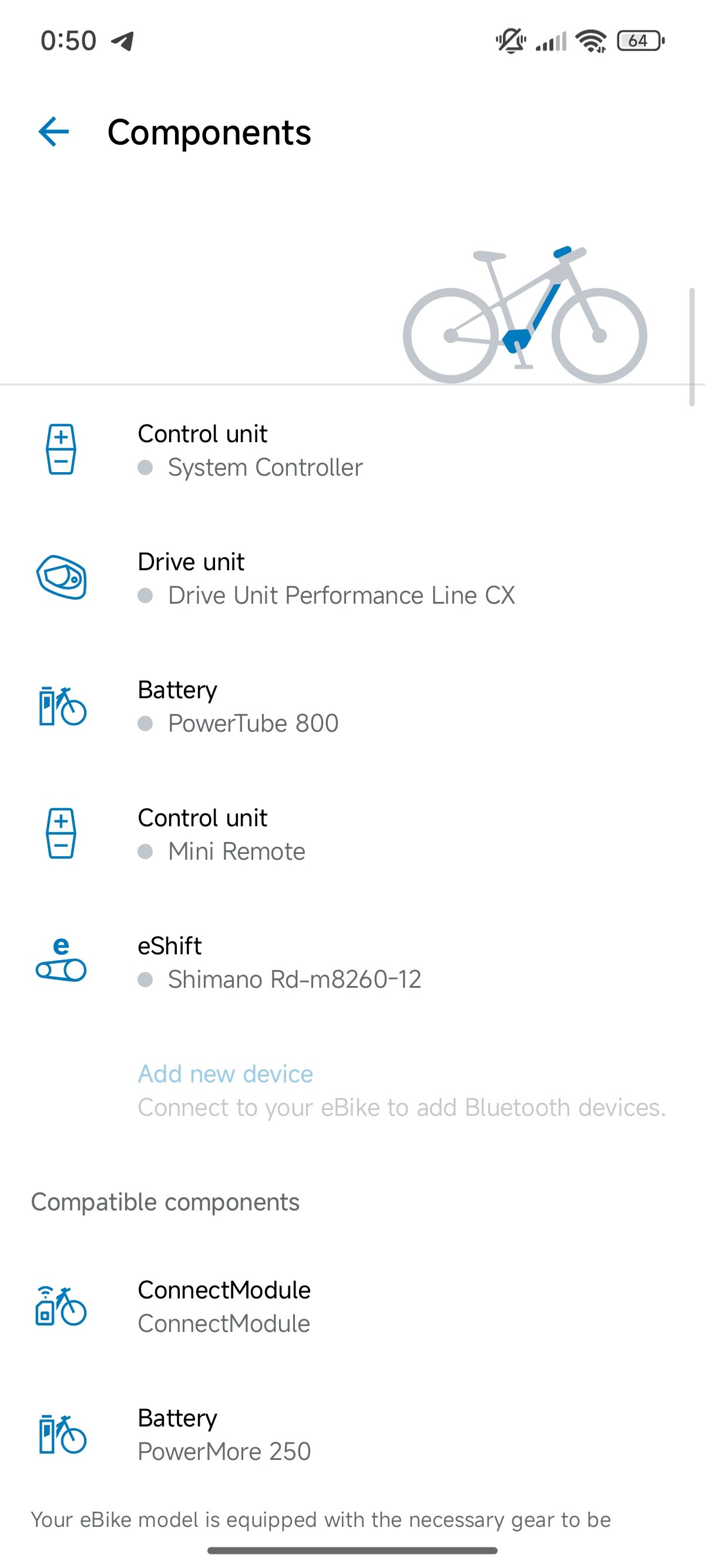

The Shimano DI2 XT M8260 not only receives power through the cable but also transmits information about the current sprocket, etc. Therefore, this cable is needed not only for power but also for data exchange. The automatic functions of Shimano+Bosch will only work with wired versions of the shifters. What did I do? I unlocked the HPP port at the dealer, then I needed to pair the shifter and derailleur via Bluetooth. There's a button on the derailleur. There are instructions on how to do this. Then you can connect the derailleur itself to the app on your phone. The functionality isn't extensive, but it's sufficient. By the way, it doesn't work perfectly for me. There are difficulties in 6th gear, but this could be due to the cassette and chain already being worn.
This is what the transmission looks like in the Flow app now. Bosch recently told me the update was planned for the fall, but it's already fall. I'm really looking forward to the update to see if it was worth the money. Naturally, I'll keep you updated.
