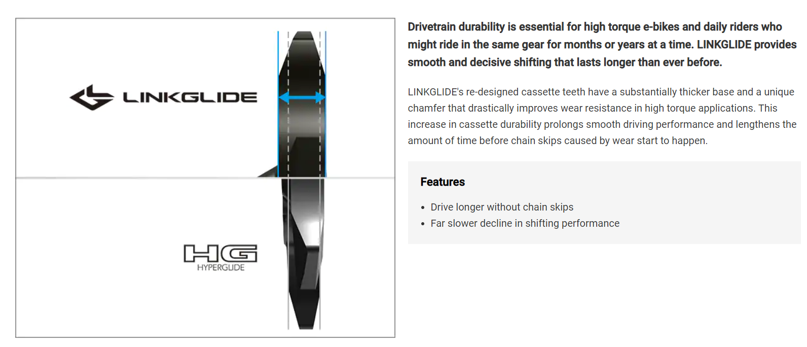

The fact that Shimano say linkglide cassettes can be run with their current HG chains says to me that the cassette sprocket teeth must still be 1.6mm thick (the same as HG) and any extra material is simply to stiffen the cassette rather than to add any actual meat to the sprocket teeth.
Heres the info from Shimano regarding this:

It's not actually clear what that rendered pic from Shimano is even showing.
Without context or dimensions it isn't particularly helpful.
We know the narrow link of a 10, 11 and 12 speed HG chain is 2.2mm.
And we know current HG sprocket width to be 1.6mm. And Shimano claim current HG chains are compatible so what is the actual width of the new linkglide sprockets that they are claiming to be 300% more durable?
Please don't just copy and paste more marketing BS.
If you think Shimano is just making things up that's fine, im just trying to answer your questions.
The diagram is showing the increased sized base of the teeth. It's also showing a bit of the newly designed chamfered teeth profile that affects how the chain ramps up and down the cassette during gear changes.
These two things when combined are what increases the durability.
The chain no longer causes such high torque against the cassette at the moments where the chain finally engages when changing gears. Those moments where it can be felt all the way through the pedal.
I've seen some videos of people with the linkglide drivetrain running, shifting through the cassette and it is much smoother. There is definitely less stress being put on the cassette teeth by the chain. That and the reinforced teeth are where Shimano is saying the increased durability comes from.
I have a feeling this video might rile you up a bit haha but Shimano shows the effect of this different ramping profile at the 2 minute point in this video. They are saying that by not causing that shock, it improves the durability of the cassette.

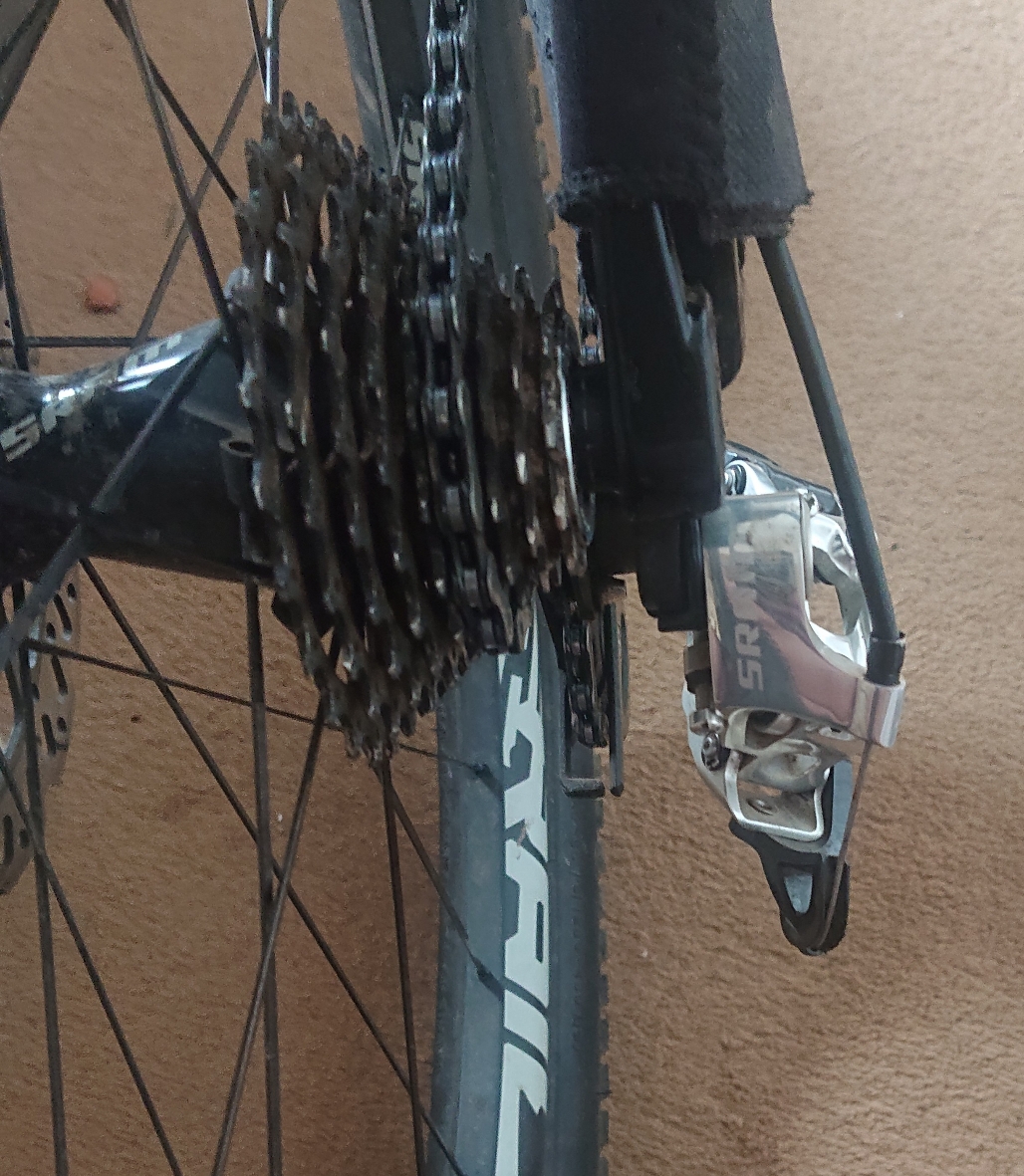

If I can at all help it I try to avoid using wide ratio cassettes on my bikes as the shifting performance and rate of wear is vastly superior.
Have you ever used a close ratio cassette on your mtb with a mech designed for smaller range?
This is the hardtail I've been riding this weekend.
That's an 11-25 cassette and an old short cage XO mech.
Shifting is vastly superior and the chain drop Shimano are attempting to lessen is already much reduced. As a much shorter chain is required chain slap is minimised and the need for a clutch in the mech is removed.
