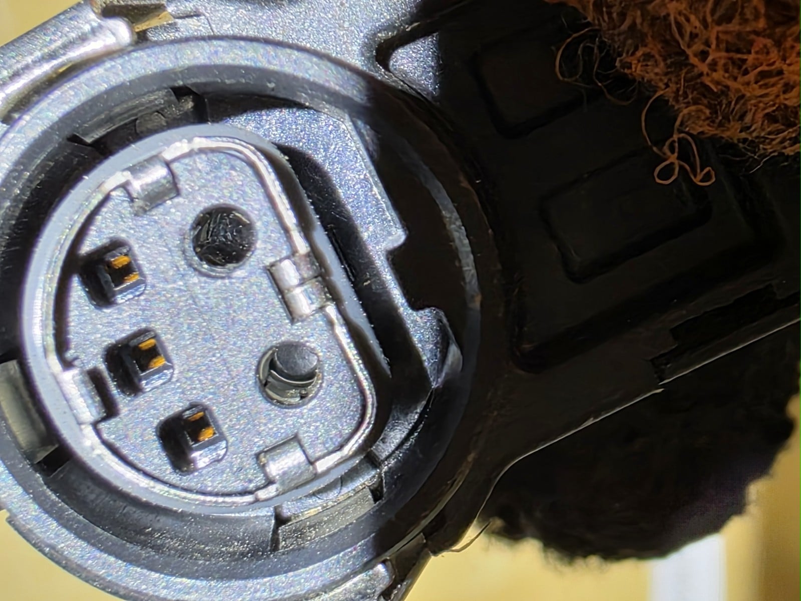

Same issue here, bike shuts down during riding randomly after 3 months after installing a new EP801 motor, no error codes. I have the standard Shimano BT-EN806 battery.
First I tried replacing the motor-battery harness (BM-EN801) but it only helped for 10 days.

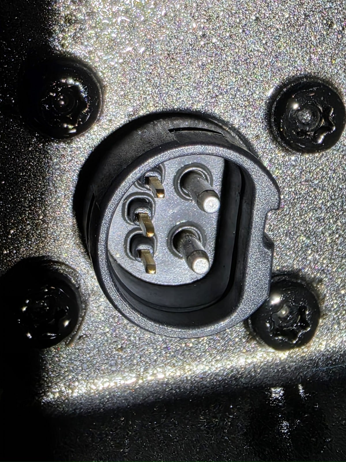

I have found the root of the issue: On the motor side the right upper pin of the battery-motor connector turns golden (some kind of corrosion?) for some reason (probably not related to humidity).
I cleaned the pin with an electric toothbush + contact cleaner spray.
I had to brush for 5-10 minutes until it had the same color (silver) as the other upper pin.
The bike worked fine for over 2 weeks after cleaning the pin, after which the bike was shut down once again and upon inspection the pin is back to golden, so I have to clean it again.

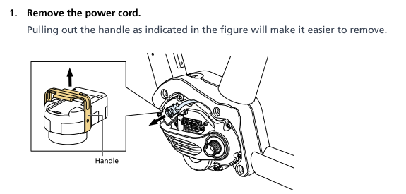

Please also check this link and especially this YouTube - video from Propain which will give some quite clever advice with an adhesive foam pad for securing the main plug on the drive unit to avoid any loose contacts (due to ongoing vibrations while riding) and increased contact resistance which then can create excessive heating and so damage the connector.
This "Rosenberger" connector seems not to be very wisely choosen from Shimano for the DU-EP600 / DU-EP801 drive units regarding the vibrations and high currents which might occur on such a drive unit while riding on the long run.
This connector also has no mechanical securing mechanism (like e.g. the former drive units from Shimano all had).
Unfortunately, the silver mechanical handle on the plug for the DU-EP600 / DU-EP801 has not any mechanical latching intention at all, but only is designed for manually unplugging the plug (see on page 34 of this document):

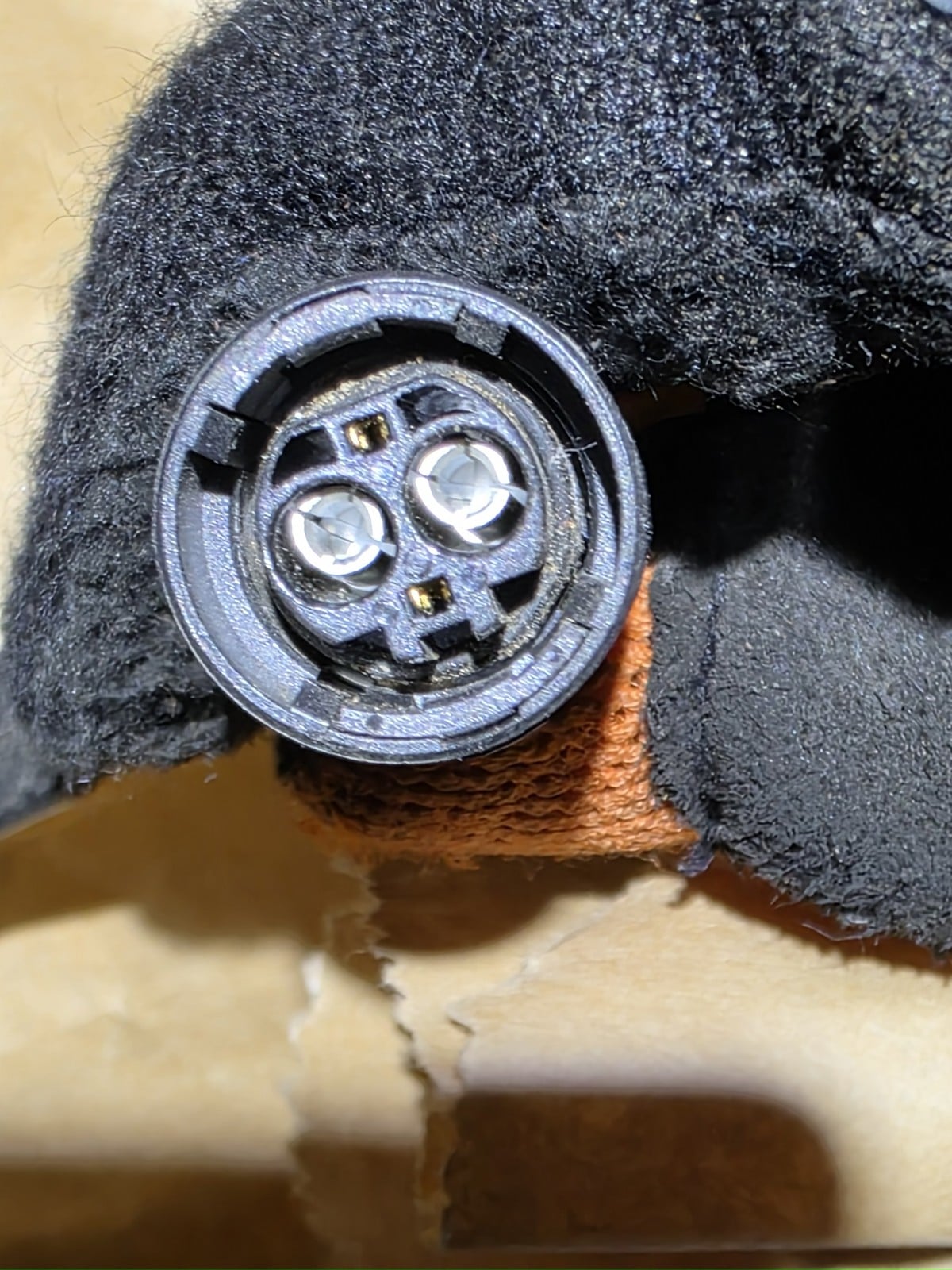

Great info, thank you.
So if the connector contact is inadequate, the contact resistance is increased which leads to overheating due to high currents and the pin turns golden, which increases the pin diameter. This in turn ruins the connector of the EP801 motor-battery harness (BM-EN801), so that even if you clean the golden pin the contact will be too lose and the issue will return (the upper round hole here is the counterpart of the golden pin, notice how it's worn out and of larger diameter versus the other one):

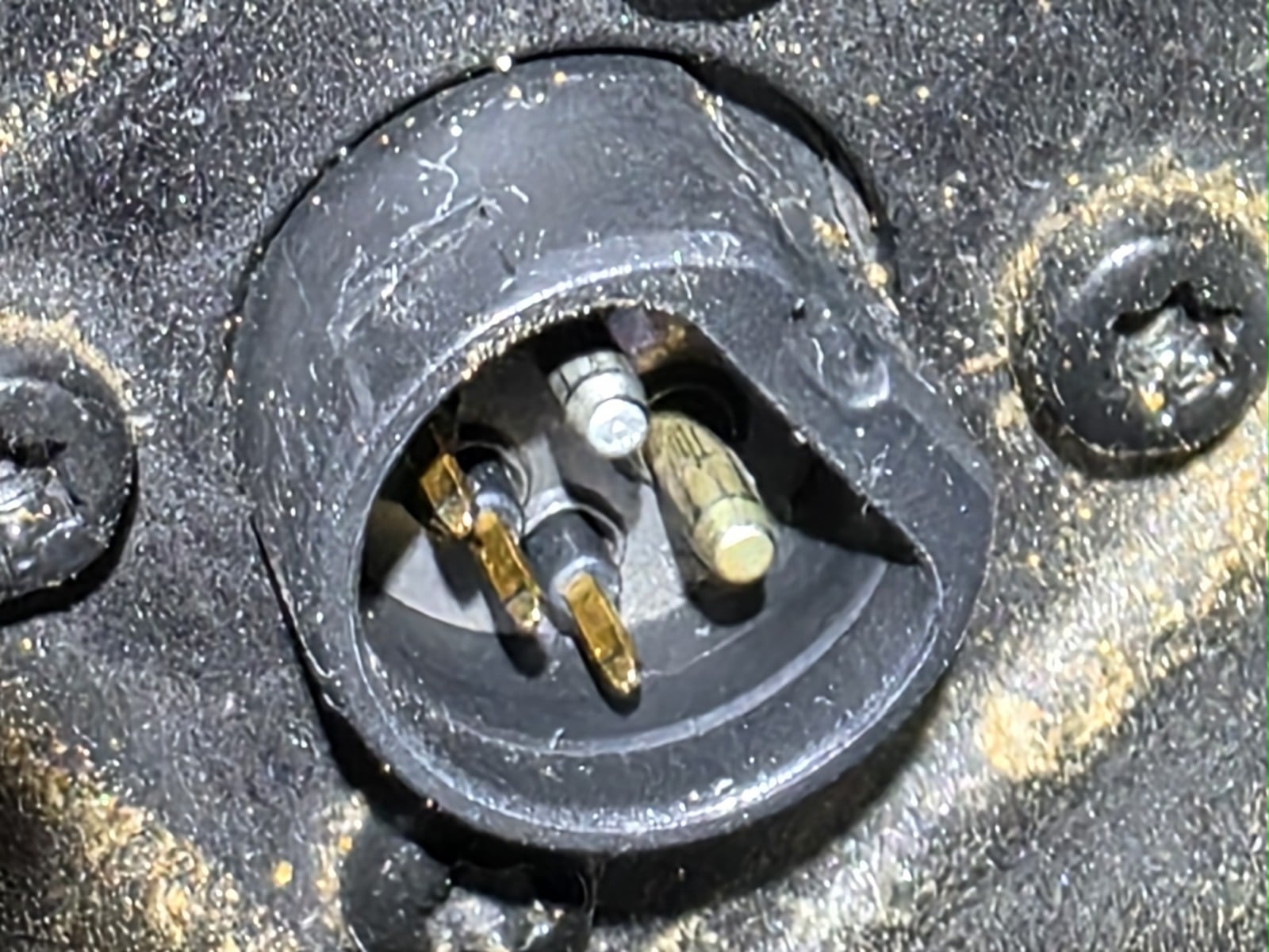

Compare this to the earlier generation EP800 connector, which is still as good as new after 4 years of usage!
Therefore in order to fix the shut down issue properly:
1) Order a new motor-battery harness (BM-EN801), don't install it yet !
2) Carefully clean the right upper pin of the motor-battery plug with a contact cleaner and 10 minutes of brushing with a modern electric toothbrush that has the new micro vibration technology (such as Braun iO series).
Before and after cleaning:
3) Install the new motor-battery harness (gotta remove the motor for this, no need to remove cranks).
4) Use a piece of foam as shown in this video to keep the motor connector fully secured.
5) (Optional) Send some strongly-worded feedback to Shimano how they managed to ruin a perfectly robust connector of EP800 in their updated EP801 motor...

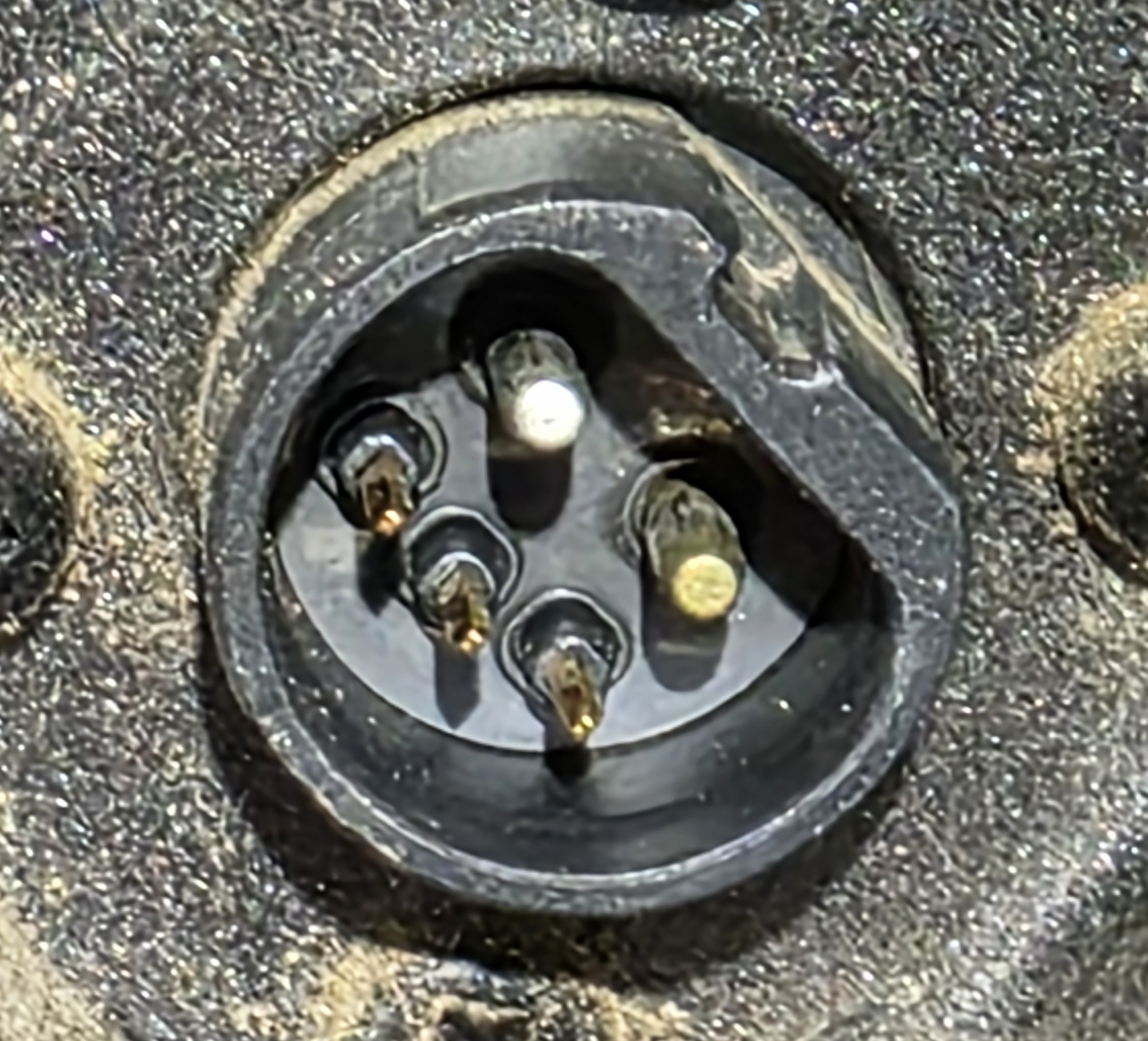

So my fix above worked for 8 months of winter riding every day without a single shutdown.
Today, the first longer (1h30mins+) ride in a warmer weather (20C+) caused a shut down, and also a second time today evening after just a 2min ride (after the bike was being charged for 1 hour).
Upon inspection, the right upper pin has once again turned to gold (oxidized), I cleaned it with contact cleaner spray and 5+ minutes of electric toothbrushing and the silver color has returned.
I also applied this compound: SR1
It's designed to prevent oxidation on aluminium, steel and copper conductors, so not 100% sure if it works on this Shimano Rosenberger plug pin, as it could be silver coated.
I will report if the issue returns, hopefully I'll get at least a few months without shutdowns.
