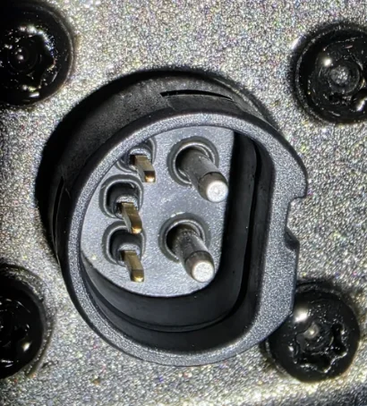

Mine look like carbon not metal. But if bike shuts off 5 times, cleaning with rubbing alcohol will reduce it to 2 times
I have 2 or 4 round pins.
No motor and new battery and new Rosenberger cable, still shuts off
The 2 bigger pins of EP801 are silver-colored when new/free of oxidation.
I noticed that contact cleaner doesn't really help (at least alone), but 5-10 mins of electric toothbrushing and the pin looks like a new again.
For some reason only the right upper pin turns to gold (=gets oxidized).
Your climate is much hotter than mine (I don't usually do long rides when it's over 25C/77F), but in your case the thermal shut down perhaps happens even if the pin isn't visibly oxidized ?
But the first thing I would do is make sure the two pins are clean (silver-colored), and maybe try applying an anti-oxidation paste on them.
On the motor they look carbon, the Rosenberger yes are silver

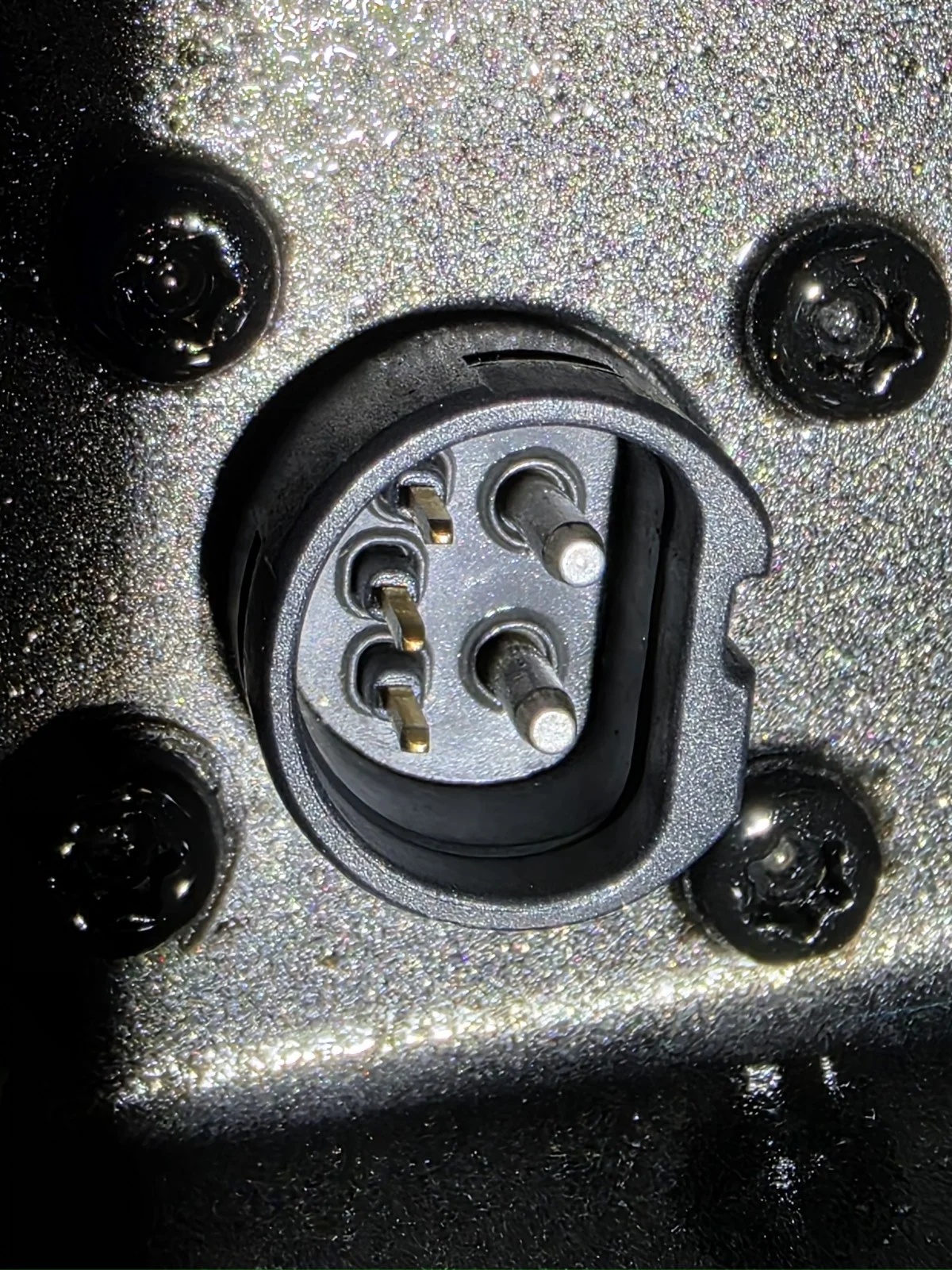

That's weird, could you upload a photo ?
Should look like this:

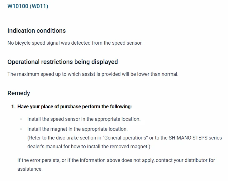

Sure, the W10100 warning wíll be triggered when there is no signal from the speed sensor detected from the drive unit (DU-EP800). In this case there will be no or only little motor support given (see also here):

I have seen dozens of DU-EP600 and DU-EP801 drive units and I completely agree to @Ted3 =>
The 2 bigger pins of the motor connector which are carrying the "heavy motor current" are silver-colored when new and free of oxidation, exactly like shown from @Ted3:
These 2 pins turn to a kind of golden color if they get (too) hot and/or oxidyzed:

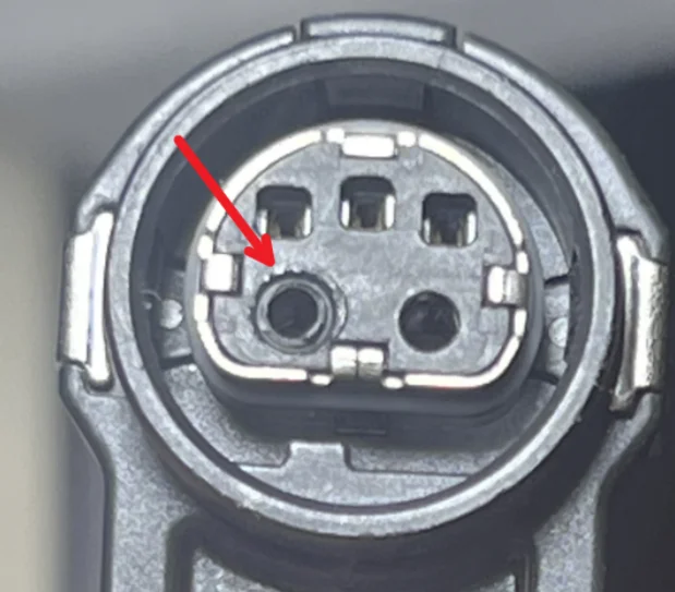

Very often the Rosenberger plug gets partly molten when the contact restistance will be to high (due to corrosion, vibration or humidity) and the contact then get too hot due to high currents:

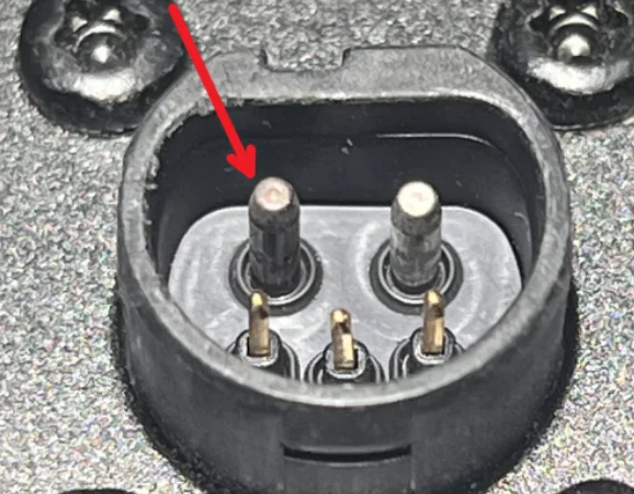

I swear mine were not silver, and looked like carbon rods. Will take pictures if i ever get in there again. I have not seen this 3rd motor however, nor did I pay a lot attention to the first, they replaced that one at 1800 miles. I was all over the second motor like a dirty shirt. I cleaned that connection many times with rubbing alcohol, which helped. Instead of shutting off 5 + times on a ride, it would cut it back to the normal 2 times. On third motor now, last ride it shut off 5 times, has not been washed in 6 months, so no water near it this year, and I crossed no creeks. What is funny is me and my buddy with identical bike both went 2-3 months with no shut offs, then mine stared on last ride again. Never had a melting socket problem like that either

Sure, the Amflow definitely is a great bike and the only eBike in town with "melting problems" is a DU-EP801 (and sometimes also DU-EP600) based bike because the main connector of these "generation 2" drive units is an absolutely design - and choice desaster from Shimano.
