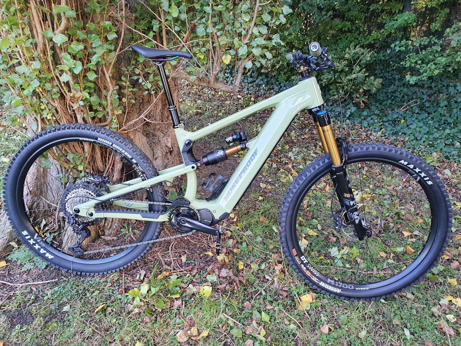

Shimano EP8 Booster testing.
You can remove the booster and tether cable with the strap to use waterbottle.
Trailwatts has been thrown around in enduro’s and extreme jumps for years by customers.
The system will drain both batteries under load sharing values. Your battery display will drop slower as invisible to bike.
As I am only altering the harness with no affect to the bikes electronics there should be no issues when motor/ factory battery need attention.
