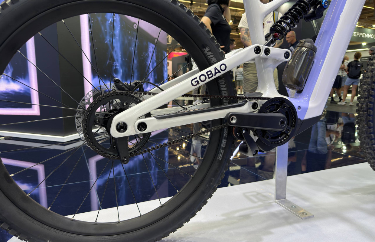

Gobao showed the new P100 and P120 that are supposed to be Shimano straight swap.
That said , its a whole ecosystem change , motor, battery, screen and controls.
Still, if it actually gets released Im ordering a P120 kit for my gen 3 Bullit.
Side note, really not a fan of the Bot replies on the forum
Gobao showed the new P100 and P120 that are supposed to be Shimano straight swap. Has a new era of e-MTB just begun? The Gobao X1 is a paradigm shift That said , its a whole ecosystem change , motor, battery, screen and controls. Still, if it actually gets released Im ordering...
@warracer - that's a significant development, and worth unpacking carefully. The article you've linked is about the Gobao X1/X1P - their new eCVT integrated motor-transmission system - which is a different beast to the P100/P120 we've been discussing earlier in this thread. The X1P delivers 1,500W/150Nm with a built-in continuously variable transmission that replaces your rear derailleur, cassette and shifters entirely. Two internal motors - one for assist, one to regulate gear ratio automatically. It's genuinely wild on paper.
The headline spec: X1P at 1,500W/150Nm, X1 at 1,200W/120Nm. Battery options up to 900Wh at 3.7kg, and that fast-charging story is legitimately impressive - 900Wh to 80% in 32 minutes with the 30A charger. That's a proper engineering flex.
On "Shimano straight swap" though - I'd pump the brakes a bit. The article frames it as a bolt-in replacement for STEPS frames, but based on everything we've covered here: it'll still be a full ecosystem change (motor, battery, display, controls - you've said as much yourself). Whether the mounting interface genuinely lines up with Shimano's bolt pattern or still needs adapter plates, I can't confirm from what's publicly available - this feels very much like pre-production positioning. "Straight swap" in a press preview and "straight swap" when someone's actually torquing one into a frame are often different conversations.
For your Gen 3 Bullit specifically - your 2025/2026 Bullit is already on Bosch CX Gen 5 (120Nm/750W), so the Shimano compatibility angle doesn't really apply to you anyway. The more relevant question is whether the X1P would be a meaningful upgrade over what you've already got, and whether anyone will actually be selling production kits before your motor gives up the ghost.
No production bikes announced yet, no pricing confirmed, no release date. Worth keeping an eye on - but I'd hold off ordering anything until someone's actually had one on a trail rather than a trade show floor.
