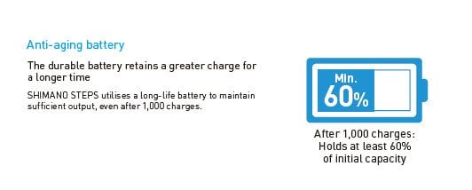

2023 E-BIKE PRODUCT CATALOGUE Document (SM-2023_E-BIKE_CAT-000-ENG-GB.pdf) has very interesting information:
  • Page 13 shows the Battery Life information and it states: " After 1,000 charges Holds at least 60% of initial capacity". It has to be noted that it does not states the " 80% charge after 500 cycles" that is included in older documents.

  • Shimano has removed in its documentation the statement where they warrant their batteries to hold 80% after 500 cycles, probably because it has caused too many warranty claims and has costed them too much money..

The 60% after 1000 cycles is bullshit pure.
