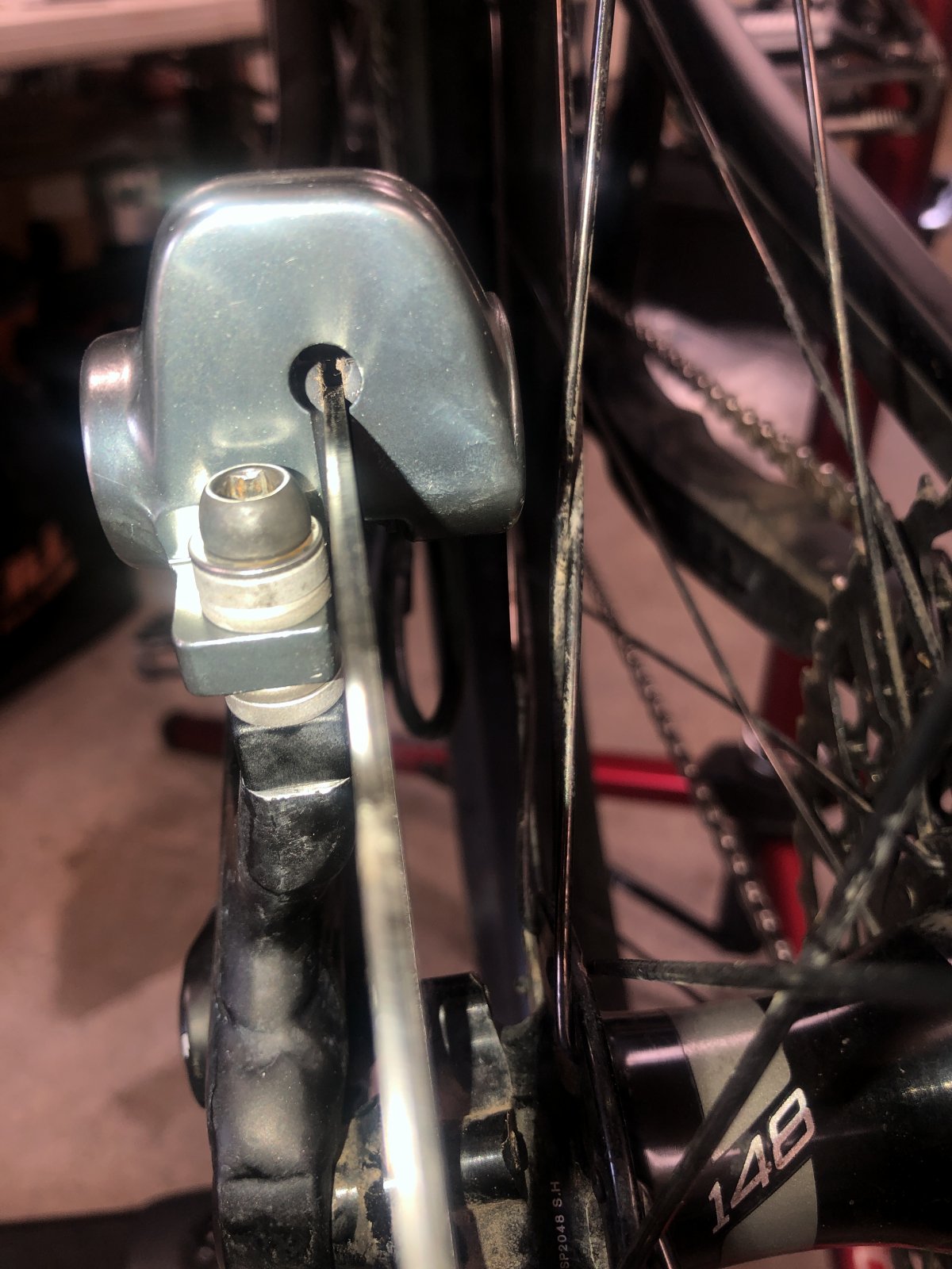

I'm switching out the Guides with 200mm discs on my 2020 Turbo Levo Comp to a Sigura setup and have a question about the caliper mount.
I went with the Magura MT7 with 203mm discs and thought I would have to change the adapter (or add a washer) to accommodate the extra 3mm diameter. However when I mounted the caliper on the original 20mm spacer I can still see some pad above the disc. Adding 3mm to the spacer would only make this worse. It would appear that the caliper should come down if anything.
There does seem to be pad contact to the bottom of the outside ring of the disc - another reason to leave it as it is, I guess.

To be clear, it appears that the caliper is too high, rather than too low, which is the opposite of what you would expect with a larger disc.

As for spacing from a 200 to 203mm disk I needed a 1.5mm washer at the front and a 4mm washer at the back. I used the deeper of the 2 conical washers for this.
