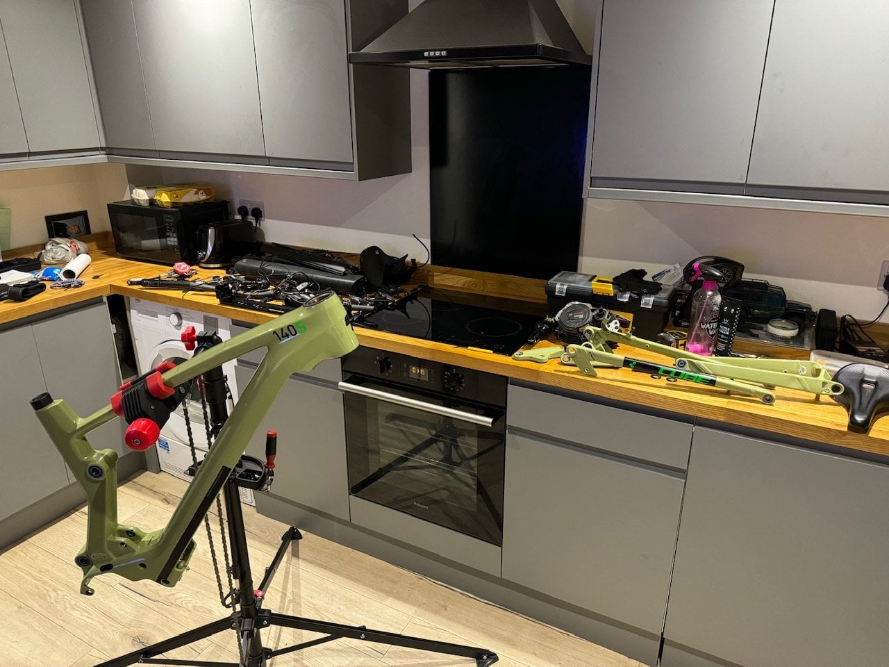

So I finally got round to servicing the bike
Where’s good for service kits for the fork, shock and motor? Also bearings? I’ve got a few gritty ones, mainly the frame and shock linkage. Headset and rest of rear triangle are still nice and smooth.

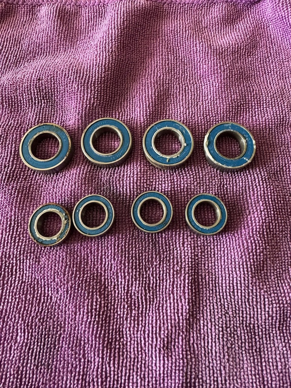

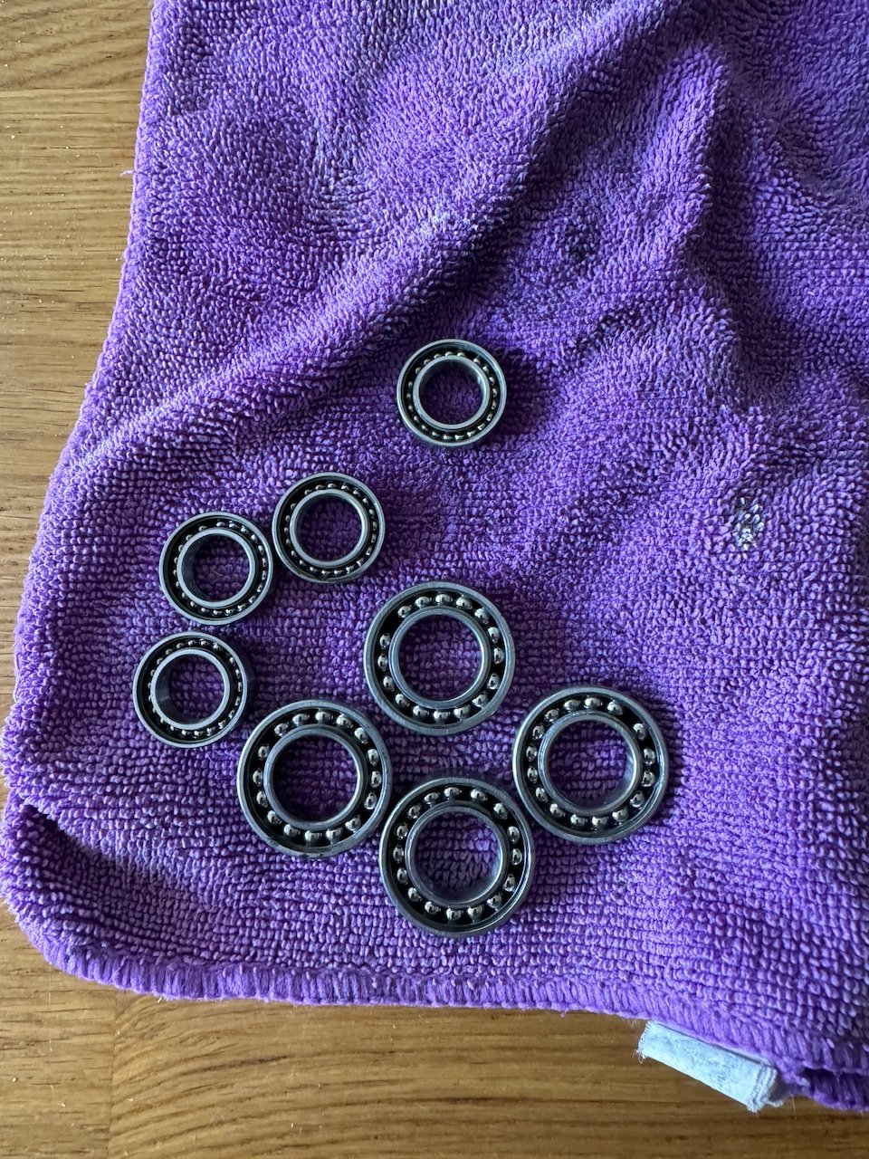

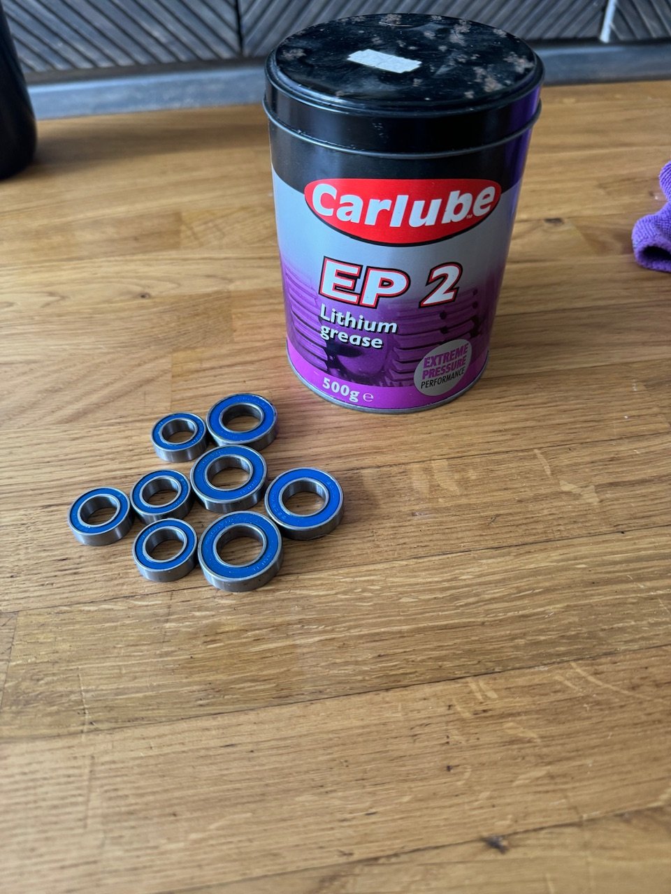

So being as impatient as I am I decided to give cleaning the bearings a go so I can start putting the frame back together. Used parrafin, isopropyl and compressed air to clean and repacked with some lithium grease I had laying around. Really pleased with the results.
Edit: put them in the bike and they made noises they didn’t when I had them in my hand. Packed some more grease in and all is well.
