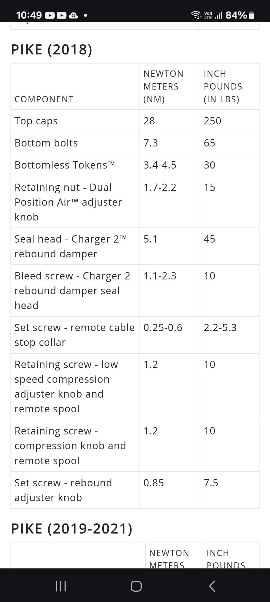

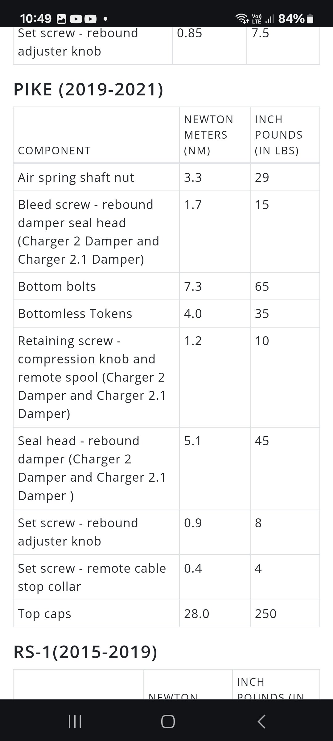

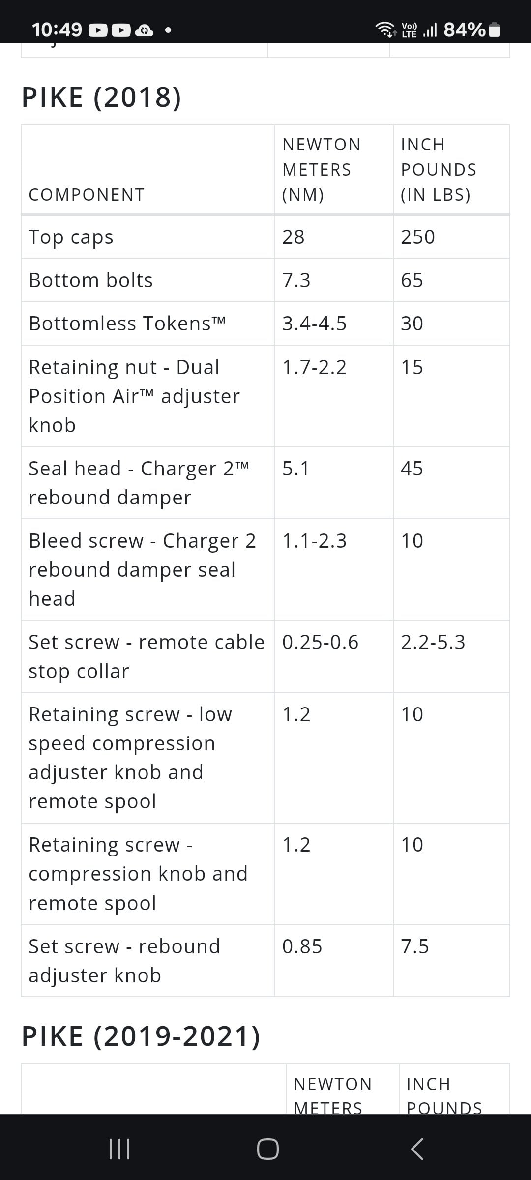

I thought they were 28nm
That sounds like a correct figure to me. However, I remember clearly that it was 40Nm on the Pike that I first removed the top cap. I remember it because I thought it was a stupidly high figure. 40Nm is the same as for a bottom bracket or the cassette lock ring, but they well designed for the spanner/lock ring to get hold of, not thin alloy flats!
I was bricking myself at my first attempt to remove the cap. It sure felt like it could have been 40Nm. I made no attempt to retighten it back to 40Nm, just to what felt to be "tight enough". But I slowly gained sag over the next few rides, so it wasn't tight enough! I didn't have a torque wrench big enough so I just increased the tightness a little bit. That stopped the leakage, but I have no idea how tight it was.
This is what I work from Steve
Pretty much the same for most of the forks

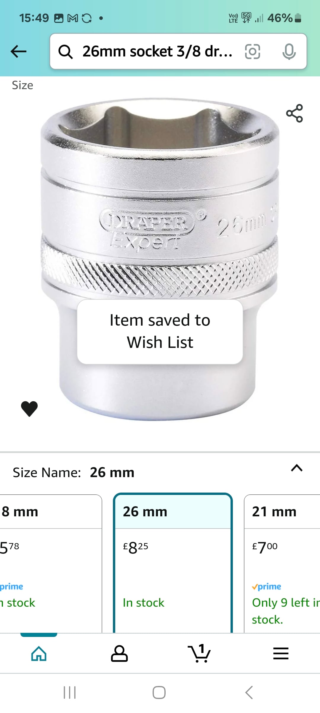

Well I only have 27mm sockets and need 26mm. I reckon I’ll end just using an adjustable spanner and going FT.
That is a risk too far for me. I reckon the top cap has such small flats that all six flats are required to loosen them. Two flats is 2/3 too few. :eek:
I’m a plumber. A 6” Bahco adjustable is like an extension of my arm! I’d get it off and back on no problem. Just not sure I’d torque it up enough without marking it.

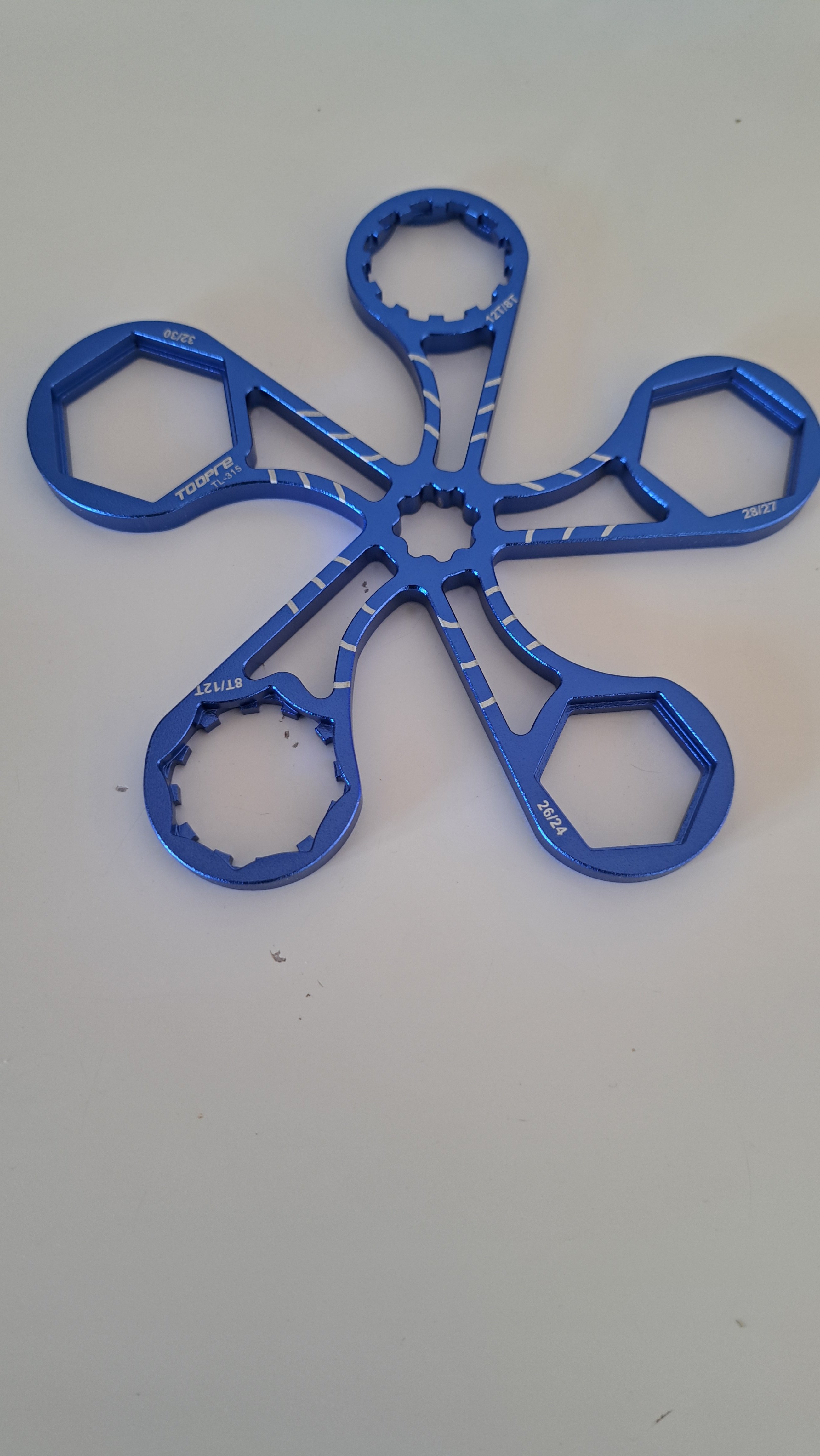

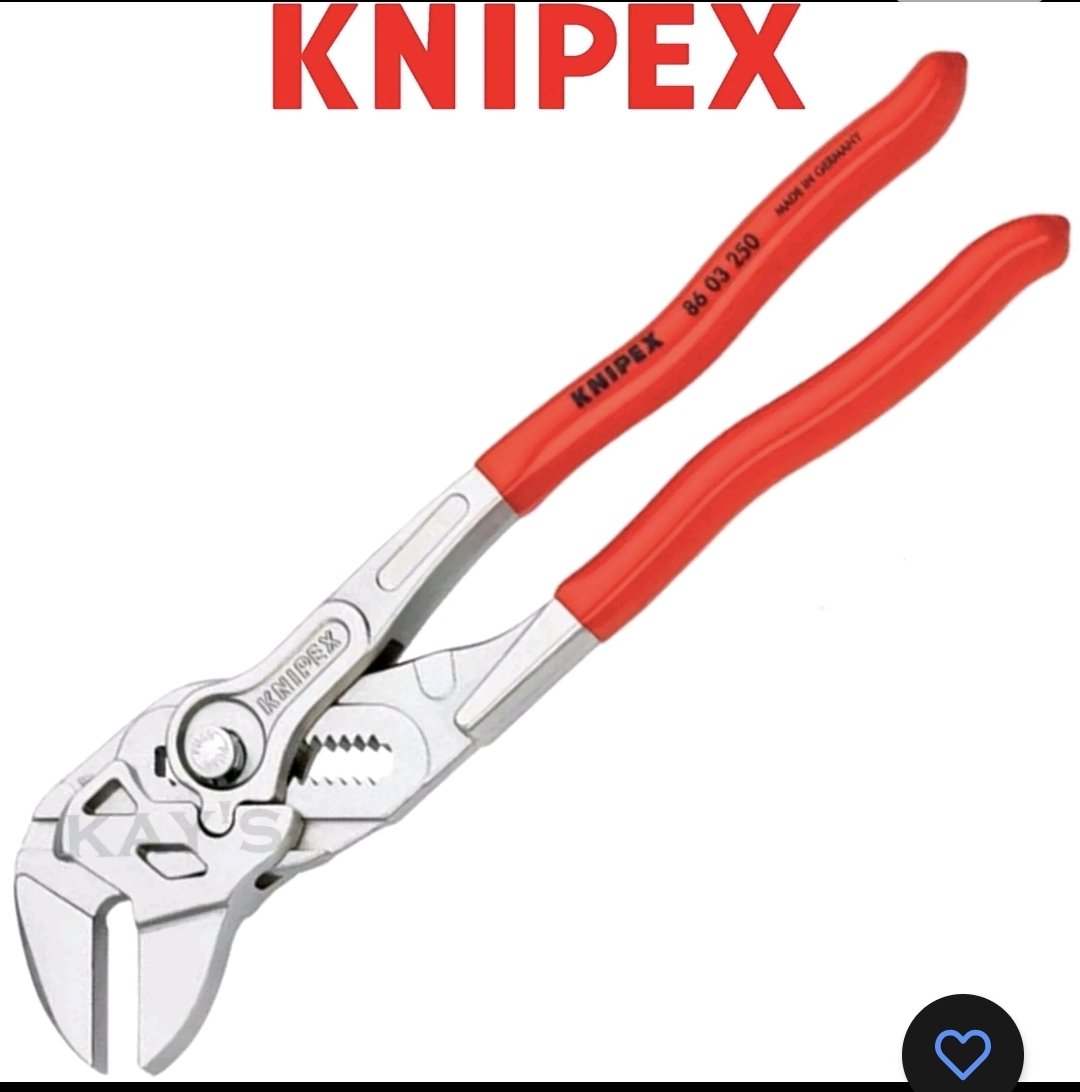

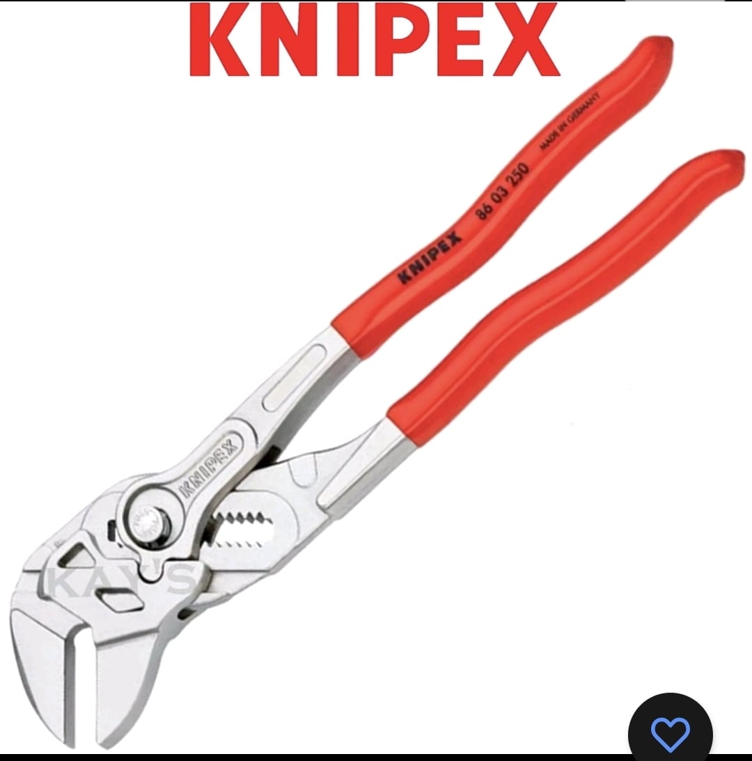

Plumbings part of the company I work for we use these for chrome work and these would be the only thing I would ever at a push use on the bike

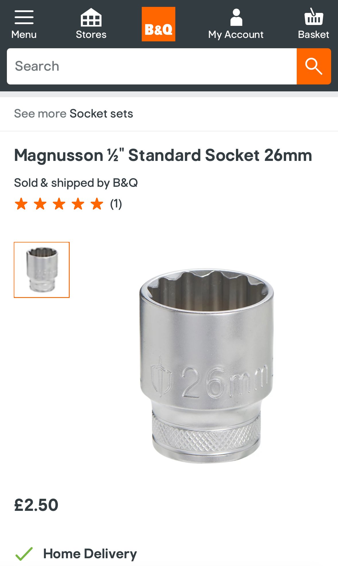

I don’t intend to use the adjustable but it’s definitely do-able. I refused to buy the park tool socket from tftuned for £8 so now, as a matter or principle, I need a cheaper solution. Found this at B&Q so will be paying a visit tomorrow
