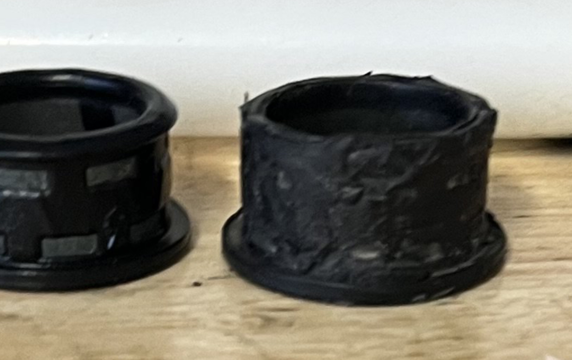

Well shit. 5 mile ride had it backing out. Just as the weather is clearing. Time to see how fast I can get some new bushings.
How are these bushes supposed to attach? Friction onto the frame?
One can buy a tool from Cyclus Tools to mount or remove these bushings.
The above shop also sells the mounting bolts for the Bosch gen5 motor (BDU38xx)
… and the bushings, although they are described as meant for the Bosch SX motor, but look identical (send them an email to make sure)
How much is that in freedom bucks?! Appreciate it, got a claim in with SC Bikes but with the holidays....ordered a set just to have.

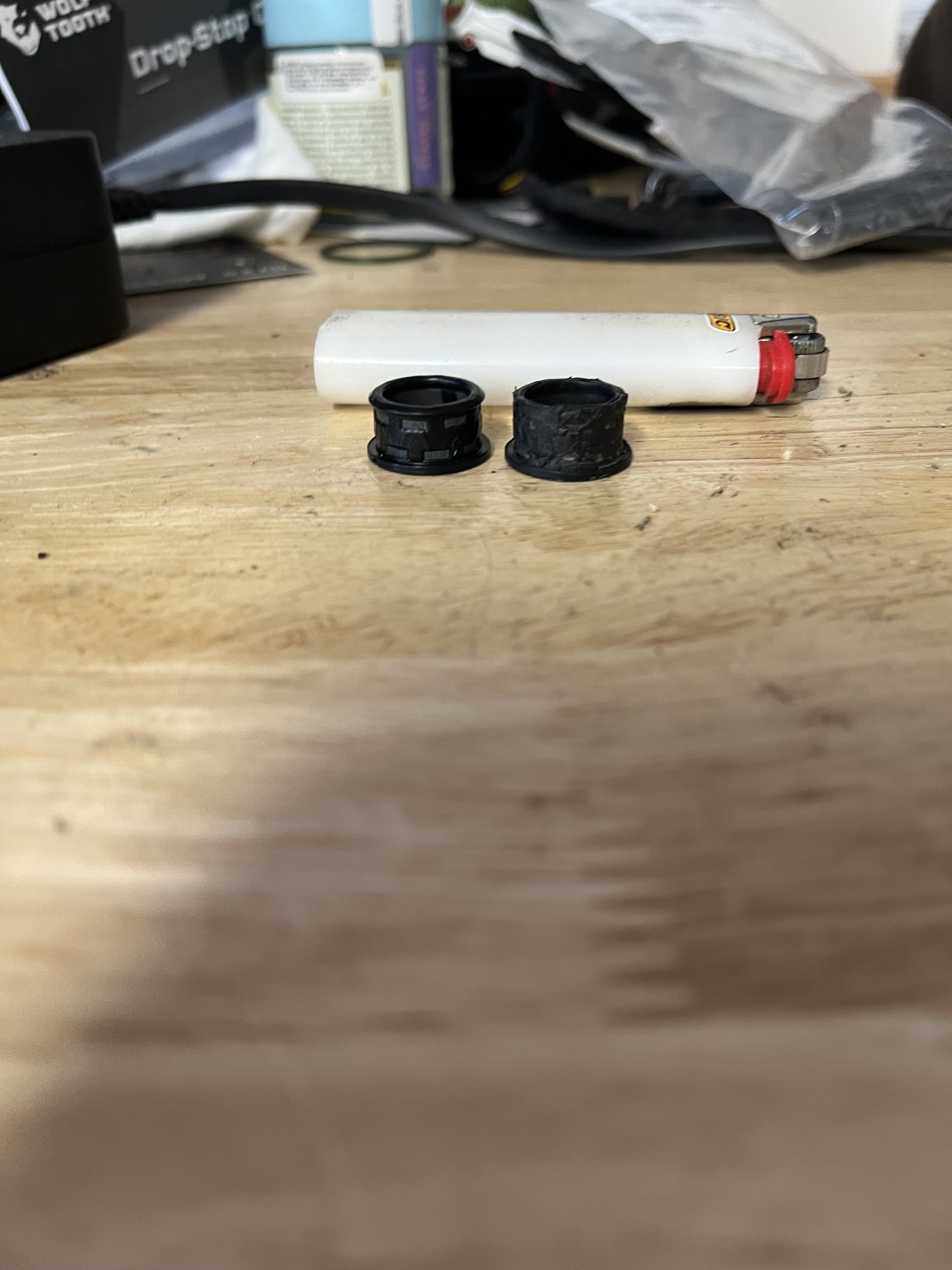

Following up on my previous. Ordered some new bushings from Euroland ( thanks for the tip Shark58! ) that arrived today. Same day as Sc Bikes has one available due to the holiday break. New vs old.
Hard to say why it happened. The inner lip locks into the frame and maybe it was damaged from the factory? Took no chances and ordered 6 of them!
The old bush looks like it has the remains of adhesive or something on it?

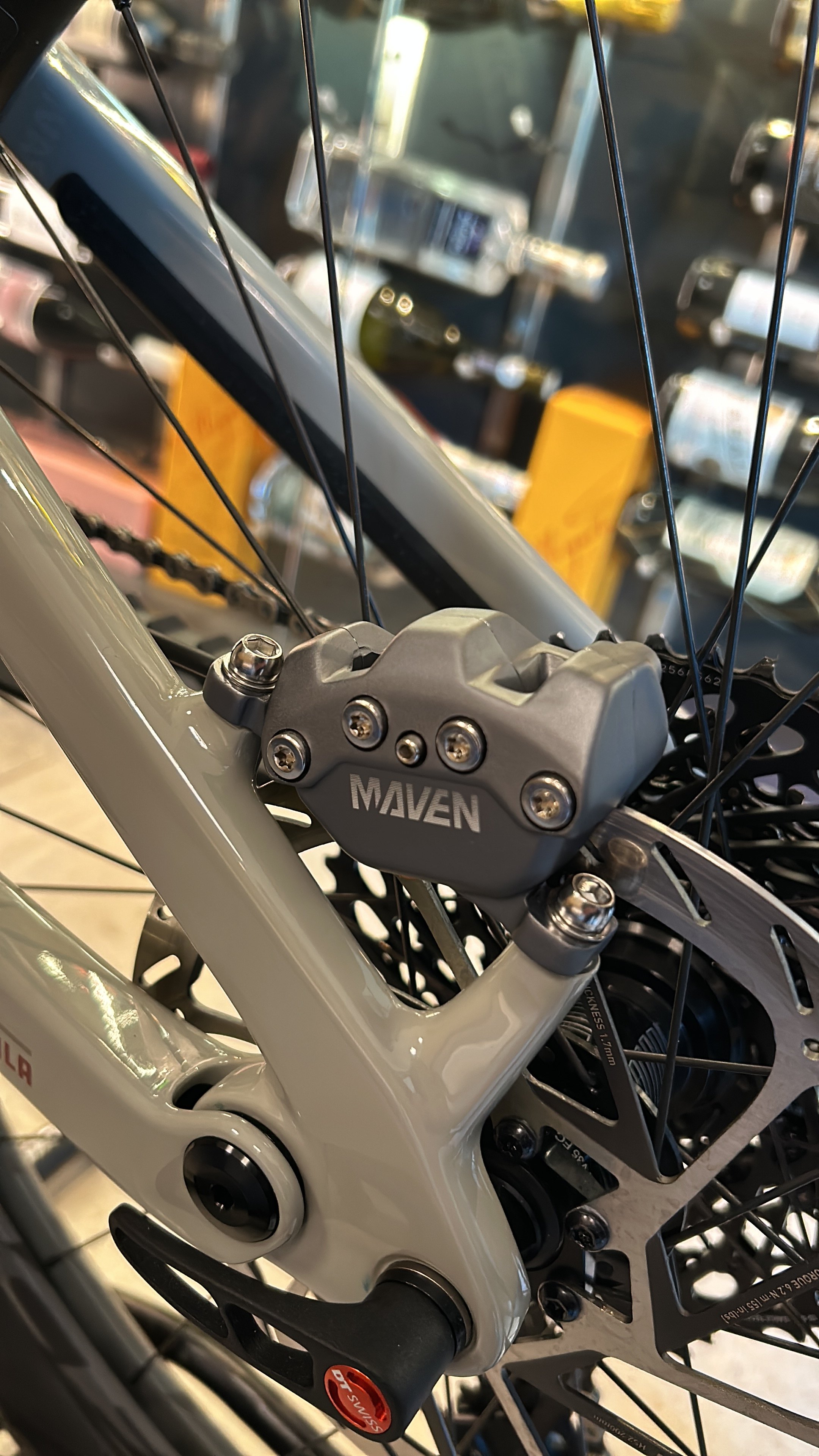

I picked up the Vala yesterday… the Maven callipers are huge! They look up to the task. Only tried them on my drive way but initial thoughts are to give them a go.
I picked up the Vala yesterday… the Maven callipers are huge! They look up to the task. Only tried them on my drive way but initial thoughts are to give them a go. View attachment 153349
Yeas, they really are :-)
My rear brake caliper had a loose screw, and I only noticed it after four rides. The brake was working intermittently because the rotor was bending during braking. Make sure to check if the screws are properly tightened. Just out of curiosity, did yours come with Fillmore tubeless valves?
This applies to every bolt on your bike. Every new bike I’ve bought has needed a nut and bolt check after the first ride. I assume bike shops don’t know how to use a torque wrench
Your initial thoughts on trying DH World Cup podium brakes on your driveway is that they’re worthy of giving them a go?
My driveways -10% in places and quite long. So Maybe not the average driveway your thinking for testing brakes@Lightme
I didn’t want to try them on the trails because if I didn’t like the power/feel and they were “used” I wouldn’t get as much for them resale.
Also I’m pretty sure the Maven Bronze haven’t been on any DH podiums… the ultimate version yes.
I think you get my point.
The biggest thing the Bronze lack is contact adjust, the importance of which will be up to ease of setup for your brake feel preferences. The power is plenty.
