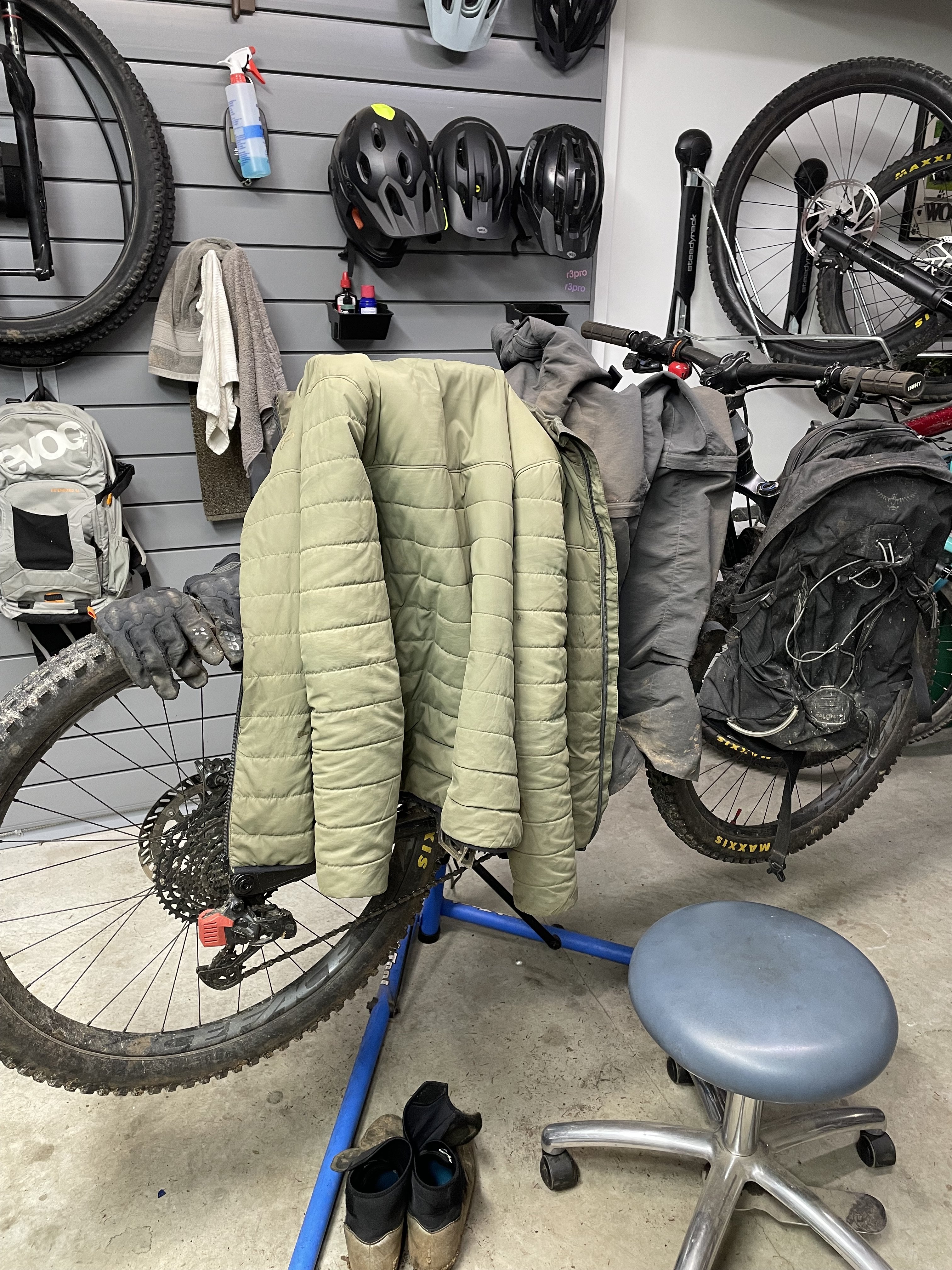

Pro tip; My stand and bike doubles as a drying rack for my riding apparel. I keep a spare underwear and socks in the bike cave also. (I walked through the house once, after a ride, and suffered the consequences.
I use the fake Saris bar to suspend almost every bike. The most used charger is attached to the stand post and plugged into an electrical receptacle, where I’m able to charge everything else (AXS batteries and extra chargers). The tool caddy holds the fake bar, lubricants , maintenance items, chocolate bar, charger cable, etc.
This location kinda keeps the dirt contained …sometimes. 👍🏻

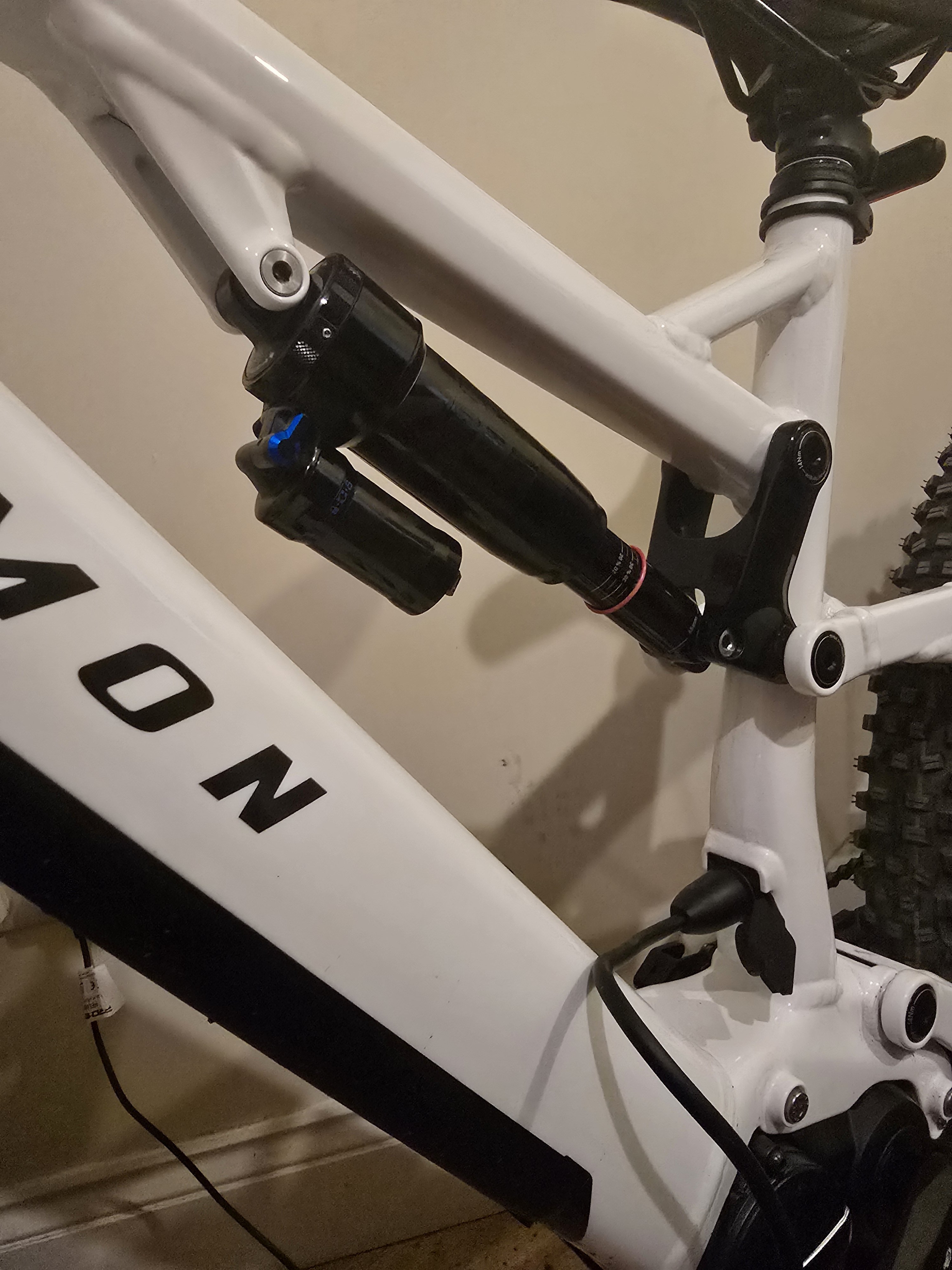

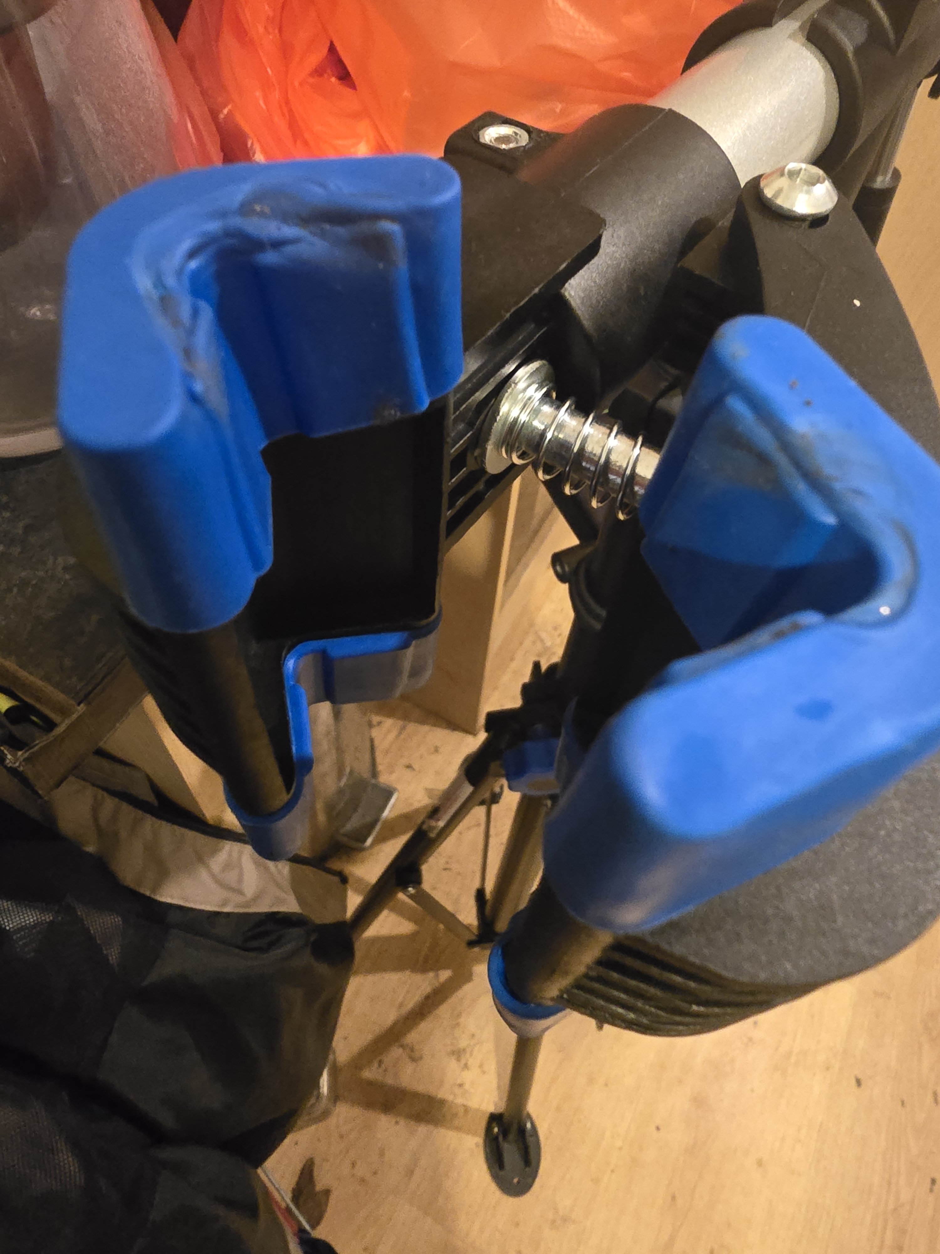

@Mikerb brilliant thanks mate will deffo look at getting one from halfords as my Raymon frame has very little room for clamping to frame because of rock shox suspension and previous clamped to seat post damaged the stand jaws
