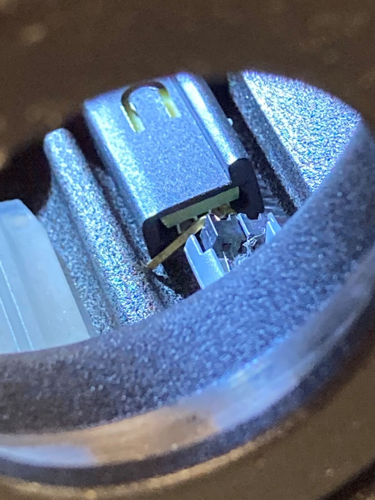

Had to solder the female connectors back in place on the ring sensor. Luckily it works again.

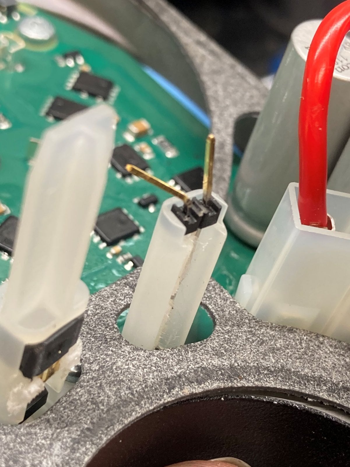

Good evening! During assembly, one contact broke off the rotation sensor (these contacts are shown in all the photos above). I disassembled the sensor, unsoldered the wire, pulled out the board with the contact, added tin, and soldered the contact back on. I reassembled everything and checked it with a tester. Everything rings, but the error persists after assembly. My question is, could something on the board itself be damaged, such as a broken track or solder joint? Thank you.

unfortunately you will have to be a little more accurate or descriptive with your descriptions. If you mean the wiring plugs under the printed circuit board (PCB) cover? They just clip in to the PCB. I'm not sure what you mean by "coil"? If you mean the electric motors armature (the magnets in the centre of the stator coils) then these will have resistance when the belt cover is removed, because the supporting bearing needs the belt cover in place to be able to do its job, without the belt cover the armature magnets will drag against the stator making it feel rough and difficult to turn.
Thank you for your answers! I've already taken everything apart and checked all the connectors and wires, everything is fine, I soldered two sensor contacts (rotation?) that the antenna connects to, just in case. Within an hour, if the guests don't get in the way, I'll take apart the engine to check the antenna. But please answer me this: what should the resistance be for a normal antenna? I need to know this in order to decide whether it is working properly. Thank you.

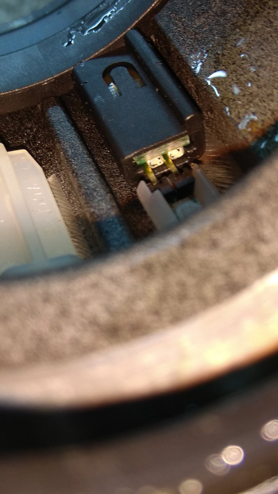

Good evening. I am referring to this component; to me, it is an antenna because the magnetic field rotates, and this antenna picks it up and transmits it to the board. Maybe I'm wrong, but these are the peculiarities of education))) Sorry for misleading you. It's very interesting what language you speak, can I translate directly into your language? I think it's Italian))))
what should the resistance be for a normal antenna?...
How much Ohms do you have? Either you have a resistance or not, I doubt it would have kind of a short cut.
In my case the torque sensor itself was broken - not the antenna

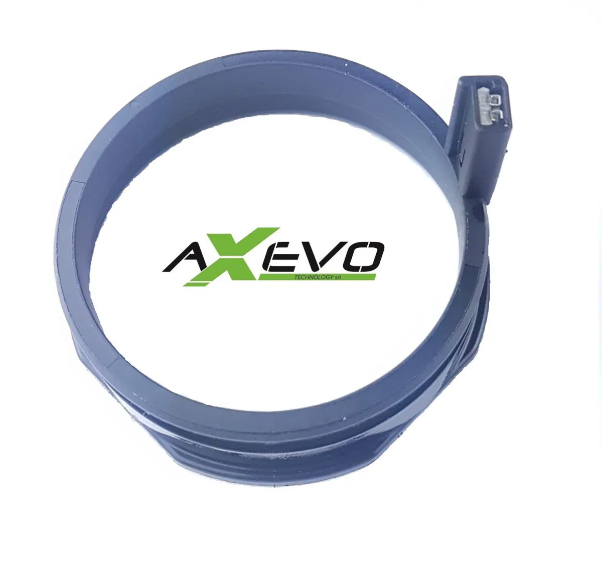

This part is the torque sensor pick-up ring. It works by converting a resistance change to a voltage signal. More pedal force = more motor current. The only practical test you can do would be a continuity test, but this will not tell you anything more than the fact that you have a circuit.
If this part fails, you will still get walk assistance when you press the walk assist button on the handlebar remote switch.
If the torque sensor fails, you will loose power and walk assist. Plugging the motor into diagnostics will normally show a torque sensor fault.

I ordered a torque sensor, I'm sure you're right, your experience proves it!

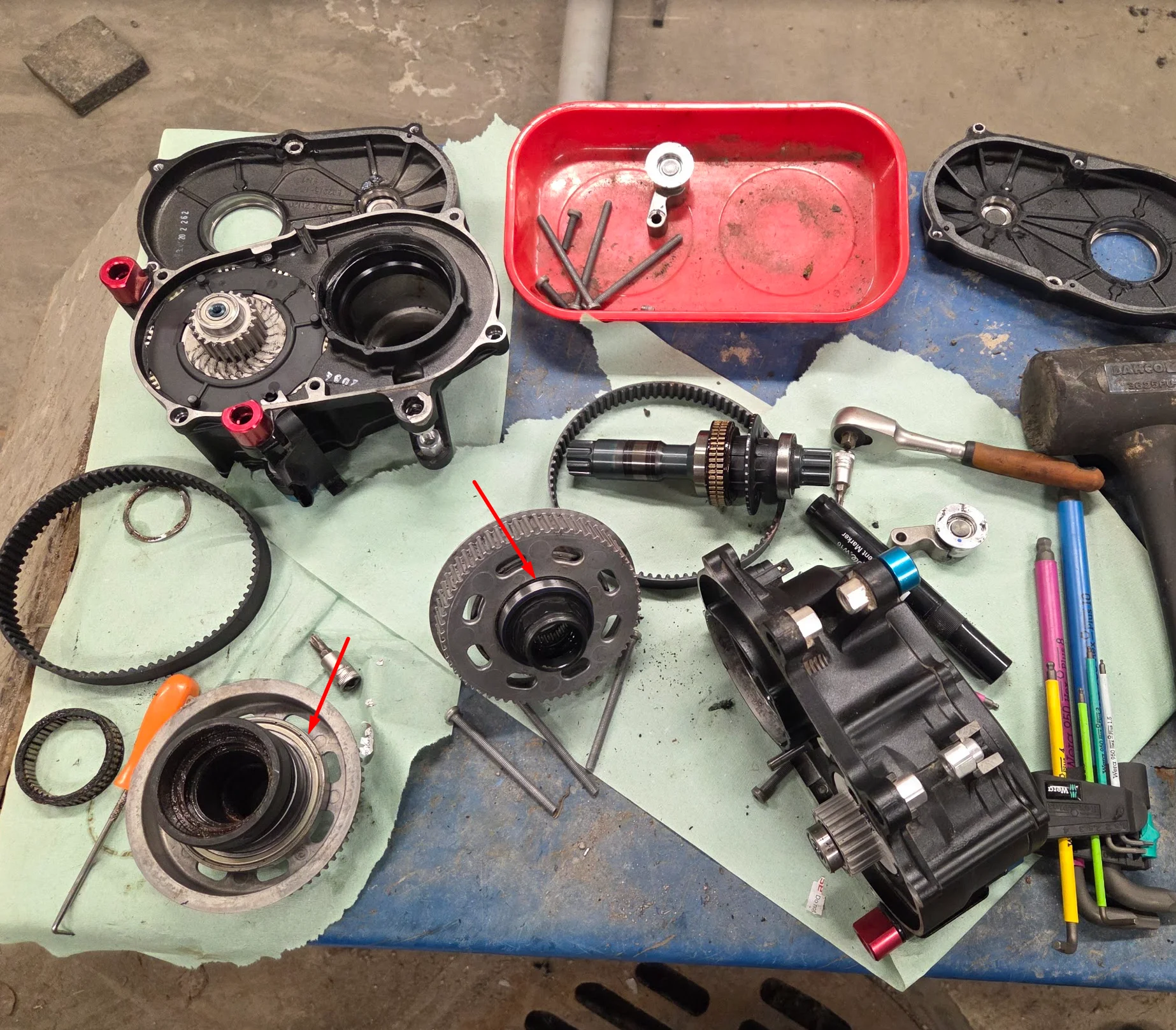

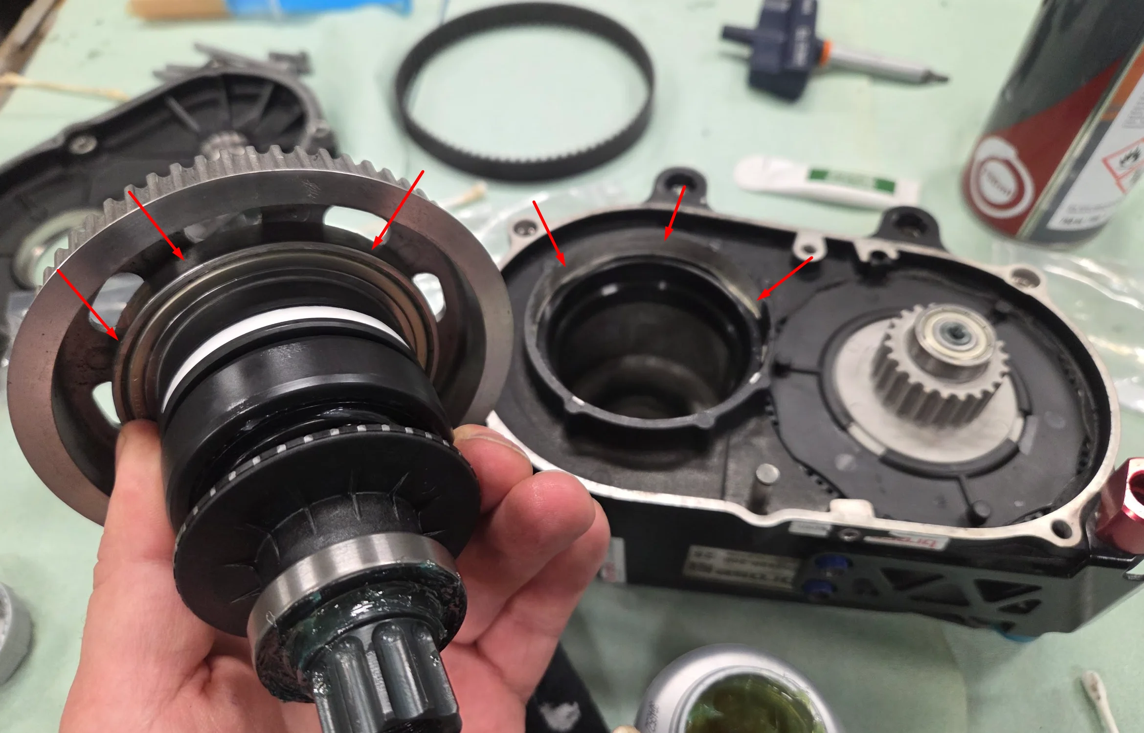

Is is common that torque sensor fails? I had troubles with uneven assistant. I read somewhere that could be caused by failing cluing of that bearing which is in picture I have changed couple bearings and added extra seals. I haven´t tested bike yet after motor reassembly. This is second time motor fails like this. First motor went to warranty around 5000km.
Torque sensor itself is not a common fault but, eventually all things fail, especially when used outside manufacturer specification (eg. pedal stries, water ingress). In many cases, motor faults after belt replacement are because of improper installation. Normally, you don't have to remove the control board when you only replace the belt.
Information transfer is made by using a transformer (magnetic coupling). This transformer is also used for power transfer from mainboard to internal torque sensor electronics. One stationary coil is the part with 2 pin connector monted on the motor housing and connected to the motor control board, and the rotary coil is on the torque sensor itself (masked with white tape). The torque sensor has an internal PCB (under the blue silicone) and 4 sensing elements oriented 90degrees, glued to the shaft. If one sensing element fail, the motor could work without errors but it will give uneven assistance or other manifestation (wrong sensitivity, excessive overrun, etc.). The PCB itself could also fail but it's not a common thing. Stationary coil would not fail by itself as it's just a copper wire (insulated) wounded around the plastic ring.

No, if the bearing moves, the belt pulley will rub on the inside of the belt cover and makes a metallic scrapping noise. Even if the bearing moves only slightly and the pulley does not rub the belt cover, eventually this will cause the drive belt to fail, but none of this has anything to do with the torque sensor.
Many things can cause run-on but the most common is when the crankshaft becomes stiff to turn, usually when the needle roller bearing that supports it starts to fail.
The stationary coil can and does fail. This is a part we definitely have to replace from time to time. Next time you have a bike with walk assist but no power assist, try changing this part first. (y)

Yeah, I think you are right. I took motor apart, changed needle bearing and added extra seals. I have driven few hundred kilometers after that. It seems that torque sensor is not working properly. I use Blevo, so it easy to see biker power. Sensor will give false readings. It is sensing either too much or too less torque. I think it more common to have too much power form motor.
I think it might be good idea change all bearing at same time, because I have to take at least these to bearings away. And maybe belt also. I saved my moneys at wrong place and I should have changed all bearings and the sensor at same time. I had to weld the casing also, because if was cracked.
