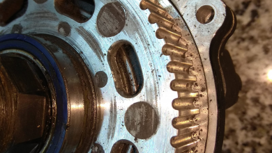

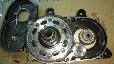

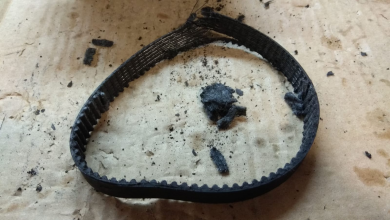

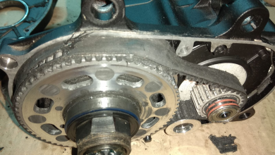

The original motor of my bike (I have 2), also broke the belt, but this time I think that the trigger for the disaster was a fall or a blow of the connecting rod in a sea of stones ...
The crankshaft has shifted and pulled the large pulley bearing out of its housing slightly and the pulley has been misaligned and rubbing against the casing, until the belt has derailed.

Is it worth while having the motor open to change the spragbearing of the crankshaft for a more robust one with a metal cage?

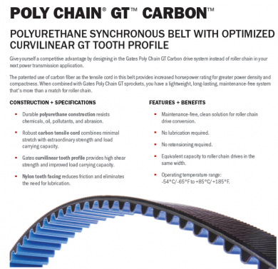

Do you think that the tremendous price difference that exists between the strap of the Brose kits (Gates Carbon) and a standard industrial strap (Gates Powergrip HTD) that the aluminum Brose had, is going to suppose a proportional increase in durability (10x ) ?. I doubt it...
It's a shame that Gates doesn't sell the Poly Chain GT Carbon in 405 ...

This one looks very good, but I don't think they market it to the right extent ...
