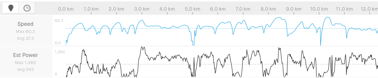

I had to stop a bit quick from this speed today because a dog was in the way. Unfortunately I didn't get off and check the colour of my 220mm rotors, sorry :(
Edit: I use Shimano D03S resin pads in my Shimano M6120 calipers. Very boring I know.

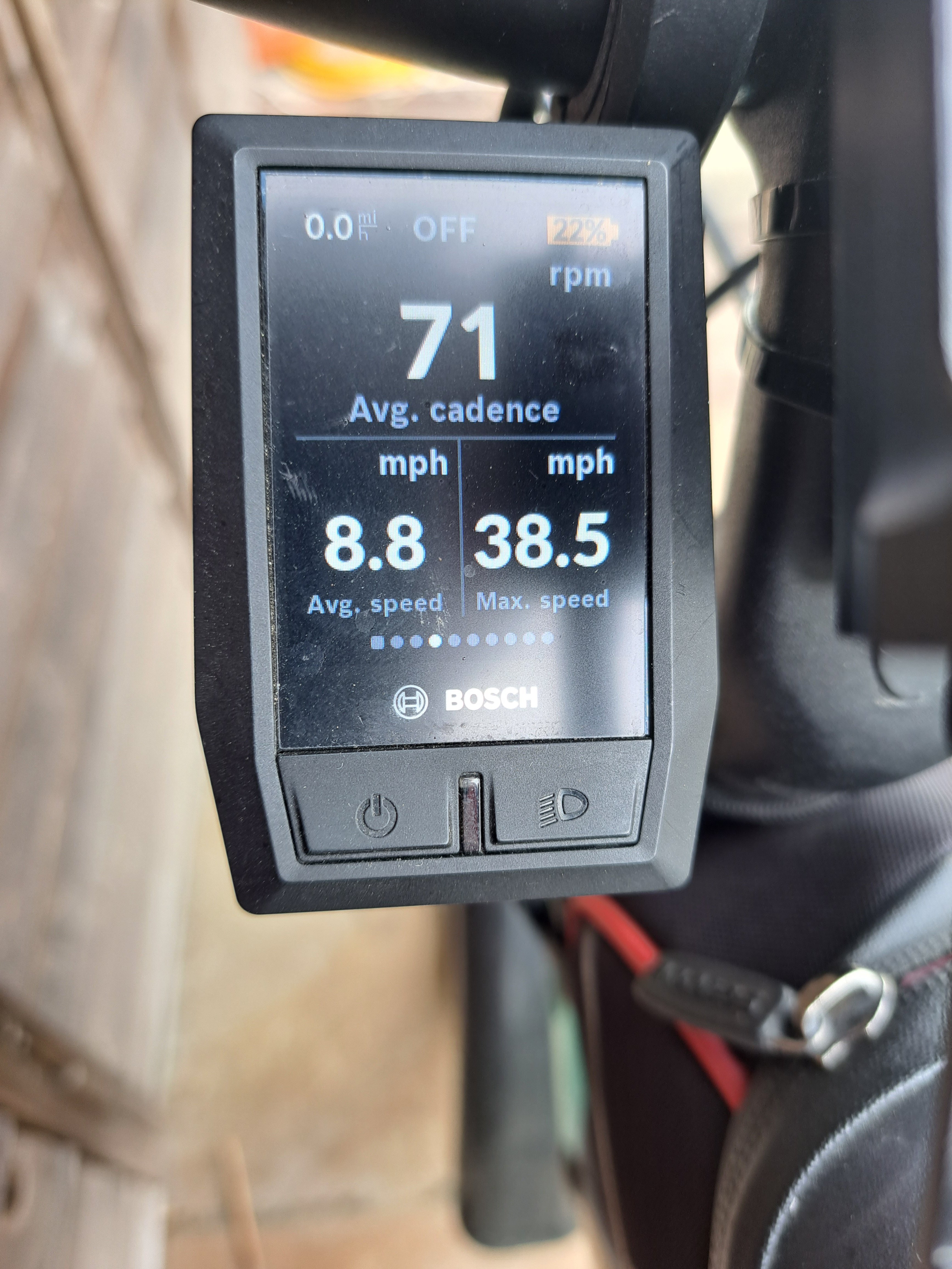

Ironically (based on @irie's post ..) I'm out from a huge off after OTBing at 45kph trying to avoid a dog which ran in front of me and managed to get enough brake force to do that rather than hit the dog on 200mm Shimano XT's - it was sh1t riding, but in the 0.1 seconds that existed at that point, options were limited and better choices could have been made.
I don't think you can really work just speed into rotor size either, on it's own, it's just another variable.
On a quick test ride the day before on a different bike with 200mm xt's, I never had any thoughts about braking.
