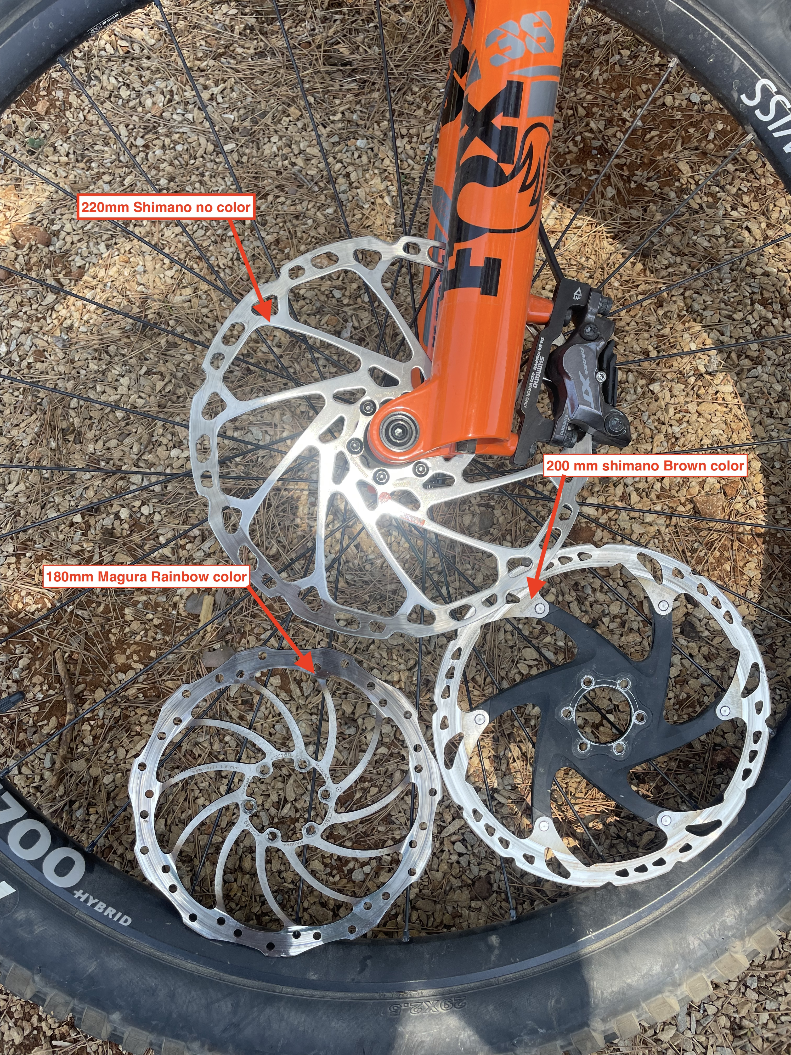

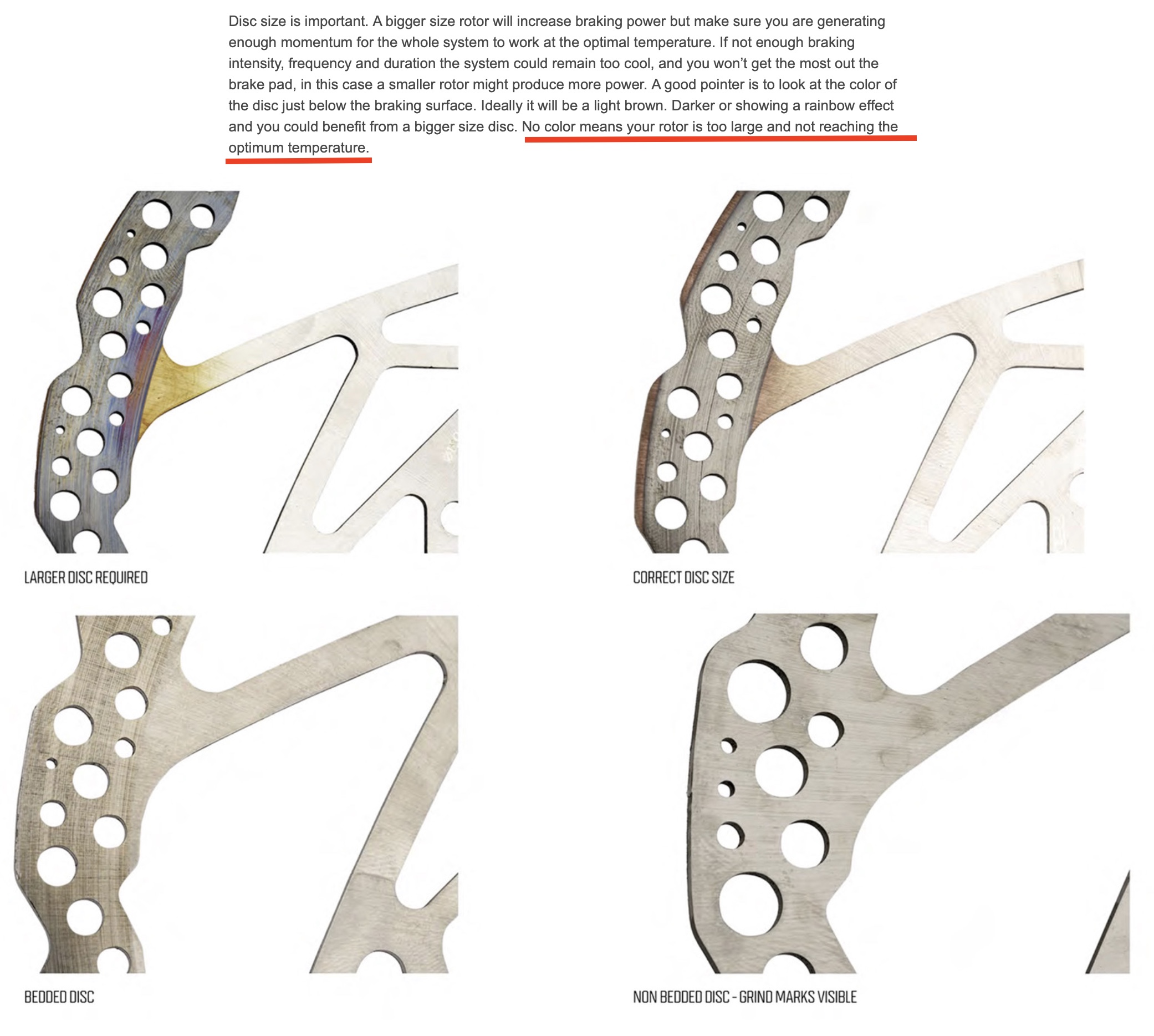

I defenetly need to go back to 200mm as my 220 don’t have any color change compare to my ex 200 mm. Guideline from hope “ Disc size is important. A bigger size rotor will increase braking power but make sure you are generating enough momentum for the whole system to work at the optimal temperature. If not enough braking intensity, frequency and duration the system could remain too cool, and you won’t get the most out the brake pad, in this case a smaller rotor might produce more power. A good pointer is to look at the color of the disc just below the braking surface. Ideally it will be a light brown. Darker or showing a rainbow effect and you could benefit from a bigger size disc. No color means your rotor is too large and not reaching the optimum temperature.“
"No color" does not necessarily mean that the rotor is "too large".
So you know better than HOPE engineers? I just copy that from what they published.

So according to HOPE the 220mm that my Strive : on CFR came with is too big for me.
Here are picture of some of my old rotor's next to my Strive 220mm one's
The 180 are too small and the 200 are spot on for me
Ps: the 220mm rotor have been used for 200km
Yes I might swap the 200 rear and 220 front. Maybe the 220 at te back will be better for me. I like to drift the bike so I use those back brake.
