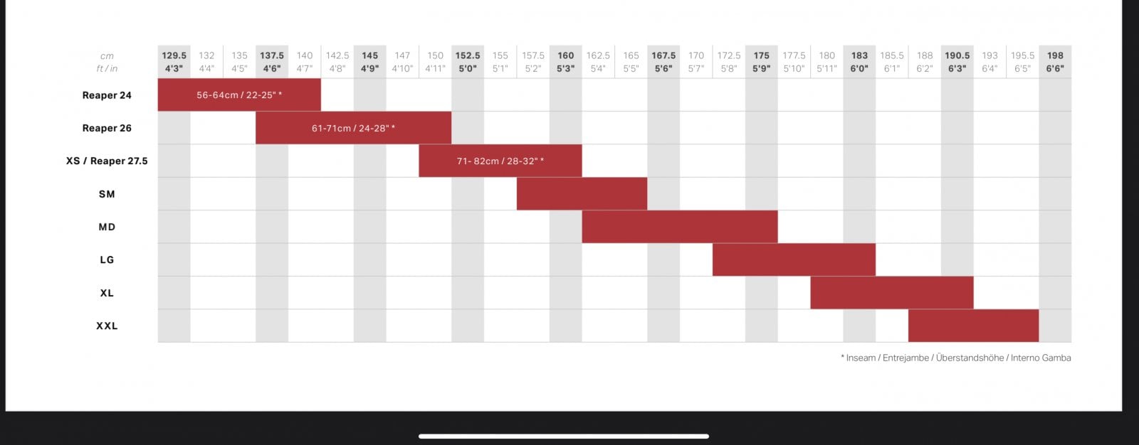

Hey, I tested the bike yesterday. I’m 183cm with long arms and ordered an XL...
The bike is definitely short and the bigger size actually gets you into the more modern geo with longer reach and wheelbase.
Btw in their sizing chart, the XL is from 180cm to 190cm, so I would say you fall directly in the middle of the XL :)

Definitely go with the XL. I am also 185 cm and got to test L and XL last spring. I went with the XL and it's not super long reach. Only thing to think about is long seat tube length. I have the 170mm dropper slammed all the way down and I wish it would go about 5mm lower.

I’m 193cm and have ordered an Instinct BC C90 PP in XL. Can’t get any size above that of course, but it’s a bit disconcerting how small you guys think the bikes are....
I mean I deliberately got a bike with a shorter chainstay than my Levo, but hope it doesn’t feel insanely tight.

Why not the XXL?
