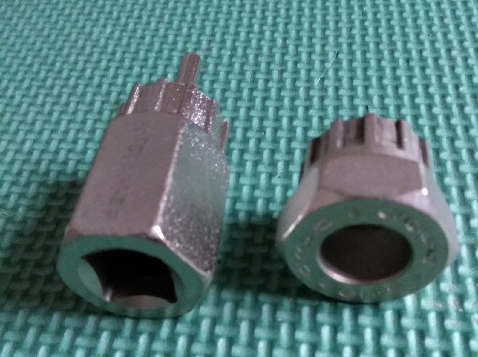

There is only one size of socket, but there are two types. One is a short body, which is fine for most of the cassettes. But there is also one with a longer splined body and a spike that was essential for one cassette I used (nope. can't remember for sure, 11-speed I think). The other has a short body and I use for for everything else, including fork top caps. The big one came from Fatspanner, the other is a genuine Shimano part.
