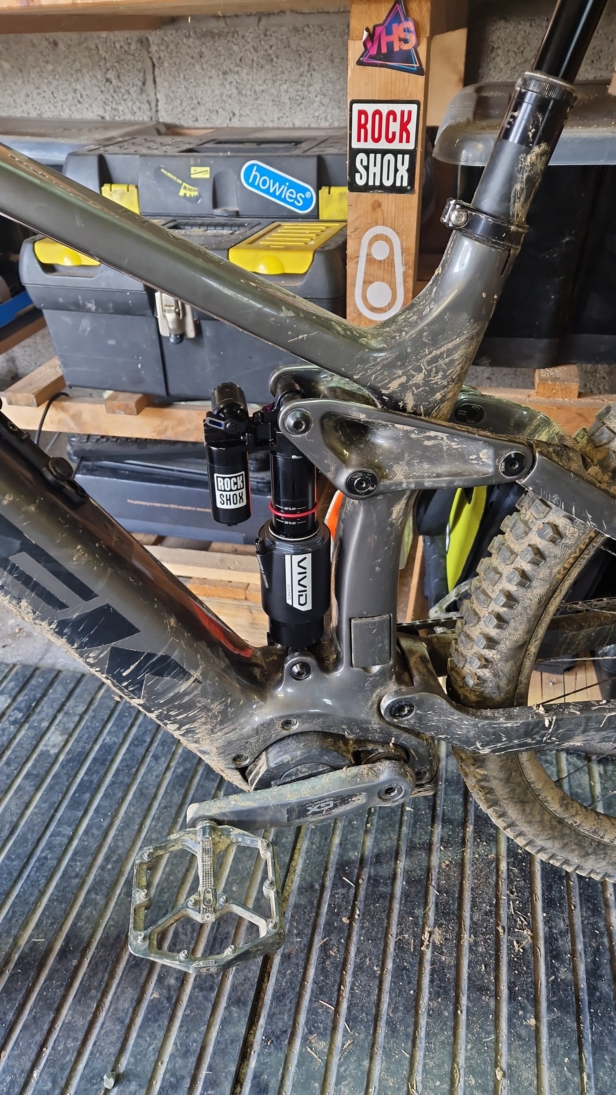

So - it's now fitted and looks amazing. Thanks for your help @Rail7Lou :)
I can't wait to ride it.
Rockshox Vivid Ultimate RC2T coil shock, 230x60, Rail size Large.
500lb spring, rider weight 83kg, and the sag is around 28%

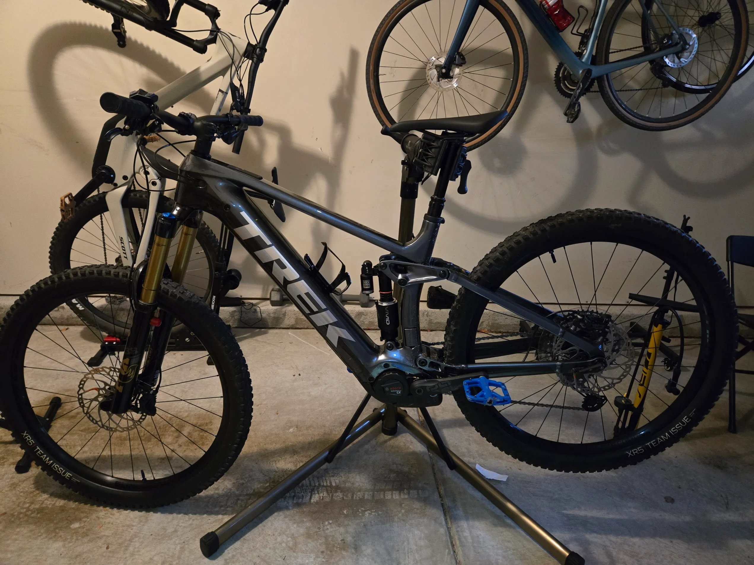

Anyone tried that Rock shox coil on medium gen 2 alloy ?
Yes and the piggyback chamber hits the downtube at full stroke compression. Sadly the M size gen 2 frames don't have enough clearance but the larger sizes and later models with the 750Wh battery do. I think I also tried a Fox X2 and had the same issue. In the end I went for a DVO Jade X which has the piggyback oriented laterally. This and other shocks with the same chamber orientation works fine.
