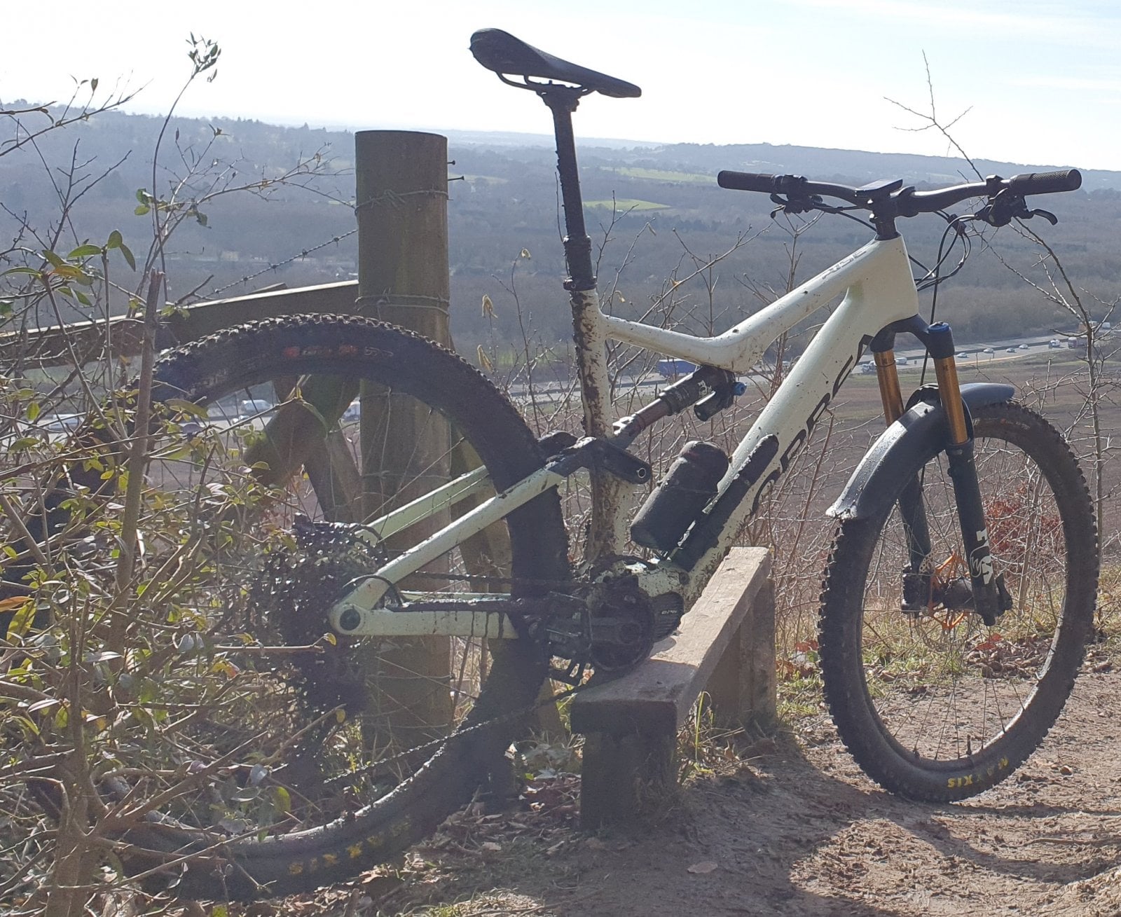

What I have done on my M10 Size XL:
  • Tyres: Maxxis Assegai Front and DHRII rear. Not fitted but ordered with bike as reviews said standard tyres were poor. Still at Bike shop, waiting for the.....
  • Range Extender - Bought with bike in mid-feb. Still no sign. Not ever needed it yet though!

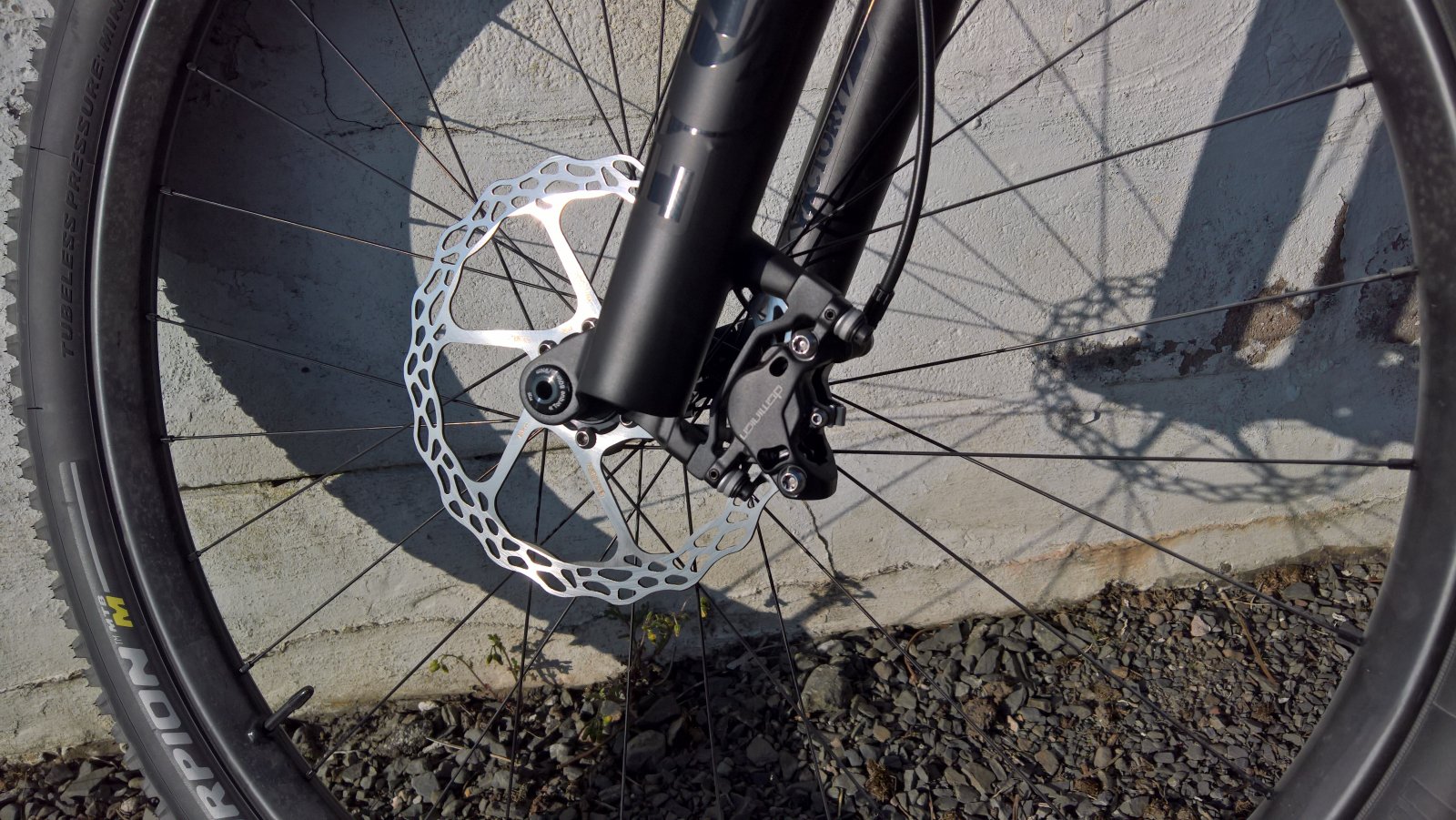

  • Front Brake Disc - Swapped out 180mm Galfer for Hope 220mm and adapter for more bite. Straight swap and very pleased. +100g -£60.
  • Grips: Brendog Thick Deathgrips - Not a huge difference, but a more comfortable grip for me.
  • Garmin Top Tube mount - Can mount the Garmin 530 straight onto the steerer. Clean, light look.
  • Additional volume spacers for 36 Factory forks - Currently unfitted. Aiming to smooth the chatter but not bottom out on small jumps and drops. Not a big deal, so haven't bothered yet
  • Tubeless conversion - LBS did this as bike prep for the sale
  • Pedals - DMR Flats. Have always had SPDs but not missing them at all. Flats are kinder on my old knees for twisting, more reassuring through sketchy technical bits and while those around me clatter around to get clipped in before a run, I'm straight in there! - Paired with some FiveTens for maximum grip
  • Cheap toolbox waterbottle - Short rides I don't need water, long rides I take a backpack/Camelback, so I keep my spare tube, levers, Stans tubeless repair, CO2 cannister in there
  • OneUp Pump and Multitool - Really good pump. Totally overspec'd and perhaps in hindsight unnecessarily heavy - but a lovely bit of kit and multitool.
  • Front Mudguard - RRP Proguard - Large f. Mounts to back of forks with screws, not zip ties. Ugly, but stops my face getting covered in sh*t.
  • Invisiframe - LBS didn't want to do it, so I fitted it - Takes HOURS when all I wanted to do was ride my brand new toy. Obviously worth it for the long run, but needs patience. Full gloss version for my bike.

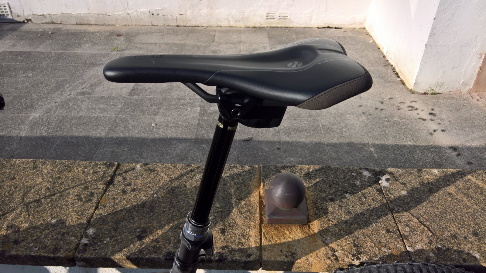

  • Saddle - People mention the Ergon saddles, but I've never found this standard saddle uncomfortable so far....

As for the Galfers: they are the same thickness as a typical mountain bike rotor (1.8mm) so I assume the weight savings comes from slimming everything down. Which means less material, therefore less thermal/cooling capacity and more flex.
Coincidentally they faded badly in one spot on my ride today, but I think it was the pads that overheated, the rotors look fine. It was a fast fire road descent with loose, flat corners, so I'd put a lot of heat into them. After a few mins flat riding they were fine again. Nonetheless I'm going to give these pads a try.

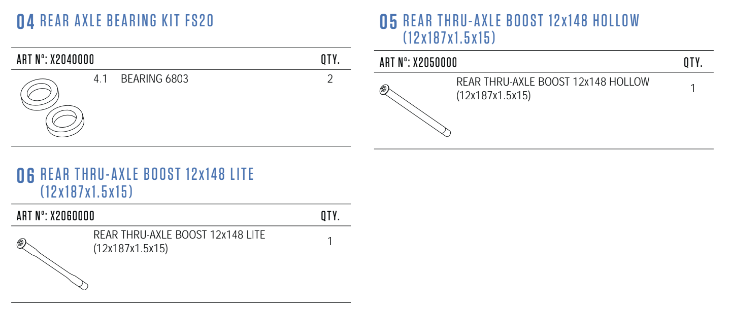

I don't think all Rise's come with the "LITE" axle, just the LTD. So presumably we can buy the "regular" one that goes in all the other bikes? If you look in the manual it lists both options:
  • LITE = X2060000
  • Regular = X2050000

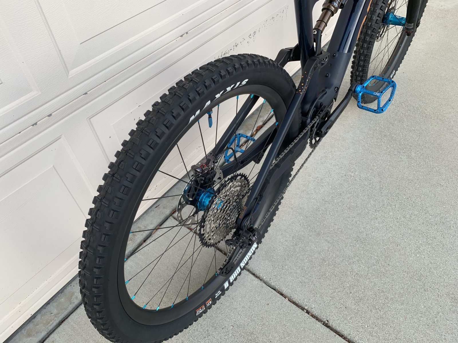

Both. I checked Maxxis' website first, then weighed them myself when doing the tubeless conversion. The difference between the two, besides the size, is the compound. The 2.6 is Maxx Terra, the 2.4 is dual compound.
Maybe the 2.4 is mislabeled and is actually EXO+? It definitely says EXO on the sidewall and the matching Maxxis listing says EXO on their website. ?‍♂️
EDIT: Just for the record, claimed vs actual weights:
BrandModelPartSizeClaimedActual
MaxxisRekon EXOTB0001770029 x 2.4800880
MaxxisRekon EXO Maxx TerraTB9696200029 x 2.6780795
Tpi different. 120 on 2.6, 60 on 2.4.

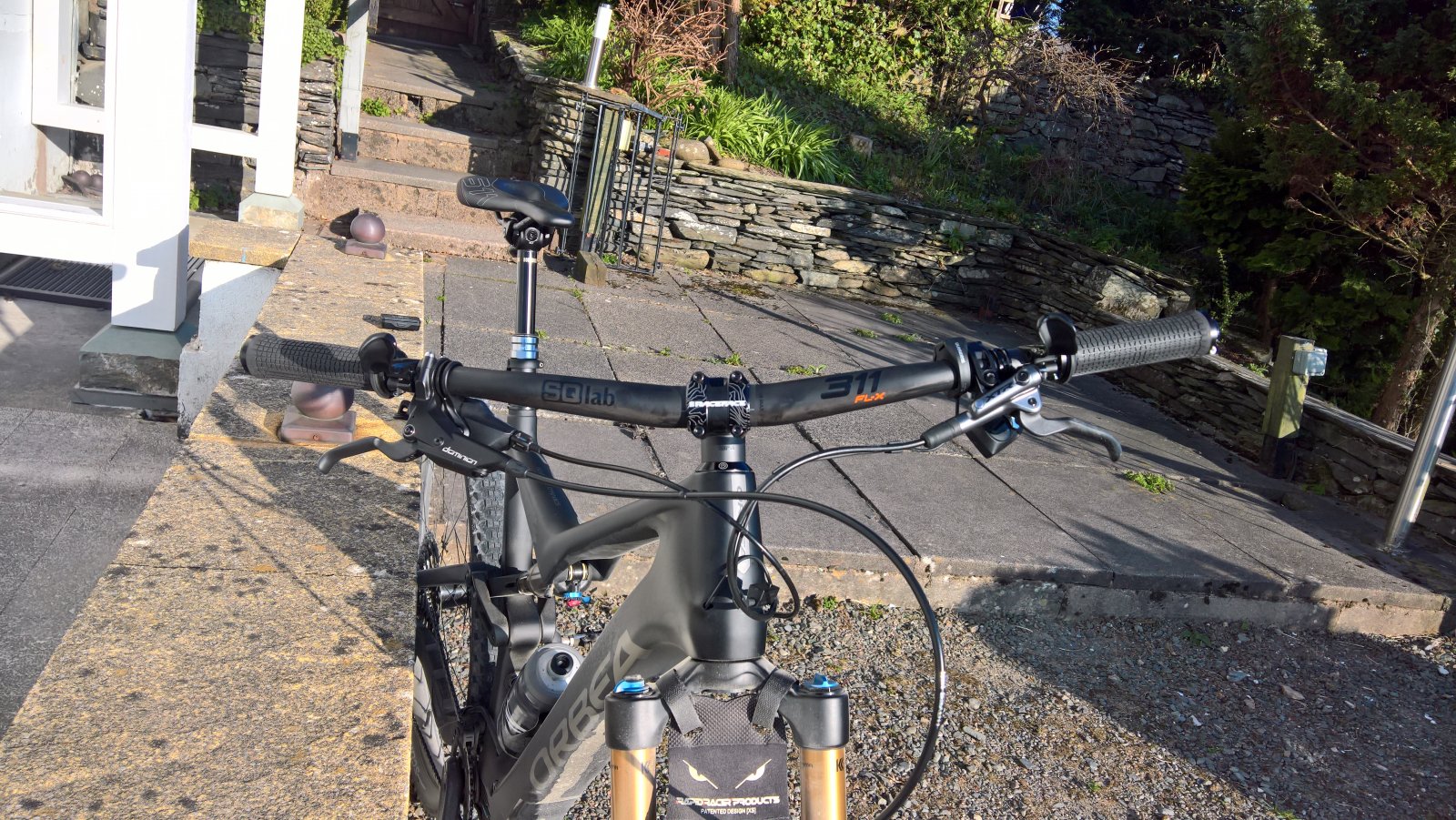

These are my changes so far:
  • Reverb AXS dropper
  • SQLab 611 Ergowave Active saddle
  • Changed the bars to SQLab 311 FL-X (I find the increased backsweep really comfortable)
  • Also had to change the stem for 31.8mm - went for the Raceface Atlas
  • Trying some Revgrips for the first time (seem fine)
  • Added some SQLab Innerbarends 411 R Carbon (great for changing hand position on road sections)
  • Trying a Hayes Dominion T2 brake on the front (Feels great and stronger than the XTR 2-pots, so I'll fit a rear one now too. Plus they are black!)

Would someone be so kind as to link me to a 203mm front rotor and spacer mount please in uk? I want to change front rotor but not 100% on what I need. This is for the M20, not to fussed about rear as I don’t want to fiddle with magnet. Something in the cheaper end nothing crazy expensive.
also how do you remove the rotor as there are no screws, does it go into the actual wheel spindle?
I used a 203mm Shimano SLX SM-RT64 M665 Centre-Lock Disc Rotor
It was about £25 but the place I bought it from is now out of stock. This seemed the same as the 180 which was on there.
To remove and refit you need a shimano bb tool, I think it was one for hollowtech II.
Then for the fox 34 fork you will need a front post to post 203 adapter
I also had to buy two M6 x 18 Black 12.9 Grade High
Tensile Hex Socket Cap Screws to mount the caliper to the bracket.

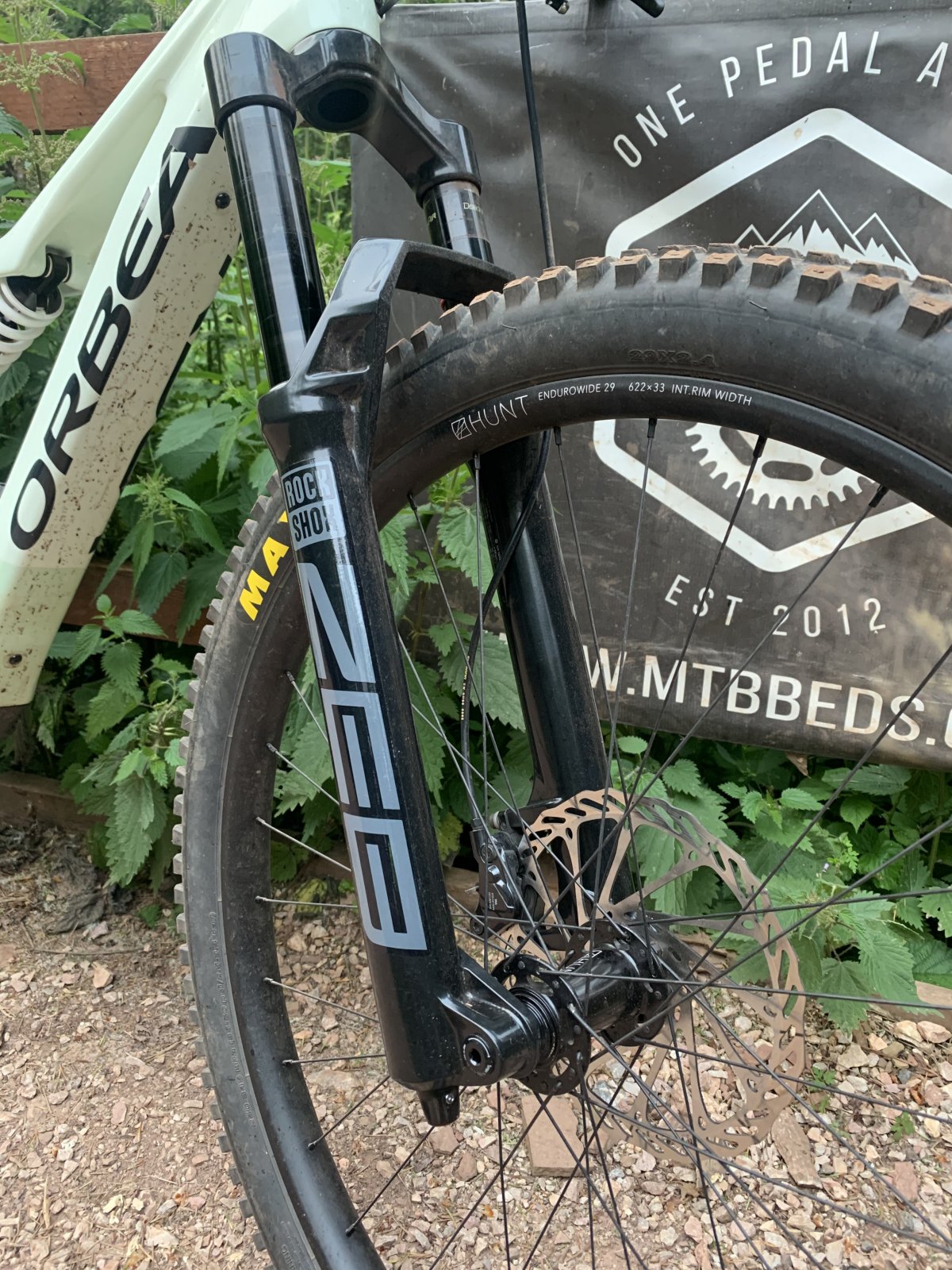

I have the M-LTD (size medium). It was the only one I could find in stock anywhere. I would have gone with the M-Team if I had the choice. Mine came with the Fox 34 (140 mm). I'm going to upgrade the air shaft to make it a 150 mm. I'm only 135 lbs, so the Fox 34 does the trick.
I switched out the bar to a Oneup Carbon with a 35 mm rise (vs the 20 mm rise Race Face that it came with). I like the extra compliance of the Oneup bar too. I added the Revgrips Pro RG5 grips onto it. I love them!
I also switched the tires. The Rekons that came with it didn't have enough grip for the trails here on the Shore. I put on a DFH 2.5 on the front and a DHR II 2.4 on the rear (both EXO+). Those made a big difference.
Next on my list is to get a 180 mm Oneup dropper. Mine came with a 150 mm dropper which is too short (even with me being only 5'7"). On the steeper descents my seat is getting in the way. I know Orbea are doing everything to save weight on the M-LTD, but the 150 mm dropper is just too short for size medium+.

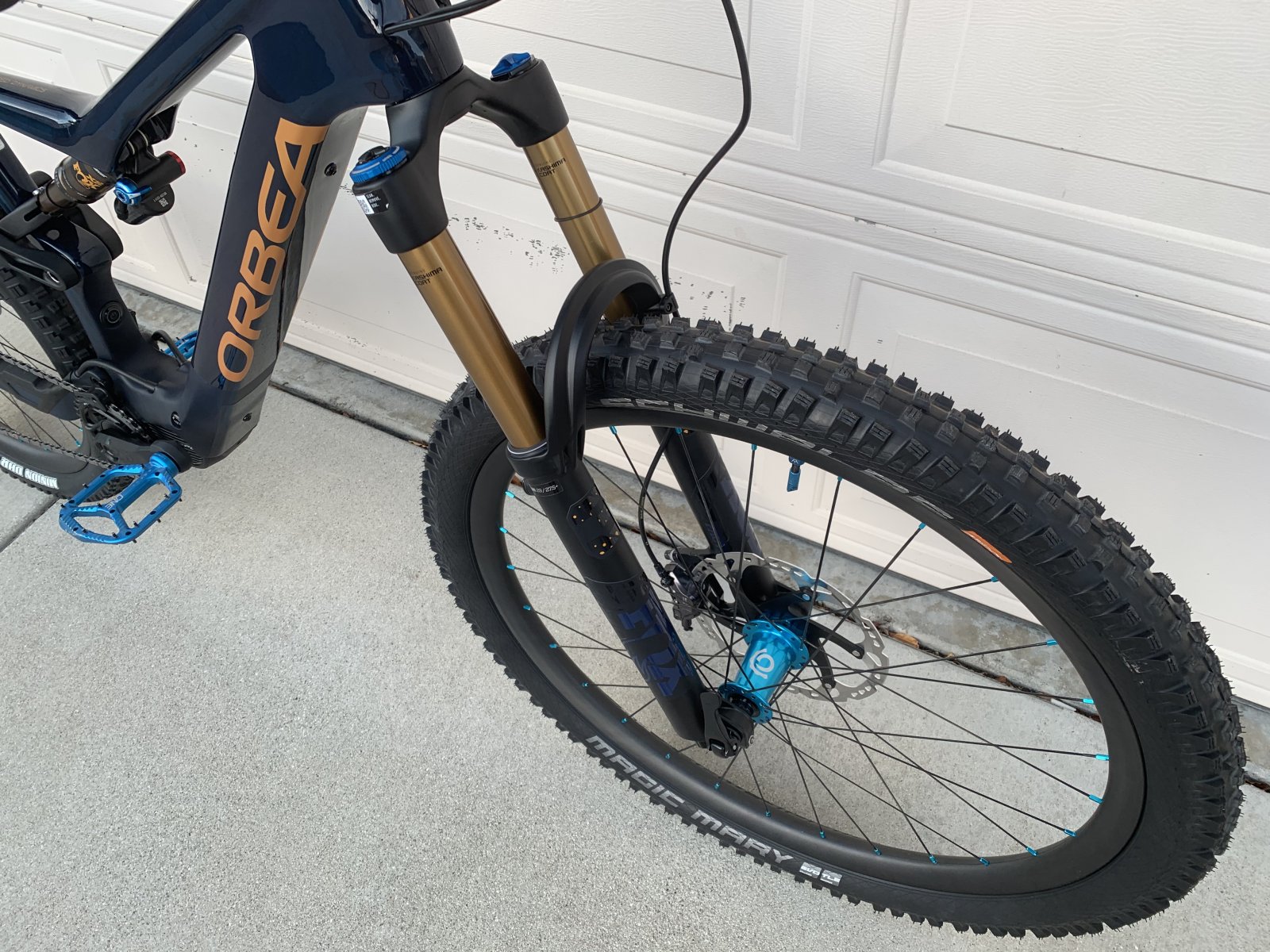

After patiently waiting my M10 L arrived last week.
Changes are 41.25 Pounds (Feedback) scale
Oneup bars 35mm rise
ESI Extra chunky grips
Enve 50mm stem
Ergon SM Pro saddle, Have SQLab I may install
Oneup alloy pedals
XTR Cassette
XTR chain
NOX Farlow, I9 Hydra, C-Xray, brass nipples 1740g
Fox Kabolt axle
Ice tech 203 front, 180 rear- MTX Red label brake pads rear only
Magic Mary Front, DHR2 rear 2.3
Oneup dropper 180mm
Fox 36/38 Mudguard

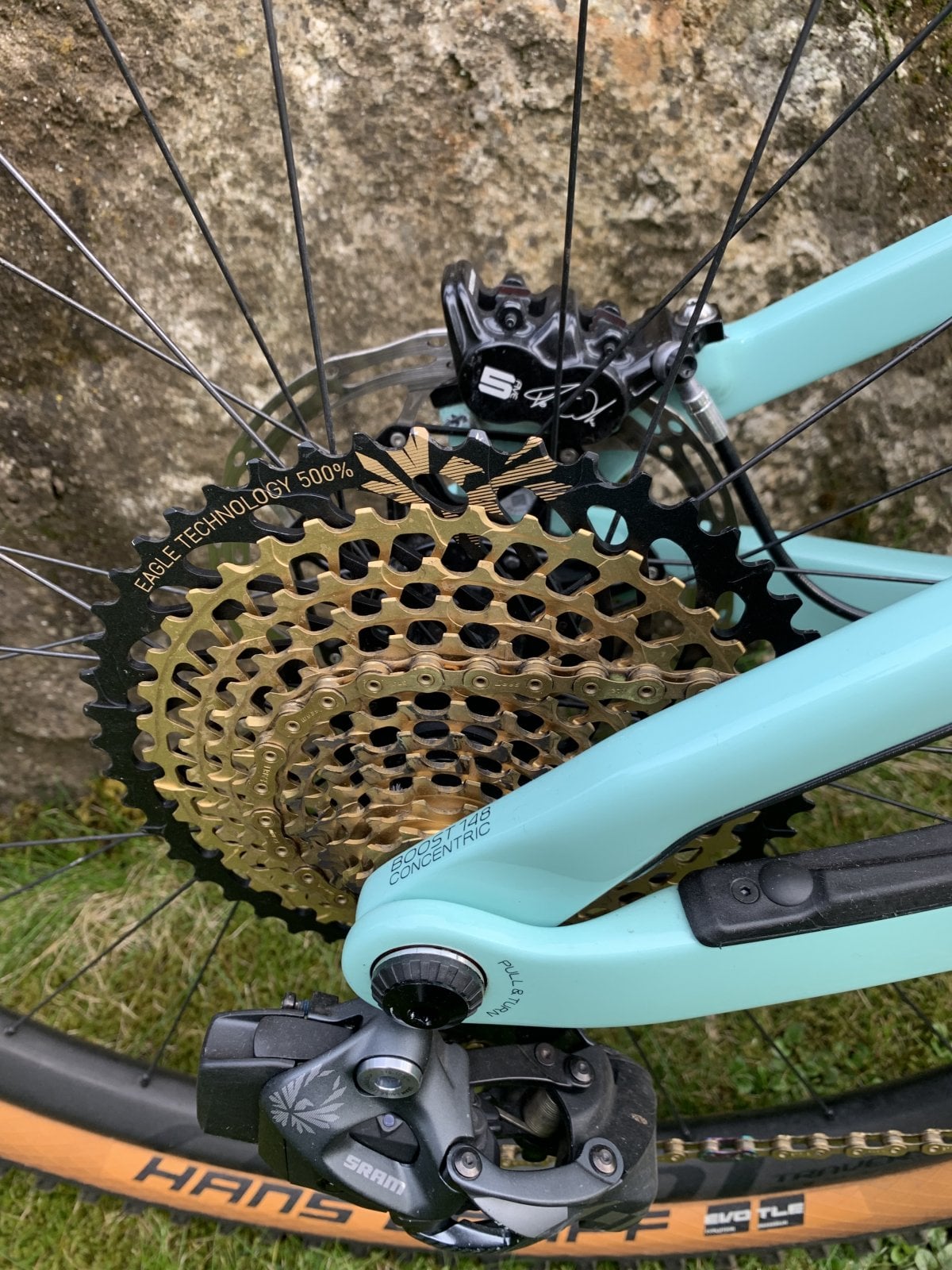

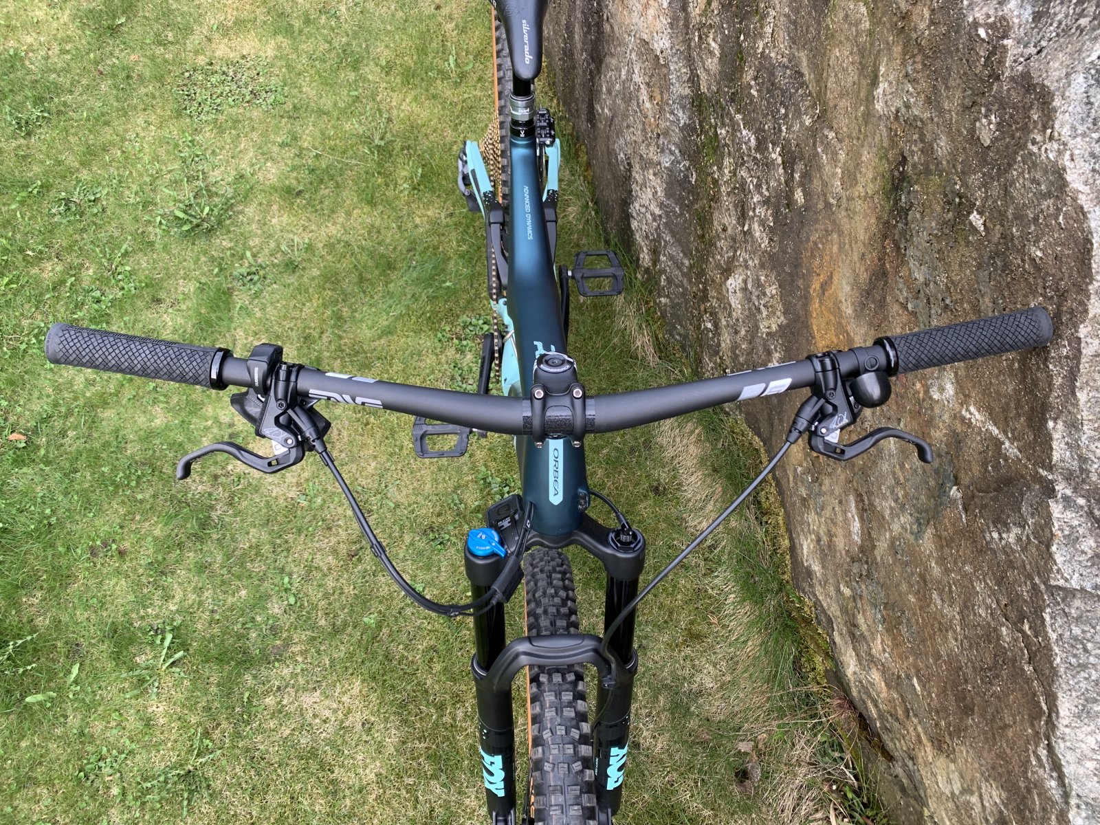

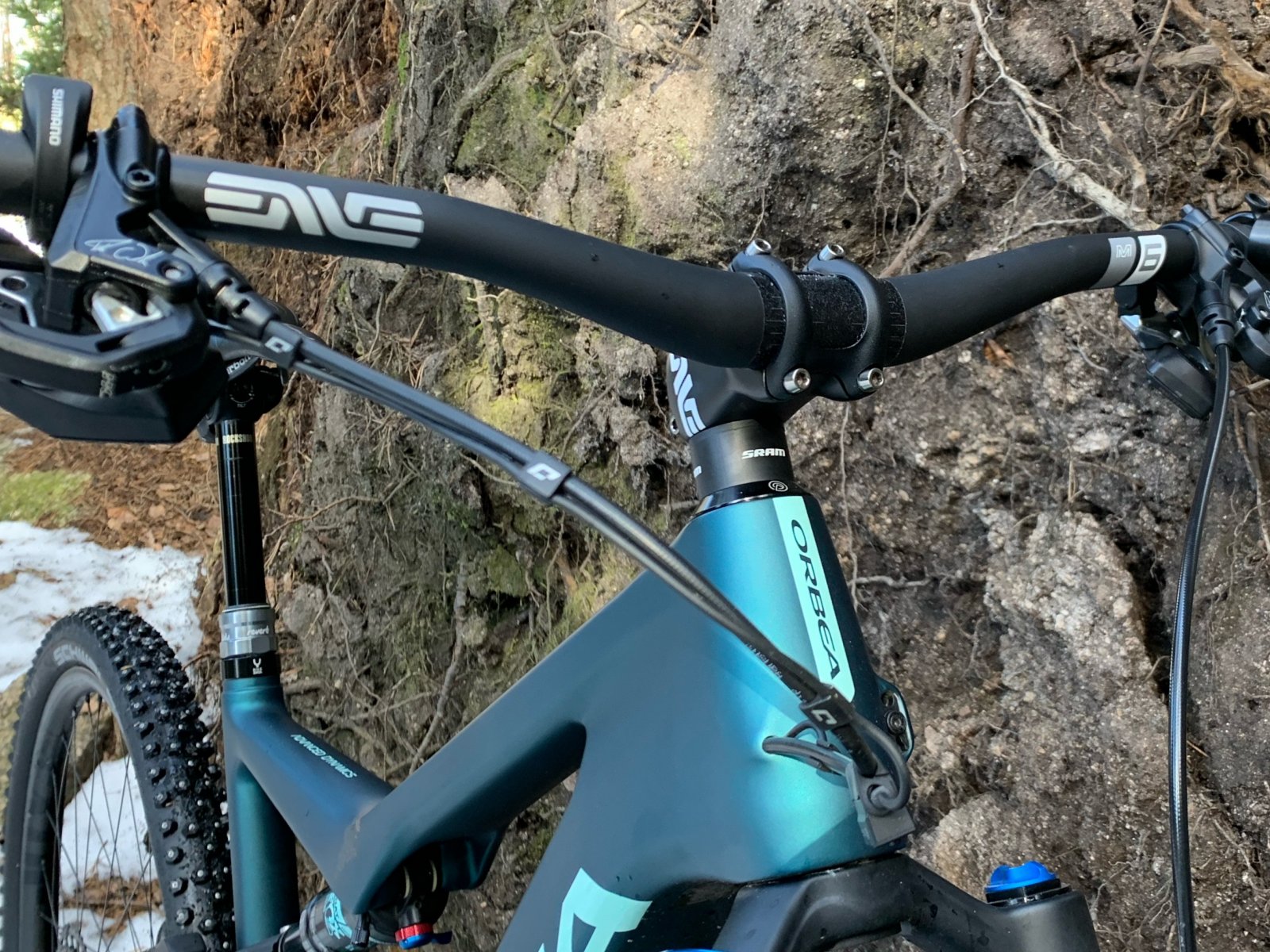

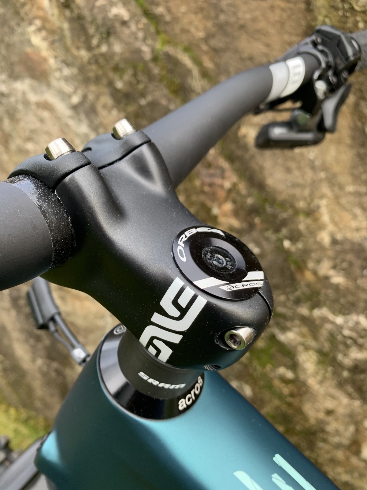

I thought the M20 was a great starting point for a real treat. Had ORBEA sold the frame set, I would probably have gone for it. What I have not replaced is The fork, damper, steering bearing and crank.

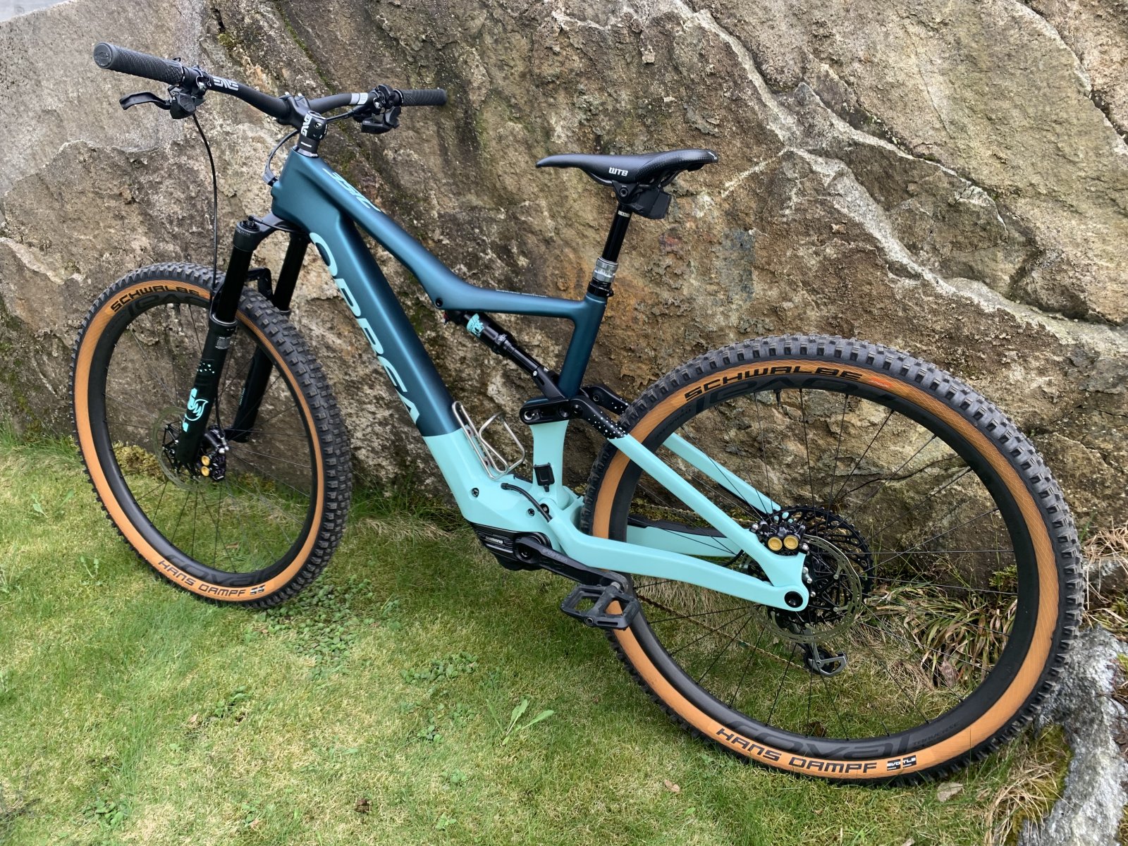

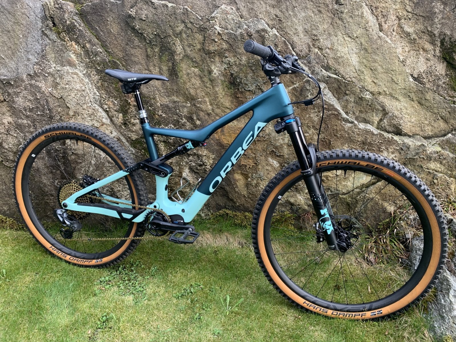

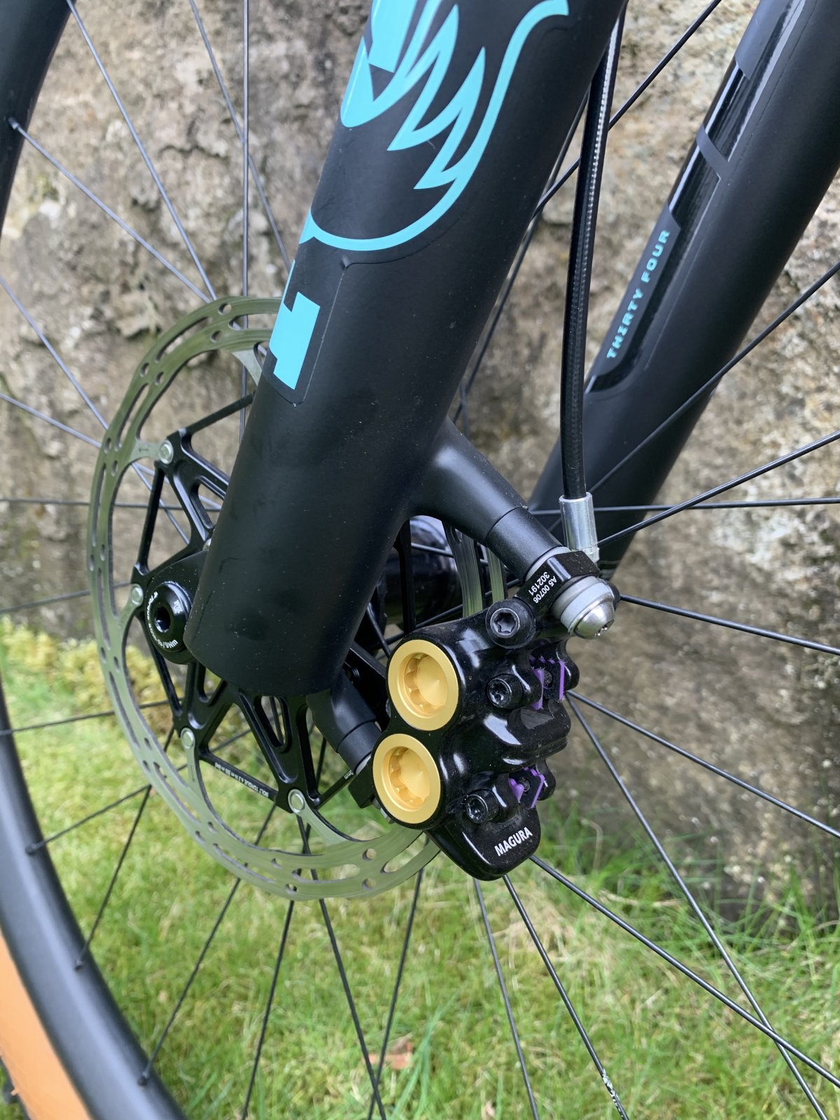

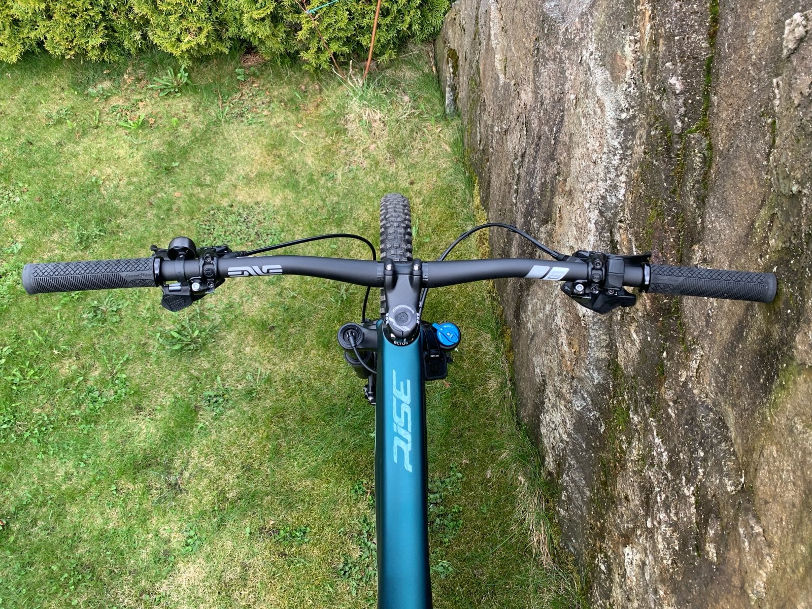

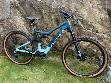

My theme was to keep the weight down, and get an even cleaner cockpit.
Handlebar: ENVE M6 31,8 780
Stem: ENVE Composites 55mm
Grips: Lizard Skins Charger Evo
Brakes: Magura MT5 Fabio Wibmer, with SRAM Centerline 180mm and GALFER E-Bike Pads
Shifters: SRAM XO1 AXS, with Rocker Paddle
Derailleur: SRAM X01 Eagle AXS
Chain: SRAM XX1 Eagle Gold
Cassette/Rear Cog: SRAM XX1 Eagle Gold
Pedals: TIME ATAC XC12 titan carbon
Wheels: Roval Traverse Carbon
Tires: Schwalbe Hans Dampf Addix Soft 29" Skinwall
Saddle: WTB Silverado Carbon
Seatpost: RockShox Reverb AXS 170mm
Seatpost clamp: Other BikeYoke Squeezy
Garmin mount: SRAM over The stem in Center
Bottle cage: King Cage titanium
Additional info: Removed the chain guide, and added Spurcycle Compact Bell, FOX Kabolt and Orbea lite axel rear and some titanium hardware :)
Weight: 17,88
8A26D85B-5563-4562-A335-BF35DC71E2AD.jpeg7AC52896-9059-4D6D-9EB9-C1CF268EA93E.jpeg49112D88-5C8D-47AE-8A86-2E354502E481.jpeg1436E957-976C-4F32-9651-BC47A73D896C.jpeg3D5EEB38-E37E-491A-9691-AAB76D605817.jpegF6AA876A-7138-4B59-88E7-68EA8BE2C9D5.jpeg

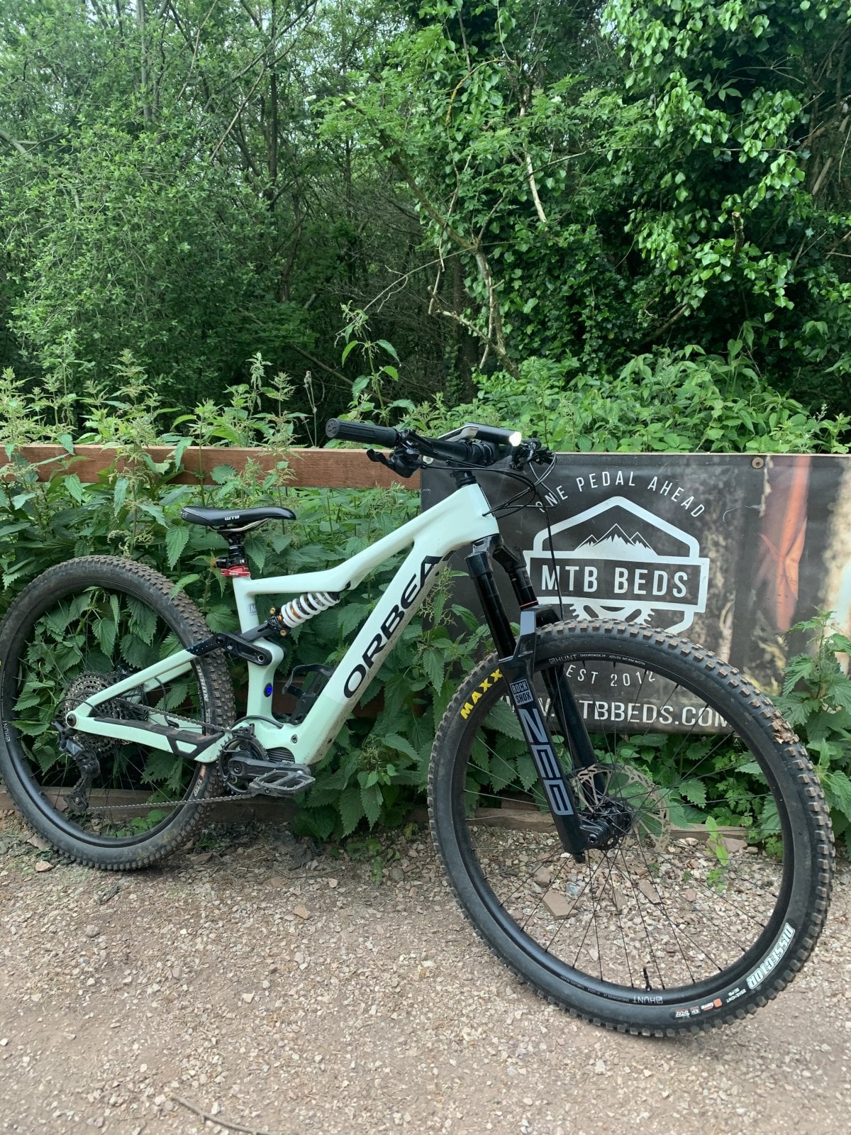

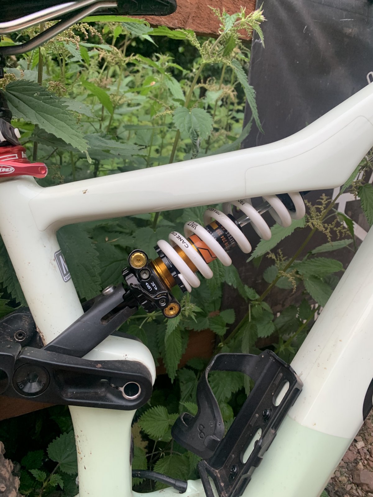

Got my M20 last week had to order a 6bolt rotor magnet as the wheels on M20 were centrelock & my wheels 6bolt
Swapped my carbon wheels over
Manitou Mezzer Pro fork
MT5 Fabio ltd edition brakes with loic levers
Burgtec stem & pedals, Joystick carbon bars
Sram cassette, XX1 derailleur & XTR shifter had on my Ripley, all parts off Ripley apart from fork

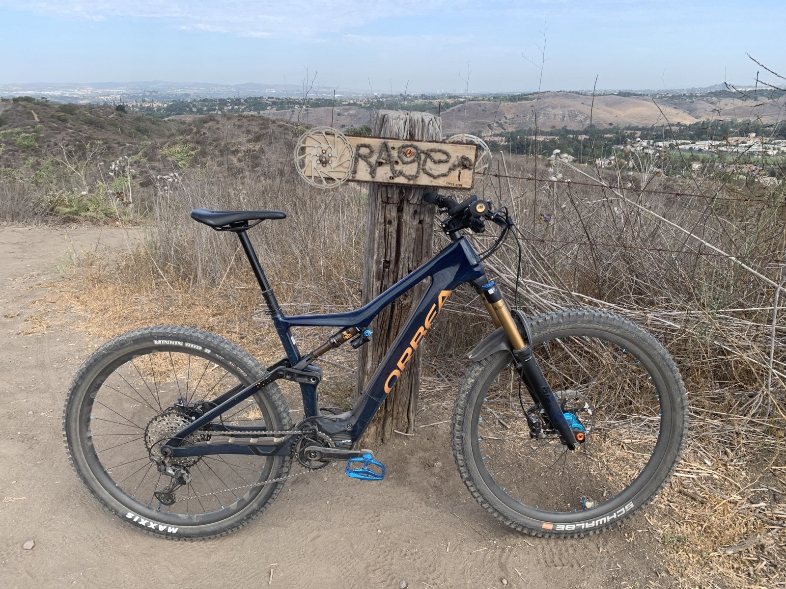

Here are my mods to date (base M10) :
- SRAM AXS XX1 10-52 transmission (cassette+derailleur+shifter+chain)
- Fox Transfer factory 175mm dropper (model 2021)
- Wolftooth dropper lever
- Galfer 203 front rotor
- Beast component Riser Bar 35 [2.0]
- Spank split stem 48mm / 31.8mm
- Deity Lockjaw grips
- Maxxis Minion DHR 2.5 rear tire
- Shimano XTR M9120 clip pedals
- Specialized Henge saddle
- Orbea Range extender (not used yet)
- Oneup EDC lite tool
- Invisiframe (gloss front, mat back)

- Carbon Bars $45
- ESI grips $20
