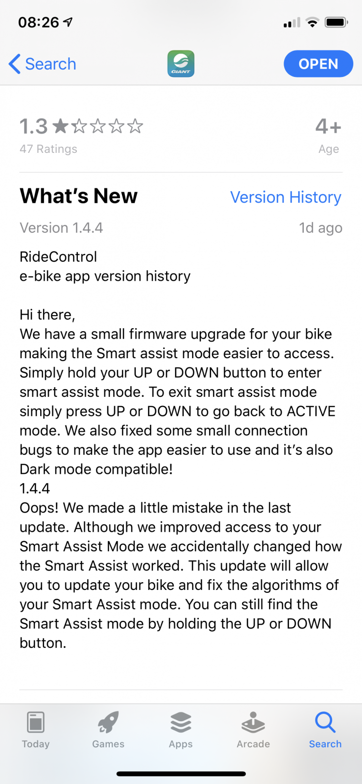

The latest Giant RideControl e-bike App is version 1.4.3 (dated 27 Mar 2020) and updates your Firmware to Software Version 20191231000.
The "Whats New" description for this version on the Google and Apple Apps Store sites states as follows:
We have a small firmware upgrade for your bike making the Smart assist mode easier to access. Simply hold your UP or DOWN button to enter smart assist mode. To exit smart assist mode simply press UP or DOWN to go back to ACTIVE mode. We also fixed some small connection bugs to make the app easier to use and more reliable. And it’s also Dark mode compatible!
Prior to this the Giant RideControl e-bike App was version 1.4.2 (dated 19 Feb 2020) which updated your Firmware to Software Version 20190802000.
The "Whats New" description for this version on the Google and Apple Apps Store sites stated the changes as follows:
With this update your 2020 Giant E-bike is also compatible with our app. Enjoy the full benefits of tuning your motor for personal optimal performance. We also have a new update available for your E-bike. This app will automatically update your E-bike to the latest firmware. The most important change is the function or your walk-assist. First press the walk-assist button to enable walk-assist, then press and hold the UP button to activate the walk-assist.
Prior to this the Giant RideControl e-bike App was version 1.3.0 (dated 17 Sep 2019), and other than language additions there is no info.

Here’s the ‘release notes’...
