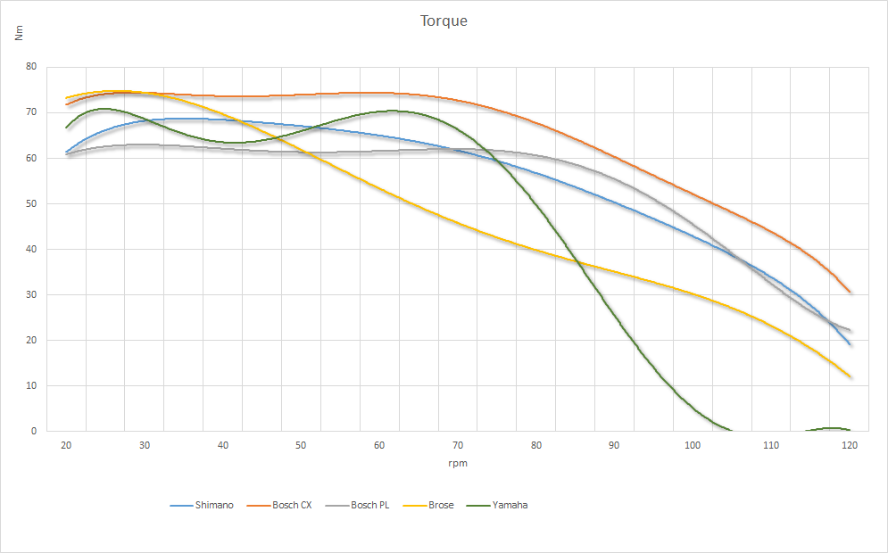

More up top support would make the Yamaha a beast.....would love to compare my 19 with the higher cadence 2020 Giants......found this graph which shows the Yamaha falls off way earlier than others.......see the green line. Torque drops off massively after 80rpm, very tractor like.
What's the max cadence on the 2020 bikes? Last time I checked it was the same as the 2019 bikes at 120. The only change I'm aware of is the auto mode that automatically ups the power if you go up hills. In reality I doubt its going to change my riding experience but I need to go and test the new bikes to see how it translates in real life riding.
Cadence is same but torque carries out further meaning you won't have to short shift to stay in full power/torque.....
where that grafic come from??
