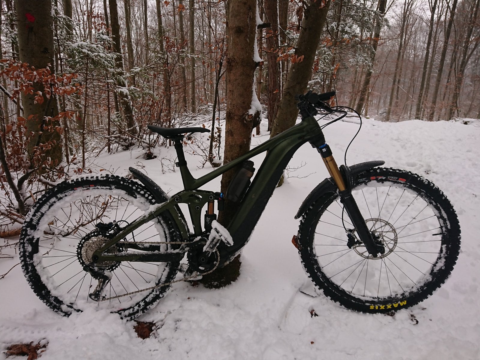

Yo all. Update on my bike and some pics.
What I changed so far:
- industry nine stem (40mm)
- kingdom titanium handlebar (780mm)
- hope 165mm cranks
- self made wheels: DT 240, EX 511, 32 spokes, brass nipples, magic
- galfer disc pads
- Giant 170mm dropper (originally 150mm)
- added Mudhugger FRX on the rear
- added Mudhugger EVO on the front
- 76 projects high flow valves
- Fidlock TWIST bottle 590ml
- XT 12 speed cassette
hey, cool setup! was wondering what fenders you're using? thanks.

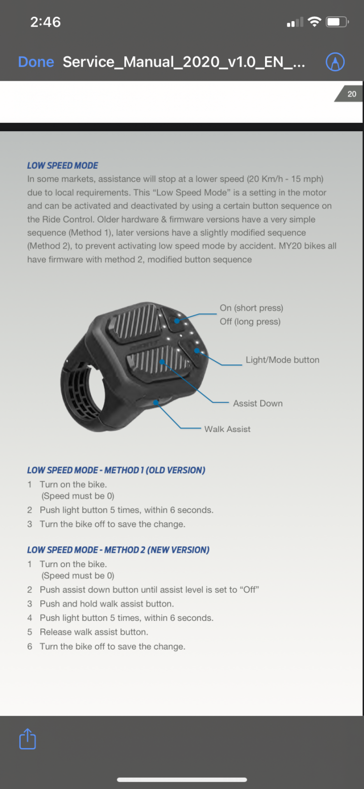

Has anyone been successful changing speed modes on the 2022 models with the updated controls?
View attachment 82571Has anyone been successful changing speed modes on the 2022 models with the updated controls?
I didn't know that this actually existed. Great info. Although this manual is for the old controller...on the new one there is no light button.
I wonder If I accidentally switched my Reign into low speed mode...as the assistance fades out/in at 21km/h when pushing hard uphill in higher modes.

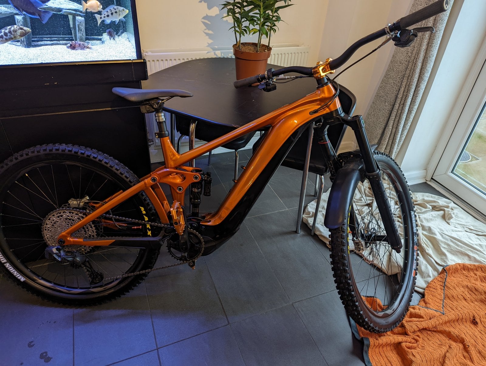

This is mine. I wanted the orange colour plus had a few upgrades ready.
Put a riser bar on it, burgtec stem and peddles. Axs dropper and gears, rockshox super deluxe ultimate rear shox, rc2 damper upgrade, vorsprung smashpot coil conversion on the forks. Assegai front and dhr rear in DD casing. Wheeler on the way. DT Swiss fr560 rims with orange hope hubs. Trickstuff Maxima brakes with galfer rotors. Thank that's it 🤣
How is that rear RS Super Deluxe shock feeling ?
Any special tune ?
Reminds of the lower Part of Monte Arsenti 😍
If this place is in Greece you're lucky man 👍

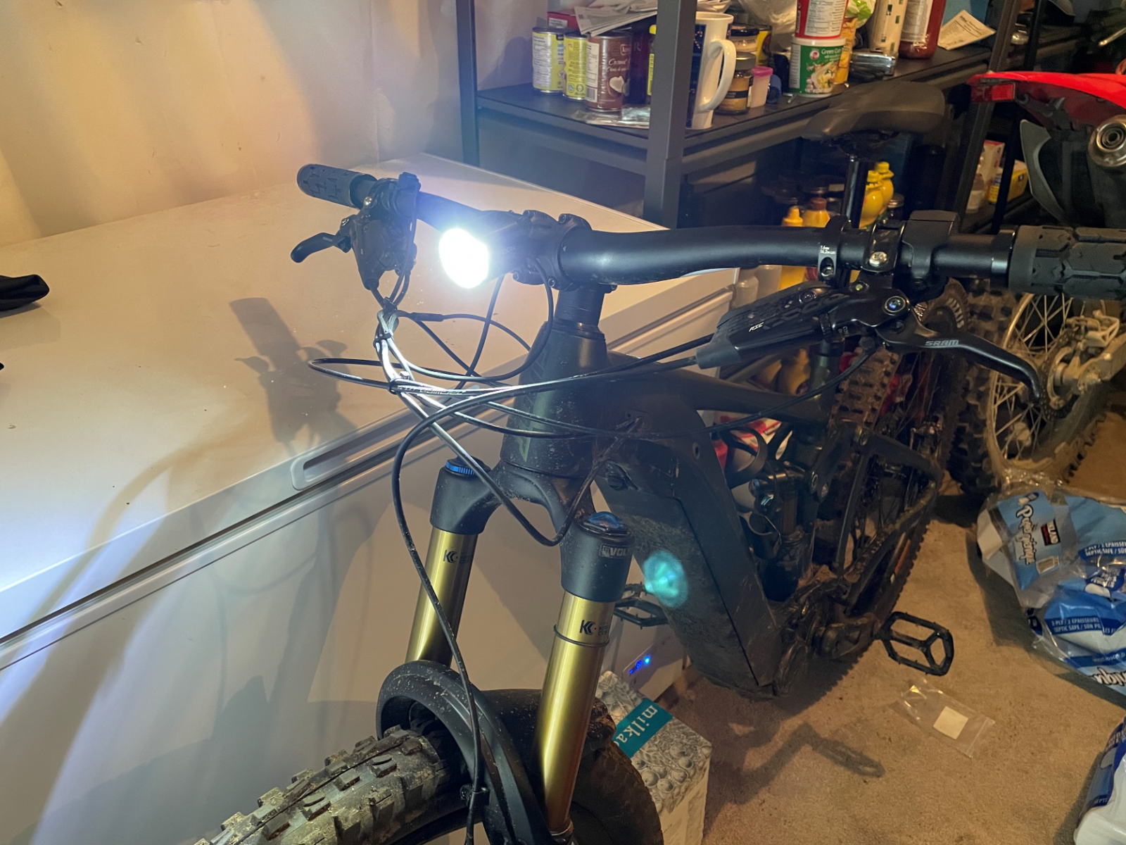

Picked up the Giant e-bike light (Recon E HL 1000). Runs off the internal battery, pretty cool! It's this one: Recon E HL 1000 | Giant Bicycles Canada
Only silly thing is it doesn't have a dedicated off switch, so I mapped it to the middle hand control button (normally for walk assist, but I never use it). Seems you can change the button mapping in the app.
Looking forward to testing it out soon, as well as a helmet-mounted light I grabbed.
