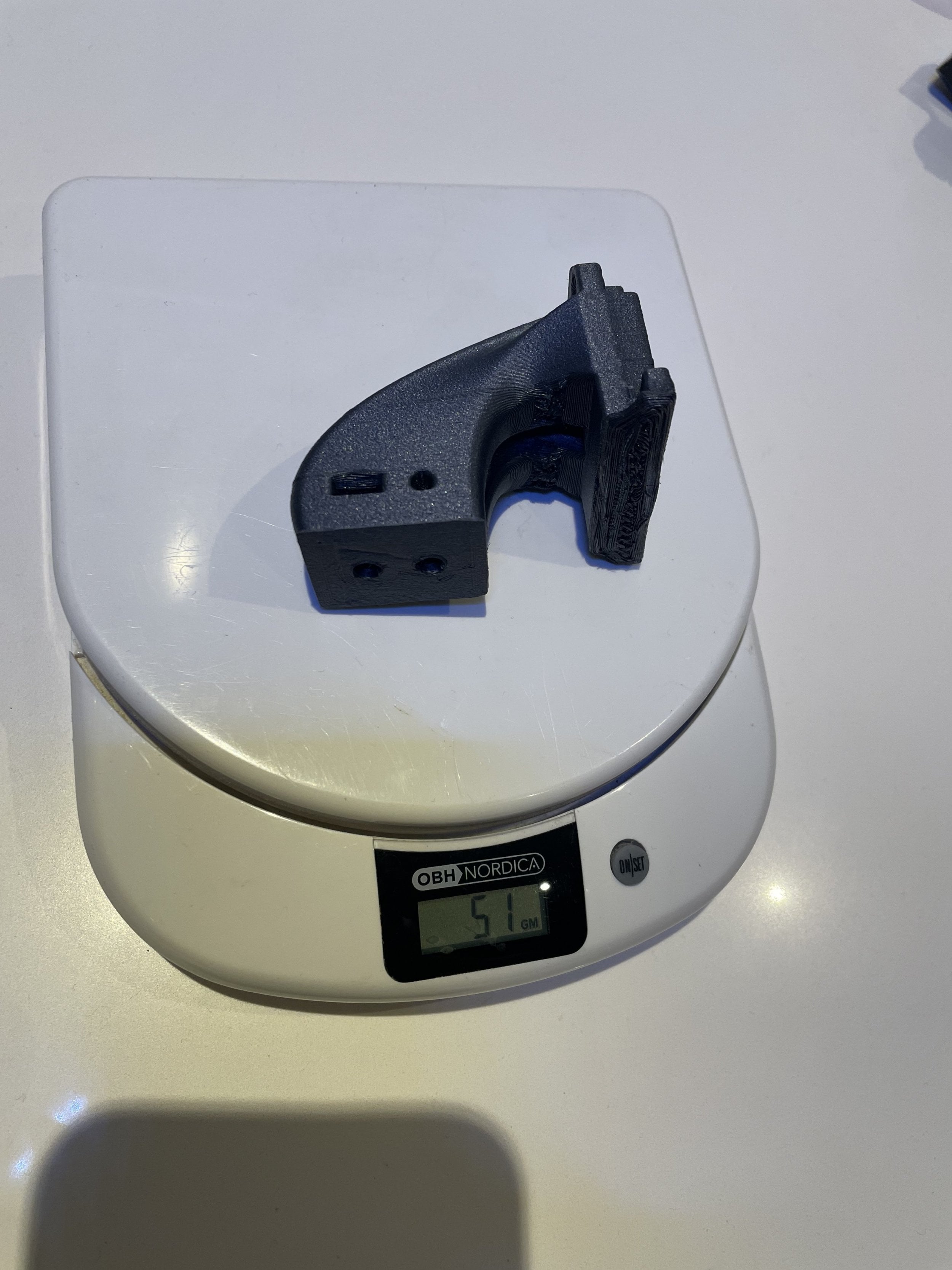

My Reign e0 Large 750wh was 25kg with pedals 1,1kg rear/ 1.25kg front tire.(lighter stear/stam seat and dropper) and 3d printed battery lock.
This way it was 0,6kg lighter than ‘22 CF cube w/ 750wh battery same size, same weight used.
Now I have shaved another 500g with lighter battery casing, and switching to 11spd 1195 casette, that is 400g lighter.
So just north of 24kg expected weight.

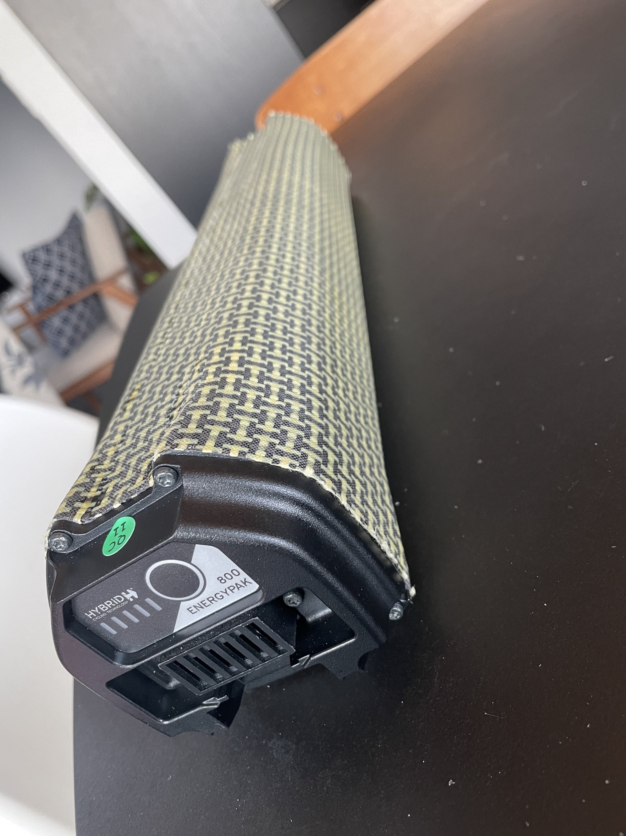

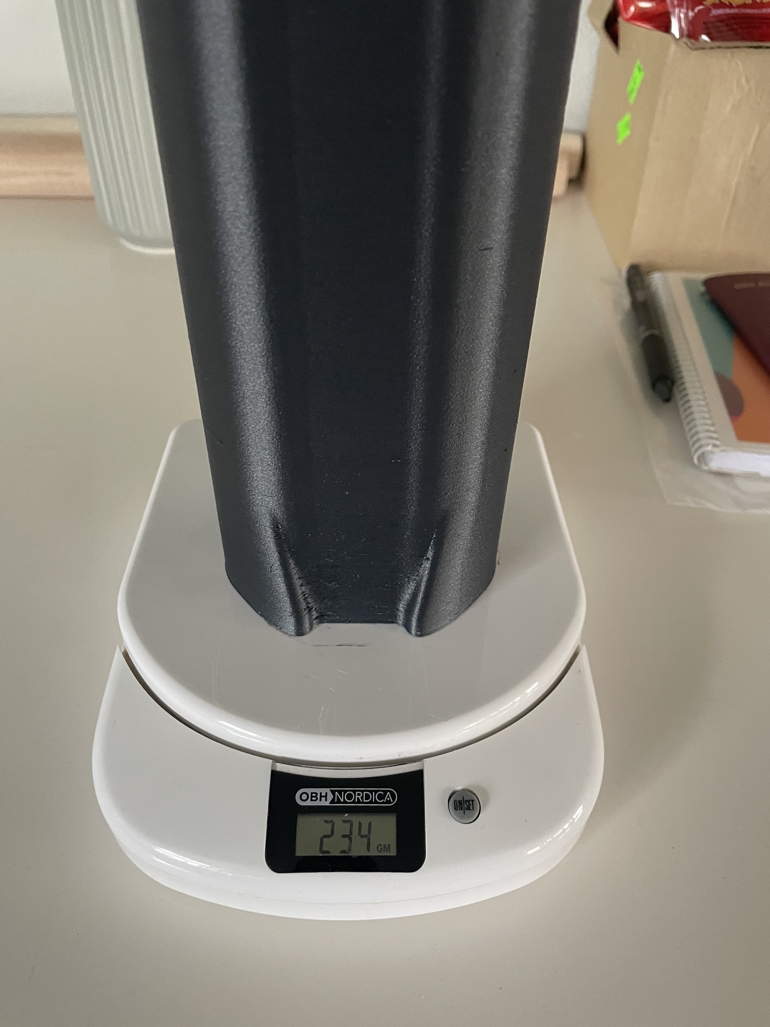

greeting. lighter battery case? maybe a hint?😁😁
Here you go
910116C3-93AC-4524-85B1-C85896022F91.jpeg 07C0B646-688E-469A-B89A-F8391B7869BA.jpeg 528E5A71-893F-4C07-84F6-BCC5A1177A39.jpeg
It weights in at 24.1kg w/pedals 🥳
Alu crancks, two remotes on handelbar.
23.6kg without pedals, and with org. Carbon cranks.
PM me if you are intrested in battery tube(500/625/800wh) and battery lock delete.
800g lighter.

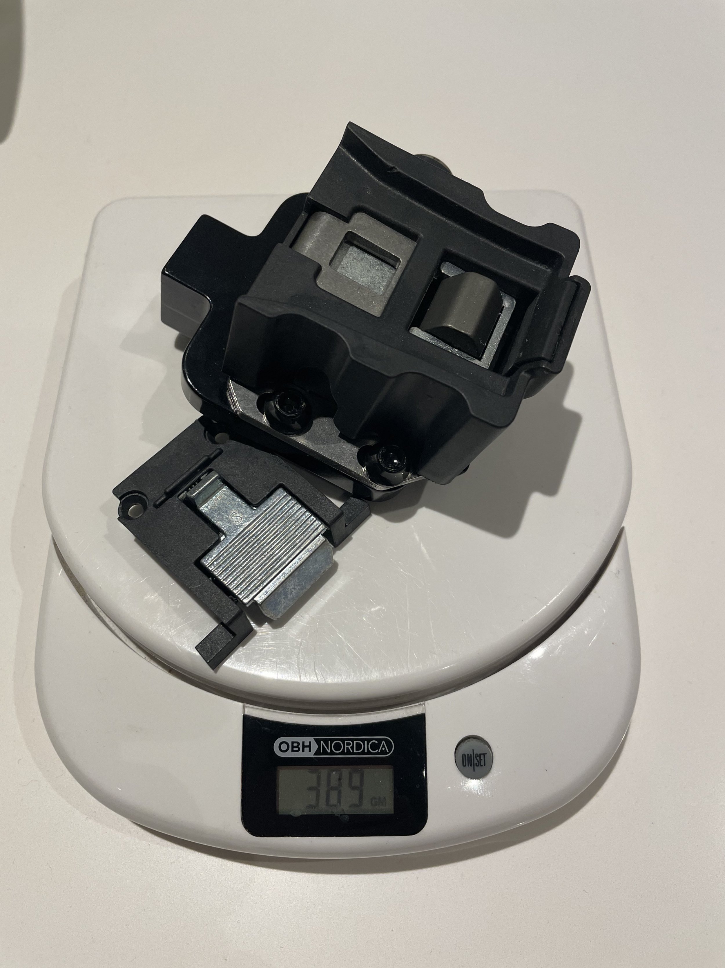

Battery lock delete:
45632738-1375-4859-BD9C-7A47B5997A94.jpeg 50CCFCA2-A9CF-4230-B8F1-932EEFCE5FE5.jpeg

Hello Nobrks,
What you have done is an amazing job, I really like it ! Saving so much weight in this part of the bike is something really important.
Since the beginning I found the weight of the battery terrible on my bike. Coming from a Full-E to a Trance-E I have seen the huge weight difference between both batteries, at that time Giant claimed that it was due to a conformity to some safety standard but they were much heavier than all other manufacturers...
I have some questions for you on your work :
1. Do you think those parts are strong enough if you ride hard stuff like jumps with rough receptions ?
2. Now you can not easily remove the battery from the frame, correct ?
3. I haven't tried t open my battery case to look inside. Is it something easy to do ?
Thanks
Hello Nobrks,
Thanks
1. Yes, last year I rode the whole season 1400km with different design of 3d printed mount, that was more more demanding on the material, the new design is simpler and has la lot less stress concentration. Matrial can flex a bit, is not brittle.
I rode a couble of days in bikeparks in Germany and Sweden that are alot more chattering than in Denmark, even got one of the fastest time on Maggan in Vallåsen (youtube).
2. battery is removable, two bolts instead of one in the lock. Takes about 20sec longer to install.
3. depends on battery size, 500/625 easy, 750 easy, 800 has a very tight fit in btw battery and case.

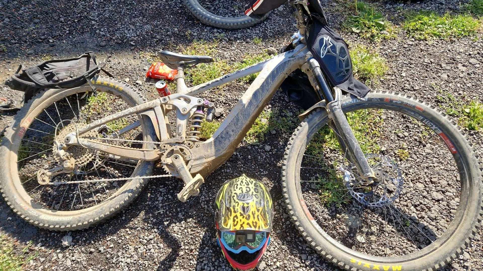

My Giant is a E+1 size M. I've weighed it at 26.5. Mods are the following:
  • 800whr battery
  • DD casing upfront DH casing rear
  • 220 rotors ( will be going back to a 200 in rear with the hope brakes)
  • Hope tech 4 V4
  • Fast Fenix coil shock
  • crank Bros stamp 7 pedals
  • One up adjustable seat post +yep components lever
  • ergon grips and saddle
last mods to come will be DTswiss EX511 front rim on hope pro4 hub and DTswiss FR541 on DT hybride hub.
I've built the bike more for strength and beating of my local terrain. And enhanced its strength. if the same frame was available in carbon, i would buy straight away
I guess i've added 1.5kg in total

Nice. That's a burly build to be fair!
I got mine down the 24.9kg with EX511 rims front and back, slightly heavier than stock tyres, and 11s X01 cassette. But with the 625Wh battery. So I guess 25.5kg is about the averge weight of a solid, high-end build with the 800Wh battery.
24.9 thats good, changing the transmission is actually a good idea because the stock cassette is heavy. And the motor can compensate. I live around Grenoble in France so the bike sees alot of 1000m descentes. Rocky rooty alpine descents are the norm. i guess carbon cranks and bars could also help save some weight.

So just a quick update, My "heavyish " build has just come back from a week at the Megavalanche, the bike performed flawlessly, no mechanicals. Very reliable and dammn such performance , so it has been mega approved and over took nearly 80 other riders.
The DT wheels are really strong and stiff. I d highly recommend them.
Coil shock i cant rave enough abut it.
ergon GD1 grips did a great job of filteringout the vibrations.
Hope tech 4 V4 brake set up was great for this and limited fatigue in the hands. always a huge reserve of power when needed. The Fox 38 is Oem and did a perfect job. I left the bike in the high setting. its a great downhill machine in these conditions.
355807083_111468608659539_6079741210290031583_n.jpg View attachment 119962 mega.jpg
800g lighter.
View attachment 108914 View attachment 108915
