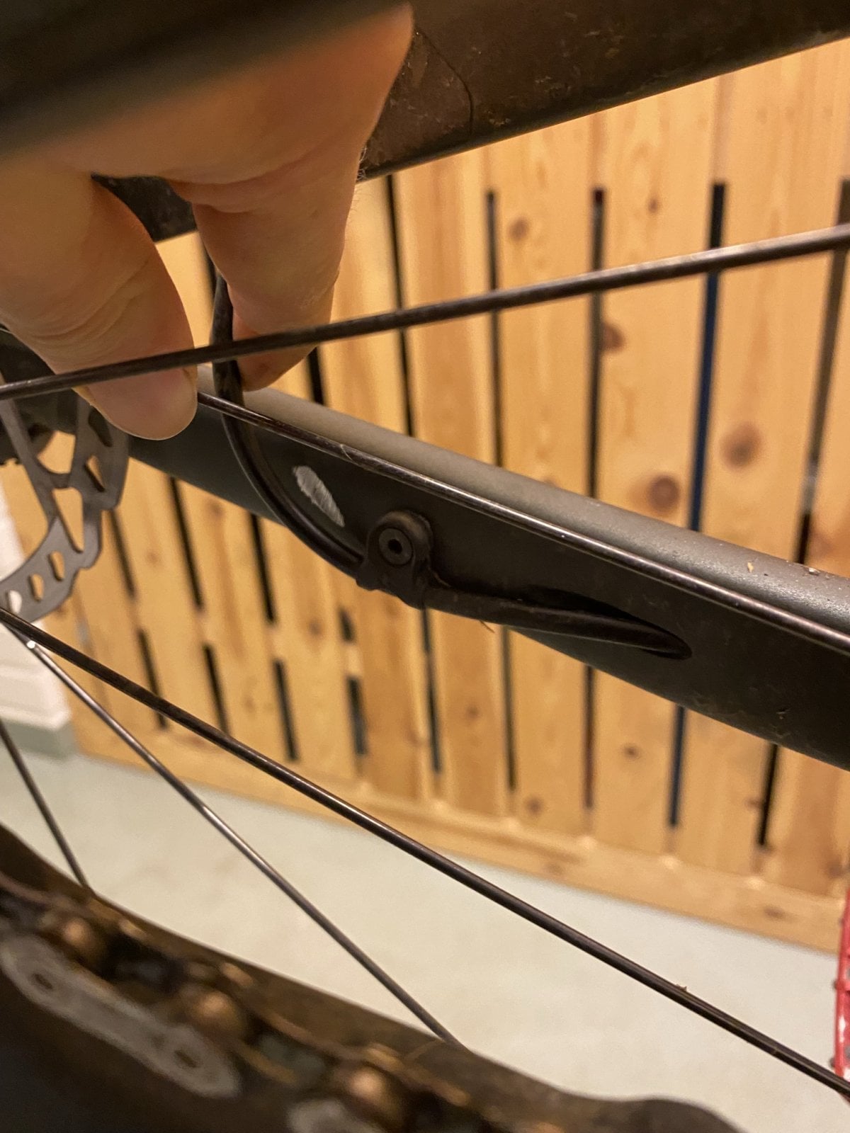

Kimmoi Well-known member Jul 6, 2018 391 385 Finland May 27, 2021 #8 Dunno about lenght but check your assembly. I took the lower clip off. And i think the clips are assembled wrong way at the factory already. I also heard that this kind of assembly could cause break of the hose over time as suspension works.
