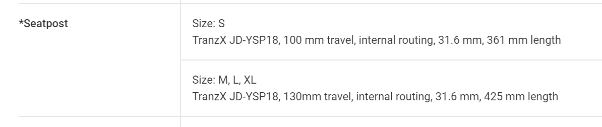

Longer than...?
Mine has a 170 in a Large. How long do you want to go?
p3eps
Dec 14, 2019
1,870
2,235
The 9.9 Large comes with 170 as standard. Not sure why another Large model would only come with 130?

That's the "Dentist Spec" Rail, us mere mortals have to make do with 130mm on all sizes.

Weird! I get that they’d not put an AXS dropper on lower specs, but I thought they’d have done the same size?
I had about 2cm of the post out when fully dropped, so I see why you’d want to change from 130.

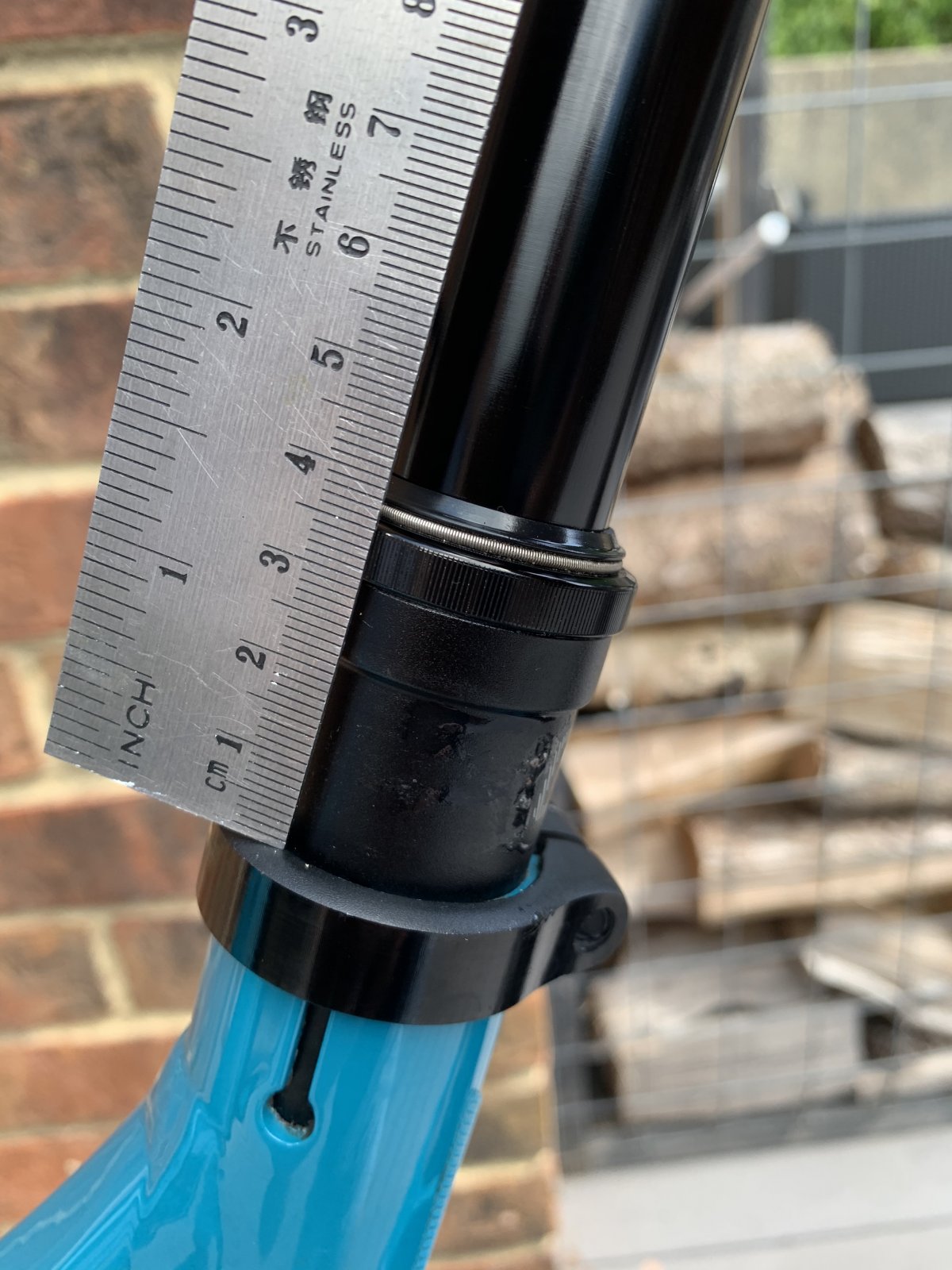

I’d like to get a 150 for mine, I think 170 might be pushing it a bit. I’ll have to measure how much post is sticking out from the seat tube.

FYI I have just put a none dropper seat post into my 7 in Large. the seat tube will allow for around 280mm of penetration, for anyone interested.
Sounds like a Bike Yoke Divine 185mm might just fit? Total insertion length to bottom of actuator is 289mm, but you can rotate the actuator to help it fit. Tight, but OK I think?

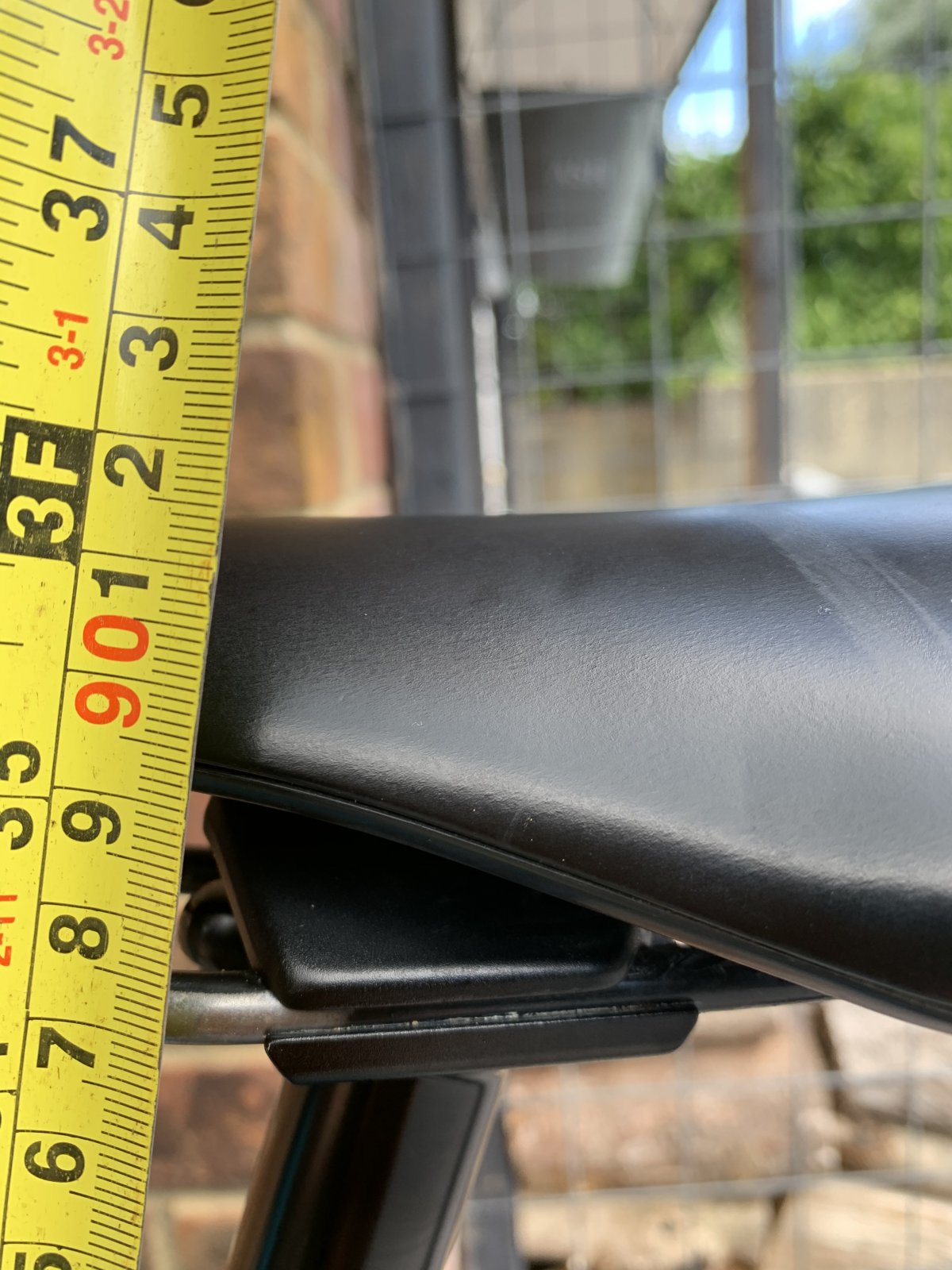

This gives me 915mm from top of pedal at 6 o’clock to top of saddle. This is what fits my body. It’s not the Min insertion you need (we know that fits), it’s how much post you need in the frame for your legs. I’m 33” inside leg. I’d measure what you run at mo (at full extension) and then measure what you need from pedal to top of saddle.

Just FYI I run 305mm from top of seat collar to top of saddle. That still leaves the 40mm of lower post above the collar. I could prob only lower another 4-5mm before it hits the kink in seat tube. Hope this helps.
Thank you for all the info and photos! This is exactly the information I need. ?

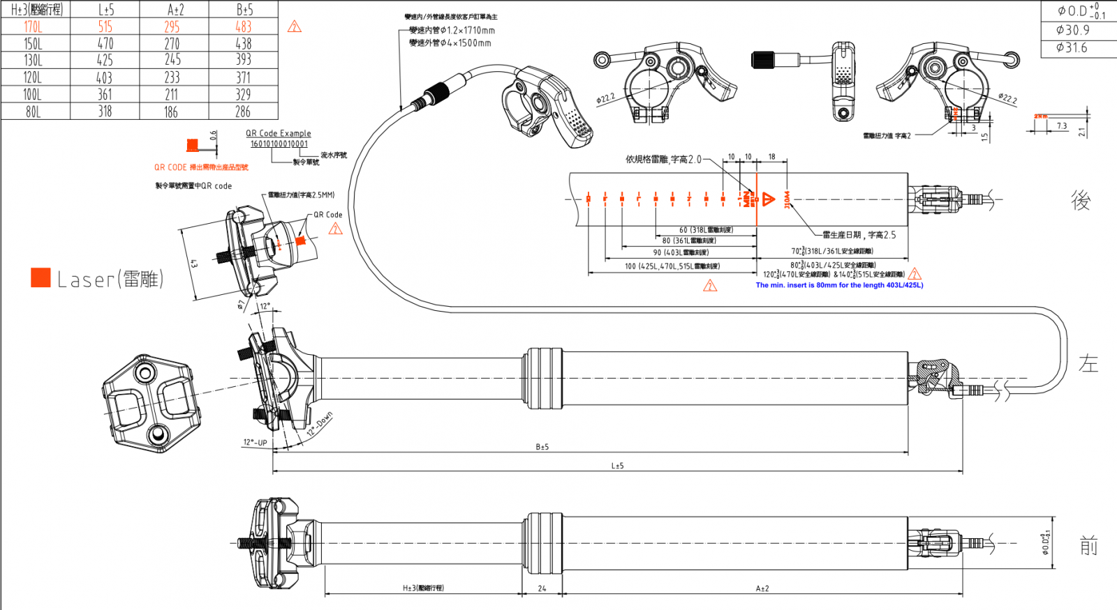

Does anyone have measurement info for a Rail 9.7 in a Small frame? I'm hoping to move up to a 150 mm dropper from Oneup with the tube down all the way to the collar. Oneup lists an insertion depth of 237. Bike comes with a 100 mm dropper with a listed max insertion of 210.

From memory the OneUp dropper cable attachment is 15mm but the Bontrager cable attachment is 27. 7mm so there's more than 12mm to play with. I put a OneUp 180 dropper (without shims) in my Trek Rail 5 Large and it fitted with room to spare in spite of the fact that using Trek's insertion lengths the Oneup dropper site recommended shimming to 160mm

FAQ on insertion depths for the rail are wrong. When I got my 2020 Rail 7, the Trek Chart said large was 300mm. I run a 210mm Oneup v2 slammed to the collar on my Rail 7.
